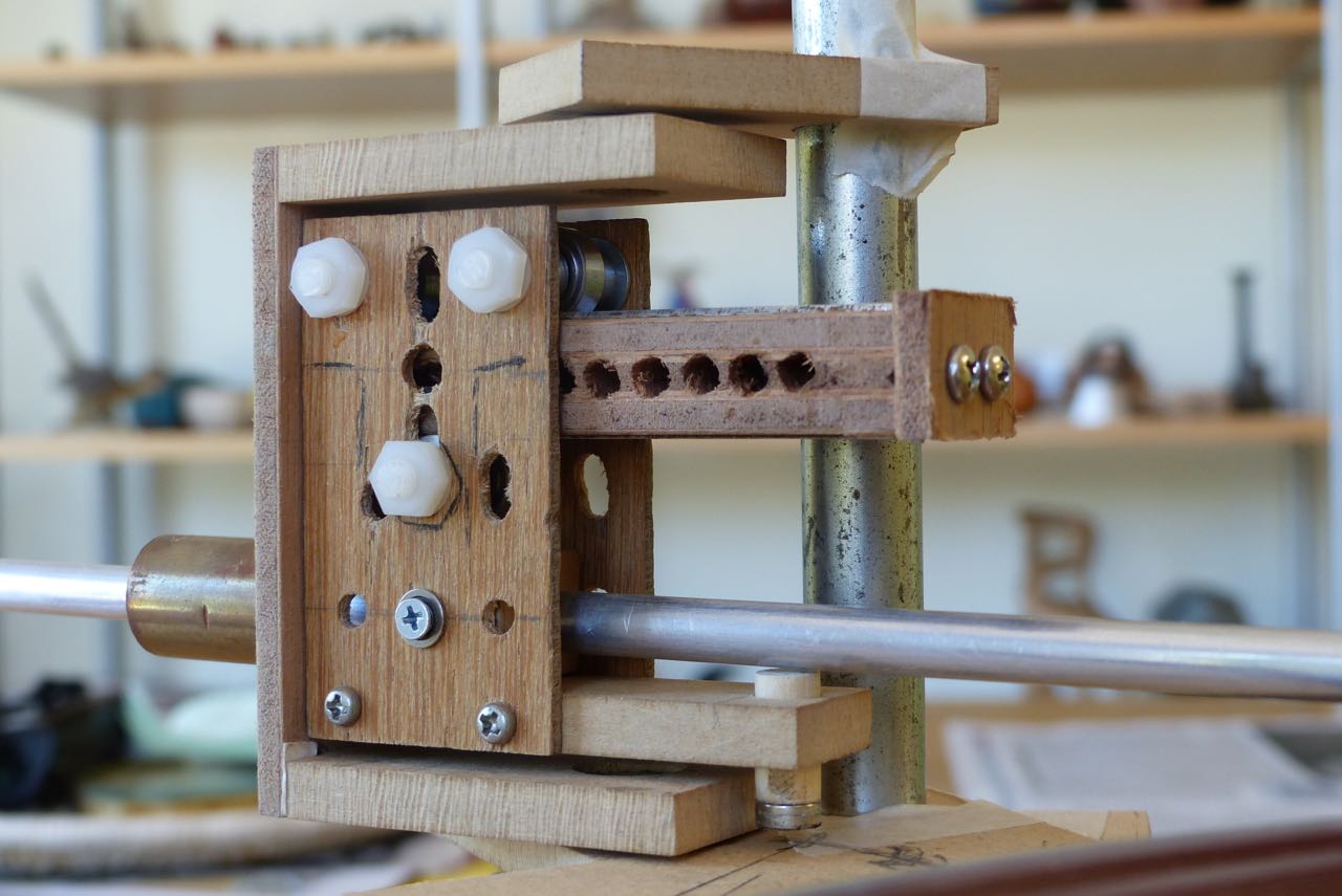

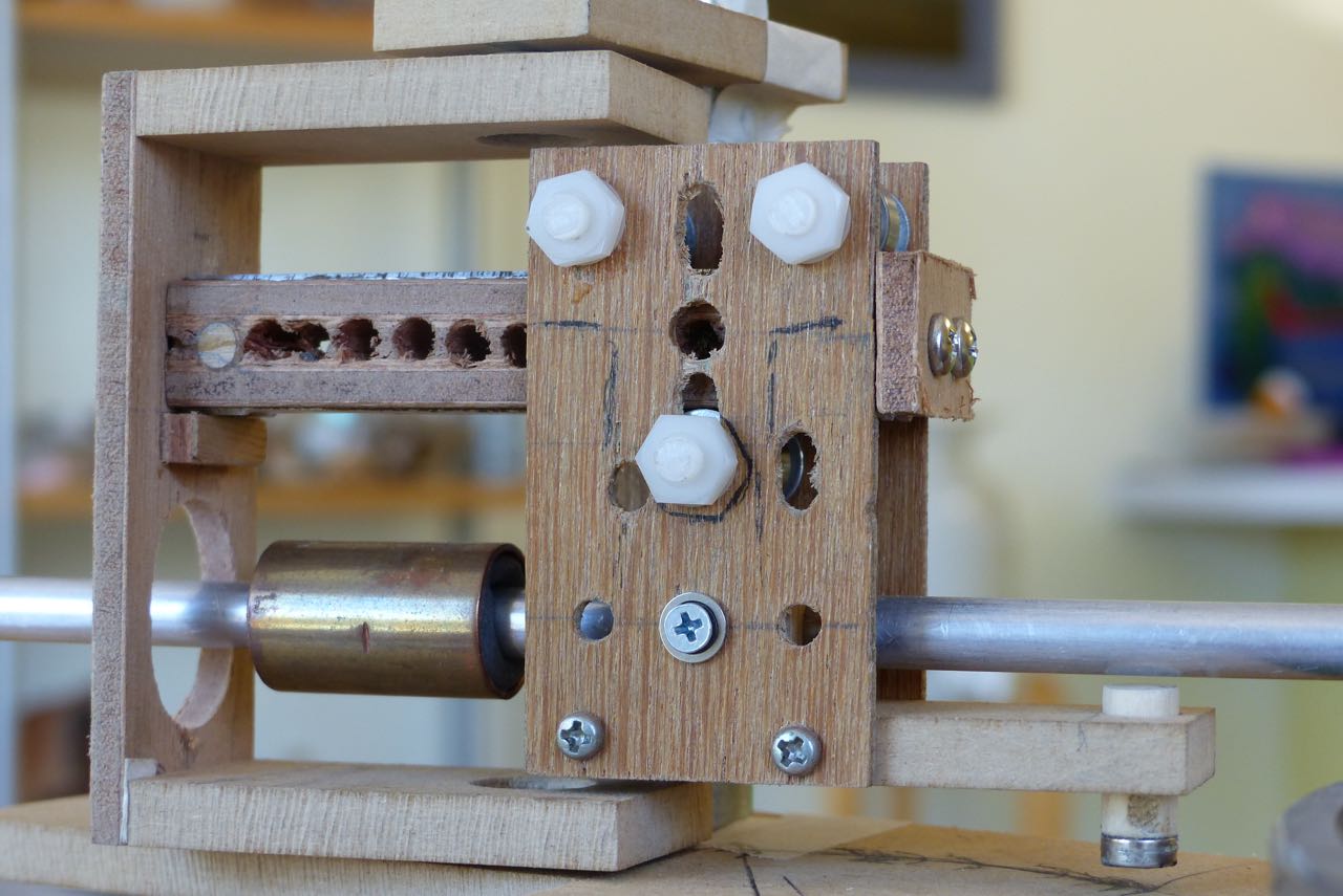

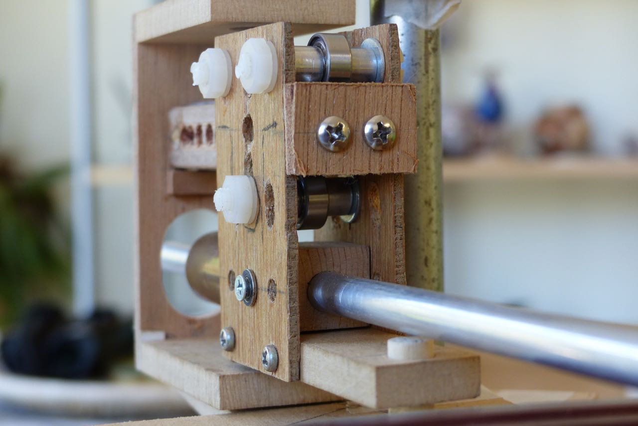

Ralf - my appreciation of your arm hasn't changed. My understanding is that you use deliberate skating which creates a side force to propel the arm and then to control that with the servo. I still think that's brilliant. My comment about stylus drag was about whether that force alone can move a sliding mechanism like I tried to build and Carlo designed for the Syrinx. I still think it's insufficient.
I've attached some larger photos which I hope show the arm more clearly. The carriage has two upper bearings which ride in a V track and one lower bearing, also in a V track, to control axial forces and keep the upper bearings from lifting. The original idea was to use a magnetic control, but because it had to be ahead of the carriage, it caused the rear upper bearing to lift. The torque also increased the friction of the other to bearings.
The fourth photo shows the trace the magnet needed to follow. I thought I might try to replace the magnet and relieve the stress with a two bearing control arm, but geometry got in the way.
In other words, I made a lot of problems for myself. Head banging, as Carlo says. It's possible someone may design and build a successful sliding extender PLT, but I got so discouraged, it probably won't be me.

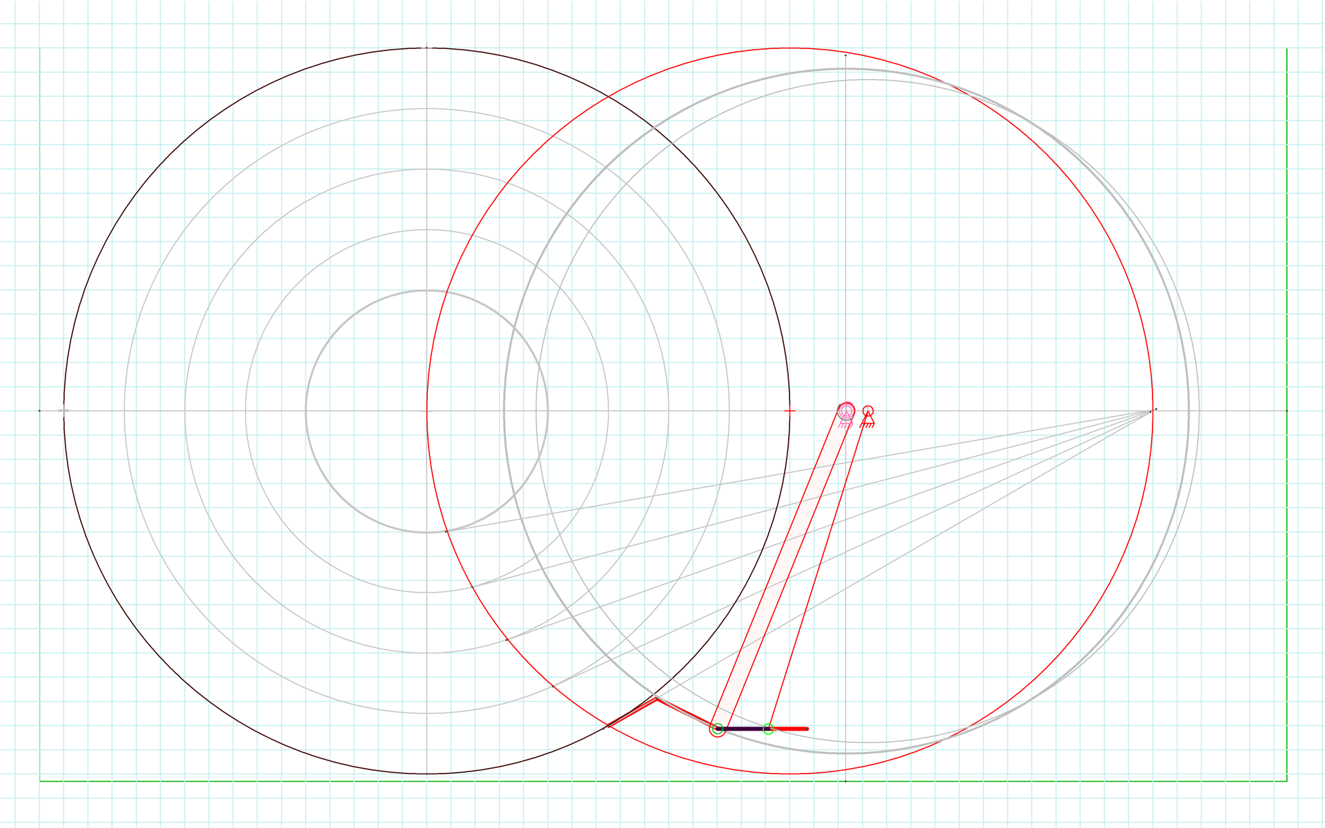

Thinking about the rear pivot of the sliding extender arm took me back to the Birch/Thales arms. The geometry of the extender was a bit different - I didn't start with the Thales circles, but instead started with a chosen arm length and did right angles off the front of that to the spindle. The point where the outter and inner lines cross is the pivot. The control arm pivot is derived from points on those lines.
I think Carlo did something similar in his drawings in #2146.
A serious problem with Birch/Thales arms is that the arm can't be parked very far away from the platter because the vertical bearing carrier bumps into the pivot. By using the geometry technique, it's possible to design the arm so that parking space is deigned in.
In the hasty drawing I've posted, the arm rests about 50 mm from the platter.

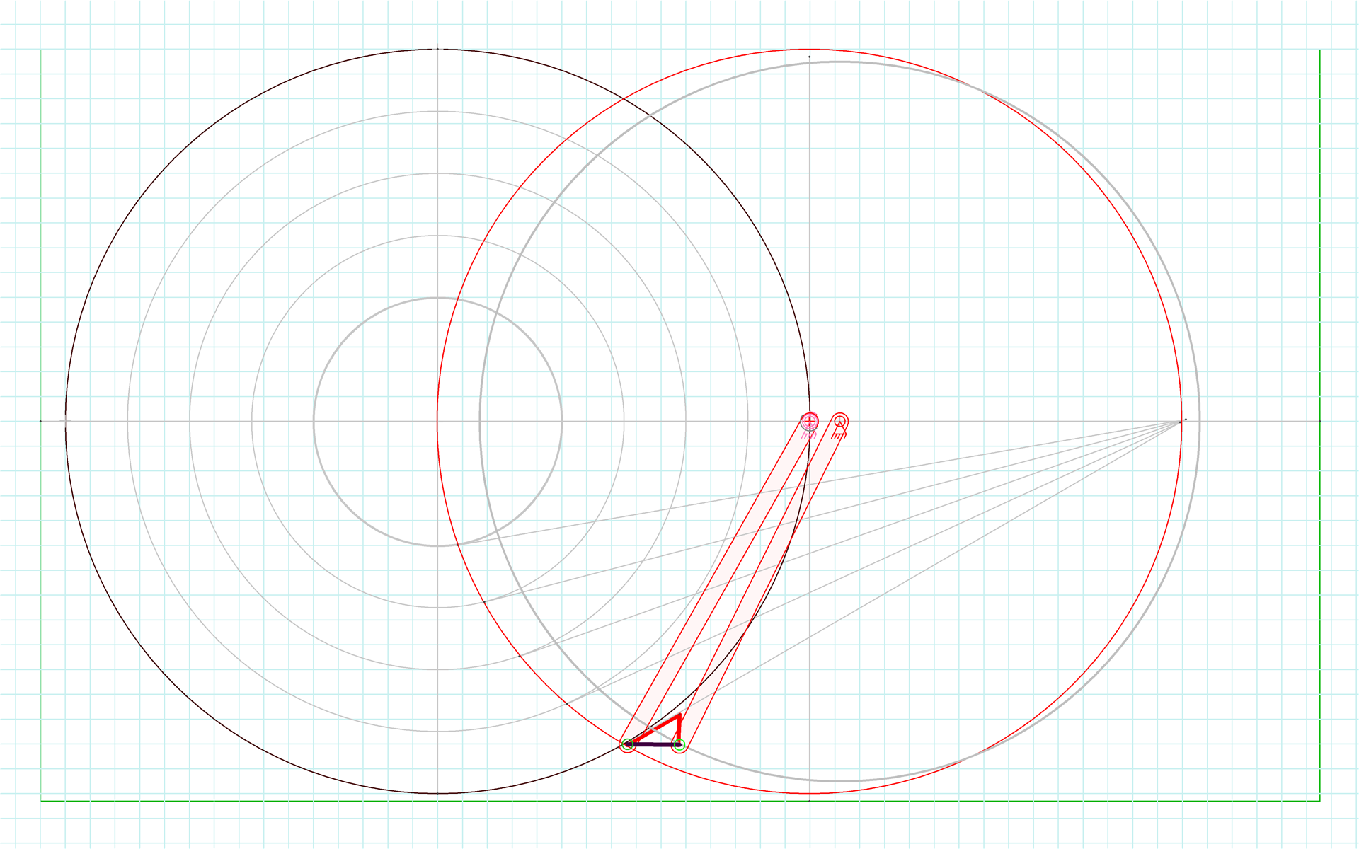

Sliding extender . Hi Doug, you were even more optimistic than me: I was hoping that the Syrinx string gadget would make SF+SD collaborate (which instead nullifies each other), you that the TA would move with the SD alone, to guide it with a magnet. The Syrinx mk2 (# 1544) unfortunately showed that SD is totally insufficient.
No, we must be able to get the extension directly from rotation = 2 years of useless "head banging" (how do you say? here sbattere il naso, smashing the nose, like pets against a glass door)

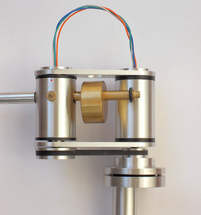

Birch TAs parking: the Rabbit belt Birch can rest everywhere needed, since the CW can go even between the 2 cranks. (attachment)
The drawing #2146 tried only to show that the geometry deriving just from the tangency to the groove provides endless, and very different solutions.(all geometrically correct, but most with completely wrong points of control)
Therefore it is very unlikely not only to clone an LT, but also to talk about it without at least knowing its measures. I had praised the geometry found on that simulation (drawn interpreting the patent drawings) because it had a guide that was aligned with the cantilever (= <<skating) except to realize then that, in that way, the guide couldn't brake efficiently the advancement. Therefore the simulation is absolutely not that of an LT
The mockup instead shows that two very different solutions fail the string test quite the same way.
This poses serious problems, as we design these arms to avoid T.E.and Skating. Applying antiskating (weights, springs, magnets, pivot slanting) on PLTs may be something like the old trick of the rail tilting in the linear trackers - a remedy worse than the evil.

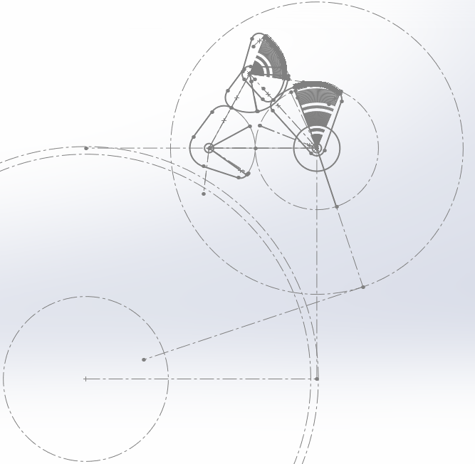

one step after...
attachment - thales 3a
many steps after...
attachment - thales 4a
wow, i've reinvented the G. Guy Thales 1950 (alias Simplicity 'n so on).......
carlo
