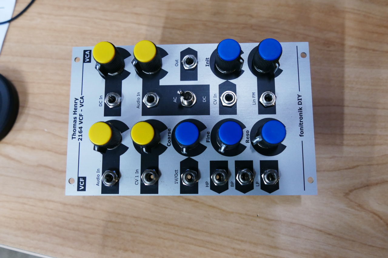

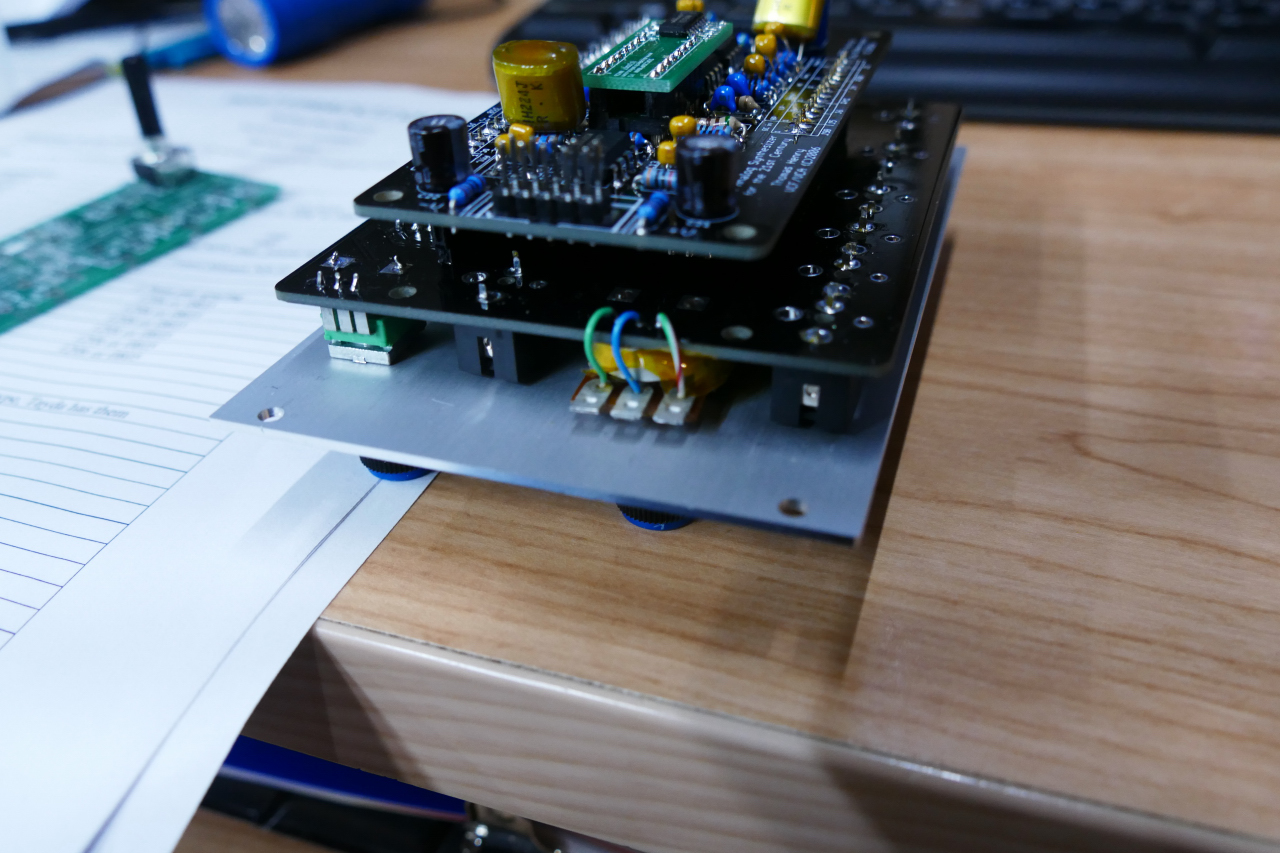

I keep a running list of parts that I need. These little 1 Meg pots have vanished from Digikey and Mouser, so I rigged some standard pots into the Eurorack modules that I built a few months back. The picture shows how I did this on a Thomas Henry 2164 VCA / VCF module. There are several more unfinished modules here waiting for parts, time or both. There is also a new front panel for my MFOS Ultimate and Ultimate Expander synth.

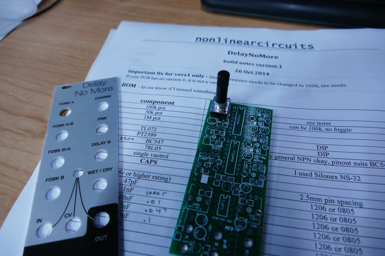

I test fitted the goldmine pots into a Nonlinear Circuits DelayNoMore board, and ordered some extra. I have a Befaco Crush Delay board and panel set on order from Synthcube, but it is on backorder.

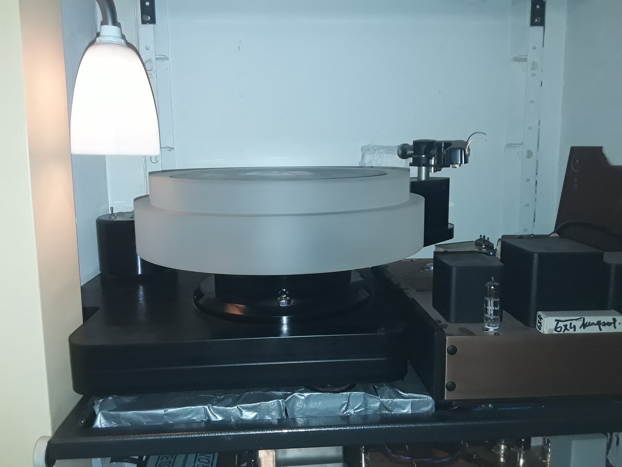

For a long time i had this project in the attic so to say.

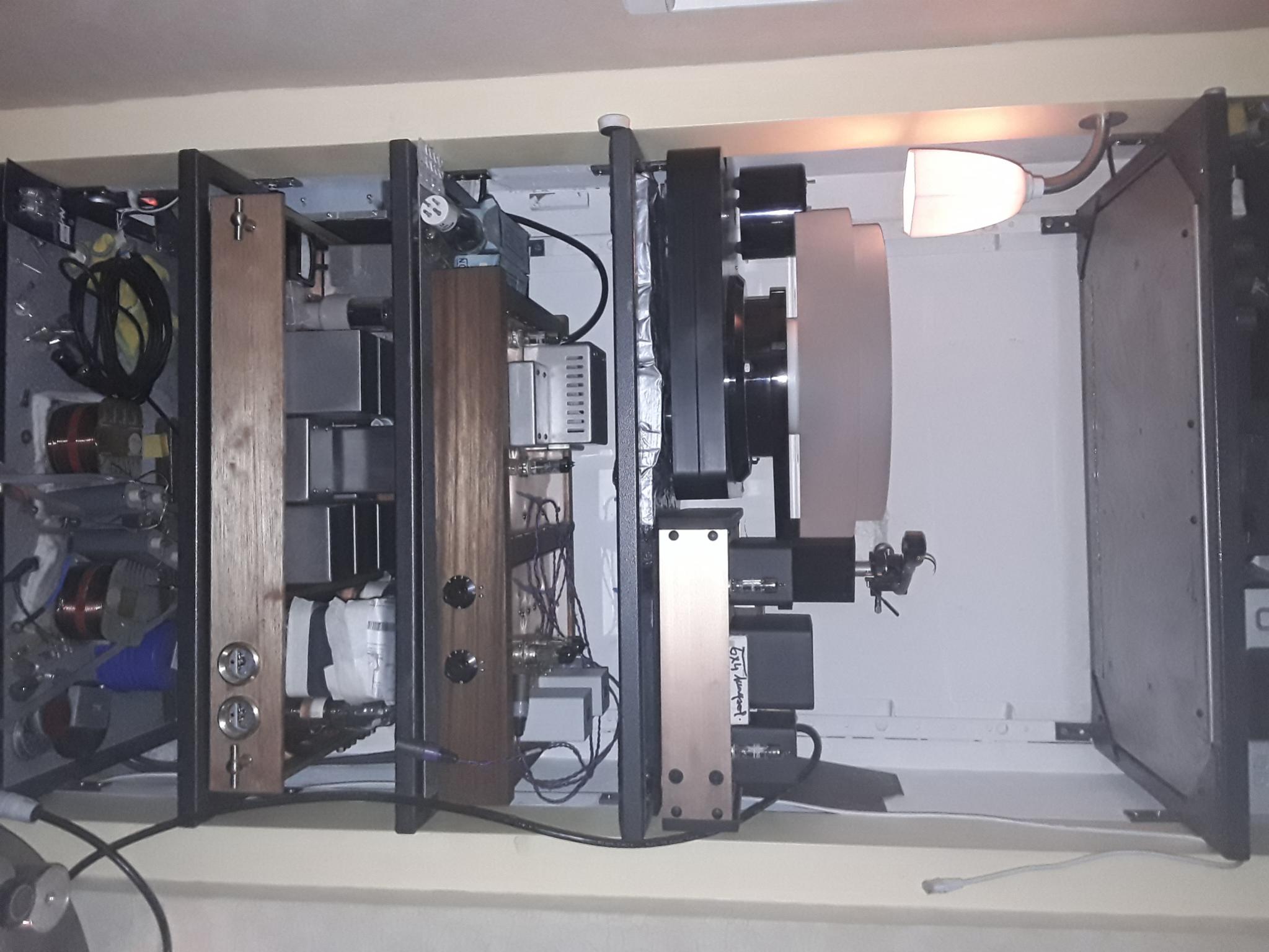

A week or two ago i put the turntable where i wanted it to be .

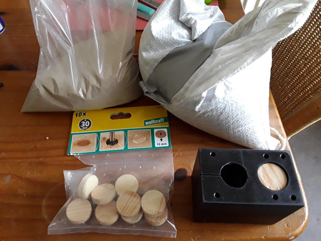

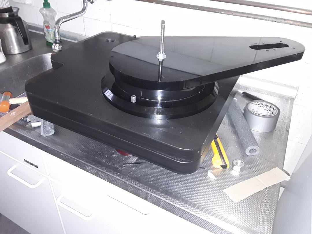

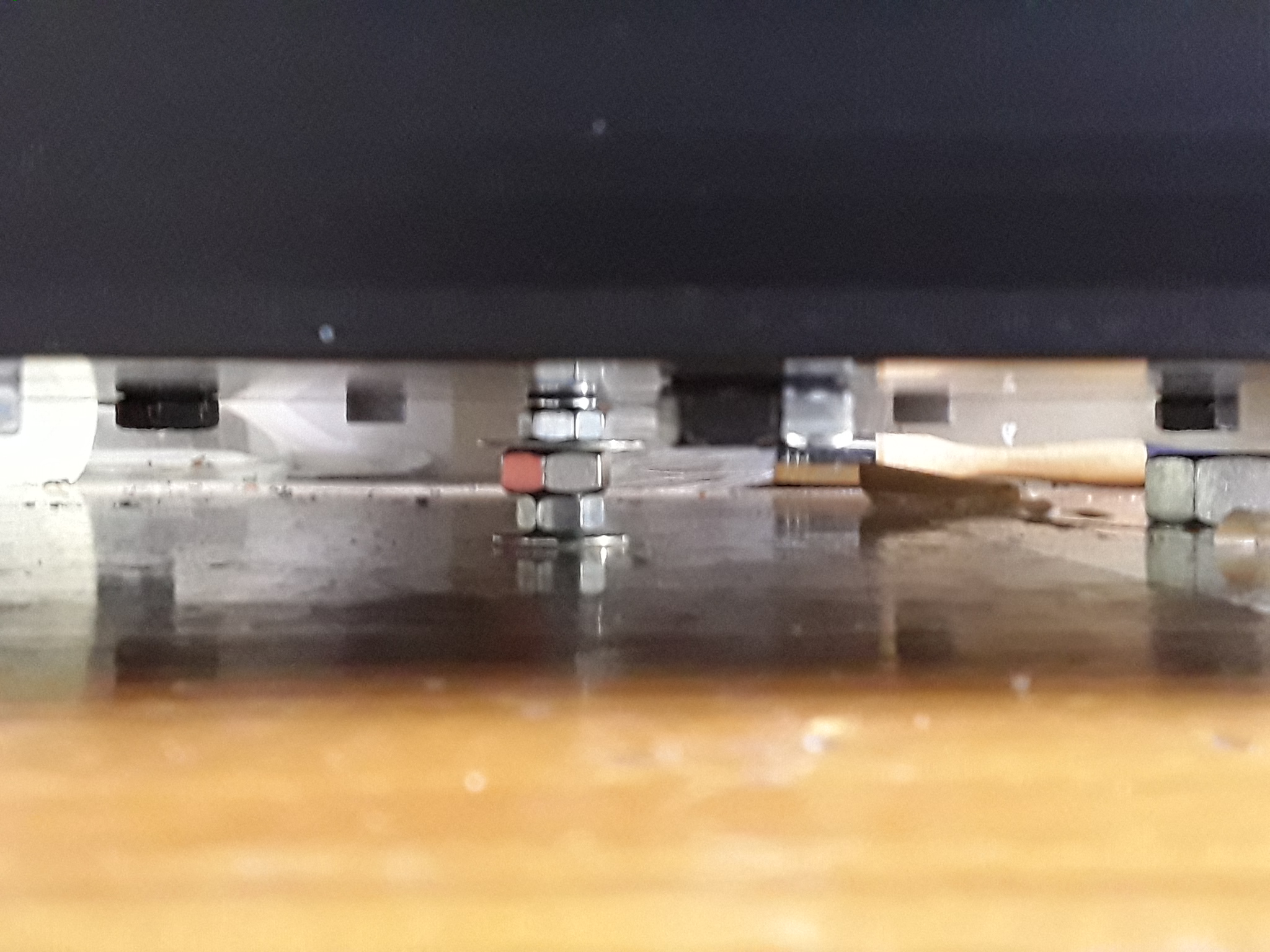

It is a German brand named Scheu which i gave something like my own signature using a pom material base also filled with lead shot like the Scheu itself.

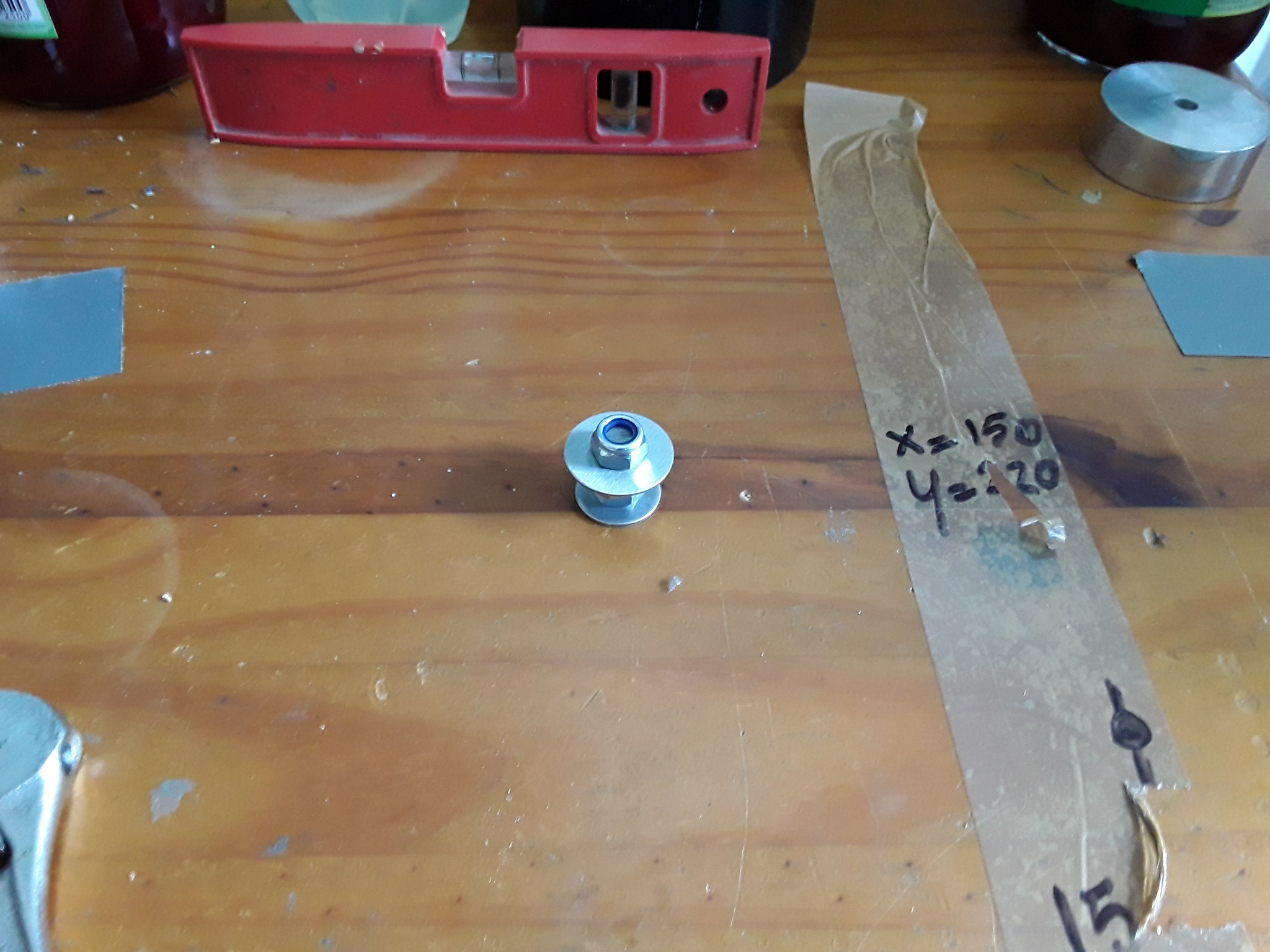

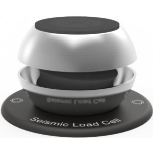

I found the center of gravity by letting it '' float '' on a bolt after that i made 3 big circular holes ( at the right distance from the center) in the lower part of the base to cover the upper part of the Townshend seismic pods. It appeared however that the weight was to close to the maximum weight so hard to make the pods actually work. So i started looking for the model that can support a bigger weight. It is nowhere in stock. The Townshend company is in a kind of lockdown for most of the time. Asking about delivery time almost feels like cursing them.
Because with the new pods the weight is on the lower side i have been thinking about adding some weight to the base in such a way that the weight will be in the middle of min and max weight.
The center of gravity is not in the same position as the spindle because i had limited space for the machine . On the left corner in the back there will be the motor and in the right corner in the back will be the arm. The arm base i made from pom filled with lead shot.
My idea was to take a big diameter ( 2 to 3 inches diameter) pvc water hose. Make a donut shape so it can be put around the round Scheu base. Fill this hose with lead shot. The pvc is rather thin because i want the lead to be in touch with the base. I also ordered some large diameter heat shrink to hide the blue hose and maybe use in the area that is wing shaped to support the arm base. Can use it there to reduce the diameter.
I expect to be able to '' drape '' the donut in such a way that all 3 pods are equally loaded.
Hope to get the hose and heat shrink tomorrow. 20 kilogrammes (44lbs) lead shot already in the house.

Finally found a company that could deliver the pods but Townshend company was not there to take his order yesterday. This morning i received an invoice for some other parts and a single pod while i need 3. I mentioned before i need 3 and they didnt correct it so now waiting again for them to send a new invoice.

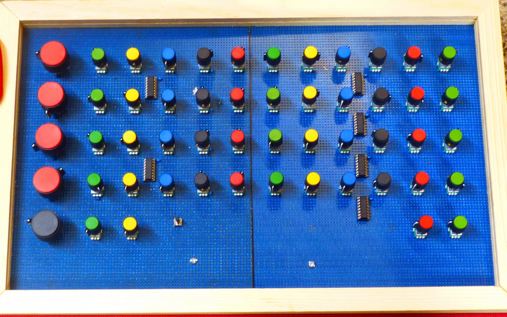

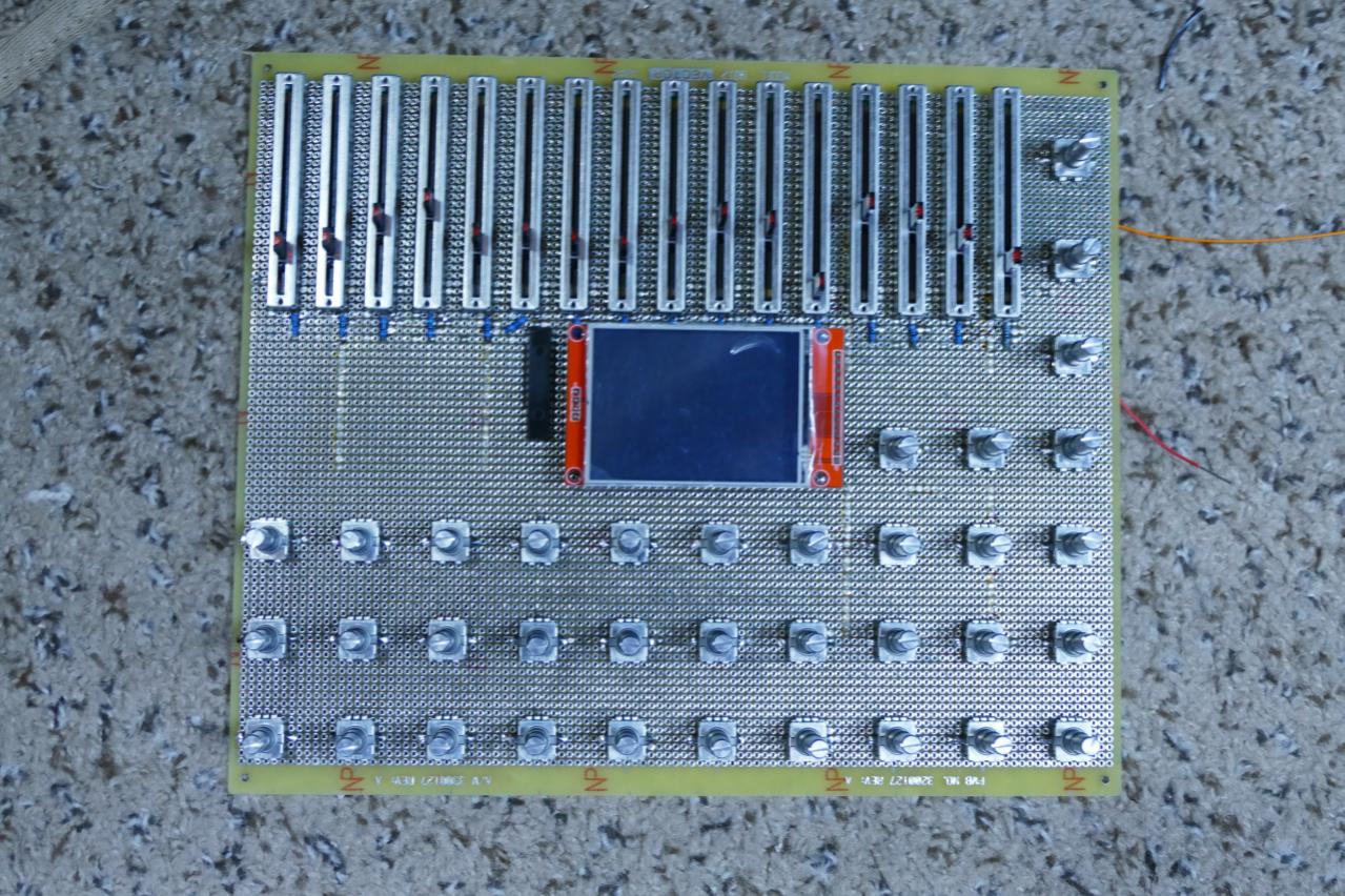

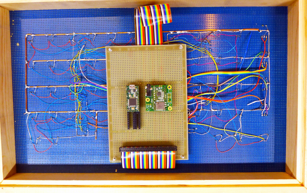

So I put the old synth back together as is, (pictures) since it works just fine, and decided to make something cool with the new T4.1 board.
What do I make...….Well, I'm not exactly sure, but I'm making it up as I go along, sorta like the last one. I dig through my boxes of "stuff" and find some cool slide pots with LED's on them....they're cool, so they go in. I have LOTS of encoders, so we need some of them. I have a big piece of perf board with solder pads, it has been used twice, but is in the "box of shattered dreams" so it gets recycled again....I see a small color touch screen display, so in it goes...…..I still don't know what this will be yet, but with 36 knobs, 16 slide pots, a touch screen display, 8 X 44/16 DAC's, 6 X 44/16 ADC's, and a 32 bit processor running at 600 MHz (overclockable to 1 GHz), it can be anything it wants to be (picture)...….probably a MIDI sequencer since I could use one.
Now, how do I connect 36 rotary encoders to a processor chip. My first thought was to multiplex them all since you only have two hands so only two will be turned at once, and the chip can sample much faster than the knobs can be turned, but some Google searching led me to some new PIC chips that cost less than the multiplexer chips, and could do all sorts of neat other stuff too.
There are PIC chips that have up to three NCO's inside. A NCO is a Numerically Controlled Oscillator, signal generation technology with microhertz resolution usually found in pricey DDS chips. These chips have the ability to modulate one waveform with another. There are all sorts of timing features built in.....but the reason to Paypal some $$$ to Digikey turned out to be the under $2 per chip price and the availability in breadboard friendly DIP packages. So I got 5 X each of 3 different cheap chips, and a programmer.
I guess my new board will be a synthesizer.....or a sequencer.....or a mixing board....or......Wait, it can be ALL of these....with a guitar jack too!
