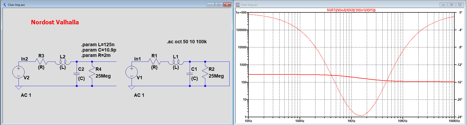

See the example below for 1 and for 10 elements with the calculation Zo=sqrt(Zopen*Zshort). There is absolutely no difference between the two.
Facts are facts, and there is no way to argue with them.
Cascading is a robust proof of the validity of a model, and if it passes it with flying colors, then it has to be right, and I gracefully accept it.
That said, this cable has a transition zone situated at a much higher frequency, >60kHz. The previous examples were around 2.5kHz, and since I didn't see that transition, I assumed the model was wrong.
Performing a similar cascading test on these examples should show a transition zone at ~2.5kHz. With the 100kHz limit, the 60kHz region is not very visible.
There is another unexplained oddity in one of the previous models: the phase doesn't tend towards -45° as it should.

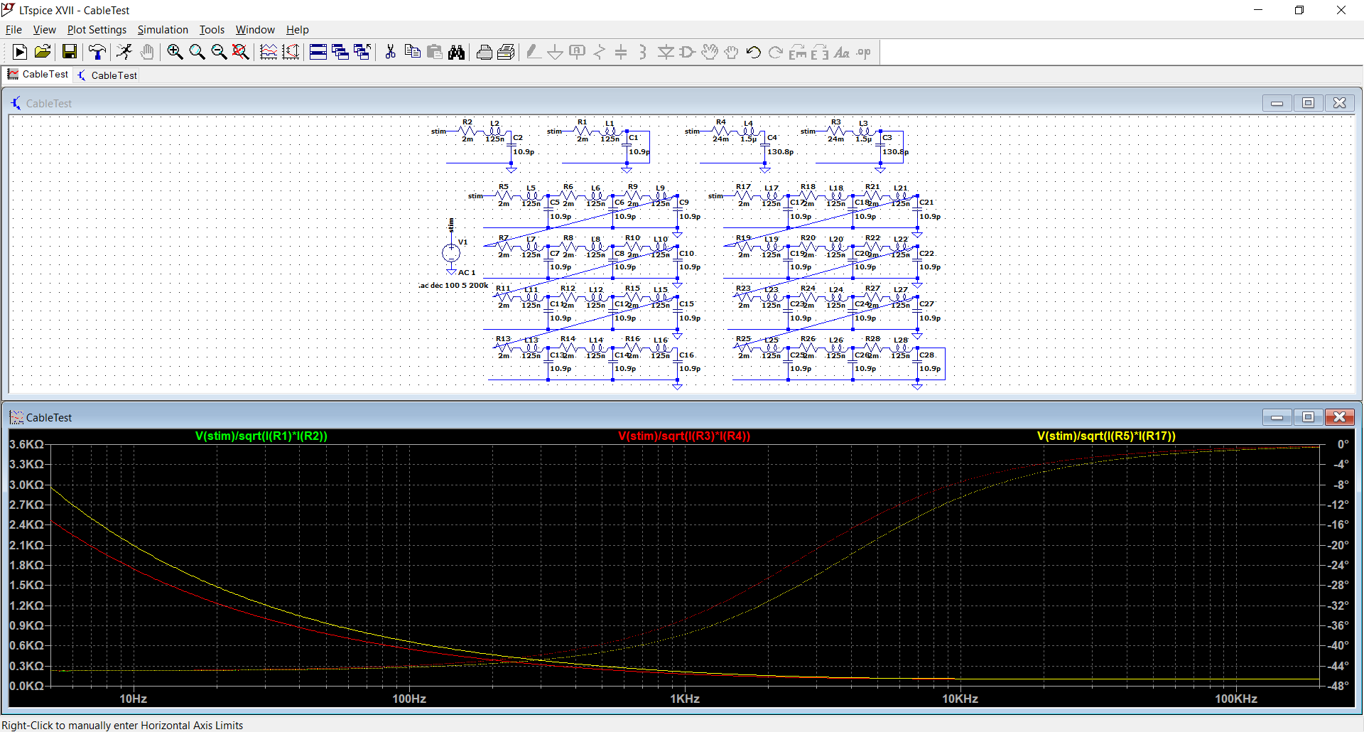

Although the simplified model holds much better than I would have expected, a strange quirk remains: the result from this cable is aberrant:
895375d1605966395-analysis-speaker-cables-townshend3-jpg
The phase is not right (it should be -45° when F tends to zero), and the magnitude is also too low.
This could mean that hidden parallel conductances have been added somewhere, which is a (lossy) method to keep the impedance flat under the transition frequency.
In my sim, with ideal components, the behaviour sticks to the theory.
The green (1 section) and yellow (12 sections) traces are completely undistinguishable, which is normal if the Zo is correctly extracted from a single cell, and the red trace is a model using a larger lump: all components times 12.
attachment.php
It is slightly different, which is to be expected, but all the curves tend to infinity and -45° when F tends to zero.
The transition around 2.5kHz is also visible.
This is the normal behaviour for a regular TL. If a difference shows, it has to be a hidden parasitic parallel conductance parameter in the elements

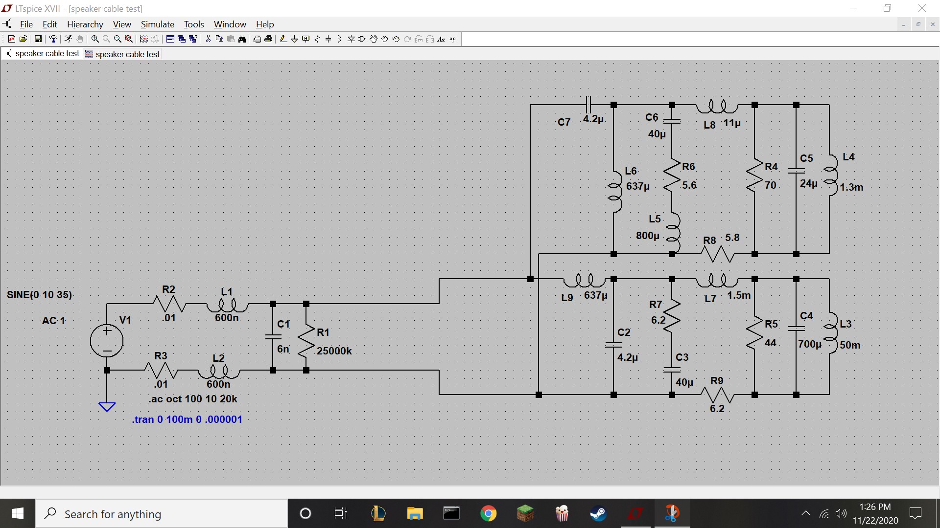

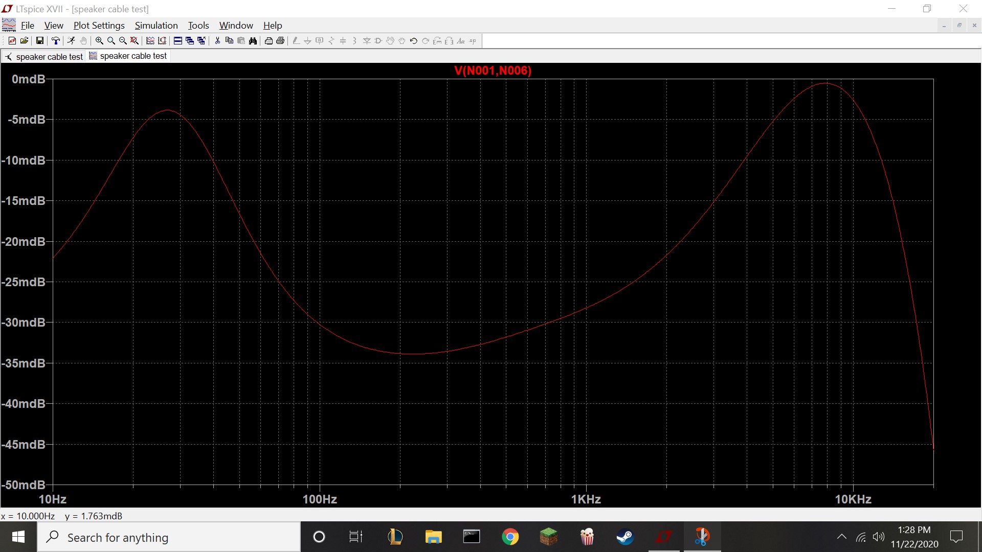

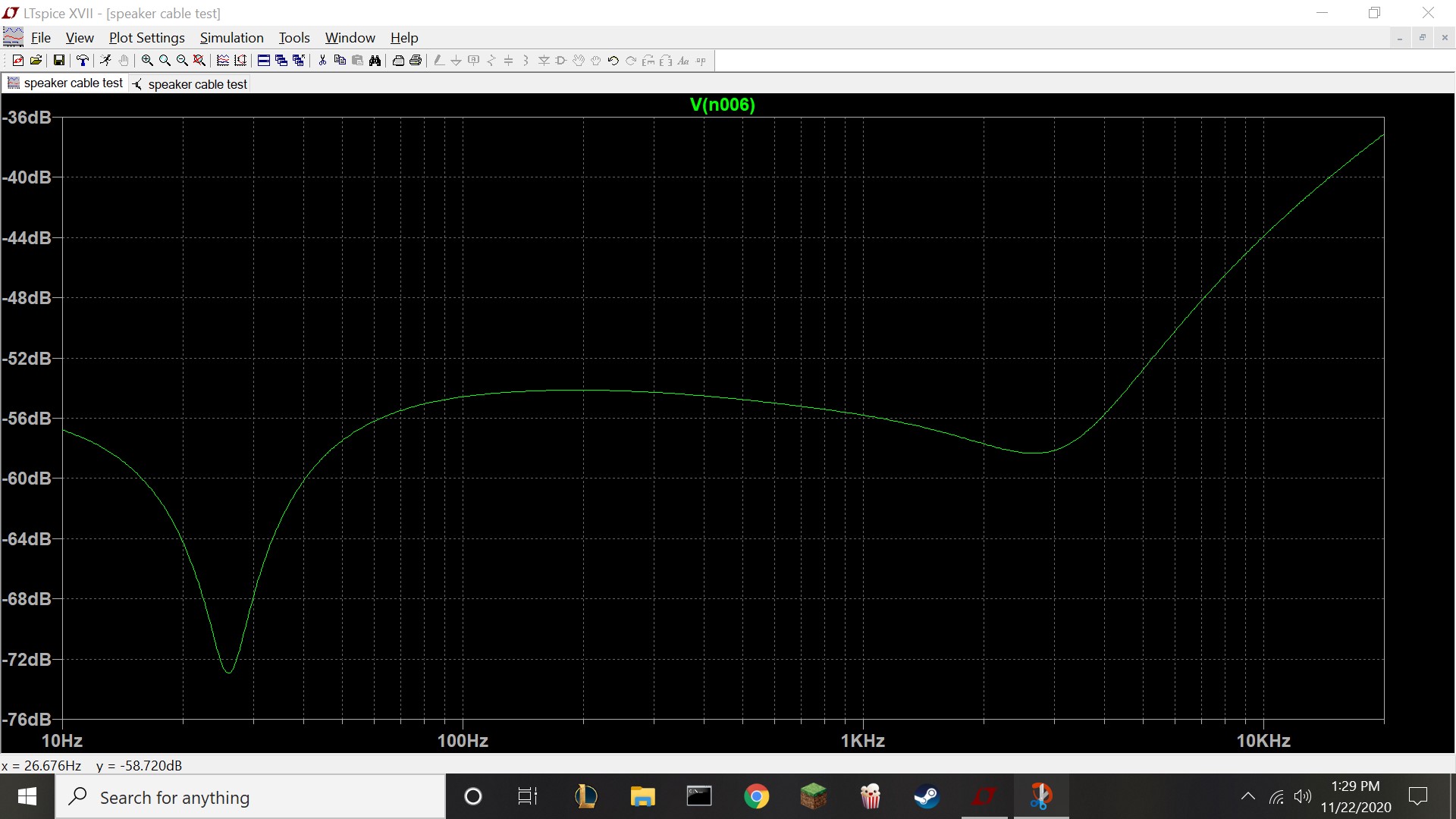

Heres some sims. Used Hans's cable model and a generic speaker model that was handy. The first one is there test, the voltage at the speaker negative. It does not look like there graph and the level is -60db. How did they fudge that? The second is what they should have measured, the error voltage, the voltage difference between the amp and the speaker terminal. As expected the freq variation is less than .05db but the audio they submit has 10db variation. Hard to call it a fudge when its a straight up lie. I feel like posting this in BS auodi comments but Im sure thell erase it instanly.
