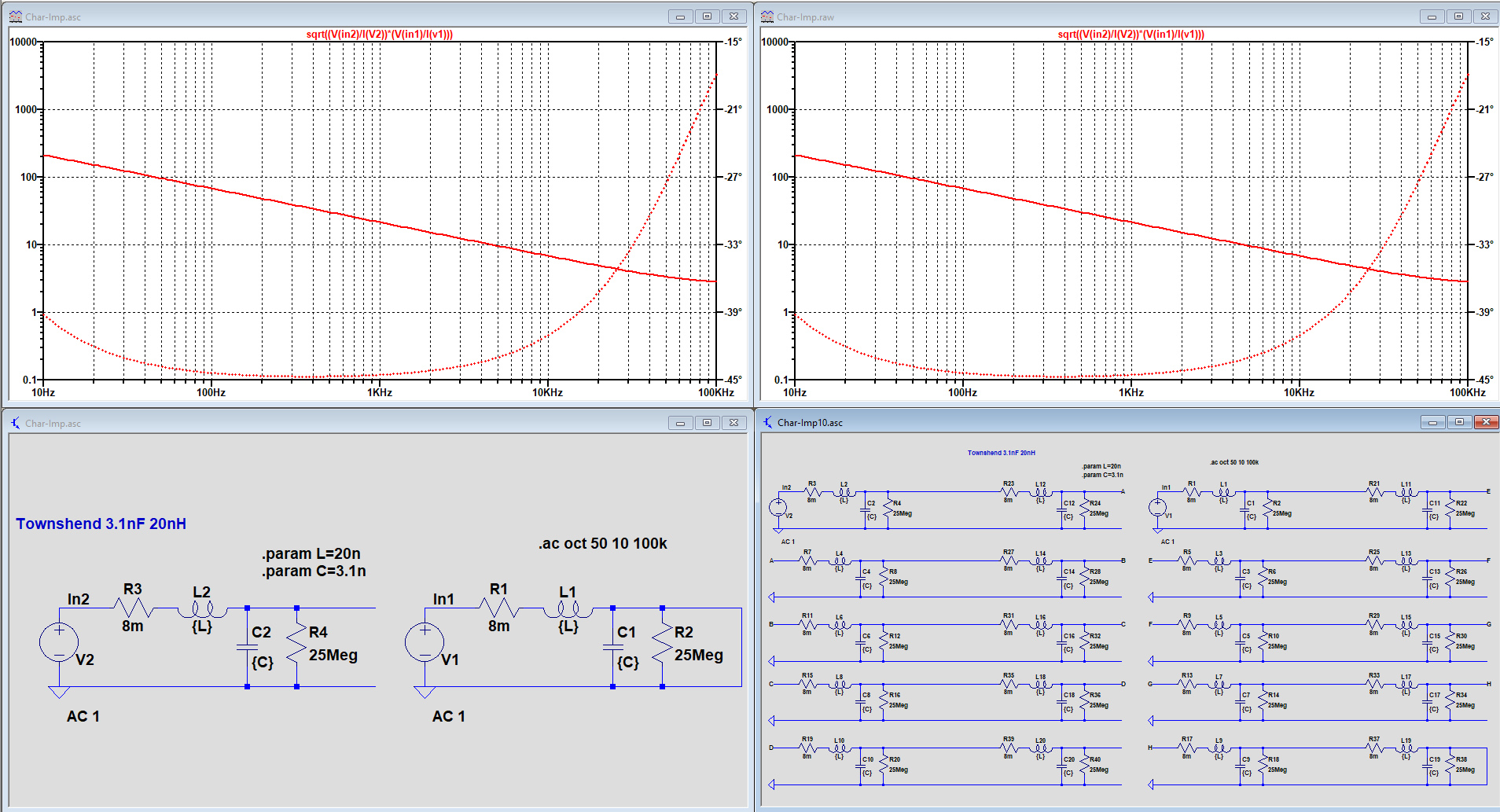

Using a single LC pair in an analysis is not the same as TL, as Elvee points out. Increasing the number of elements eventually gets the model to stabilize. IIRC, Cyrus used 200.
If a step input is pushed through a single LC model, the slew rate is limited by the inductance feeding a capacitance. As the number of elements increases in the model, the step response will approach reality. If the line and load match, the step response at the load will be identical to the amp output, just delayed a very small bit.
If the load is much lower than the line, the line has to magnetically charge, requiring many transits of the signal.

Well, using a step is a completely different way of finding the Char. Imp. Zo, but that was not at all what that I did.
When using the AC analysis, it makes no difference whether you take one element or N.
See the example below for 1 and for 10 elements with the calculation Zo=sqrt(Zopen*Zshort). There is absolutely no difference between the two.

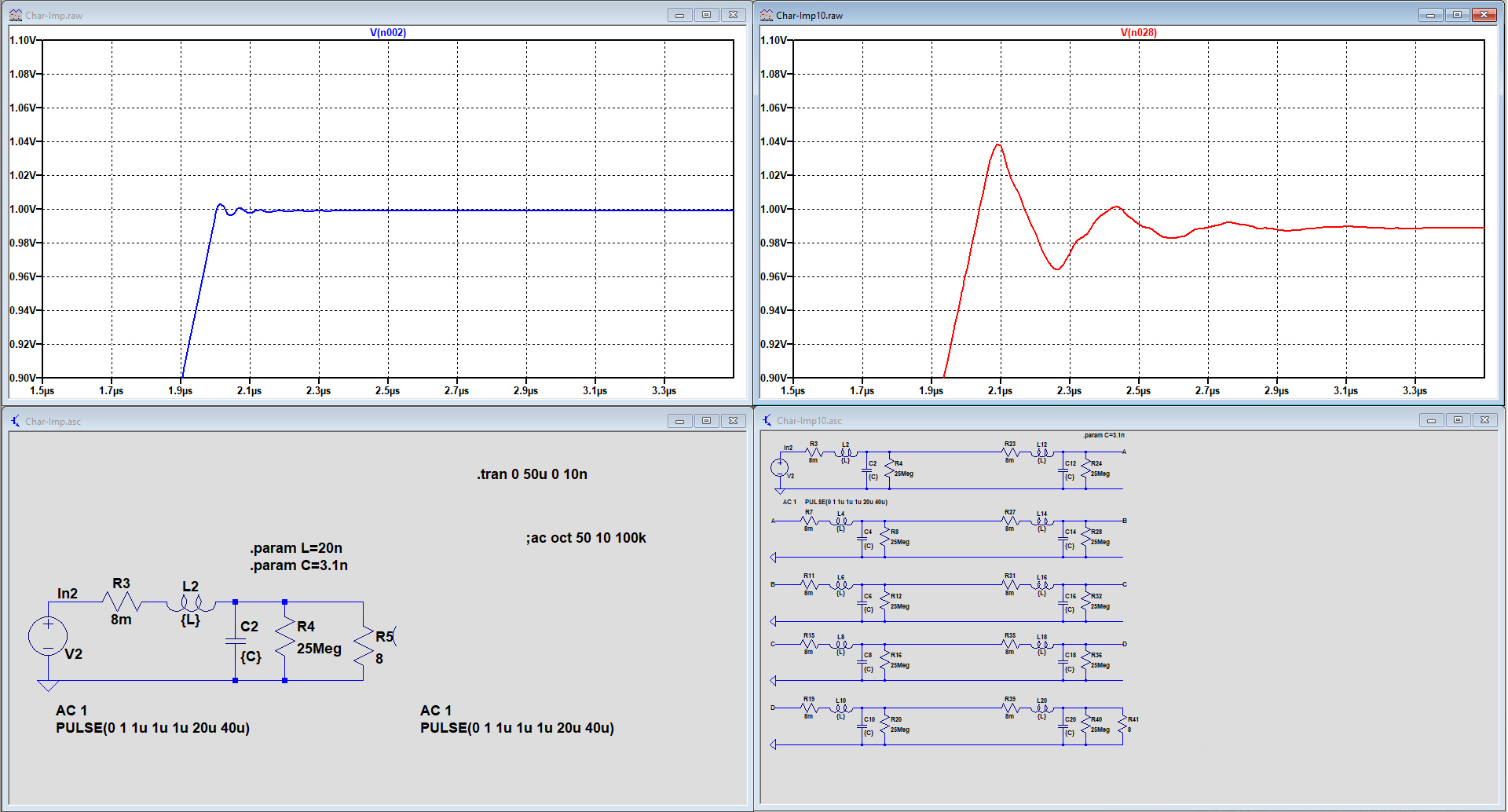

Now look at the second image where a 1V square wave is offered to resp 1 and 10 segments of the Townshend cable, here terminated with 8R.
Now you see a large difference in overshoot and settling between the two.
When trying to find the the Char Imp with this Step method, you will indeed have to cascade many elements, I would not have argued against that.
But to avoid all that, that's why I used the much more convenient way to determine Zo.
