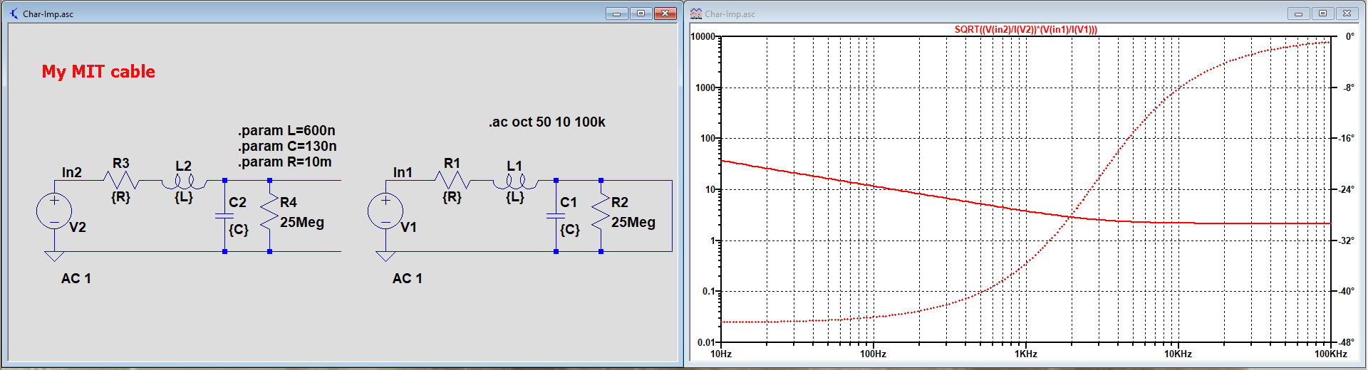

Just out of curiosity, I measured my speaker cables and plotted the characteristic impedance just like I did for the Townshend cable.
Capacity and resistance values are quite accurate, but inductance might be a bit less accurate.
But as a first indication, it comes even closer to the Zo = 8R than the Townshend cable.

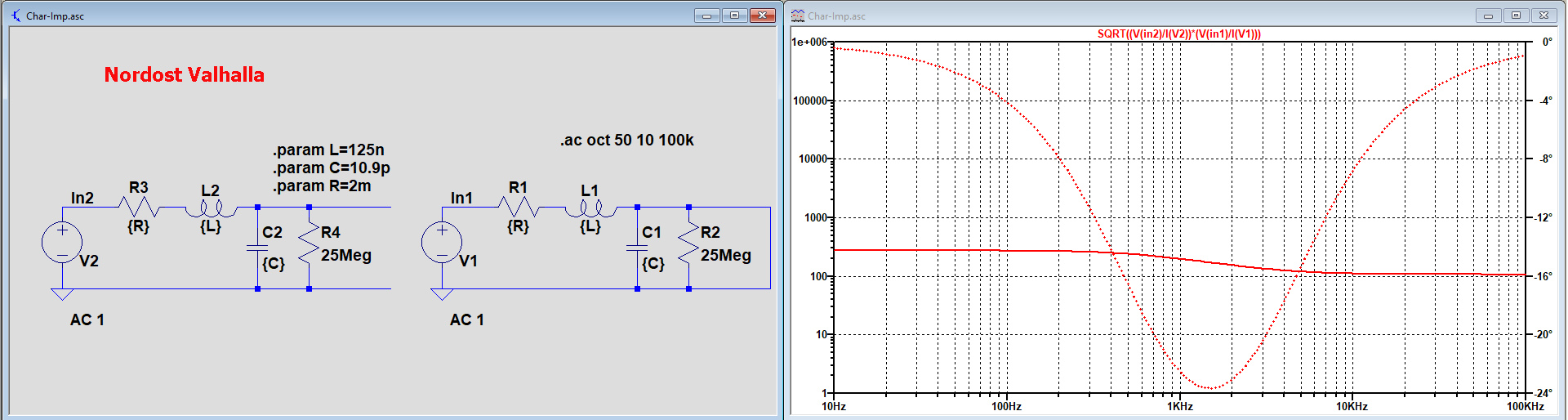

Then I made a Sim of the very expensive but highly praised Nordost Valhalla LS cable.
This one doesn't even come close to the Zo = 8R, but it's impedance is remarkably flat.
So to conclude, I don't think there is enough evidence that the characteristic impedance theory is the holy grail to explain sound differences.

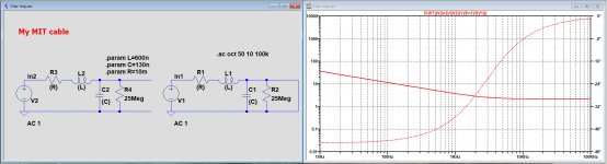

Estimating the characteristic impedance from a single LRC section is completely wrong at low frequencies..Just out of curiosity, I measured my speaker cables and plotted the characteristic impedance
To do that, you would need to cascade hundreds of elementary sections, and the result would be completely different.
Basically, below the Zo cutoff frequency, Zo increases (up to infinity at very low frequencies), and tends to adopt a 45°, capacitive phase.
The cutoff frequency is R/(2*Pi*L), R and L being the lineic parameters, and is around 2.5kHz for the two examples provided.
At lower frequencies, the magnitude will become increasingly large.
The situation is somewhat complicated by the inductance variation effects hinted by JN, but they are relatively minor and will further increase the LF Zo
I’m always getting a bit irritated by postings that are talkings things into the ground without any evidence or mathematical prove to substantiate.
And yes, JN is right that L and C may vary but within the audio range I don’t expect large deviations.
Zo = sqrt(Zopen*Zshort) is a mathematical correct expression.
So despite of a limited variation in L and C, it’s good enough to prove that the Townshend claims are to be taken with very big corns of salt.
Hans
Hans
The expression is perfectly correct from a mathematical POV, but like any tool it has to be used in a proper and meaningful context.Zo = sqrt(Zopen*Zshort) is a mathematical correct expression.
A way to check the validity of your model is to apply your (perfectly correct) formula to a different number of sections, in your case it can only be >1.
If the formula actually yields a characteristic impedance (in the transmisssion lines theory context), you can cascade any number of sections and still get the same result.
This can be done by just multiplying your initial cell by n, in which case the LF value will become increasingly accurate, or you can split the lineic components into smaller parts, which will increase the HF accuracy of the model.
Ideally, if you want a good overall accuracy from LF to HF, you need to do both: increase the granularity and the total simulated length.
With your sim, you can just cascade sections from 1 to n and see that the LF characteristic impedance increases, and the phase tends to 45°.
If you have a sufficient number of sections, the transition from a flat, resistive impedance will happen at ~2.5kHz.
Lumped models are always approximations of distributed systems, and with the lump=1, you have to expect the crudest approximation possible.
In an audio context, the concept of characteristic impedance should generally be avoided, because it is highly misleading (it does exists, and has a meaning, but it is certainly not the one most people think it is)
A reference to some authoritive paper would be welcome.The expression is perfectly correct from a mathematical POV, but like any tool it has to be used in a proper and meaningful context.

Sorry, it originates from French :lineic - WiktionaryP.S. Even Wiki doesn’t know what a lineic compoment is.
It just means a parameter (inductance, capacitance, resistance or whatever) per unit of length.
Anyway, the best way to test the validity of your model is to cascade a number of sections: Zo should remain invariant whether you have 1, 10, 100 or more sections.
Ultimately, if you cascade enough sections, you do not even need to go through the sqrt(....) etc: just plot Vin/Iin, it will yield the Zo for an infinite TL
