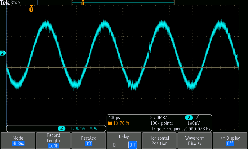

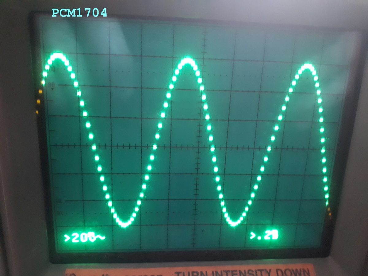

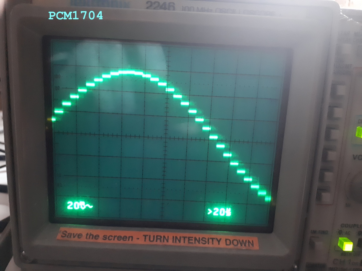

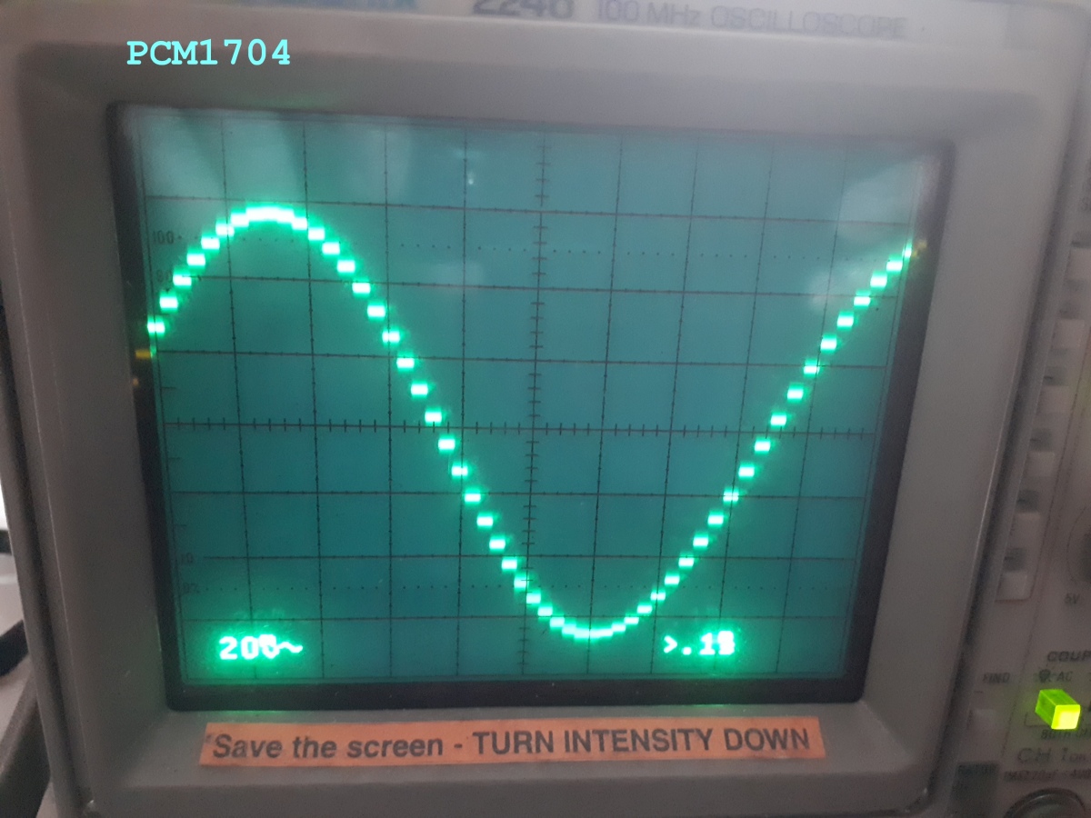

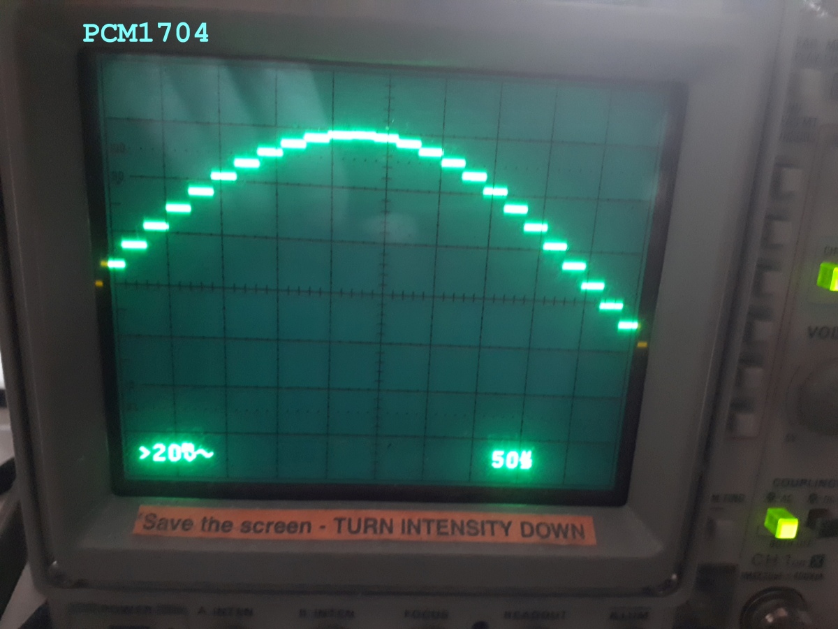

This is pcm1704, posted here Denafrips discrete R2R Multibit
As promised by Ds yes on zero zone no glitches, how about other levels?

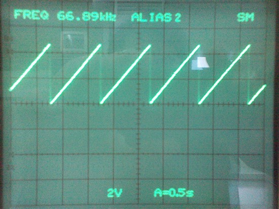

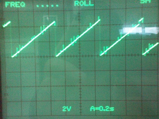

A fellow on e2e ti support forum was complaining for glitches
https://e2e.ti.com/support/data-converters/f/73/t/240050

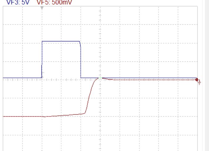

The expert advised nothing but RC filter. The guy used bit banging and here is the result,
before and after.
Bit banging is to emulate a hardware by software. How on earth he programed the emulator?

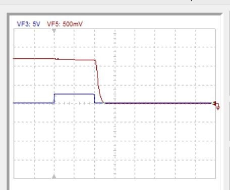

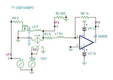

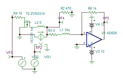

The hike in hold was due to spice model defect of 2n7000. With ZVN3310, not suitable, has near perfect function.
The current sample and hold got invented. How strange that since 4 decades people are struggling to eliminate glitches and no one has thought about such simple solution.
The circuit with opamp.
The right switching mosfet is from TI csd15380.
It S/H both polarities.
Bellow is -1.2ma sampled and hold.

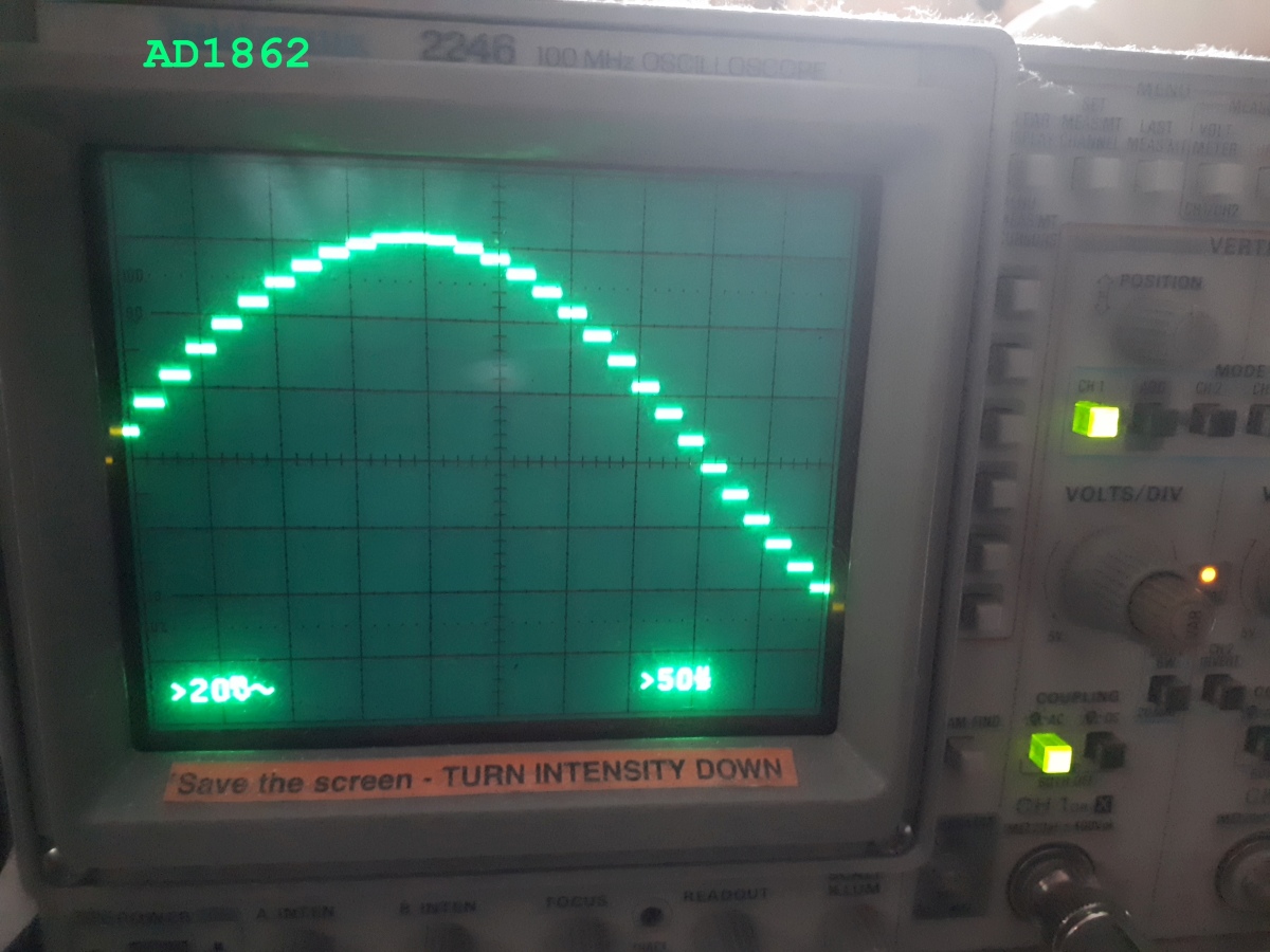

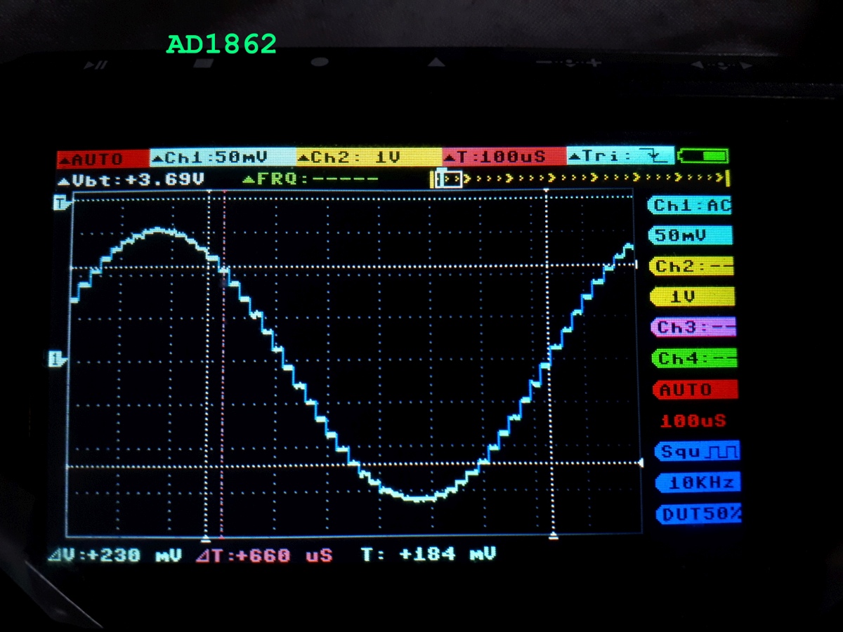

The glitch is neglitible, it is on 1mV scale.

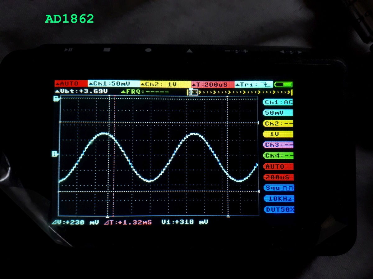

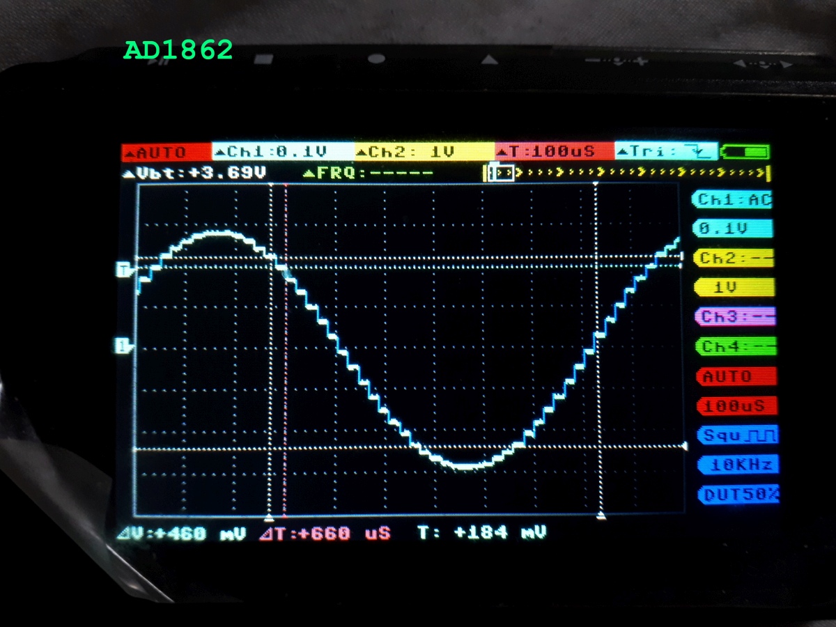

I have not that pro scope.

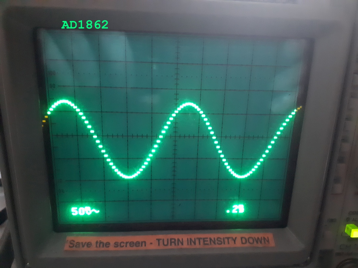

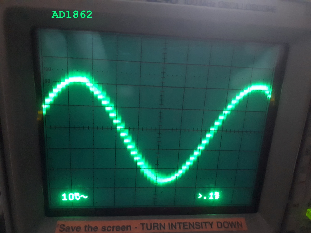

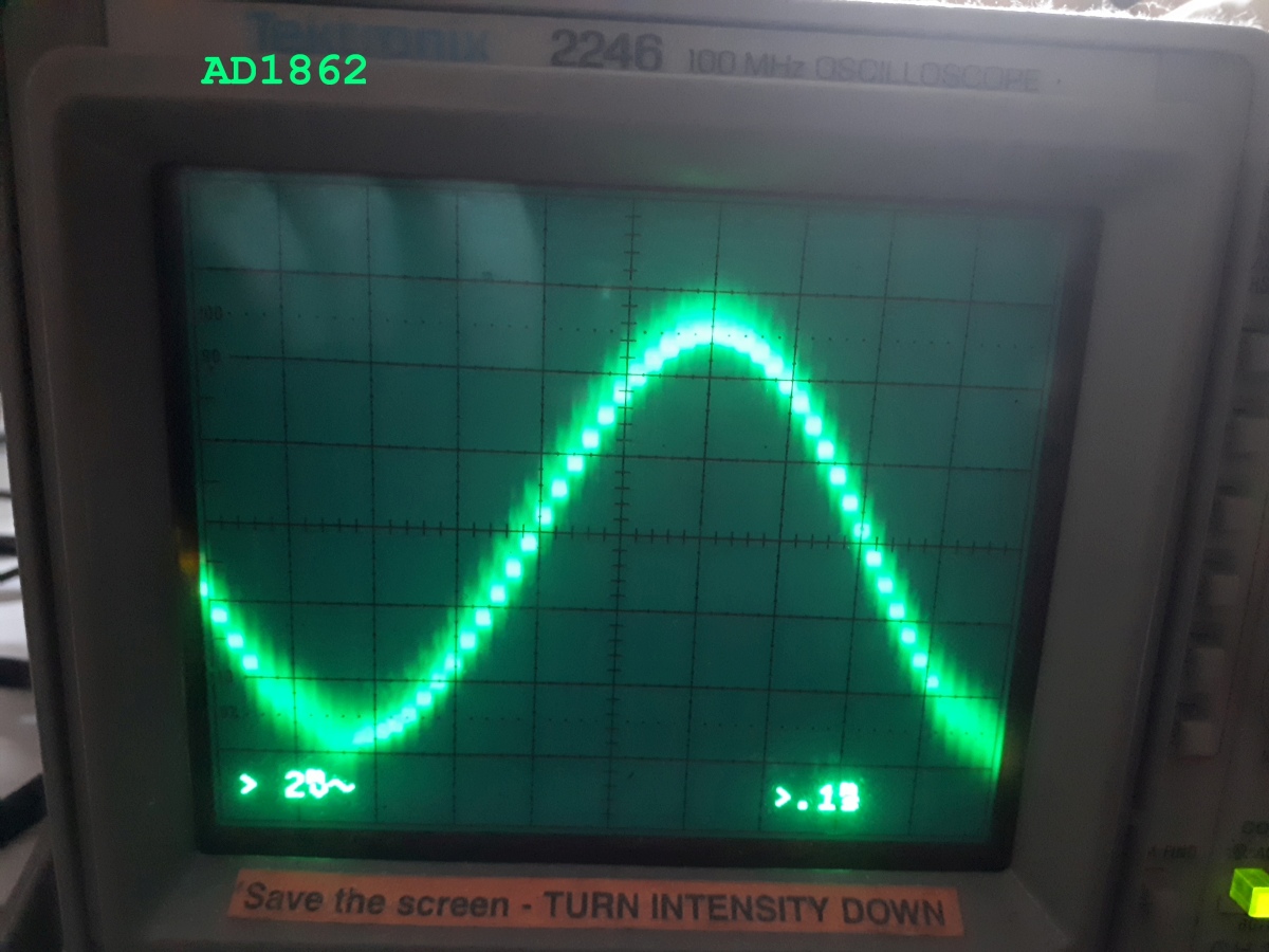

here is the AD1862
For a signal level -60db, that is 2.8mv peak, if you want to have a modest distortion + noise of 0.1% than the error you should see must not be more than 2.8uv peak!

I tried a standard R-2R network in the past, feeded by 2s complement data and the glitch was huge, great visible on 1V scale, sometimes over 100mV ... Such glitches are well audible during normal listening 😀
I was looking for an audible glitch at lowest volume on headphones in PCM1704 and AD1862 (even other dacs like AD1865, PCM1702, PCM63, ...) and I didn't hear a tiny sign of that. If an output filter is added on the output, the sound will be modified/colored. Try to create the most transparent filter possible.

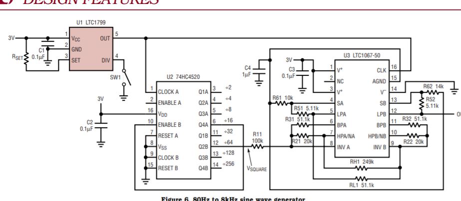

sin wave generator for frequency shifter
The high frequency above 10khz treatment needs to heterodyne the data signal multiplying with a clean sin wave of 44.1 or 48khz, in phase with the sample clock WRCK.

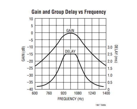

To generate such synchronous wave, I will filter the WRCK with a capacitor switched filter that its clock frequency makes the characteristic frequencies to vary, the LTC1067-50
Plan A is to use a sin generator application where the filter notches the 3rd harmonic of the input square wave and the other harmonics submit to low pass.
The problem to see if the phase remains the same for both 22.05&24khz.
Plan B is to use a high Q band pass filter with linear phase.
Luckily the approximate spice model comes in LTspice to see the results.

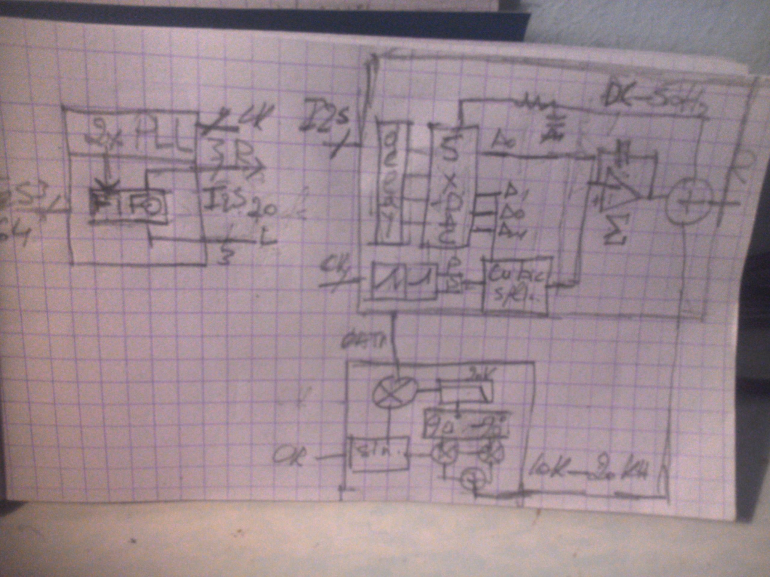

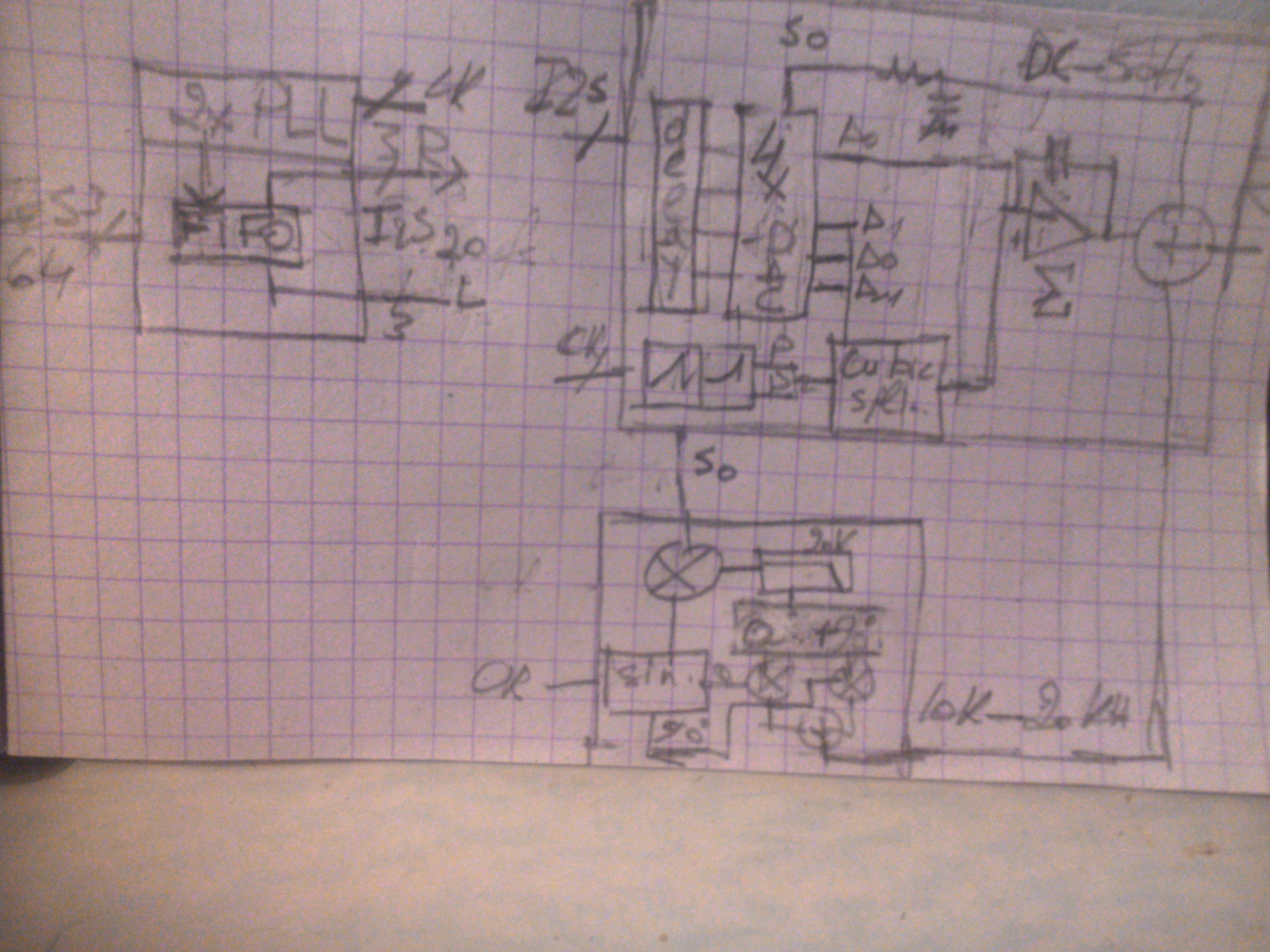

This the block diagram of second round.
It consist of 4 PCBs.
1x Sync. I2S 64/32fs to 2xPCM 20fs + several clock generator by double PLL.
2x Digital analog converter + mixer.
1x 2channel SSB (single side band) generator 10k-20khz.
The D/A has 3 sample delays feeding 5 DACs, 4 of which, to generate 3 deltas (difference between 2 samples) and a 5th to add DC to 50hz at the output mixer. An analog clock generates ramp P + its square P2. The 3 deltas and the two Ps enter the analog calculator to create the interpolating additive delta.
The integrator sigma recreates back the signal from 50hz to 10khz.
The SSB has a sin wave converter which shift the frequency of the data, 20khz becomes 2khz and 10khz becomes 12khz with 44.1 sample rate. The result passes through a Quadrant phase shifter after being filtered above 20khz. The two quadrants are re shifted and additioned to generate 10k to 20khz image less signals to be mixed at the output.
I made some errors. The DC-50hz doesn't need a separate DAC, The S₀ DAC I/V output can be used for this purpose after amplifying. The SSB doesn't require the data but the same S₀.
I forgot also that the SSB Hartley modulator needs two 90° phase carriers, but should they be sin waves or square waves can, although I tried it out on simulator.
In fact, the SSB will be my next attention.
