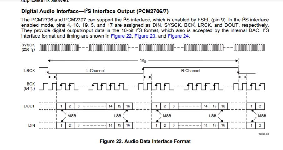

I2S is a Philips standard that to my knowledge 96k 24bit has 48 BCK. this makes 4.5Mhz. Am I wrong? Running the MC at 12v along level shifters, should be enough.
I am looking for a small FIFO to write in 48bit rate but read in 32. By this the DAC doesn't see 12clock bit stopped, and the max ck becomes 3.1Mhz.

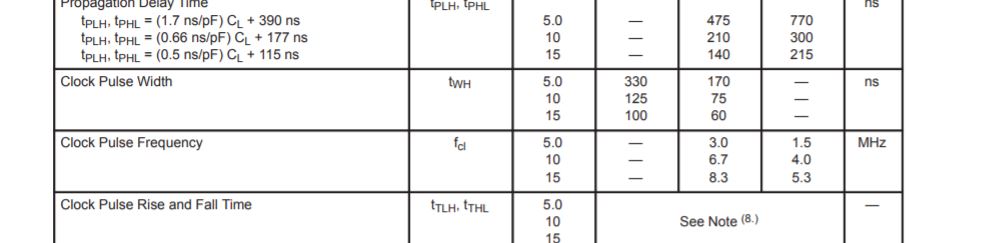

I am here really only trying to help you. I asked you for the specific I2S source, because almost any I2S source on the market outputs the data in 64-Bit samples (stereo), in which 16 or 24 bit can fit and the rest bits are zero. This is how the shift registers in my DAC are working and I simulated it here in Quartus. I2S sim
As Marcel said, your "1970's CMOS logic" ... it can safely handle only 5.3 MHz at 15V supply 😱. Your 8.3 MHz is potential performance and not intended for design purposes (as a Designer you should know this). Not me, but the datasheet says that: "Data labelled “Typ” is not to be used for design purposes but is intended as an indication of the IC’s potential performance. "
Now if you calculate 96kHz sample (1 LRCK clock), the BCK speed will be 64 x 96000 = 6.144 MHz. So it can easily happens, that many bits will be skipped and the result of the recording will be popped. Perhaps you can find/create an I2S source with 32-Bit word (stereo, 2x16), but it can be a programming challenge for you.
Another challenge with 15V supply logic is the voltage input and output compatibility (how to balance different voltage levels).

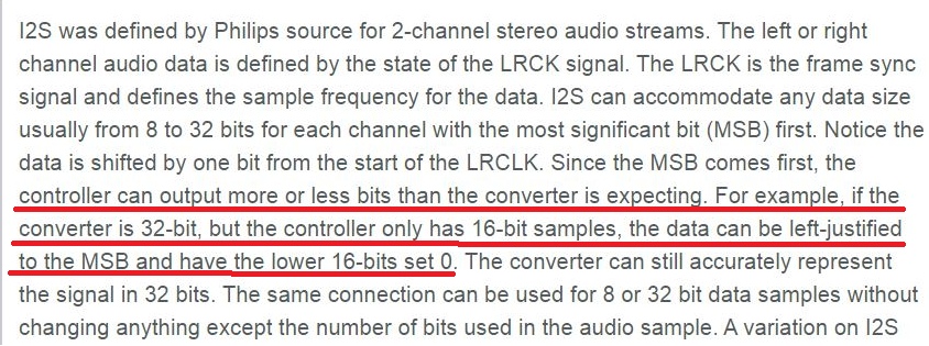

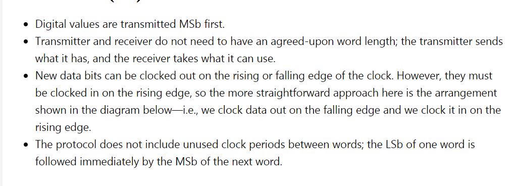

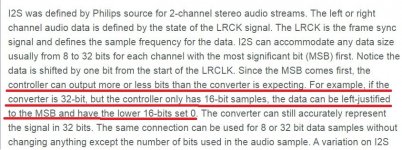

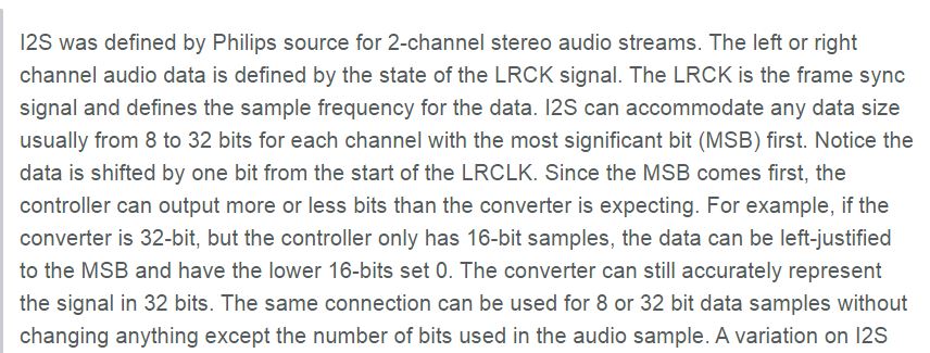

I have always seen a 16bit word I2C to be 32bit never have seen 64. The document of I 2C that what says 8bit to 32bit each channel variable and not fix. This is why it is left justify so that the one which is 8bit, collects the first 8 highest bits and goes deaf until the end LRCK even what is following higher definition bits are still pouring.
May be an expert as abraxalito can shed some light on it.
Read the original I2S bus specification from philips:
"When the system word length is greater than the transmitter word
length, the word is truncated (least significant data bits are set to ‘0’)
for data transmission."
"If the MSB follows immediately the LSB, this means 16bit/channel is 32bit."
ee ... there is technically only one MSB and the rest is LSB
64-bit word >> 2x32 bit >> 2x (16a+16b) where 16a is DATA with MSB first and 16b are zero (which can be considered as LSB).
Why don't you take a digital analyzer and look at that I2S data? I did it a few times.
You will spend hours on the wrong design with thinking that BCK frequency is not constant for 16b and 24b recordings in the same LRCK.
How cares what data is truncated and not transmitted.
If the MSB must immediatly follow the LSB of the precedent than you need to delay only one word length to make the two channels simultaneous, 16 or 24 to be selected.
If you have observed the data on scope, than 2×16bit data in 64bit format should see half of the time flat zero, is it the case.
I have seen fix 32bit×2 I2S from asynchronous SRC outputs for any input data length. This what you need to make your DAC work properly.
Or else it will sample the 16bits of right channel, fill with 4 highest bits of the left channel in the 4 lower bits mixing the two channels and repeat to other channel exactly the same copy but 1fs delayed by 32bit shift register.
"I have seen fix 32bit×2 I2S from asynchronous SRC outputs for any input data length. This what you need to make your DAC work properly."
And exactly this is how the most I2S sources are created, with the fixed word (64b is the most common, ... 128, 48, 32 is rare or perhaps selectable in a device). The shift register in my DAC is universal for 16b and 24b recordings (thanks to fixed word length from almost any I2S sources - 64b ... both channels are working correctly - recordings can be audible only in the left channel or only in the right channel - so nothing is mixed).
The question still be what is your I2S source with the 32b word length for 16b recordings or 48b for 24b recordings?

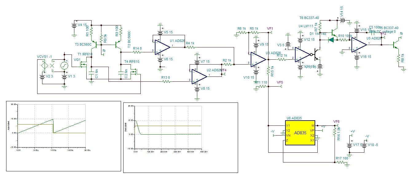

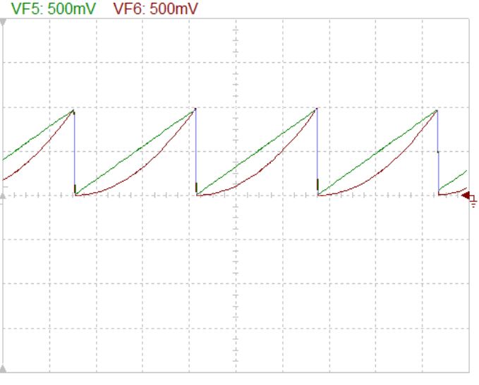

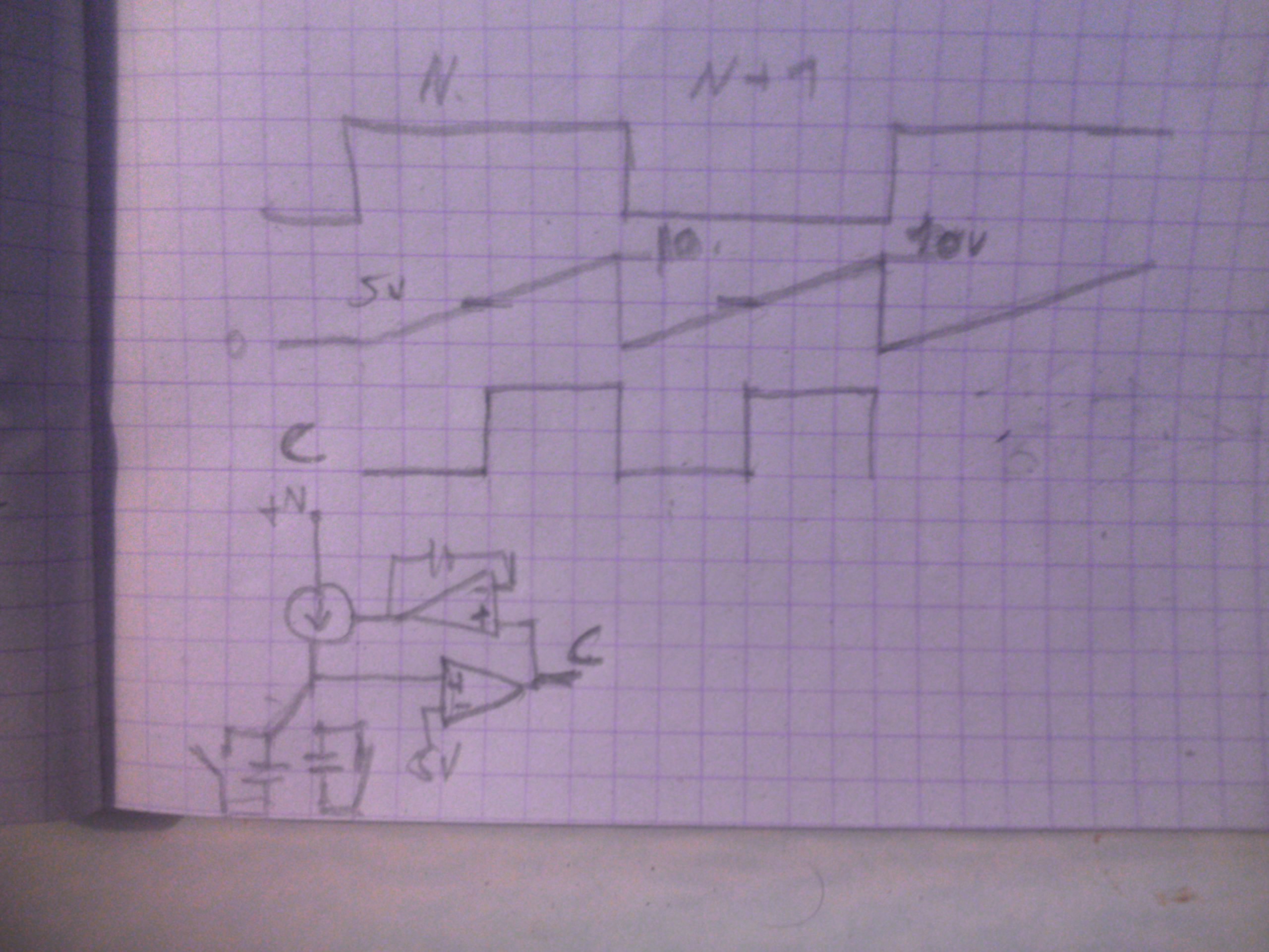

The Ramp Generator.
The ramp generator is the chief orchestra of the interpolator. When it is zero volt at start, the resulting output of the DAC should be the actual sampled voltage, that is nothing should be add. when it reaches 10V the output has gradually interpolated to the next sampled value.
I said 10V and not 1V, because the AD633 multipliers divide the product by 10.
The great challenge, is to have the ramp extremely sharp zero return ready for next sample. Another problem is that my fs is variable to be 44.1khz, 44khz, 96khz, at all speeds the ramp must reach 10V precise at the end of the fs cycle.
The first approach I have for the fast zero return is to use matched pair of capacitors switched alternately charged by a current source. By this when one is charging the other is discharging by shorting switch to be ready for the relay.
To adjust automatically the ramp slope, a comparator looks the ramp comparing to the mid cycle value, 5V. If the ramp is perfect reaching 10V at the end, than the duty cycle of the comparator is exactly 50%. If it is to end higher or lower, the duty cycle is measured by an integrator to feedback the current source and bring it to 50%.
attachment.php

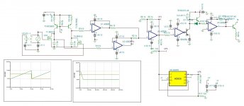

This is the interpolating analog clock generator. It generates a ramp always equal to 1v peak at any input fs frequency as well as the square function of the ramp. In the interpolating formula they are P and P2.
The function is nearly what is described in precedent post except that the capacitors aren't switched but each has its own current source and the two alternating ramps are simply added. It returns to zero in 50ns mainly delayed the opamps but there is still margin as the DAC analog outputs settle in 200ns. The discharging mosfets are arbitrary here, ssm3sk339 in in my mind.
The AD633 low cost multiplier was too slow in zero return and too noisy NF1uv, so I replaced with AD835 200Mhz NF50nv. Unlike the AD633 with fix 1/10 output multiplier, the AD835 is adjustable, so I brought both clocks to 1Vp.
Now all the variables and parameters are ready to form the analog cubic spline calculator.

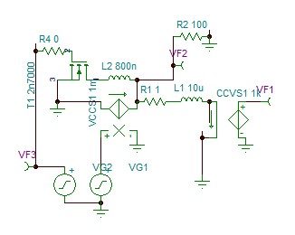

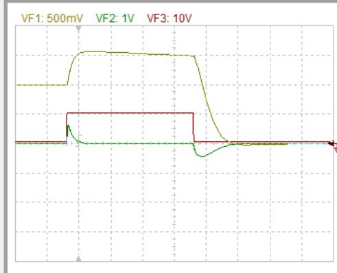

Why complicate it with deglitching, PCM1702 is considered as glitch-free due to sign-magnitude architecture, ... finding or creating a low THD analog switch for voltage out hold circuitry is hard, because switch has own THD. Controlling the switch with slowed LRCK can increase jitter problem.
To maintain a current for only 200ns, an inductor should be sufficient, I said to myself.
I made a quick modeling to see the theory in action.
attachment.php
The CCVS simulated the I/V converter 1V/1ma, the current generator was pouring 1ma when it shut off to 0ma. The 200ns following pulse shorts the generator to let the 10uH inductor continue pouring 1ma.
attachment.php
It looks promising, I need to understand why the inductor passes more current in hold time than the sampled one. If I add a gate stopper, the hike increases! strange isn't it.
