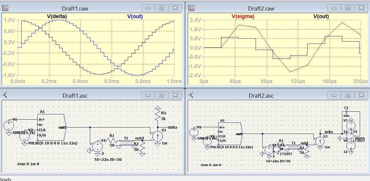

What is Delta-Sigma? In quantified math is the same as derivative-integral in linear math. In electronics with limited frequency is simply high pass-low pass. The most known is the recording-playback RIAA curve. As on records the high frequencies which have much smaller amplitudes than the lowers, physically the groove will contain very little information about high frequencies, besides the hiss of the stylus friction noise. If the signal is recorded with the derivative function, the high frequencies are better described and on the playback the integrator cleans the hiss of the stylus bringing back the initial spectrum.
This is to be applied on the DAC to eliminate noises created by switching spikes internal R2R noise and due to step character of the analog converted signal.
The Delta hence is the difference in level between the actual and the preceding sample. I only need to delay the signal one clock and subtract with the actual and I get the derivative function
attachment.php

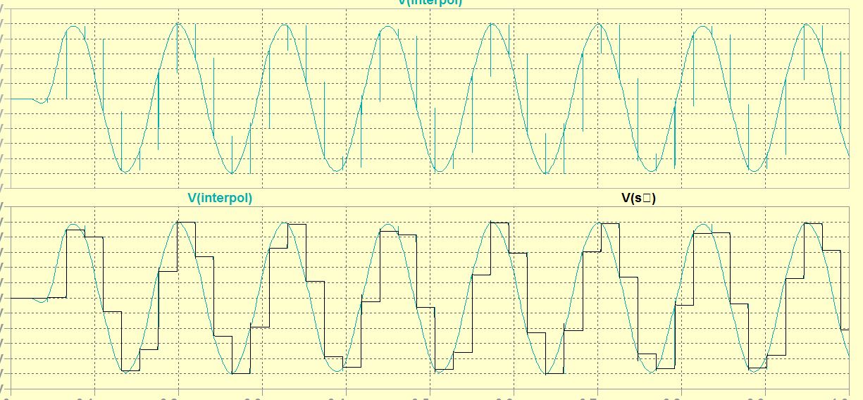

The left circuit shows this, the signal from the sampler 44khz is delayed 22us and the subtracted signal now is a cosine derivative of the input.
Now, if I integrate back the signal all the DAC noises will be attenuated and the step cosine will become ramped sine wave. The signal with 1khz becomes too clean sinusoidal , I increased to 8khz to be compared with the step wave. You can remark that very little filtering is necessary.
All is not bright, instead of sigma (accumulating discreet values) as I integrated it, the high frequency information in step is eliminated and the DAC has -3db response about 11khz. Band pass filter might re equalize but the lost information is not valuable, better can be done by interpolation that I explain in few.
To remark that the Delta is described with double precision than the signal occupying 17 bits.

This circuit has nothing to do with delta modulator. Instead of transforming the 16bit data into analog, the delta is transformed into analog and integrated. In fact the delay is made of 64bit shift register MC14517 and feeds inverted to a second DAC TDA1387 whose output current is tied with the first TDA1387 which receives the direct data. The delta is obtained at the current node to feed an integrator.
The circuits of post #1 also have absolutely nothing to do with delta-sigma (or sigma-delta) modulation. They consist of a DAC followed by filters. If I understand post #9, you have actually implemented the delay digitally and used a kind of FIRDAC structure to make the first filter.
The analogy with delta modulation and with DPCM is that at the output of the first filter, you have a discrete-valued signal (with lots of possible values, but still discrete) that depends on the changes in the input signal.

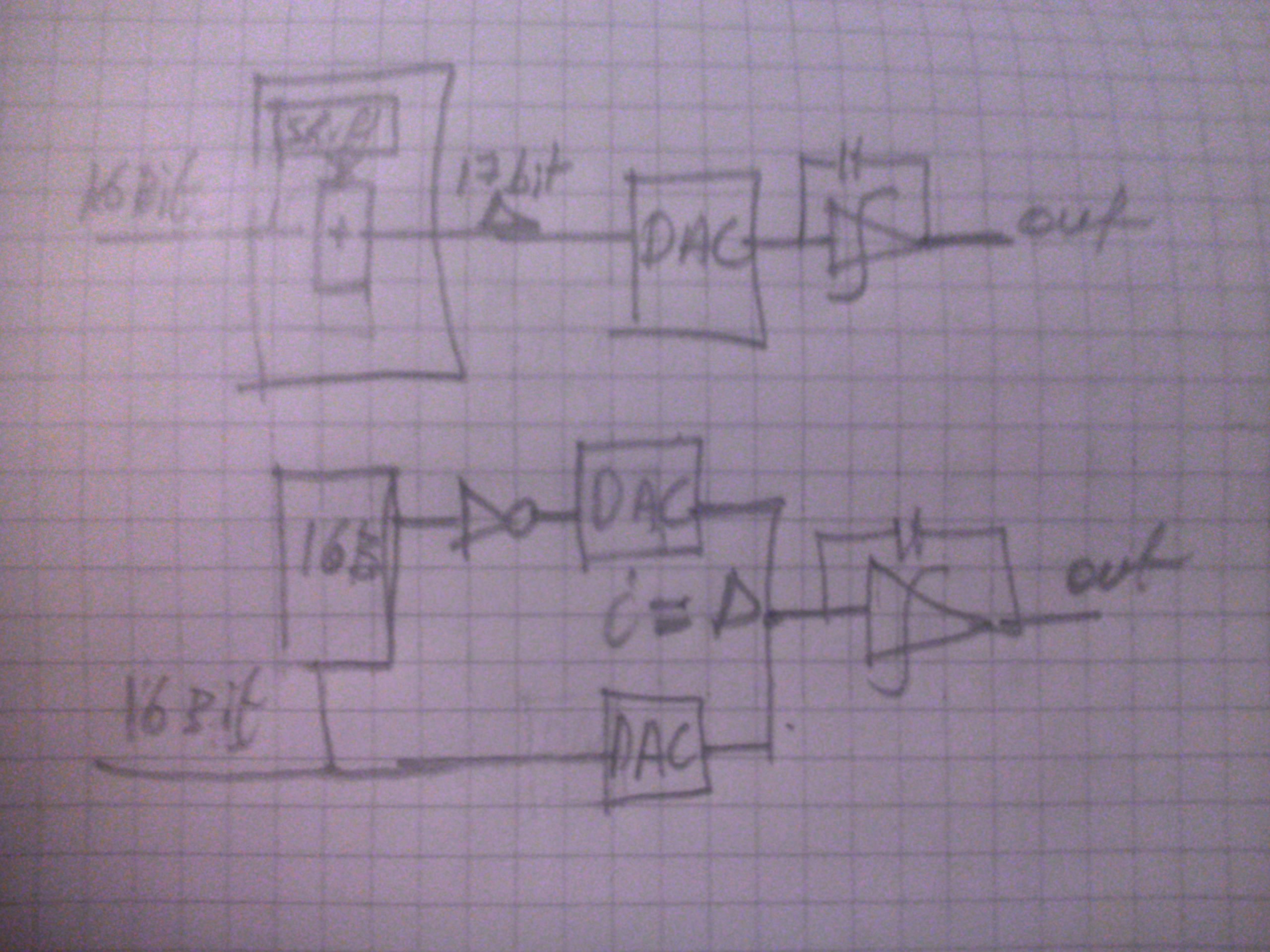

This is a sketch of two different ways with no filters.
The first, the delta is obtained digitally by subtracting the actual data from the precedent and the 17 bits delta value is transformed into analog current to be immediately integrated.
The second, the 16 bit data is transformed into analog current but it get subtracted by the current value of the precedent data, to inject into the integrator the delta information. The circuit in post 1 simulate both types.

In both cases, you have a filter: a digital FIR filter with transfer 1 - z^-1 in the upper version and a mixed-signal FIR filter (a FIRDAC actually) with transfer 1 - z^-1 in the lower version (and of course an integrator in both cases).
By the way, I mistook the things on the left in the schematics of post #1 for digital to analogue converters, but apparently they are sample and holds.
I don't understand at all what the key message of this thread is. Do you want to apply pre-emphasis to a DAC using a FIRDAC structure and de-emphasis with an analogue integrator to suppress the higher-frequency parts of the quantization noise? What's the purpose of it all?

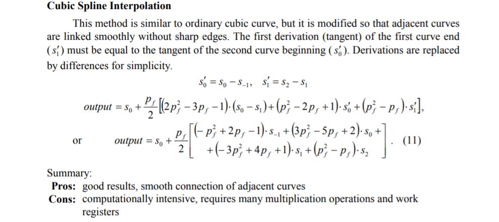

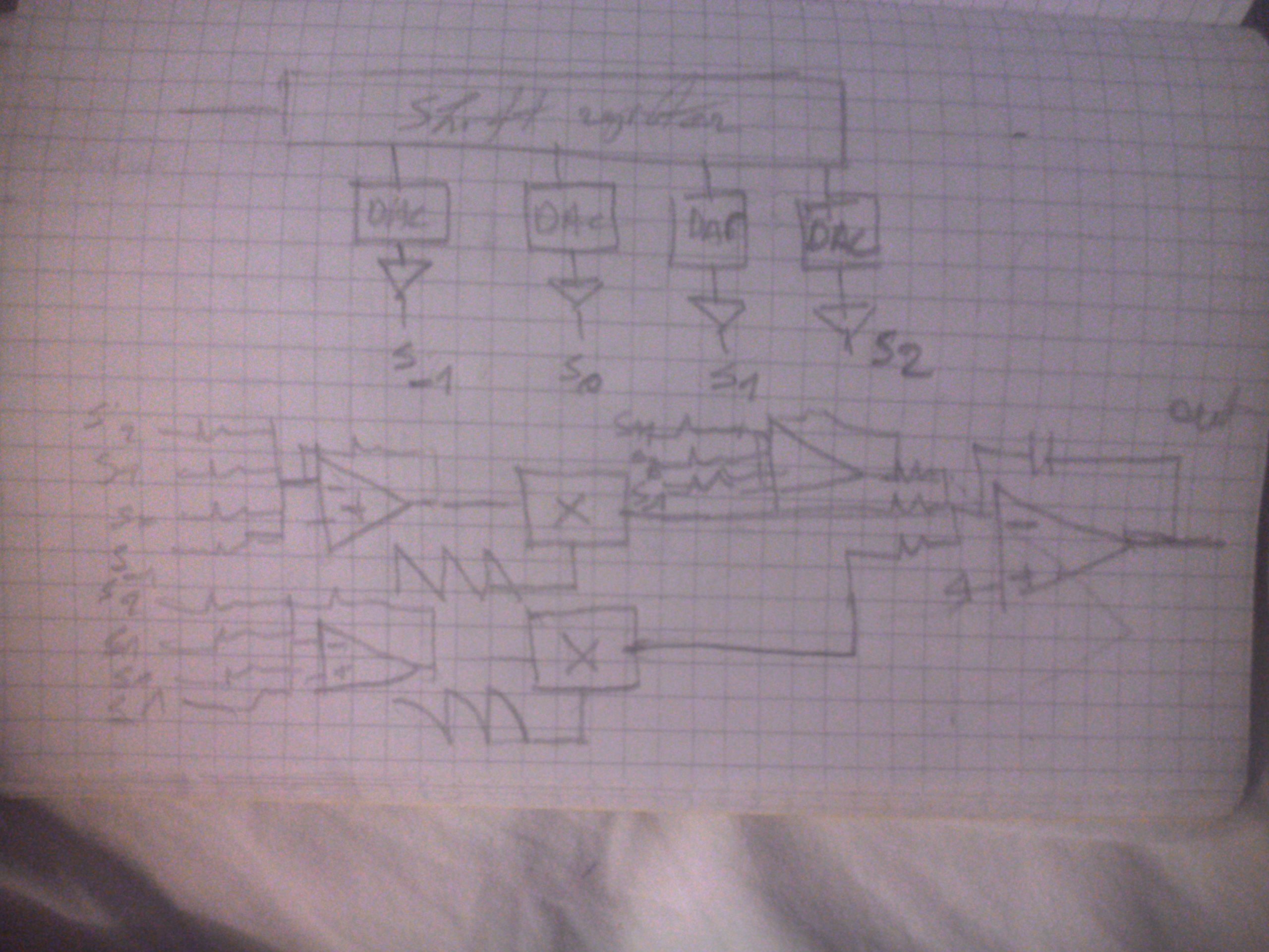

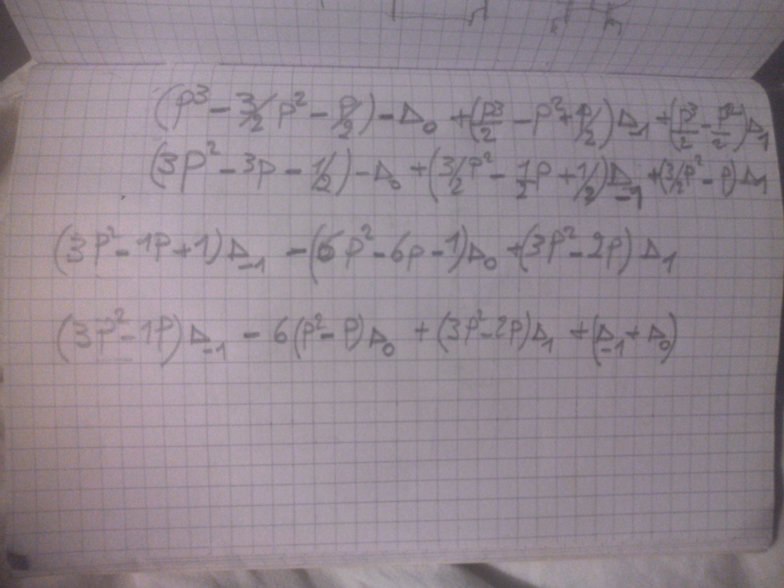

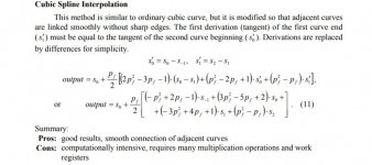

To interpolate linearly and smoothly the sampled points I will temp the spline cubic interpolation. This is the formula that my analog computer will accomplish.
attachment.php
This needs 4 samples to be fed a future s-₁, a present s₀, and two precedents s₁, s₂.
The formula 11 is to be grouped in terms of P³,P²,P, and than derivate it yields (k1s-₁+k2s₀ +k3s₁+k4s₂)P² + (m1s-₁..............m4s₂)P + (n1s-₁ +n2s₀+n3s₁)
This operation is accomplished by the following circuit.
attachment.php

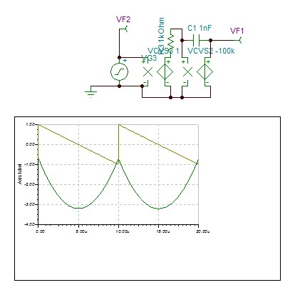

The P² and the P functions are realized by square law and linear saw tooth waves multiplied by the mixed values of of the samples. an example of P is the following
attachment.php
As shown the saw tooth provokes on the integrator output parabolic waves whose amplitude and the polarity (bump or hump) is determined by the 4 samples.

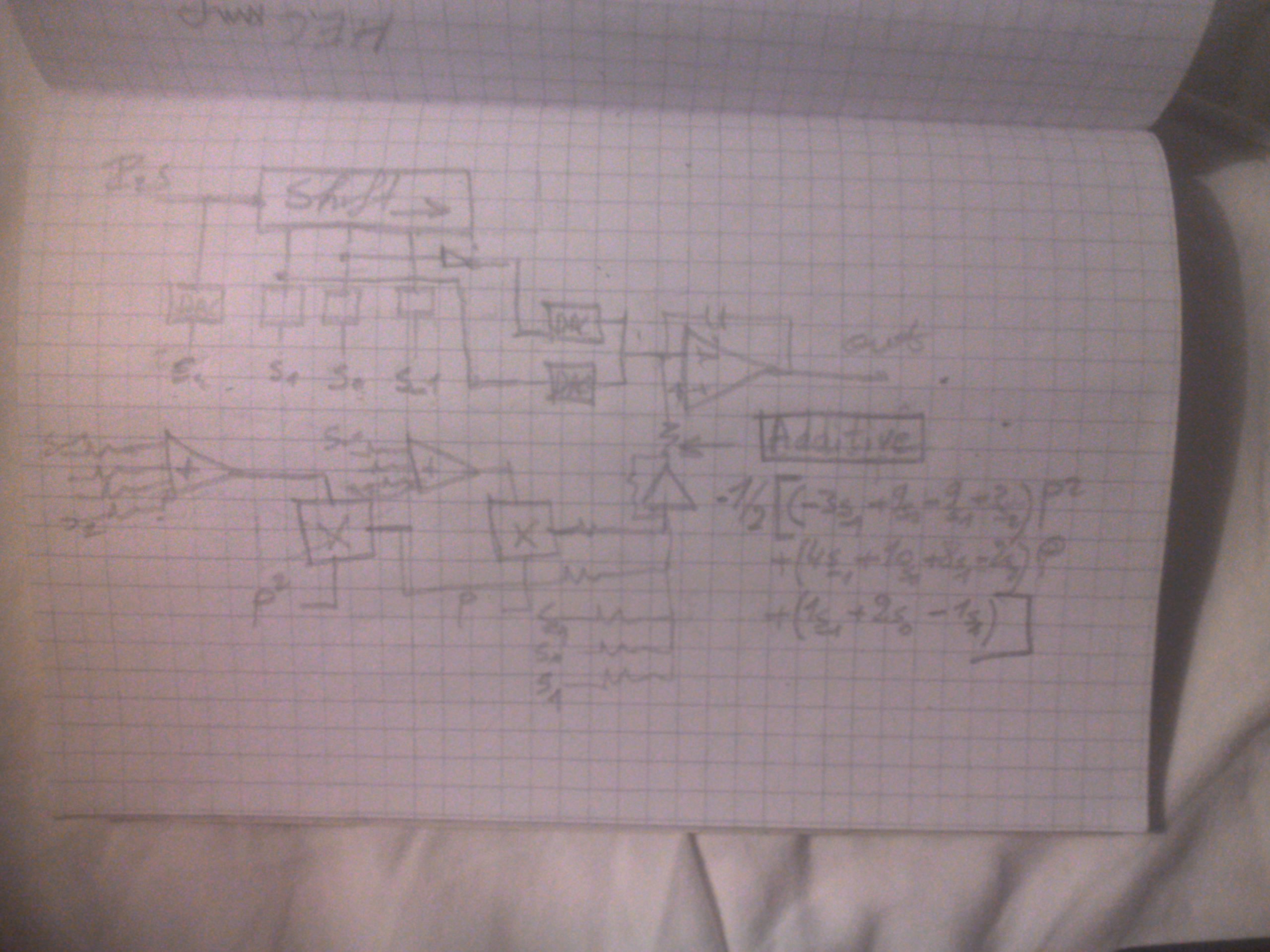

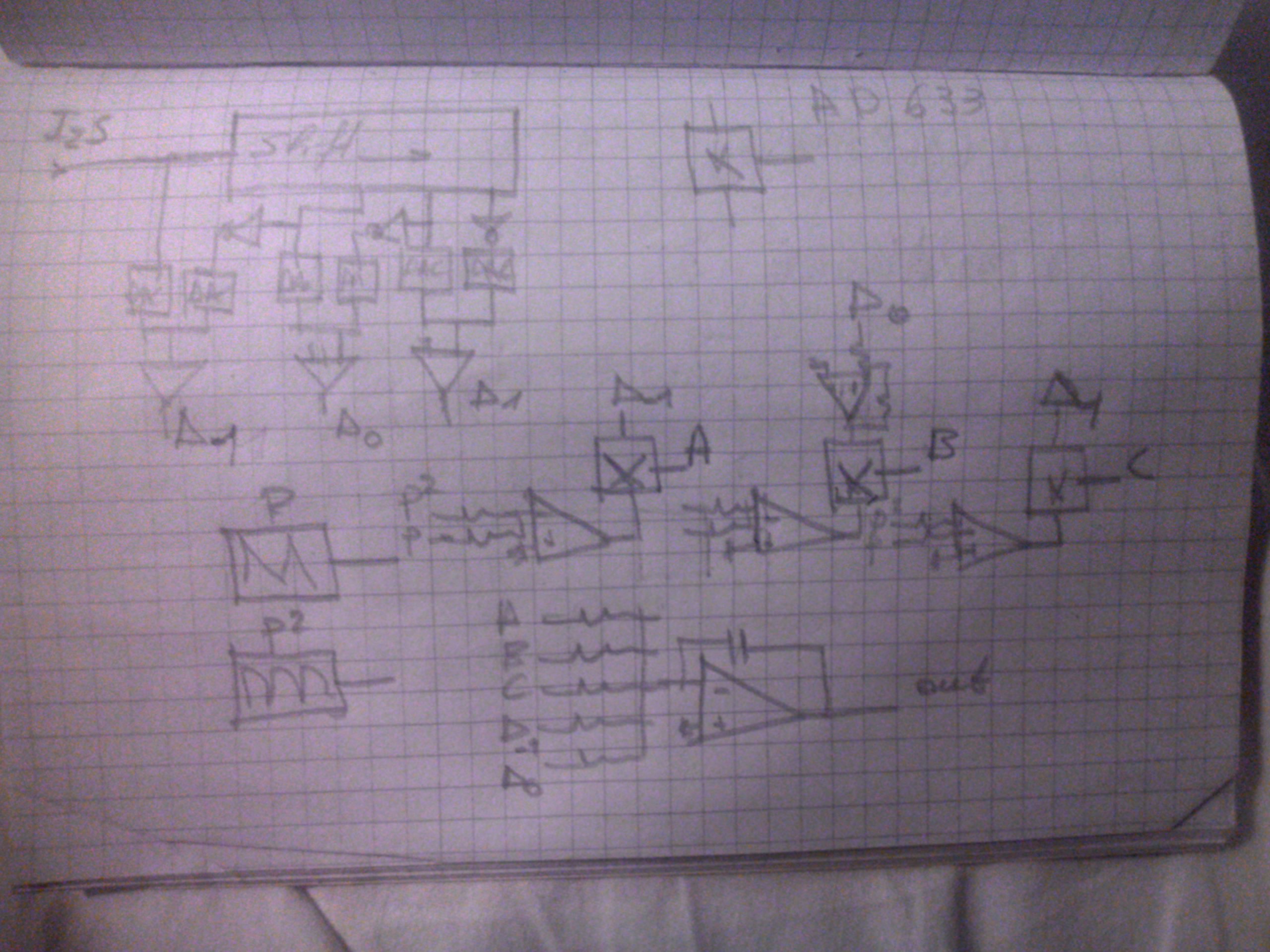

This is a second method using deltas instead of samples by the first equation
908429d1609828704-analog-delta-sigma-interpolation-dac-spline-cube-jpg
If I rearrange the derivative of the equation as shown bellow, I can make the following circuit.
attachment.php
Although it has two more DACs and one extra multiplier, the adjustment is much easier.

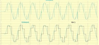

I changed the configuration to suit better to my humble understanding.
I bring back my initial delta- sigma DAC which gives excellent result up to 8khz, on this I add an additive to enhance the high frequencies by adding interpolated compliment to the linear interpolated ramps.
The circuit I will try to simulate will have the following topology.
attachment.php
The equation 11 is erroneous, but if the s₀ of the beginning is erased it gives exactly the additive function after the integrator, the derivative of it I add before integrator.
