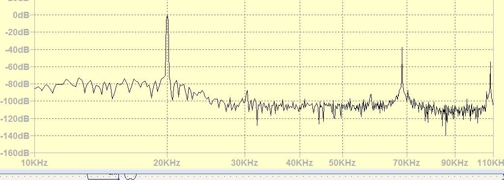

Giving extra gain of 0.45% to midpoints, the 24khz image vanishes.
I am now looking to interpolate the sinc looking only the 30 succeeding samples to avoid pre ringing.

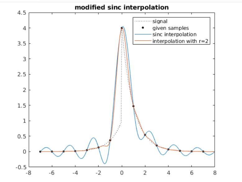

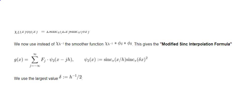

I understood the formula. The second term sinc delta square is the type of function as the Hamming window. The delta can be between 0 and h-¹/2. the (sinc(pi)2t/h)² is 1.414/(pi*nh)² nh=0.5 to 14.5 this value falls rapidly from 0.81 for the first to 0.03 for the third sample. In other words it reduces considerably the precision of the interpolation, as it relies mainly on few samples. I am happy at least I learned what is Dirac delta function.

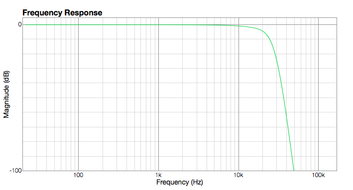

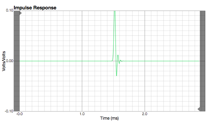

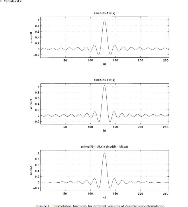

There is another way of reducing the ringing used in biomedical imagery by Yaroslavski,

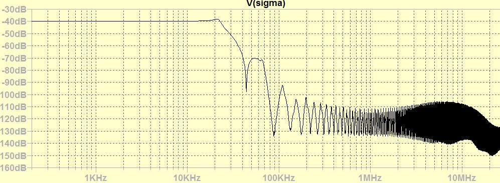

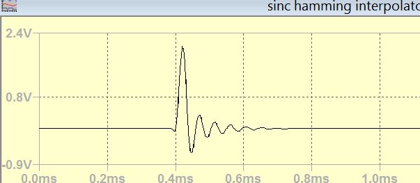

I could make very easily non pre ringing interpolator, the image rejection is a disaster.
View attachment 926731 t
The frequency response of the impulse you show is ridiculous as mine, -25db at 30khz.
True, but this was also the case with the T+A DAC test that I showed a number of postings ago #367.
But nevertheless, the reviewer preferred this filter.
So it’s a brickwall and somewhat cooler sound or a friendlier rol off of a minimal phase filter and “better” sound.
Hans

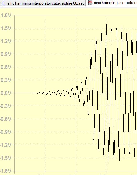

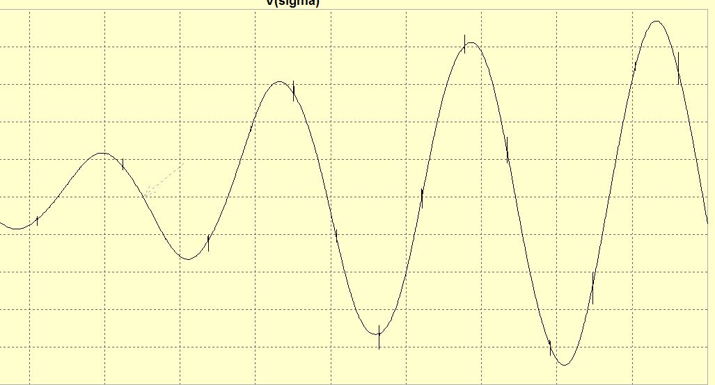

I will study a more important aspect than the ringing, The transient 20khz. It needs three cycles to reach the steady state. I will see what I get with 60 samples.
The arrow shows the start of 20khz.
