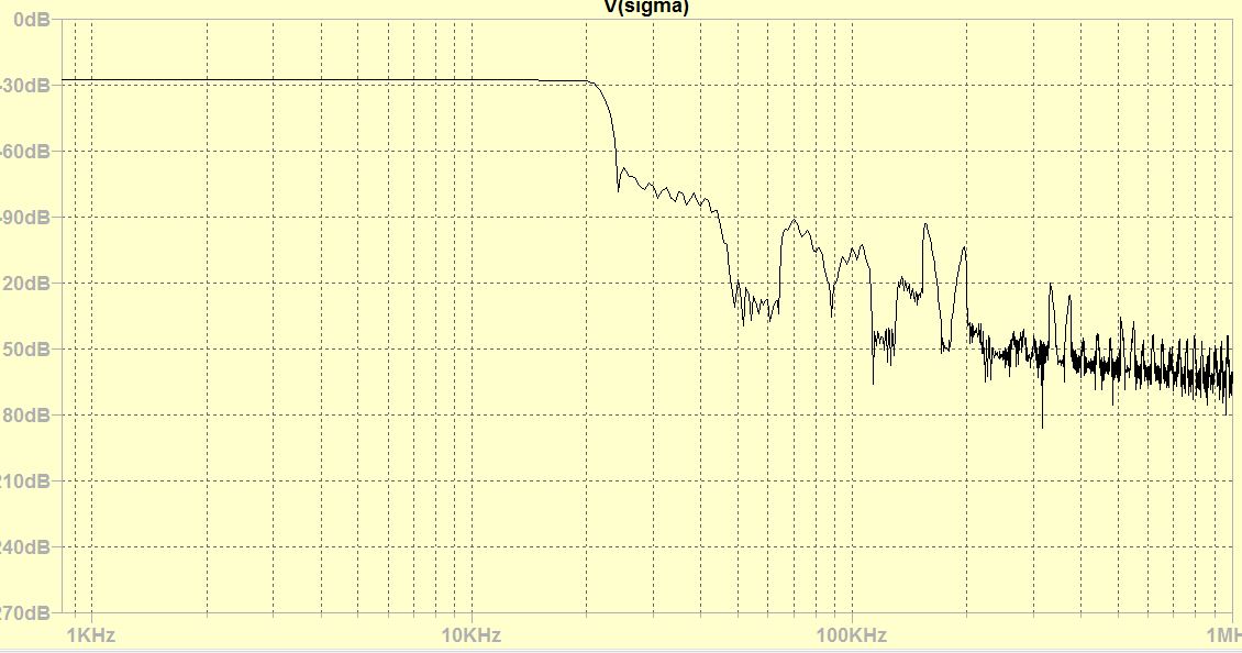

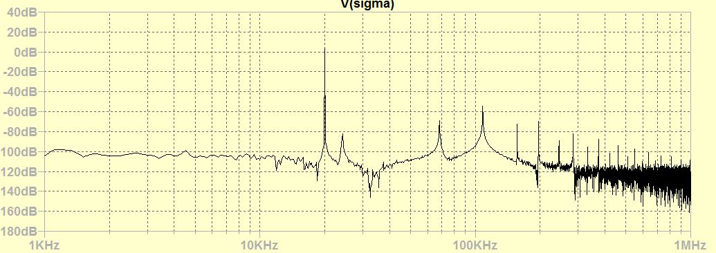

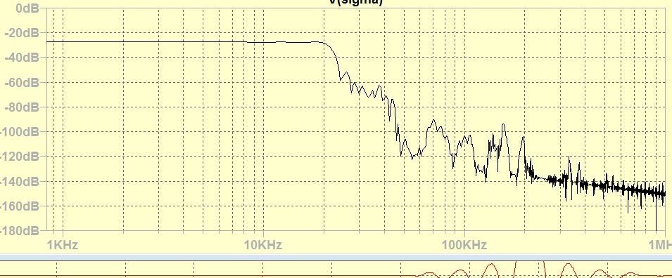

20 samples didn't make anything better, the image is at -28db. It looks the 30 samples is the best.

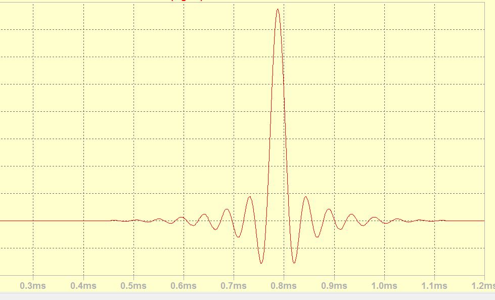

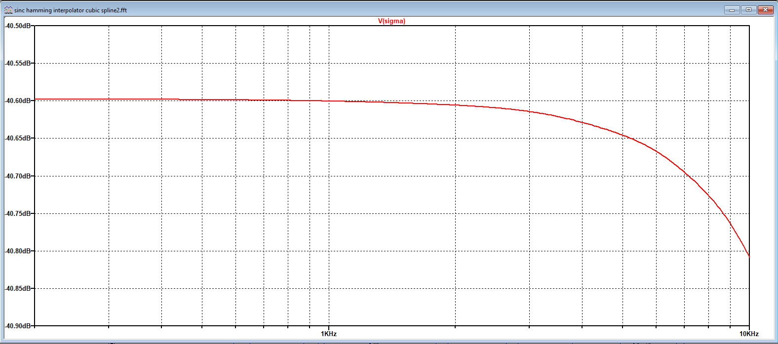

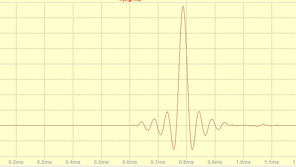

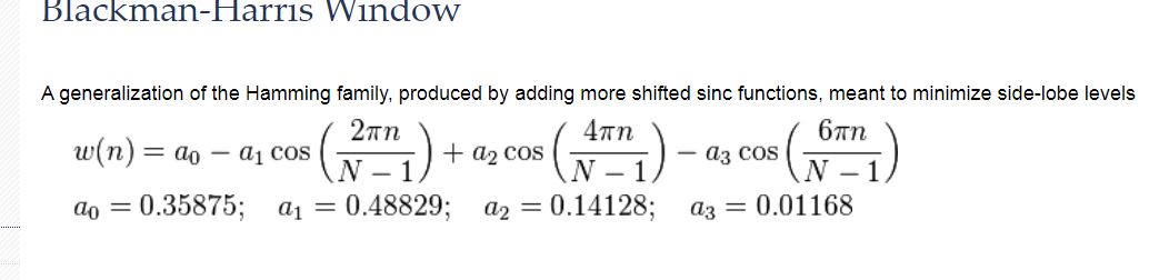

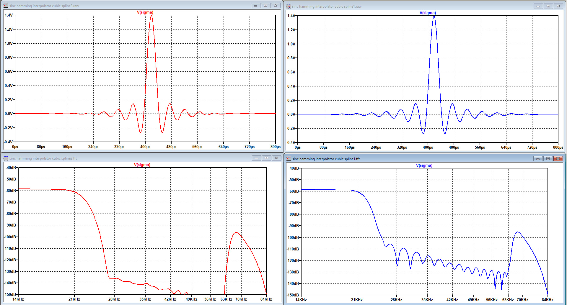

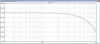

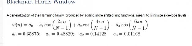

I tried a 36point Blackman Harris window while not using the outer 4 points because they were practically zero, so filter length stayed still the same as before.
Below, at the left Blackman Harris in Red t and the Hamming with 0,45% gain at the right in Blue.
FR is now a bit smoother around 20Khz, but stopband is much deeper that the Hamming window with 0,45% gain.

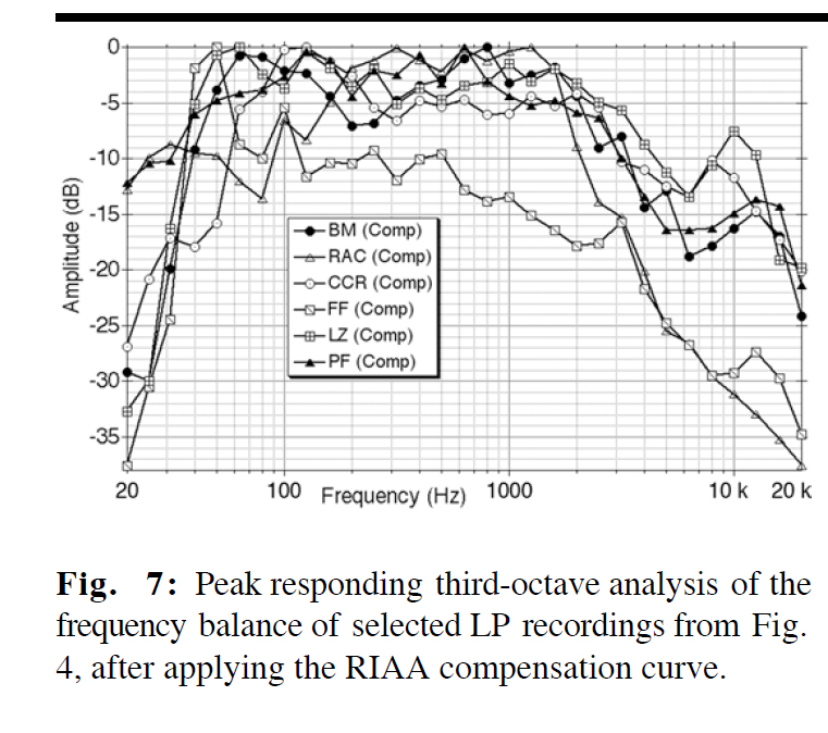

Suppression at 24.1Khz is a bit less, but to be realistic, at this frequency the spectral content of music is quite a bit lower, see second image.

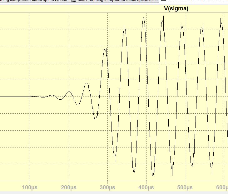

An advantage that very short filters, very long filters and minimum-phase filters have in common is their reduction of the passband-ripple-related pre-echo. That's something else than the ultrasonic pre-ringing. Using very short filters reduces the time between the pre-echo and the main signal, very long filters reduce the level of the pre-echo and minimum-phase filters simply haven't got a pre-echo. See the attachment for an explanation about the relation between passband ripple and pre-echo.

Yes. I'm trying to find a relation between the pre- and post-echoes and the passband ripple without needing to assume that the filter is a cascade of a hypothetical low-pass with perfectly flat passband and a hypothetical filter that causes the passband ripple, but has perfectly equal distances between the ripples.

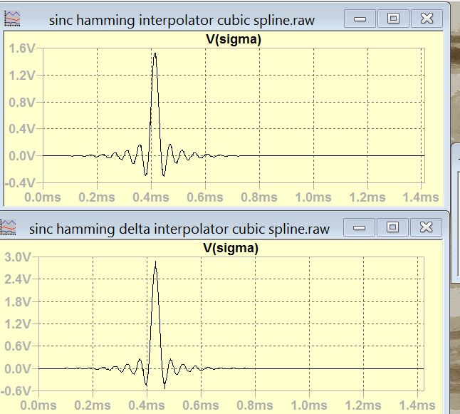

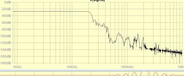

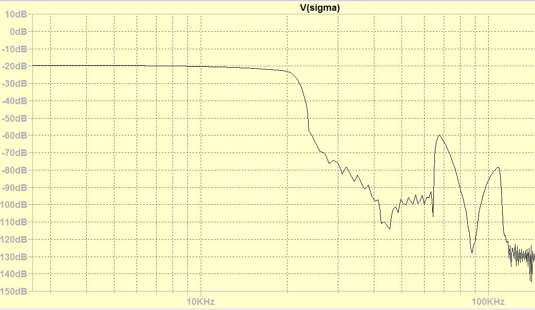

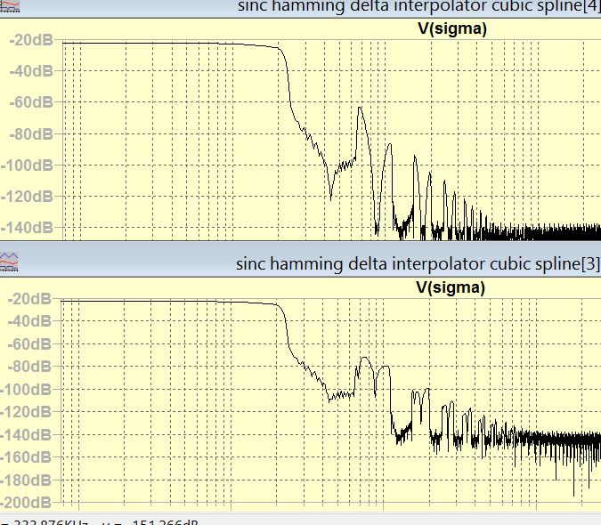

While you are considering my interpolator as filter, I am trying to filter out nothing. For that, I tried the heterodyne to decrease the images 68k-88khz.
I succeeded for 20khz,
but for global it is not so effective, with and without.
To clean up the output from spikes, I added S/H on the derivatives outputs.
