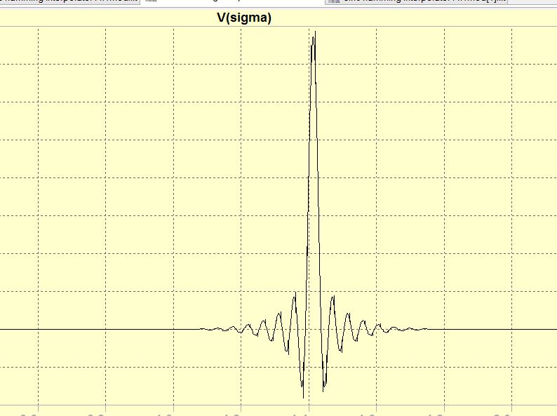

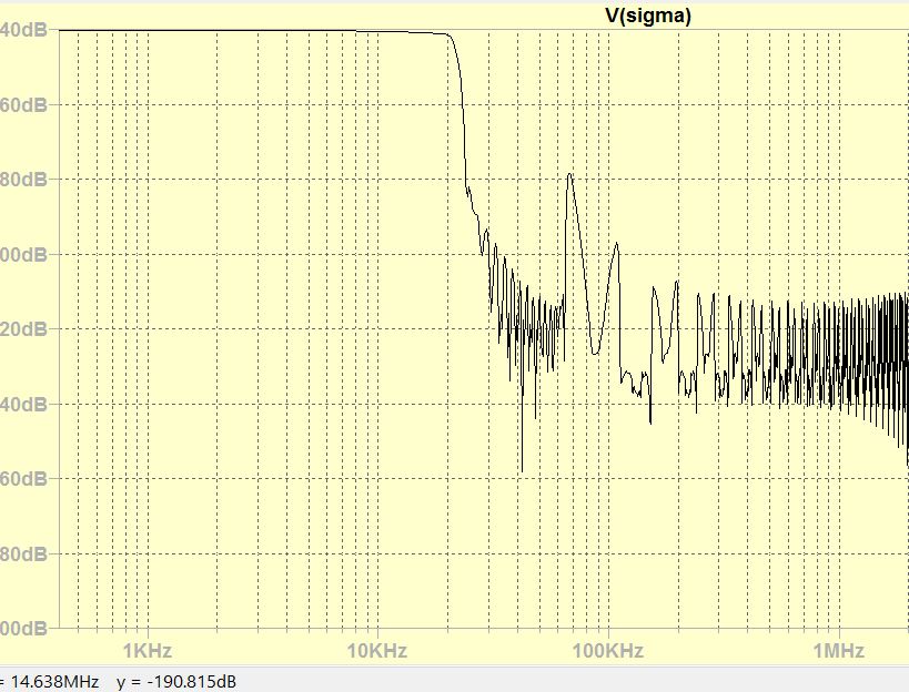

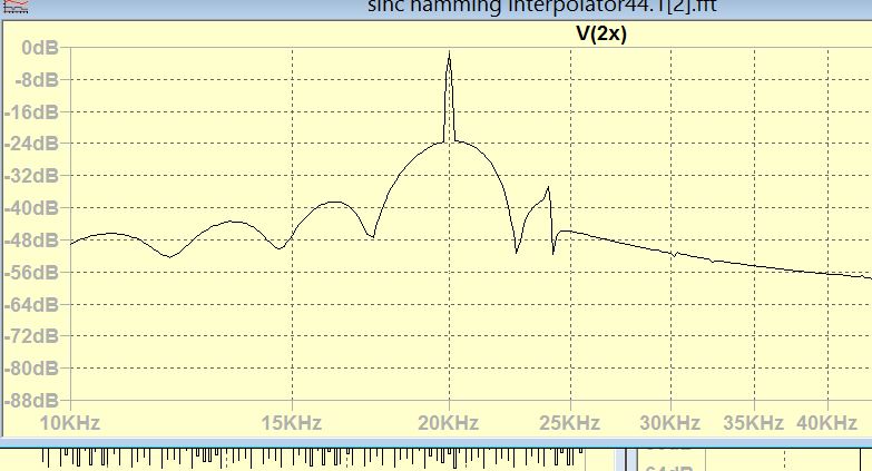

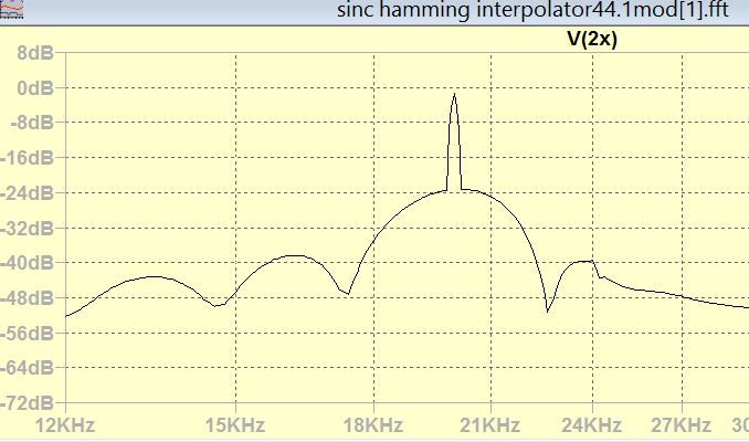

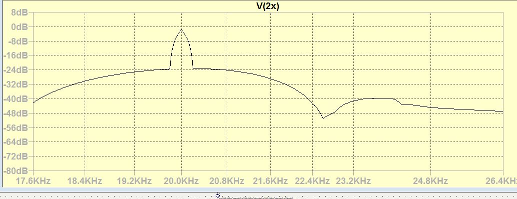

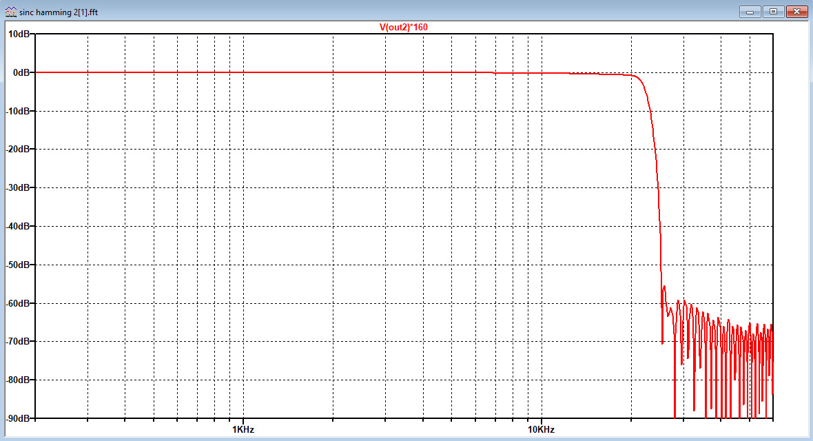

I recalculted your filter coefficients, because 3% or even 7.3% sounds odd.
Here are my more accurate results:
0.63502, -0.20743, 0.11948, -0.08020, 0.05732, -004208, 0.03113, -0,02292
0.01664, -0.01182, 0.00817, -0.00548, 0.00361, -0.00242, 0,00181.
With these coefficients spectrum with your 20Khz sine wave input is in the first picture below, and the FFT of the impulse response is the second image.
Both are much smoother as before.
Hans

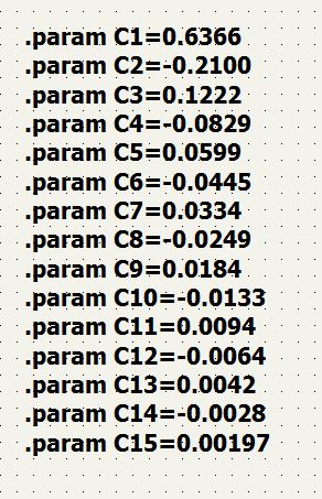

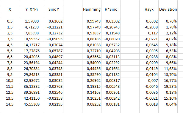

How did you calculate? considering the first coefficient. The sinc is 1/(.5*pi)=0.6366 to multiply by the Hamming window (0.54+0.46(cos(2*pi/30))= 0.9899 I get 0.63022. How you find 0.63502?
I see, you consider the Window also with half factor, I thought the window acts upon the samples.
Here they are.
Hans

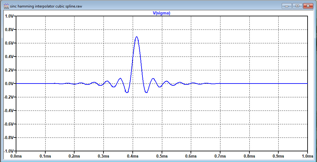

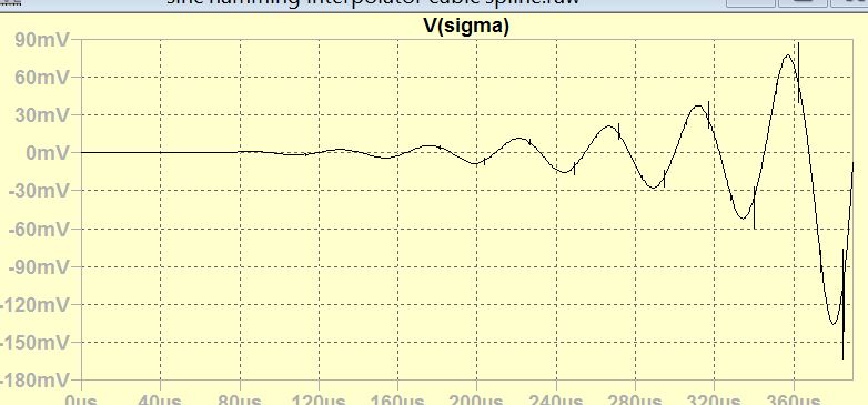

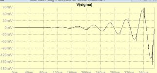

I feel shameful to give you such troubles. The Hamming window I made it double bell on one each 15th and 16th sample. It works marvelous. I added now the cubic interpolator, I don't know yet, why I have spikes after the integrator, this what I get with pulse response.
You can improive things quite a bit by lining up V5 with the other signals.
Set fall time to 1nsec and delay to 2u061.
Also from the delay lines generating S1 to S-2 you can attach small 30pF caps to catch the spikes.
Succes,
Hans

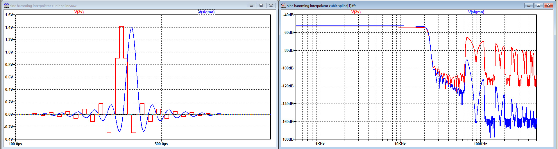

So instead of having three filters working in parallel instead of the single Sinc Hamming filter you have now, you want to put a complete copy in series with what you have, but now at twice the frequency ?
That will then remove the second mirror but also introduce unwanted pre ringing at twice the frequency.
To interpolate more points then you have now, it seems better to use two or three Sinc Hamming polyphase filters in parallel working at Fs to get two or three interpolated points between the original points.
In that case, the length and frequency of the pre and post ringing will stay the same

For your first proposition, the new ringing at double frequency is what I wish to filter out by a notch. A quick sim showed that the precedent ringing remains as is, so not a solution.
May be I can interpolate the sinc by linear phase filter method to have it without pre resonance.

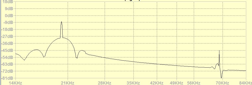

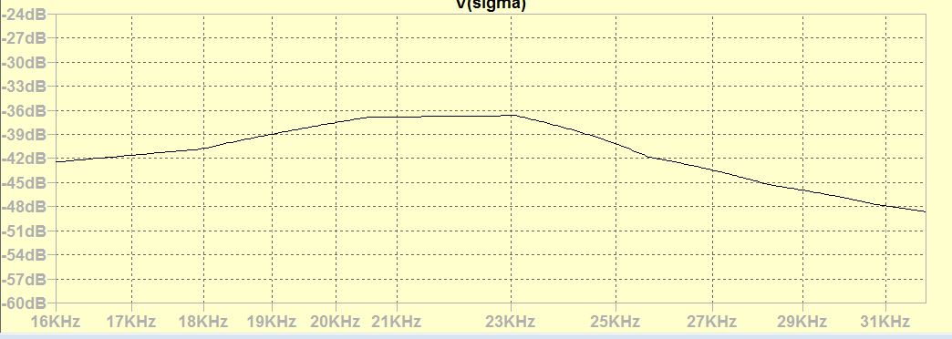

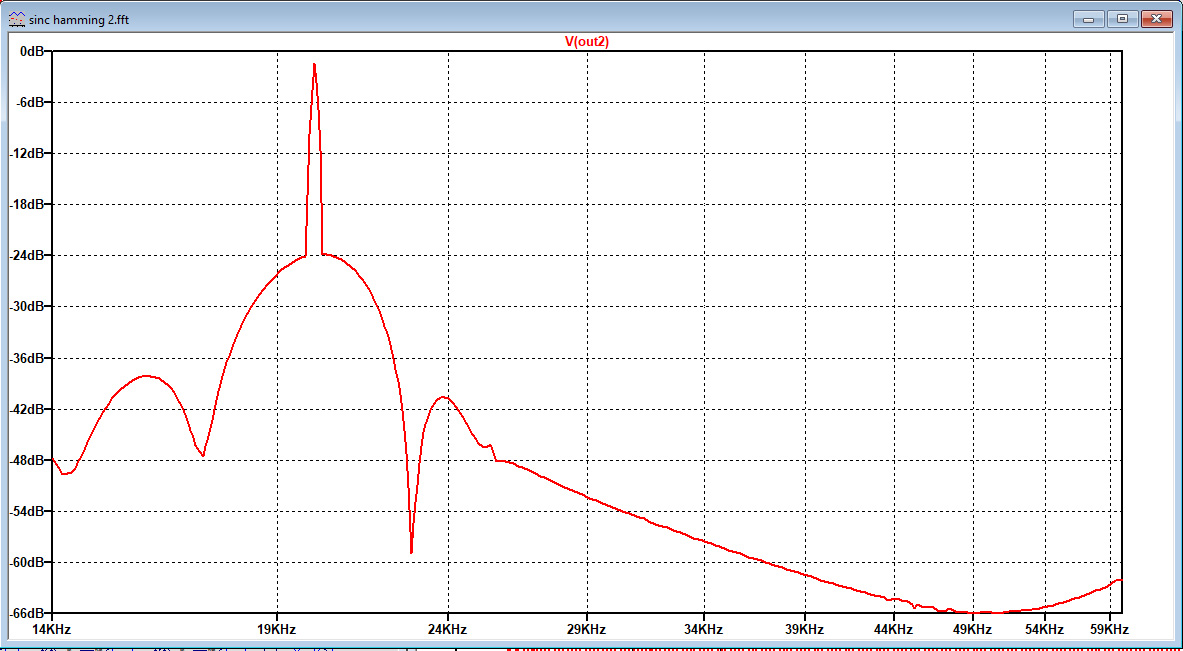

Nevertheless, I optimised your last .asc for exactly 44.1Khz and plotted the filter before and after your smoothing filter.
Results are looking very good, see below.
Mirror at 88,2Khz is suppressed by almost 40dB.
Hans

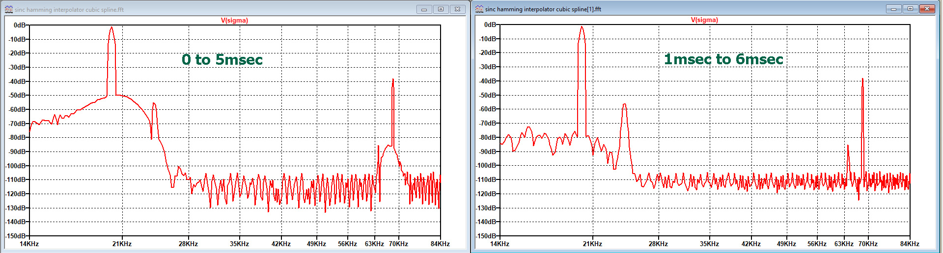

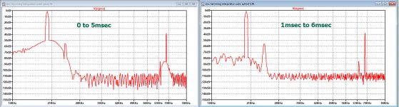

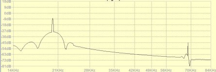

Measuring in continuous mode gives different image ratio than the impulse.
I think your image is not as good as it could, that's why I include your optimised .asc file.
Two images below with a 20Khz 1.414V sinus wave input , the first from 0 to 5msec, giving this funny bulge below 20Khz, the second one from 1msec to 6msec, giving a better view on things.
Hans

I expect that the pre- and post-ringing will be determined by the filter with the narrowest bandwidth, so it will stay around 22050 Hz no matter which of the two solutions is chosen. At least with ideal filters, the two solutions would be completely equivalent.
