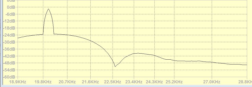

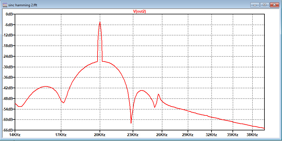

And when going on a logarithmic scale from 14K to 40 K as you did, this is how the result should look like.
Hans

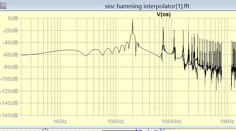

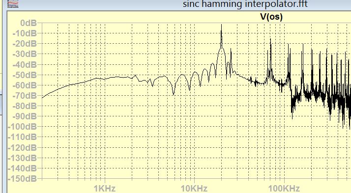

I don't understand why you delay the original samples by 15.5 samples and why the clock ck is reversed by delaying 11us. All I see from the FFT the OS to be this.
Are you sure mine was wrong? I make the OS to be first the 16th on the positive, as the sampler acts on the rise, and switch to the midpoint on the negative.
It’s working properly, isn’t it?
That’s all that counts.
I could have taken a sample from your delay line, but this was more flexible, and for the anogue delay I needed a separate delay line anyhow.
It’s beautiful weather here, like spring.
And I preferred to sit in the sun instead of behind a PC.
That’s why I didn’t take the time to check things as I normally try to do.
But the last .asc file is right.
Hans

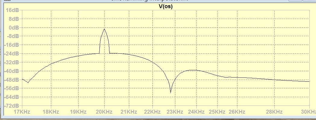

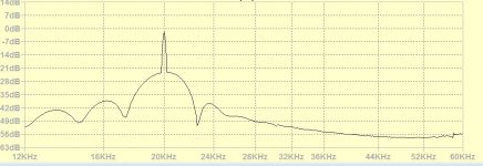

I saw that you did not download the Sinc Hamming 2.asc file from #341 ready to run the Impulse Response.
The impulse response is the ultimate test to check the correct working of the model.
Or did you alter E31’s gain from 1.15 to -1, and do you now get the correct FR with 20K input as in #342 ?
Hans

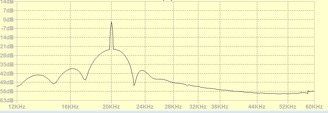

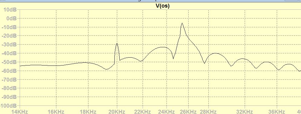

The only thing I needed to change to be similar to yours is the rise and fall of the clock ck. With 0 rise, fall.
With 0.05u rise fall.
How strange?

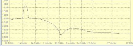

With -40db image, my interpolator is a excellent.
You are close but still not perfect.
Look at the image in #342 at 0dB with the first mirror at -37dB.
Yours is at -25dB for a 0dB signal.
Try to sim an impulse response, that’s the easiest way to find out if everything is O.K. Image should be flawless like in posting #334
Hans
adjusted to 44.1khz it needs 8.3% extra gain. To say that the clock has half the period on but 0.05us rise and fall. If I subtract the rise from the on time to have it 50% duty cycle, I get lot of parasite pulses.
That’s why you should better use the sample input instead of the clock input of the S&H.
That relieves you from calculating 50% dutu cycle.
