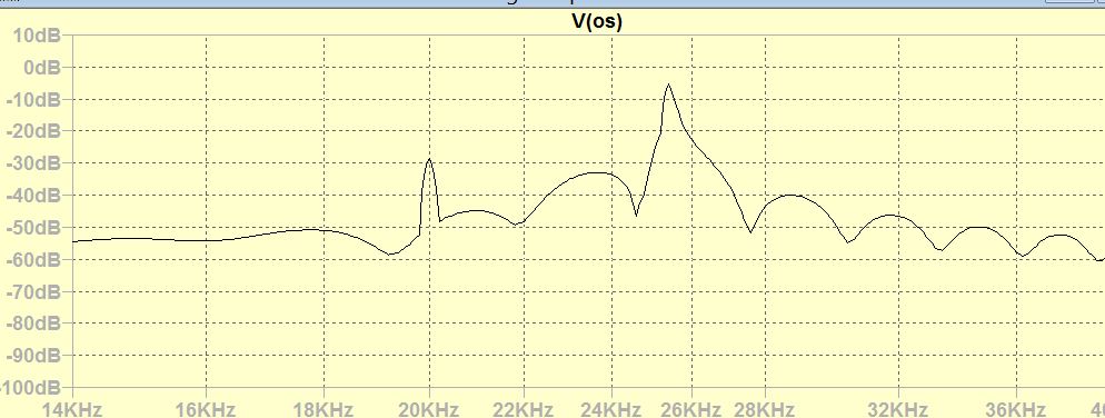

Increasing the midpoint gain by 15%, I get minimum image at -36db and -1db for 20khz.

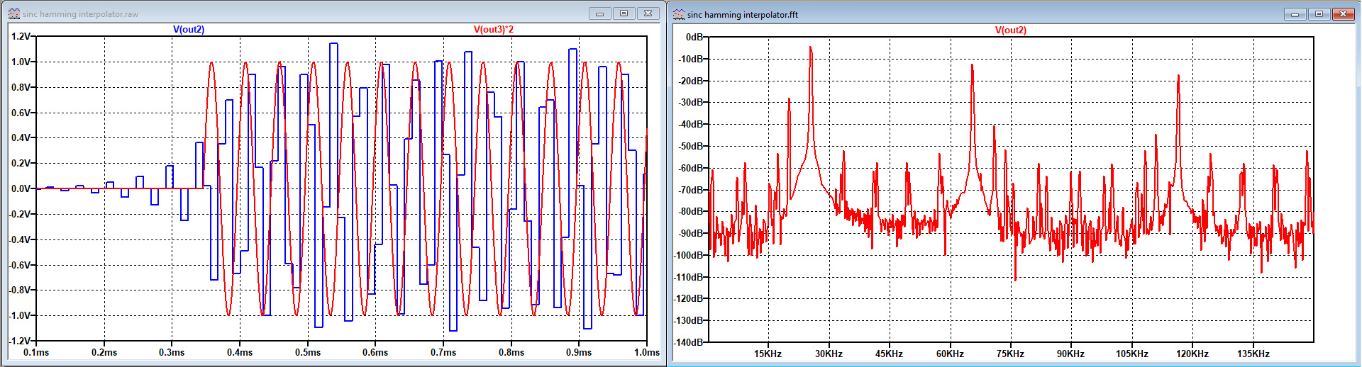

I don't see what is modified in your asc file. I don't see neither any stuffing of 1's instead of zero's as you do, I don't see neither any filtering I am doing to be associated with low pass filtering. All I am doing is sinc interpolation to harvest mid sample values and merge to the original. My approach is in time domain, low pass filtering is in frequency domain.Hayk,

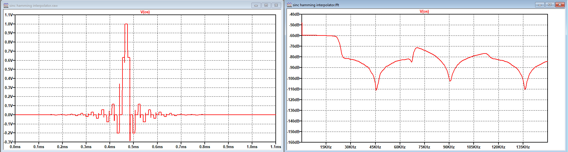

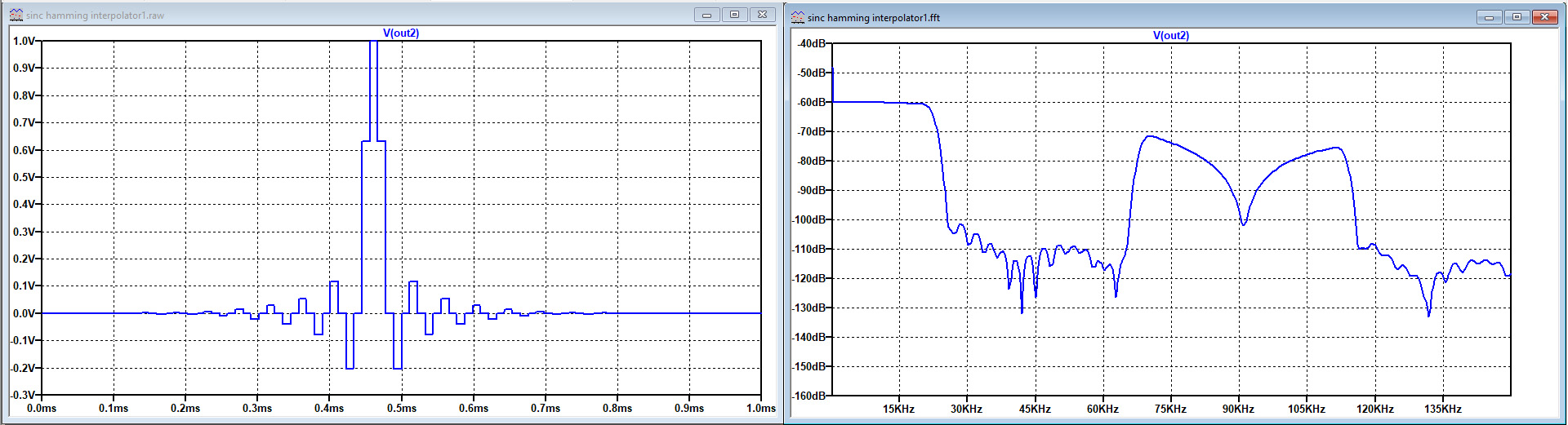

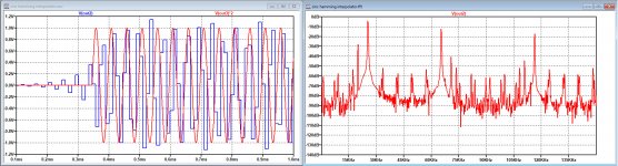

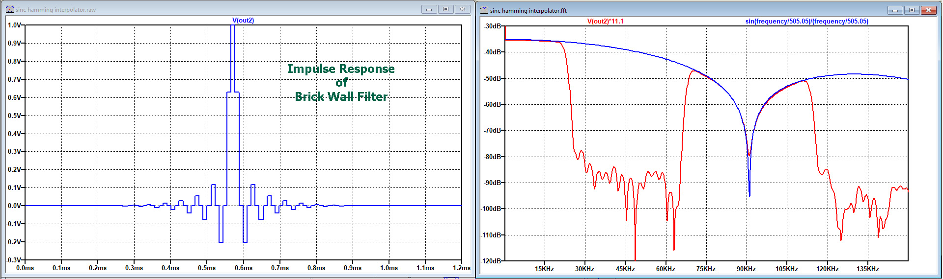

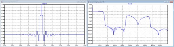

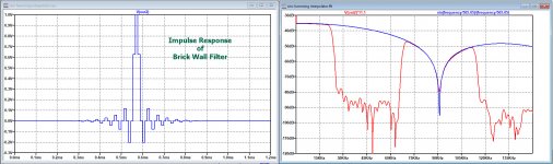

I only corrected a few small things in YOUR model, and see the difference in the images below the original version in red and the corrected one in blue.I don't see what is modified in your asc file.
Impulse response plus FR of yours, versus the same for the corrected one.
It's all in the .asc version in #320.
Hans

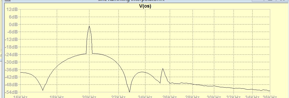

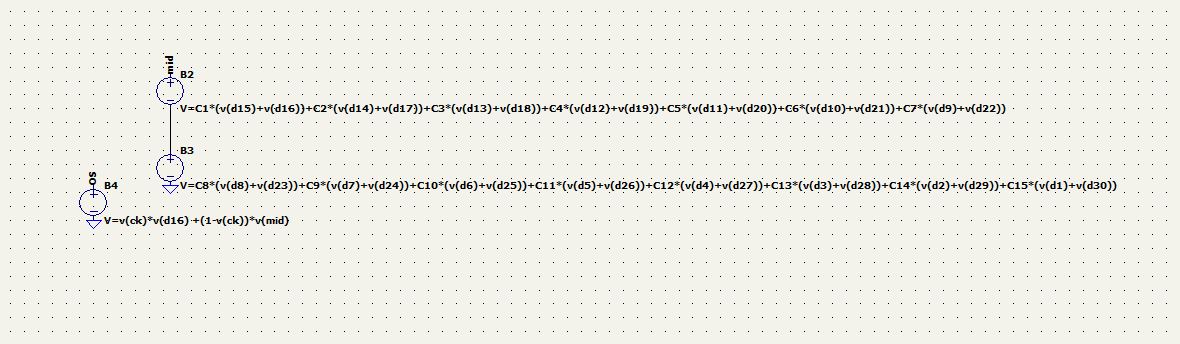

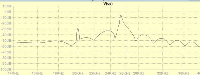

I don't understand why you delay the original samples by 15.5 samples and why the clock ck is reversed by delaying 11us. All I see from the FFT the OS to be this.
Are you sure mine was wrong? I make the OS to be first the 16th on the positive, as the sampler acts on the rise, and switch to the midpoint on the negative.
