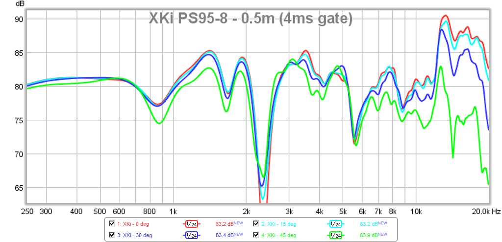

The K-aperture can really improve polar response
So I have an XKi enclosure designed for the RS100-4 so I stuck the PS95-8 in it for fun. It actually sounds decent with some usable bass. I took a polar and was really surprised how uniform it is. Although there is a deep notch at 2.4kHz, it is narrow and my ears don't miss it.
PS95-8 in XKi, at 0.5m and 4ms gate:

Response and HD of PS95-8 in XKi (200 ms gate):
467348d1424550092-objective-comparison-3in-4in-class-full-range-drivers-ps95-8-xki-hd.png
