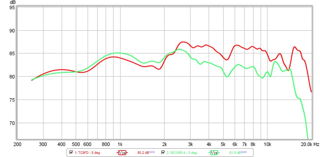

Also the earlier graphs are still good and everything is compared under the same conditions. Cut it any way you like, the vifa tc9 is the standout performer at any price point.
Have you heard a pair?

Those 1m graphs are throw aways. I think xrk knows that. He needs to adjust the gate. No big deal. But conclusions shouldn't be drawn from them right now. If xrk saved the file, it's easy to change to 3ms.

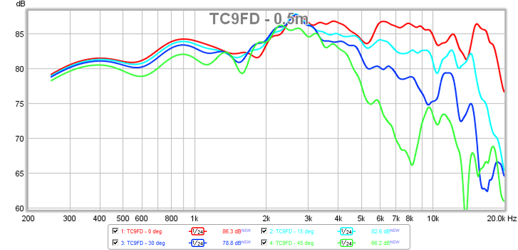

I saved the data files but I just repeated the measurements at 0.5m with 4ms gate, padding blankets on floor and covered microphone tripod legs with blanket as well. The IR's are clean as a whistle with no reflections out to 6ms+. I also took polars while I was at it. as you can imagine, I have a ton of data now. Will be posting them soon.

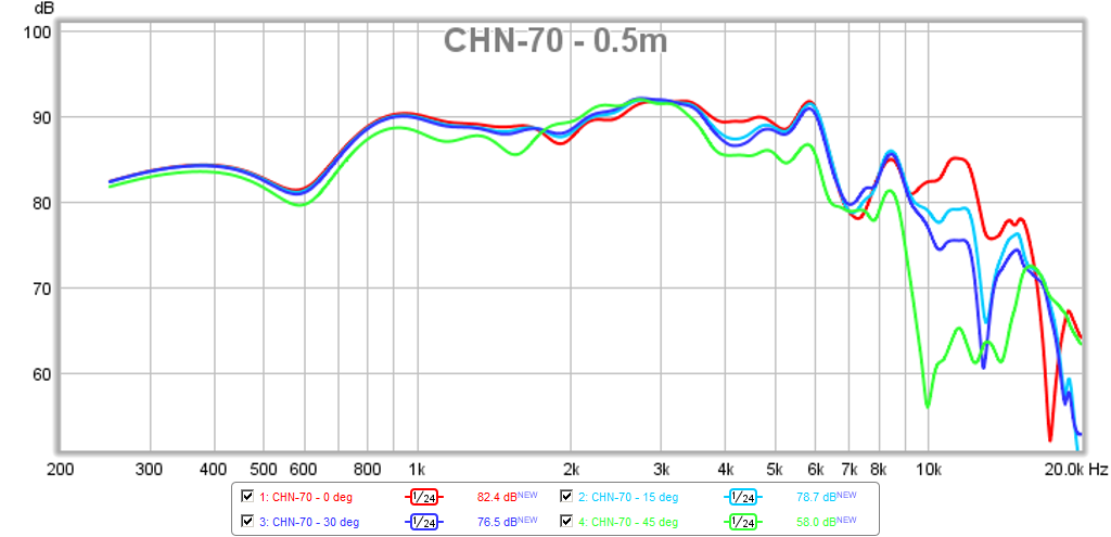

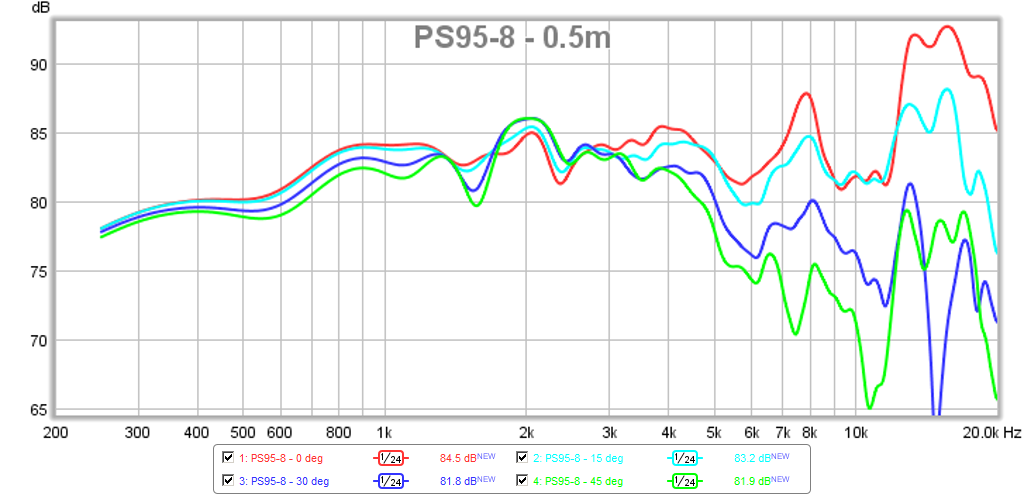

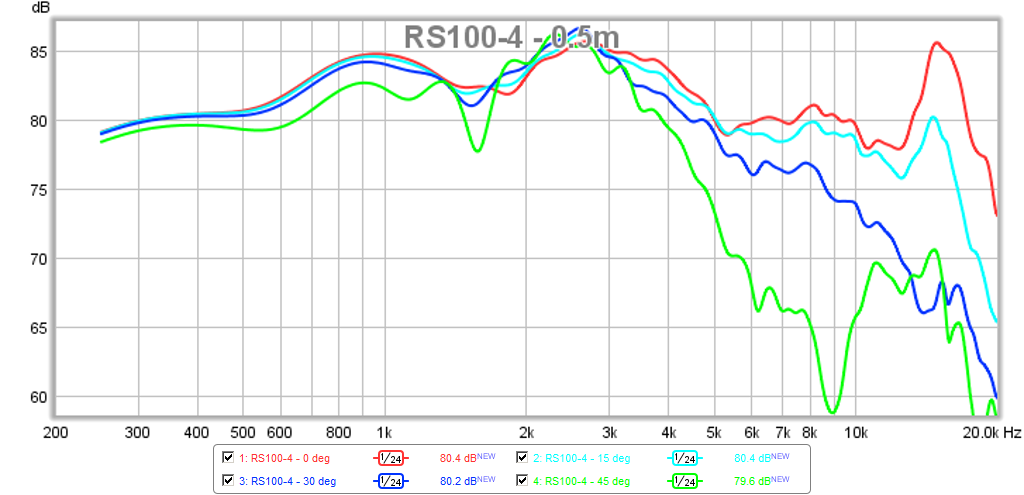

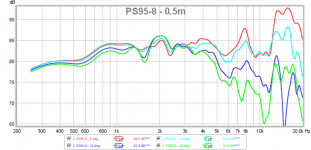

Polar Data from 0.5m with 4ms gate

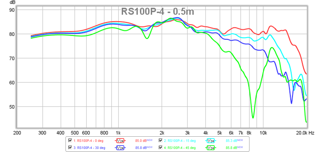

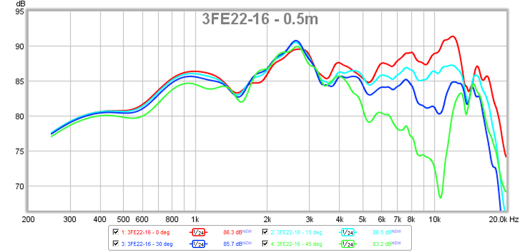

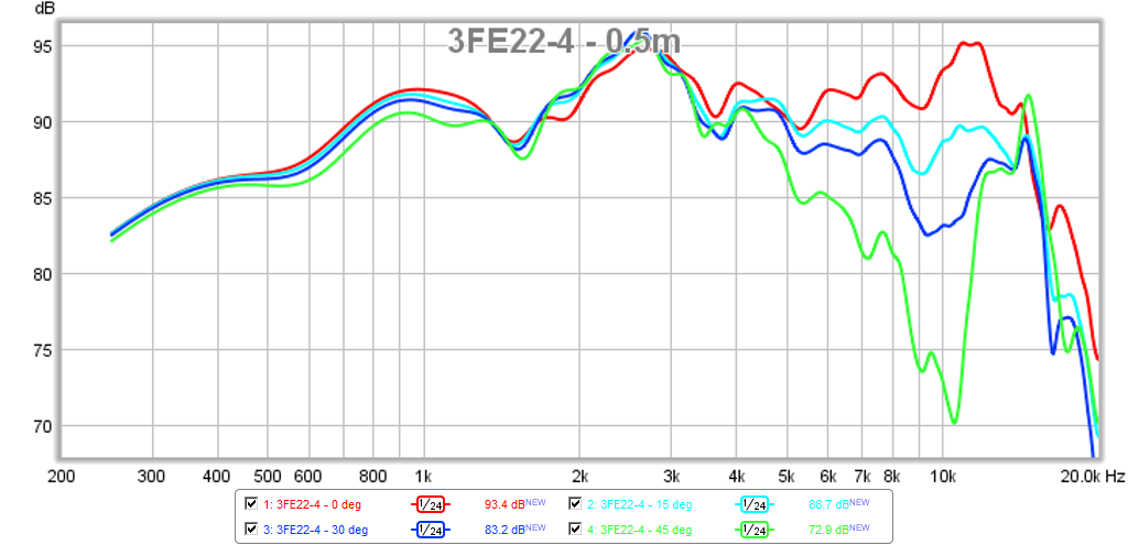

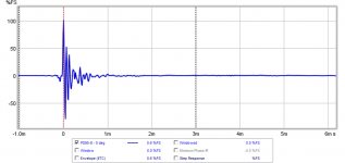

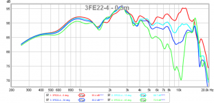

I decided to repeat the measurements at 0.5m distance with a 1ms (pre t=0) and 3ms (post t=0) for a total 4ms gate (250Hz resolution). I reduced the drive level by -6dB so the measured sensitivity is comparable to a 1m measurement at 2.83v. I added blankets to absorb some of the floor reflections and the tripod legs. While I was at it, I took data at 4 different angles: 0 deg, 15 deg, 30 deg, and 45 deg so that we can get a sense of the off-axis behavior. I am plotting everything on 5dB scale (except for RS100P-4 and CHN-70 which needed 10dB/div to show extent of variation) with 1/24th octave smoothing. The lowest resolvable frequency is 250Hz. The measurements are now reflection free (no more combing).

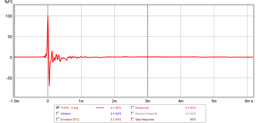

Here is one Impulse Response from the TC9FD at 0 deg just to verify that the IR is clean and reflection free:
Here are the Polars...
TC9FD:
3FE22-4:
3FE22-16:
RS100-4:
RS100P-4 (note vertical scale is 10dB/div):
CHN-70 (note vertical scale had to be increased to 10dB/div to accommodate the large variation):
PS95-8:
As you can see, repeating the measurement with the correct gate and distance from mic to avoid reflections still produced the same response in the CHN-70 with a sharp edged plateau from 600Hz to 7kHz.

3FE22-4:
PS95-8:
cool !! - would you mind sometime posting RS100P-4 and CHN-70 again but with 5dB per vertical division?

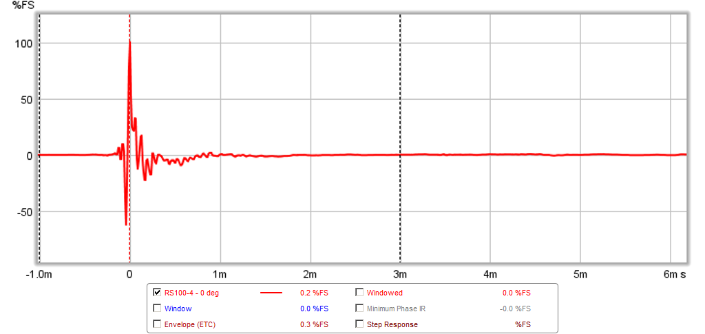

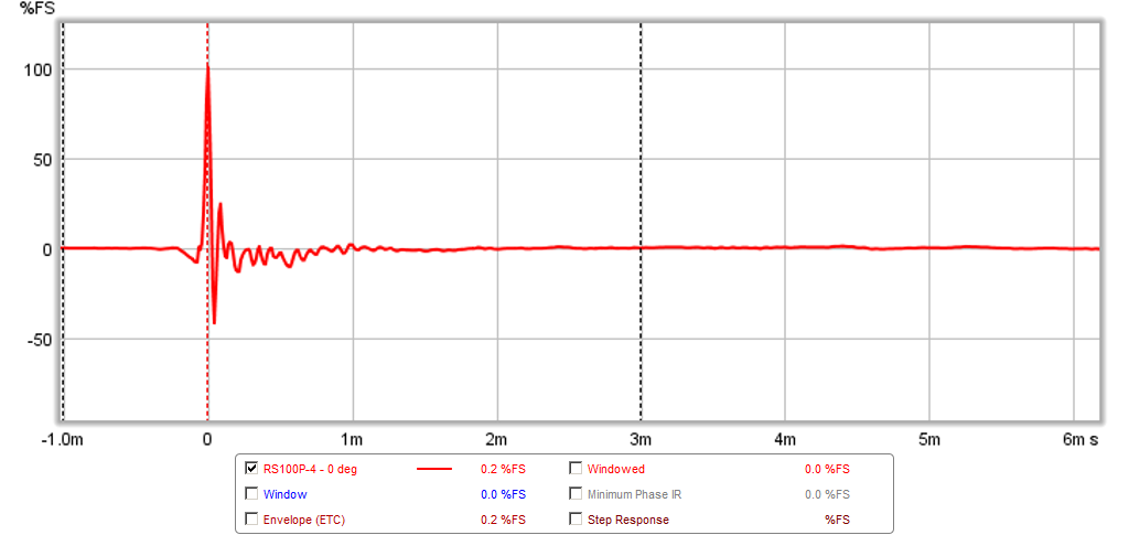

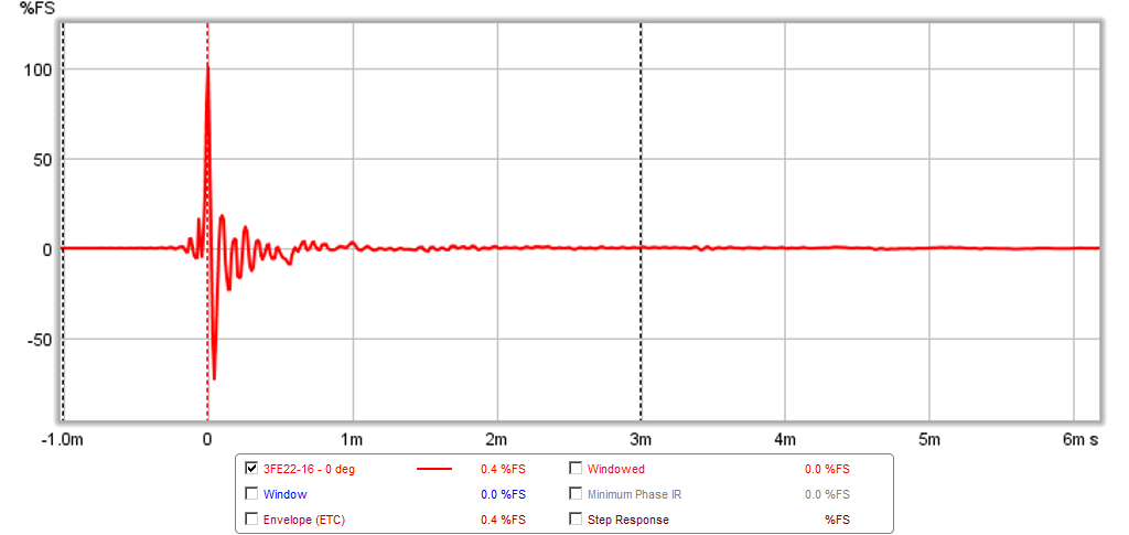

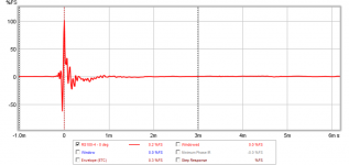

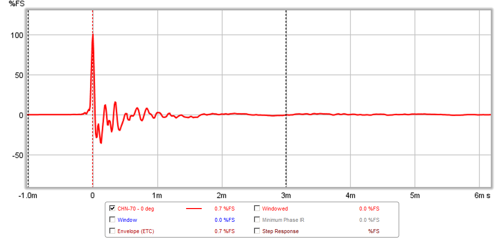

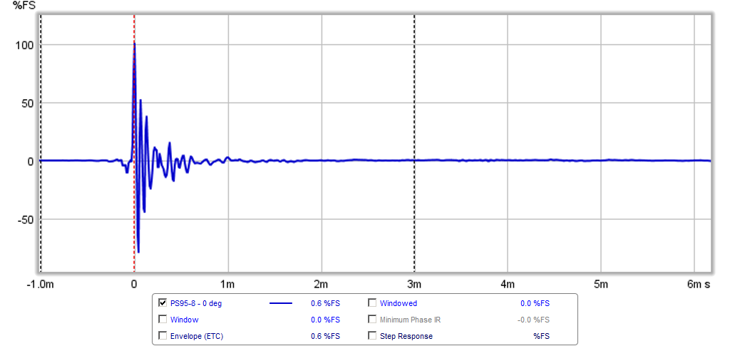

Corresponding Impulse Response at 0.5m
Here are the corresponding IR's measured at 0.5m away and 0 deg. I am missing the 3FE22-4 as I forgot to save the data file.
TC9FD:
3FE22-16:
RS100-4:
RS100P-4:
CHN-70:
PS95-8:
TC9FD:

RS100-4:
RS100P-4:

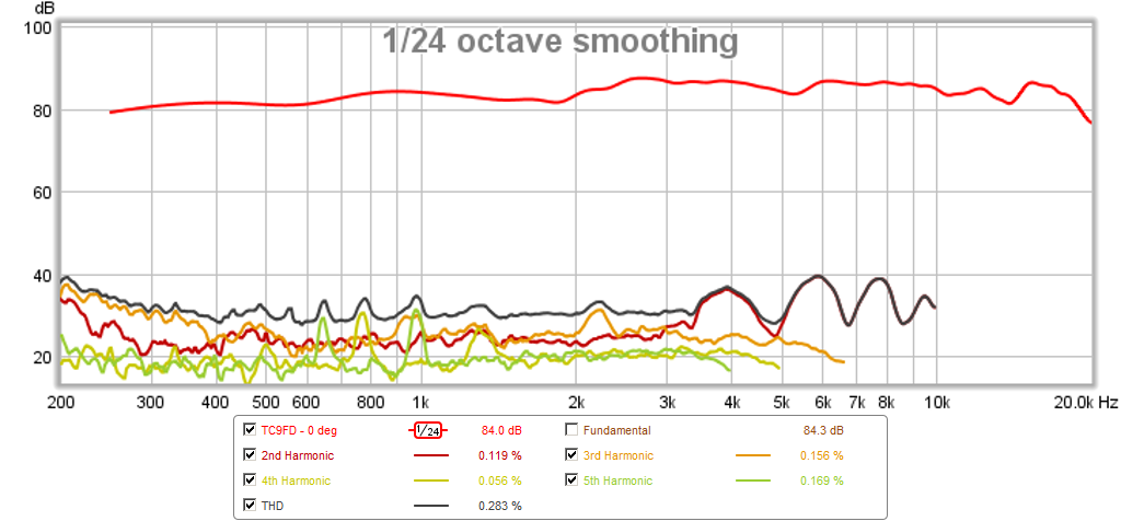

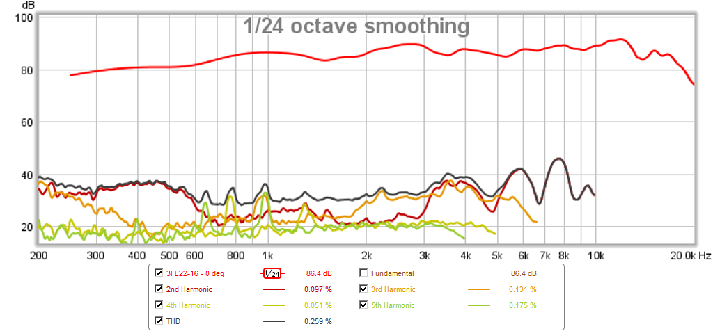

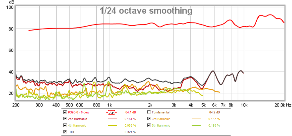

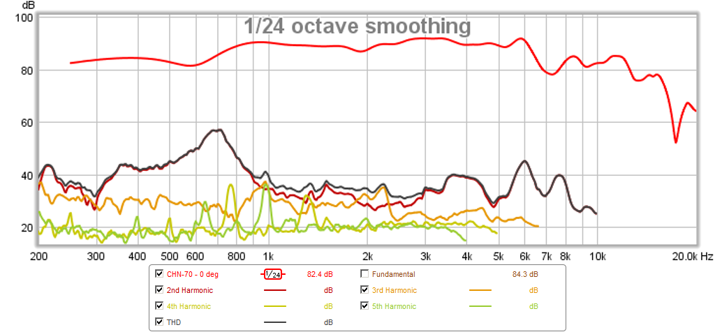

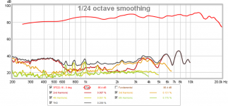

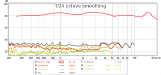

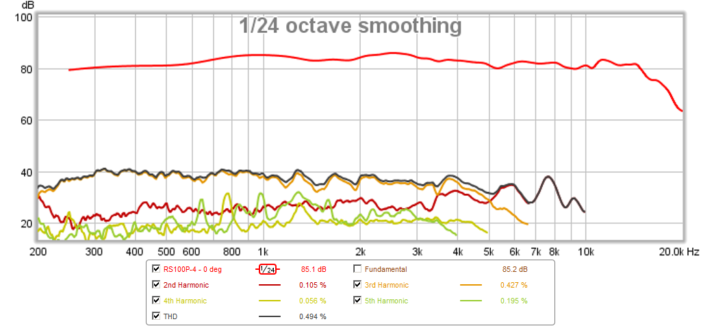

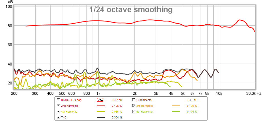

Harmonic Distortion
TC9FD
3FE22-16
RS100-4
RS100P-4
CHN-70 (watch out for the high disotortion peak around 700Hz):
PS95-8

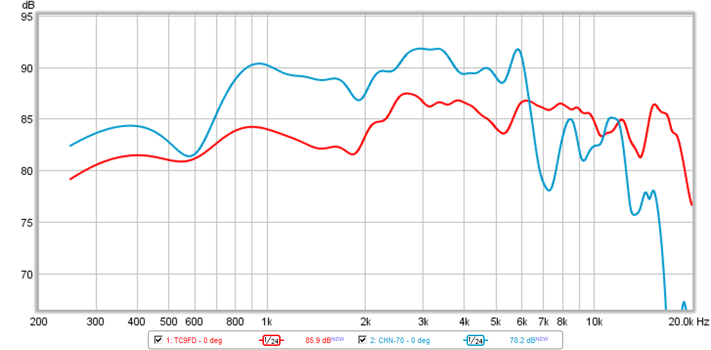

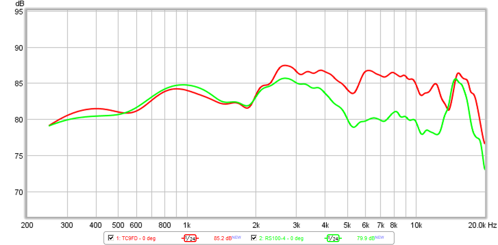

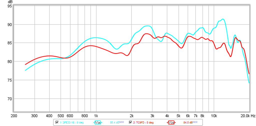

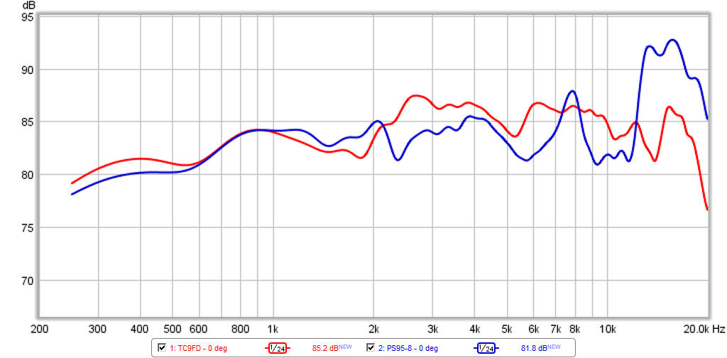

Comparison of Response vs TC9FD at 0.5m and 0 deg
This is with 4ms gating same as above data.
TC9FD vs 3FE22-16:
TC9FD vs RS100-4:
TC9FD vs RS100P-4:
TC9FD vs CHN-70 (response still has issues even with correct gating and far field mic placement):
TC9FD vs PS95-8:
TC9FD vs 3FE22-16:
TC9FD vs RS100-4:

The only thing screwy is the wonky response of the CHN-70. These are new reflection-free measurements at 0.5m with 4ms gating.
