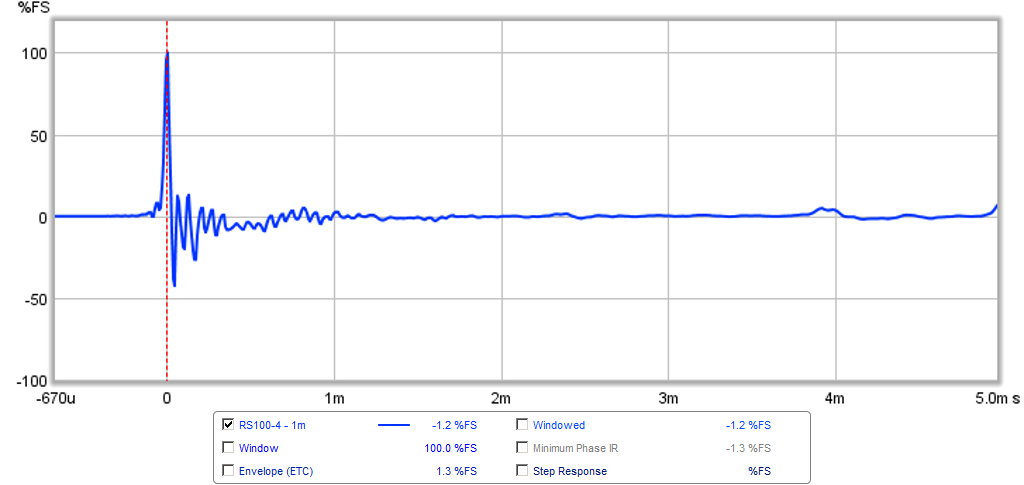

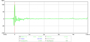

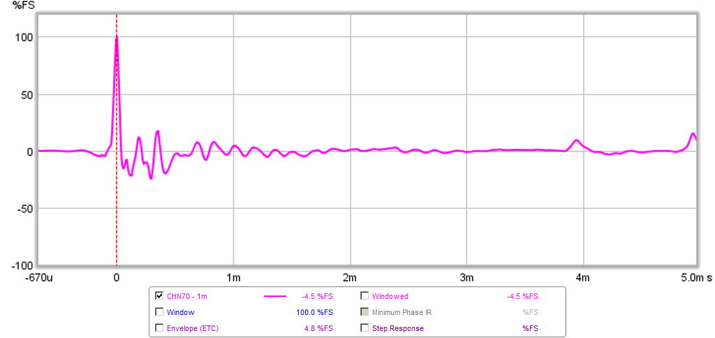

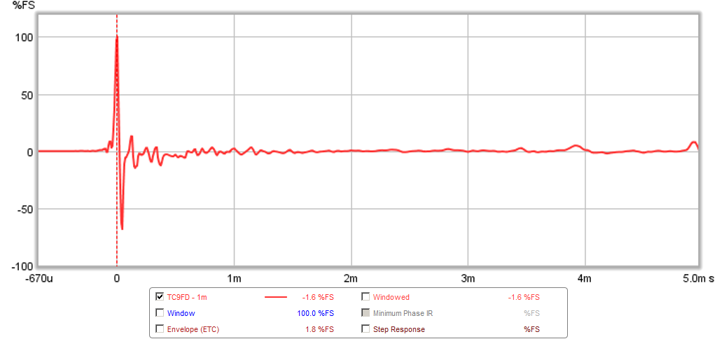

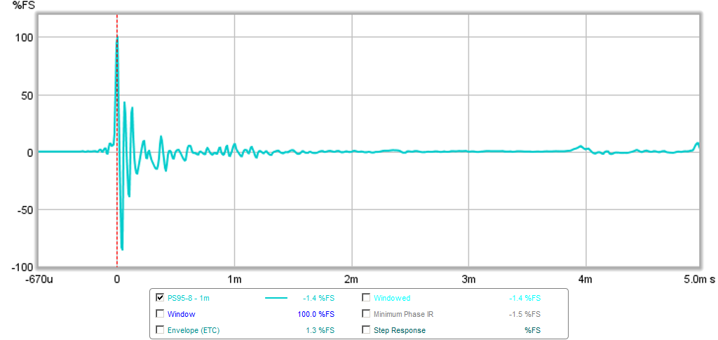

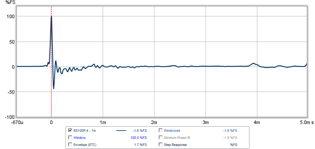

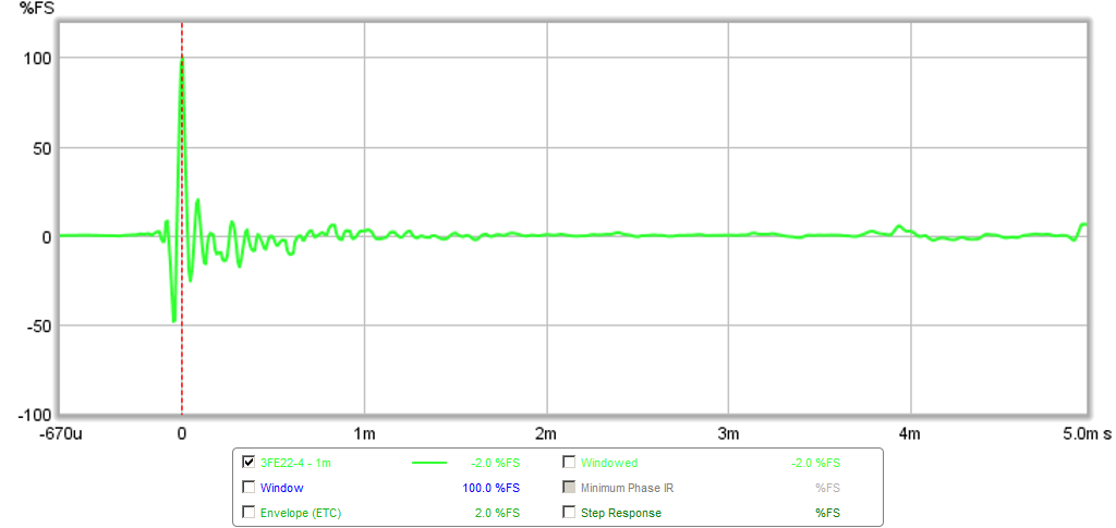

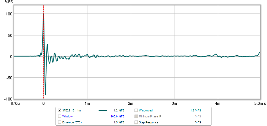

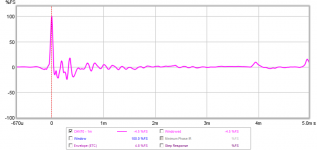

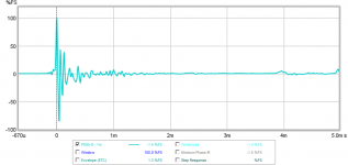

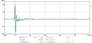

Here are the IR's.
TC9FD
3FE22-4
467119d1424470846-objective-comparison-3in-4in-class-full-range-drivers-3fe22-1m-ir.png
3FE22-16
467120d1424470846-objective-comparison-3in-4in-class-full-range-drivers-3fe22-16-1m-ir.png
RS100-4
467121d1424470845-objective-comparison-3in-4in-class-full-range-drivers-rs100-4-ir.png
RS100P-4
467122d1424470845-objective-comparison-3in-4in-class-full-range-drivers-rs100p-4-ir.png
I see what you are saying, there is a very small reflection at 3.9 ms. That is 48 in - not sure what that corresponds to because the reflection of the floor to the mic is measured to be 96in.
Yup, there's one at 3.9 ms and one just before 5 ms. I calculated 4 feet from the peak/dip cycle also.
The reflection could be baffle related also. For example, if your baffle edge is 2 feet away from the center of the driver, you will see the reflection at 4'. You could try gating out the 3.9 ms reflection and see what you get. Also, 1/24th might be enough resolution. I know I asked for 1/48th but I had the full IEC baffle in mind.
Thanks again for your hard work!
I agree with ra7, it looks like you need a 3ms gate. Typical of the home environment. Measure at 0.5 or 0.75m and you could probably get away with 4 or 4.5ms. This is why going outside is really helpful. At 3ms you data won't be very good below about 1000hz and will be useless below about 400hz. You could add a bat of insulation on the floor and ceiling to try and slow down the reflection but it'll only get you maybe 1/2ms. Maybe.
EDIT - The reason I suggest 3ms and not 3.9 is because you need to allow for some of the taper in the gating. It's not a brick wall. You can do about 3.5ms and let a little bit of the reflection "sneak past" but for the cleanest picture up high I'd go with 3ms.
