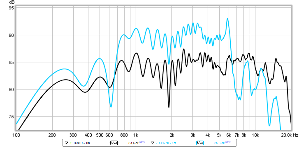

The CHN is decidely better than the Vifa despite what your graph says (and given some of the latest comments about measuring distance and proper gating, not very accurate measures). If you are measuring before you listen you may well be adding expectation bias to your listening session -- i have seen a lot of that.

I can't believe you're saying that the measurment is not accurate. They were all made under the same setup. If you look at factory graphs of the other drivers, you will see they pretty much match what I measured despite the so called "not very accurate measures" you cite. Next thing you will say is that my microphone calibration is off. The MA factory graph is the only one that is way off - even without the dips, the high end falls off way faster than the factory graph claimed. I have no expectation of what it sounds like when listening to it - folks just have to take a listen to the clip without EQ and judge for themselves.
I will add that all your claims and arguments are anecdotal and subjective. The title of this thread is objective comparisons. Show some data to back your claims or this will just turn into another thread debating how one driver has more "x" than the other. Replace x with the favorite non measurable non quantitiative subjective descriptor like DDR, presence, immediacy, speed, resolution, detail, etc

How do you measure "low level detail"? Presumably that detail has a pitch, right? So the frequency responses show, thus far, that the VIFA produces them more accurately than the MA.
What other measurements are needed?
Are you saying the VIFA smears detail? Energy storage that would make for a terrible CSD?

Yes, on-axis frequency response will not tell you everything; a group of measurements are needed. But it is the single most important measurement that correlates most with what we hear. We start here.
...If you look at factory graphs of the other drivers, you will see they pretty much match what I measured despite the so called "not very accurate measures" you cite...The MA factory graph is the only one that is way off - even without the dips, the high end falls off way faster than the factory graph claimed.

I've never seen a good explanation for why users here can take measurements of drivers produced by other manufacturers that prove to be accurate, yet no-one can seem to get close with MarkAudio drivers.
If we assume that MarkAudio's measurements are accurate, then his drivers must posses some unique property that makes home measurement impossible. I say "unique" because it seems no other manufacturer's products are imbued this property.
What is so special about MarkAudio drivers than makes them impossible to measure at home?

How can you even try to compare them? MA graphs are taken in an anechic chamber on an IEC baffle, with professional gear, by professionals.
Not that i am defending MA measures -- i don't care one way or the other -- just that the connidions between yours and his are so different that comparison is meaningless.

I have presented dozens of objective graphs, and careful secondary tests of the CHN70 because it was the only one that deviated so far from the factory data. Even with the microphone based acoustical response measures, how does one explain the deviation in the measured free air impedance? The 700Hz blip is less than 0.3ohm in the factory data and maybe 10x greater in reality. That is a big difference.
What objective data have you presented thus far? I have yet to see single measurement or quantitative piece of data but a lot talk, anecdotes, and criticism of my measurement setup. It's getting old.

Ok, now we are clinging onto the need for identical anechoic chambers and $2k mics and $10k LMS setups before any non "meaningless" comparison can be made?
Regarding professionally made measurements and the comment that I have only been at diyAudio for 2 years: you are bordering on prohibited personal attacks there. You do not know my background and the extent of my experience with pro grade mics, acoustic measurement testing, use of transient digitizers, spectrum analyzers in my former daily professional life, before I appeared on diyAudio.
