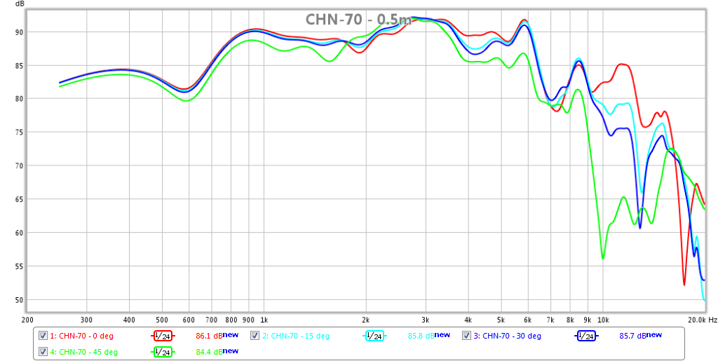

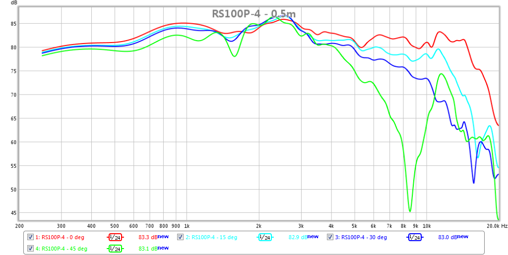

X, could you revise the plots for the CHN-70 and RS100P-4 to 5 dB imcrements as well, even as that means some info falls off of the plot scale?
I had to remind myself it is a 10 dB scale because the off axis response seemed to trace on axis better on these two (after equalisation on axis it would seem superior) based on the plot as posted.
As presented, even with the side note both look like they behave better than they actually are.
I think the CHN-70 does indeed have a more consistent polar response, although it achieves this by having little to no output in the 14kHz to 20kHz range so beaming is not as much of an issue. But pehaps as you say, equalizing it will boost the HF's uniformly across the angular spread. I am working on getting the 5dB plots. I had to transfer the native REW files onto a bigger laptop with larger screen to produce larger plots. While I am at it, I want to make some spectral decay contour plots (spectrograms) but unsure of what parameters to use for the window gating to produce the data. Maybe 10ms window and 4ms gate consistent with the other data?
Polar data at 0.5m at 5dB/div with 4ms gate
I am re-posting the plots for the RS100P-4 and CHN-70 at 5dB/div vertical scale as requested by several members. I will include the previous plots for easy comparison.

RS100P-4 (revised 5dB/div):
467256d1424529694-objective-comparison-3in-4in-class-full-range-drivers-rs100p-4-polars-0.5m-4ms-gate-5db.png
CHN-70 (revised 5dB/div):
467257d1424529694-objective-comparison-3in-4in-class-full-range-drivers-chn-70-polars-0.5m-4ms-gate-5db.png

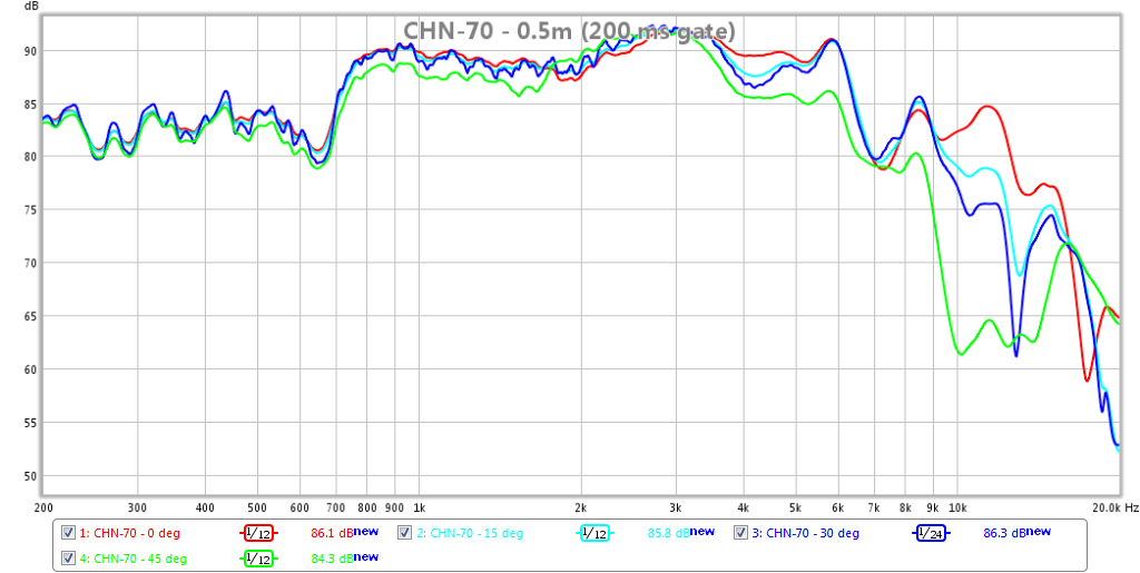

For comparison, this is what the 0.5m data looks like with a 200ms gate - still the same general response but there are some small wiggles due to reflections causing combing effects in the lower frequency range. Note that the upper frequency range and the rapid HF fall off is independent of gating. That is, gating should not be blamed for a response in the HF that doesn't match expected performance. Also note that the longer gate allows a higher frequency resolving plot that shows, more accurately, just how steep the cliffs are on the 700Hz to 7kHz plateau is - as Byrtt mentioned previously, this steep wall will wreak havoc on phase and group delay:
467258d1424530245-objective-comparison-3in-4in-class-full-range-drivers-chn-70-polars-0.5m-4ms-gate-5db-200ms-gate.png

Thanks again X for the off-axis measurements. The new 4ms gated measurements look very good indeed. There is no doubt that these measurements quantify differences between the drivers under comparison.
Looking at the Vifa measurements, it is flatter and the response is even in a 60 degree window. Looking at the more even CHN70 measurements, it looks like the the highs are more even, but the response is quite ragged. IMO, the 700 Hz blip on the CHN70 is where the cone decouples and hands over to the center element, kind of like a whizzer cone. I have seen traditional whizzer cone designs where the handover happens at > 2 kHz, so this is something new. Wonder if the other MA drivers work this way. The impedance graph on the other drivers should show where the handoff happens.

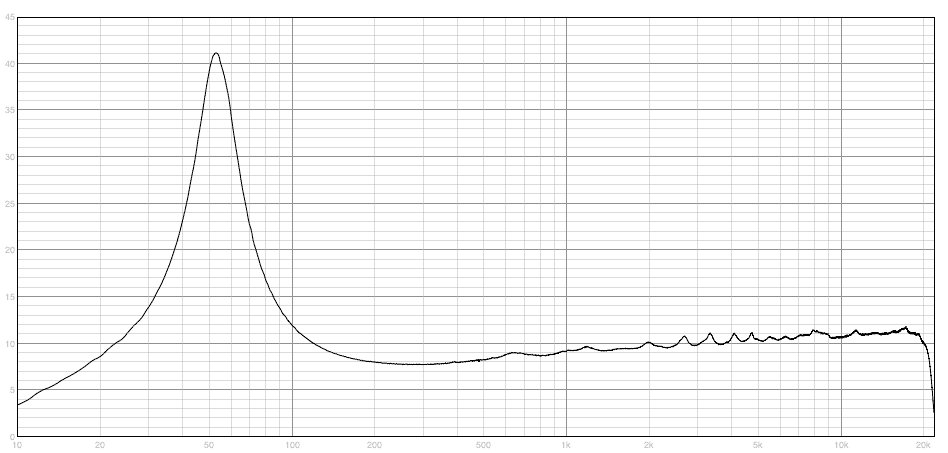

Ra7,
Thanks, I think the data looks pretty good too - not sure if it will make the "Believers" change their views though. I can take impedance sweeps of all the drivers as that is an easy test, but I have yet to see another 3in or 4in whizzercone-less driver have a big impedance blip like that. At 700Hz that is way too low to say it is where the driver transitions from pistonic to cone break up mode for HF's. That generally is around 6 to 8kHz for this size driver.
Not saying it transitions to cone breakup, but that it transitions to the center element in the driver, the thing in place of the dustcap. Some other larger drivers, like the FE206 have a central whizzer element and the large cone sort of rolls of and the whizzer radiates the high frequencies. It's like a mechanical crossover. I'm saying the MA drivers could be designed such that this handoff happens at a much lower frequency, where the impedance blip lies. Just saying it may be one reason why the response off-axis follows the the on-axis even above 5 kHz, because a smaller element is radiating.
🙂 just Re and Le in sim. But listening to earlier MA paper unit difference heard seems bigger than simulated difference, maybe components in sim are too perfect or.. well don't know.
My MA is metal 10.2 and at listening (subjective) it goes wrong when adding R this driver and have a guess it's the softer elastic you add at electric dampning that degrade it because this one likes resonance (RLC) and inductance (RC) compensation filters which raise sound quality and tighten the electric elastic.
Actually, I suggested the same thing earlier in this thread but told by the Expert that it is otherwise, and related to the pistonic transition:
http://www.diyaudio.com/forums/full-range/270094-objective-comparison-3in-4in-class-full-range-drivers-2.html#post4231325
But as it is occuring at 700Hz, I would have to agree with you and assume this is more related to the mechanical XO going on from the cone to the button shaped dustcap.

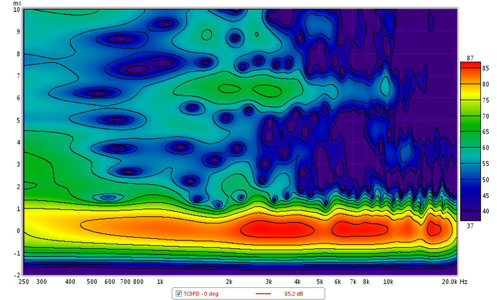

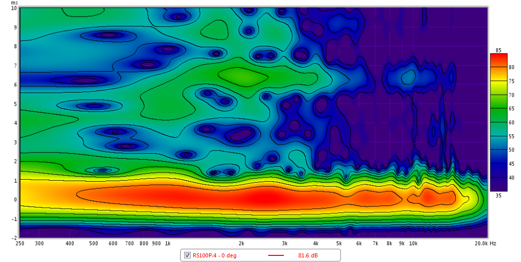

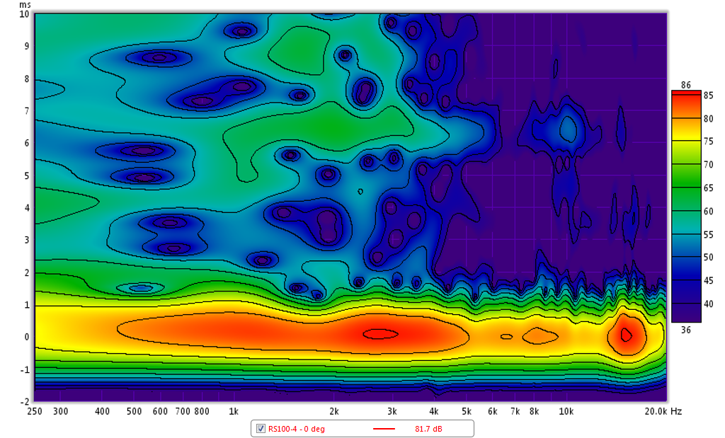

Temporal Decay via Spectrograms

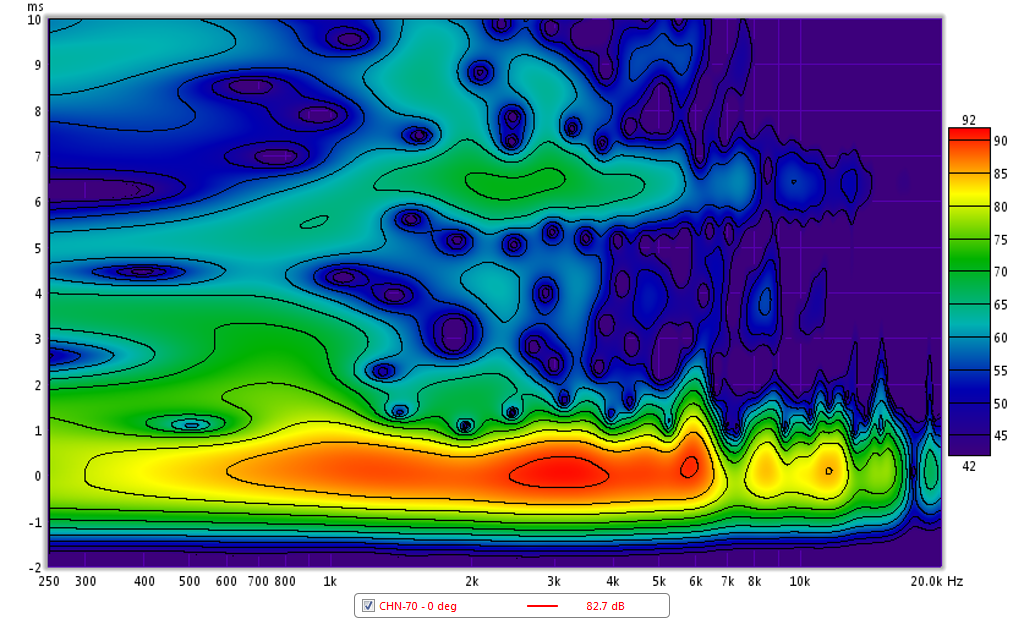

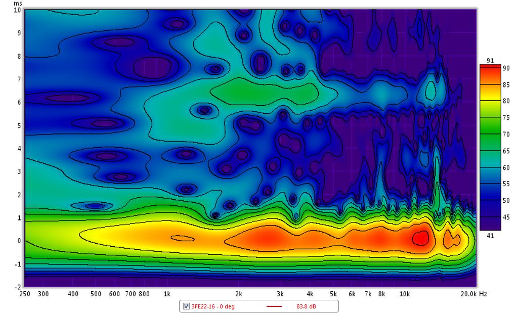

Here are some spectrograms calculated by REW - I used a 4ms gate and 10ms window setting. If anyone knows or thinks there may be a better setting for the calculation, let me know. I think this is useful for seeing the decaying tendrils of resonance peaks - any vertical persistance is ringing in the time domain. These are all for 0 deg on axis measurement at 0.5m with drive level set at -10dB below 2.83v (same as previous set of plots). I think that everything beyond the 4ms gate is a reflection from some hard object or boundary nearby, and under 4ms though, that is the real (intrinsic) decay of the driver - I think same as the CSD but in a color contour plot.
TC9FD:

3FE22-16:
467277d1424536065-objective-comparison-3in-4in-class-full-range-drivers-3fe22-16-spectrogram.png
RS100-4:
467278d1424536065-objective-comparison-3in-4in-class-full-range-drivers-rs100-4-spectrogram.png
RS100P-4:
467279d1424536065-objective-comparison-3in-4in-class-full-range-drivers-rs100p-4-spectrogram.png
CHN-70:
467280d1424536065-objective-comparison-3in-4in-class-full-range-drivers-chn-70-spectrogram.png

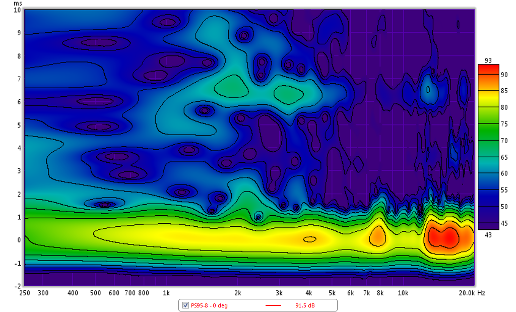

PS95-8:
467281d1424536065-objective-comparison-3in-4in-class-full-range-drivers-ps95-8-spectrogram.png

That looks much better. Thanks for doing it. The Faital Pro makes me interested for a mid in a 3 way.
Only last thing I would recommend, is stating the limitations of the test clearly as you've seen people can misunderstand easily. In this case it would be the test is not useful below 1/0.004 hz and not very detailed below 2.5/0.004 hz. Also mention any smoothing, polar angles, etc. That sort of thing helps people view the data in a more concentrated fashion. I've been there. I once tested the alp 6 and FF85wkEn together and posted here. They were in different boxes and even though I alluded to that, some people lost their mind because of this. They didn't understand it was expected of the viewer to judge the data based on the box sizes I had them in. It was my lack of explanation and their lack of knowledge that lead to quite a frustrating conversation. 😱
Good points. I will be sure to add limitations of data presented in future plots. Maybe embed right into title provided by REW.

Actually one can say that all FRs work like this more or less.Often one will see a train of smaller impedance peaks as there are a number of transition points.
Attached an Audio Nirvana Super 10.
dave
