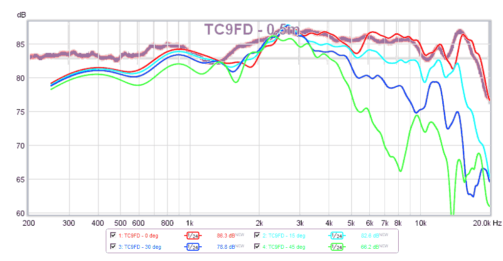

Because they were taken under invalid measuring conditions... they broke measurement guidelines.
And are different. Your earlier 12.x cm VIFA FR (rescaled tomatch) in the background of your 1/2 m measure.

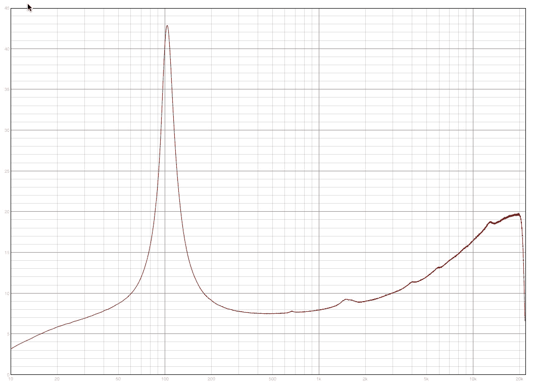

Here is the impedancs curve of a FE127e. It has an uncontrolled resonance peak at about 7kHz and another at about 11kHz, but is startingyo go into resonant behaviour at about 650 Hz, As i mentioned earlier it also shows a train of resonances as frequency increases.
attachment.php
dave
That difference in the LF is due to gate of 4ms giving 250Hz resolution. If I increased the gate at 0.5m it would match (average) but have ripples due to reflections.

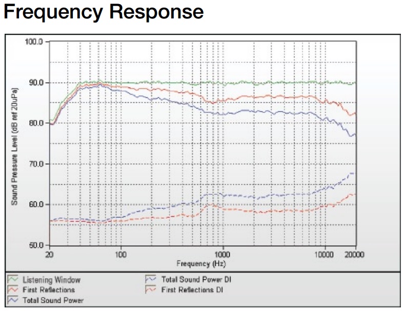

attachment.php
do you want the reproduction to happen on a speaker with this response (looking at 200 Hz onwards only)?
(Note the different scales in the two measurement. JBL's measurement is on a 50 db scale with 5 db increment lines. The second measurement is on a 75 db scale with 20 db increment lines, making the variations appear to be smoother than they are.)
