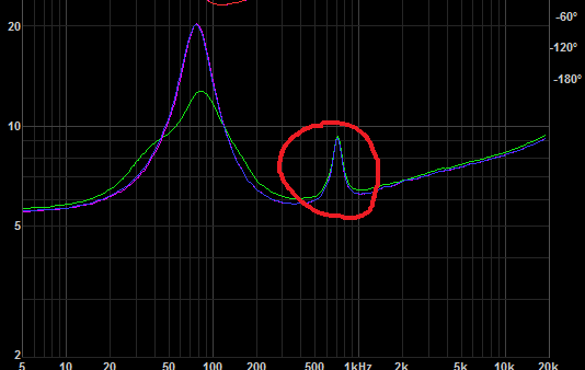

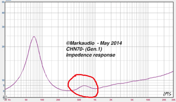

You assume that T/S (which are derived from the impedance curve) are scalars, they are curves. XRK will be measuring at a different place on the curve so his, vrs factory imp curves could both be correct because they are made under sifferent conditions. He also seems to be using DATS which, if it works at all, is of questionable accuracy,
Your comment only shows a lack of understanding of how a driver works.
My T/S measurer (Smith & Larson woofer tester 2) is very good but it measures t/s the old way (as opposed to many tools that estimate from the impedance curve) so does not produce pretty highly detailed impedance curves by default -- it can do pretty, highly accurate curve but i may have to remeasure or reprocess the (CHN & VIFA) data i have. To use it i have to reboot my MacPro into Windows XP (which is crap). I will look at getting presentable data sometime next week,

Not necessary the line you talk down on me I'm full aware you a library of knowledge regarding speakers compared me, try differentiate when to take PRO hat on verse DIY hat. Subject is not how a driver works and i don't understand that as good as you, subject is measure its impedance and weird i shall learn you that opposit a microphone which is impossible to check its precision in home facilities a DATS device is a measuring tool which can be calibrated and precision checked via a reference R L or C. Having calibrated it and checked a reference component you have a fine instrument. Personal have DATS v1, seen xrk971 have the brand new DATS v2 released think around new year which deal with problems that non experienced users could run into.
Great you will throw in CHN70 and TC9FD data later but what is wrong the data you already have "QUOTE (CHN & VIFA) data i have UNQUOTE" do it need smoothing before revealed, attach CHN70 datasheet verse xrk971 plot, different conditions can't explain that.
My point is that you are trying to directly compare impedance curves taken under different conditions that are not necessarily comparable. I am not either is wrong, or either is right. They both could be. Just that the measuring conditions are so different you cannot compare them.
As an example, here are the T/S parameters taken of the same FE127e, one set by me with my (old) impedance jig and one by Mark's (with factory numbers thrown in for reference). They are both valid. And they are very different. You cannot say one is wrong because they are so different because the measurement conditions were different.
