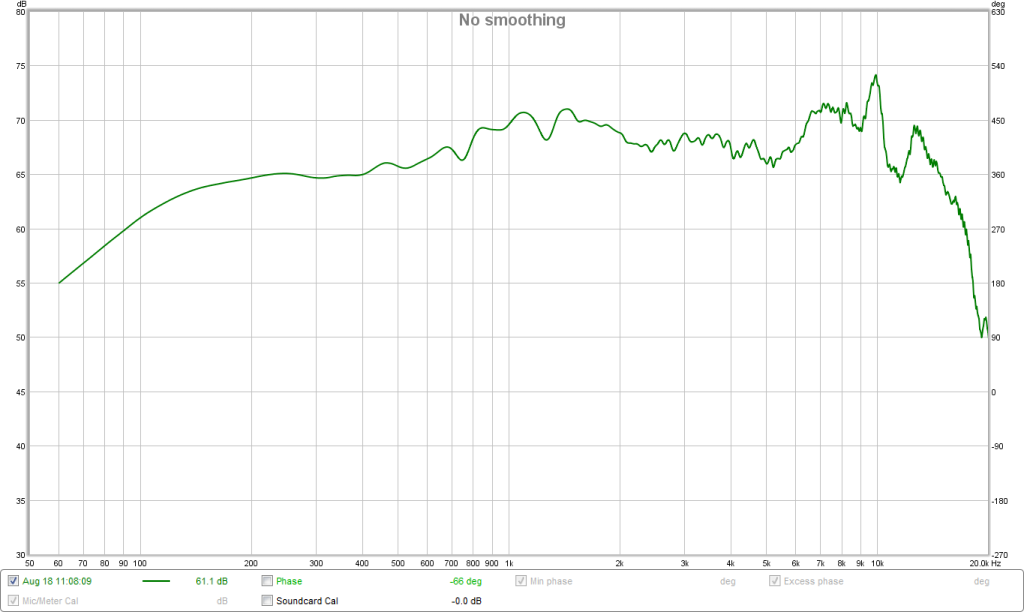

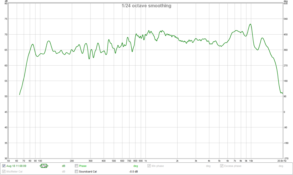

Tony, thanks for the measurement. SB Acoustics makes good quality, competitively priced drivers. In fact, their drivers are probably the most value for money out there right now.
Could you repost the measurement with a 50 db scale and 5 db increment lines? That slope up below 1000 Hz looks smooth on your graph, but it's actually a +5db climb. Can be eq'ed no problem, but I want to highlight how a large scale on a graph makes everything looks smooth. The standard setting should be 50 db range and 5 db increments. If you gate all the reflections, you need little to no smoothing. We don't want to lose the details.
Check out Tux's measurements here (the correct amount of resolution):
http://www.diyaudio.com/forums/full...udio-alpair-6p-tested-against-each-other.html
Hi ra7, I took this measurement with REW to get the distortion info. I normally use Holm Impulse but don't have those measurements to hand. I've re-presented with 50db range, with 12th octave smoothing. Unfortunately I don't know how to use the gating in REW otherwise I would show a gated measurement (which would definitely be preferable. It would probably have resolution down to about 200Hz.
I've also attached the impulse response, you can clearly see a substantial reflection at around 22 ms.
Tony.

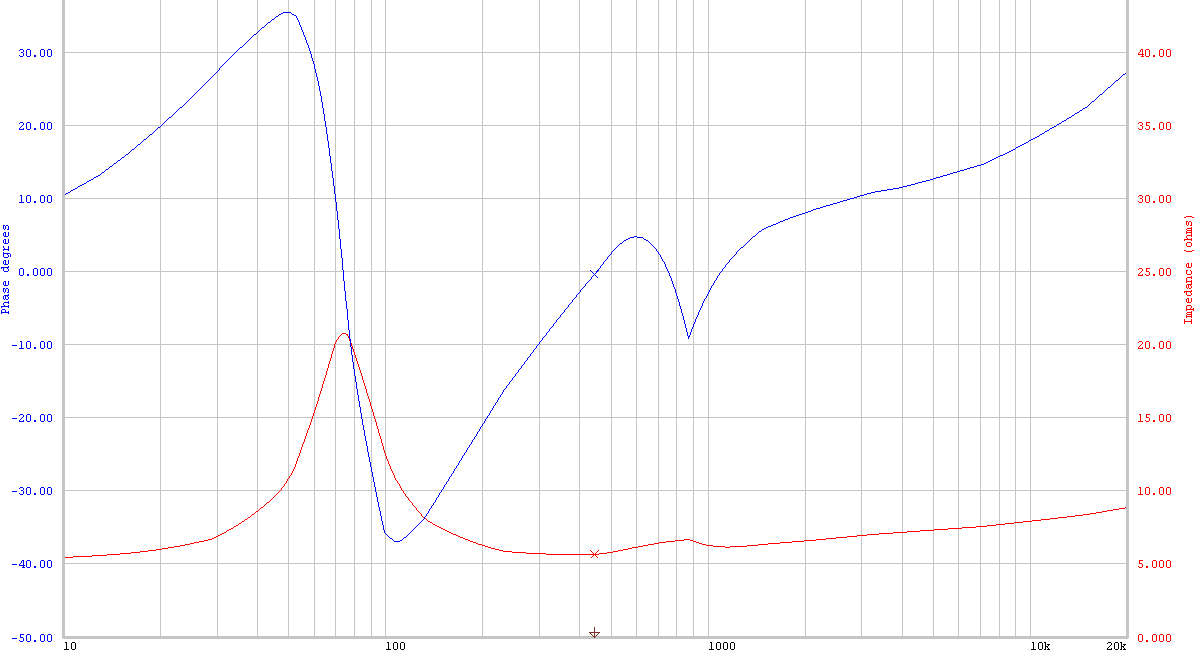

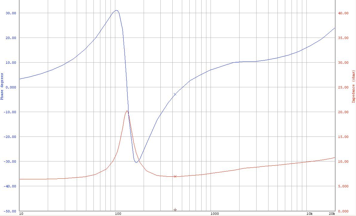

I said earlier that i would be doing T/S measures this week.
Here is the CHN-70. The magnitude of impedance bump at the transition frequency is consistent with Mark's data.
attachment.php
The little VIFA has a VERY smooth impedance cutve -- xonsistent with my guess that the cone/suspension id heavily damped (leading to both smooth FR and poor DDR), so it is hard to see the transition frequency but i would say just above 2kHz,
attachment.php
Graphs generated with Smith & Larson Woofer Tester 2
dave

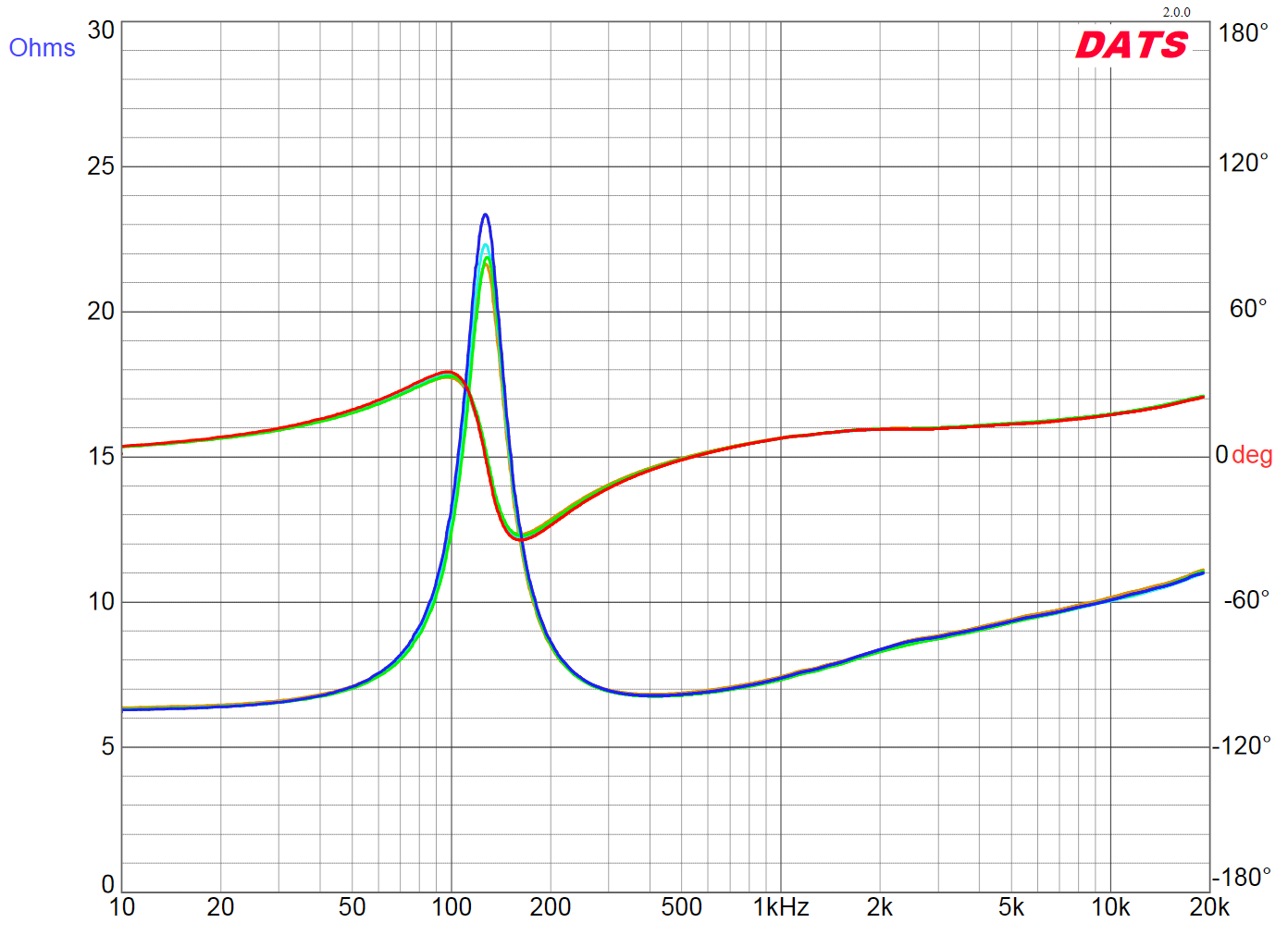

Thanks your impedance plots CHN70, for me the phase mirror looks strange but I'm not a pro and will have to investigate. Your one is different than xrk971 one and will keep an eye in future to see other ones to discover if i have to prepare excuse for the words said about datasheet out of spec.
Regarding if DATS in this case v1 is reliable tool attach plot 4 x TC9FD drivers very much match yours.
