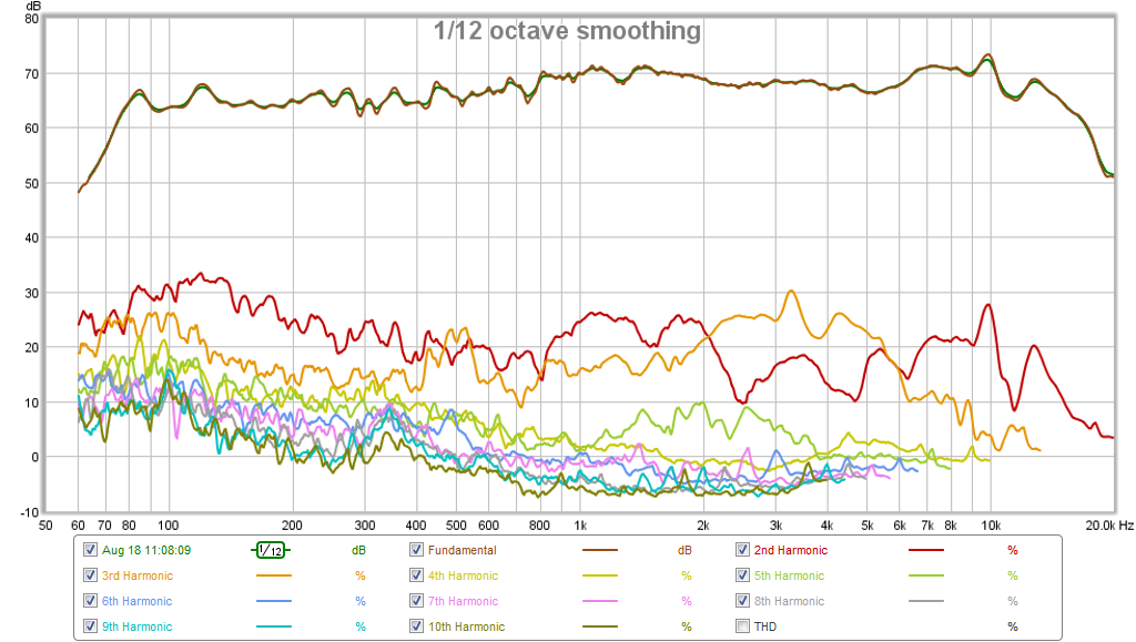

xrk here is a measurement of a 4" driver that I have. It's not a full range (it's actually a midrange) but I like to push the boundaries so used it as a "full range"
I don't have the details of the measurement except that it was taken outside, there is no gating, and it is 1/12th octave smoothed. It's in a reflex enclosure with small baffle and is showing full baffle step.
I's an SB Acoustics SB12MNRX25-4
actually another measurement (with some explanation) here http://www.diyaudio.com/forums/full...-4-full-range-build-thread-3.html#post3599708

I could see this as being quite pleasant with fair tonal balance, assuming wise placement or straight-up BSC is used.

Wintermute,
Thanks for the measurement plot of your speaker - I remember following your thread on this build. Looks like a fine driver with an even response and usable extension up to 12kHz or so. There is a mild breakup peak at 10khz but clean otherwise.
I've yet to do polars of it. but it does have a very neutral sound. A little bit harsh in the top end.
Note that my mic is not calibrated, but it is a wm-60AY which are renound for being very flat. certainly tweeter measurements would indicate it as being so, but it is what it is, ie uncalibrated.
I thought I'd post it because a lot of people look at full range drivers for possible use in a multiway with helper woofers and super tweeters. I think this driver is very good for that, but would be good to do off axis measurements as well.
Tony.
