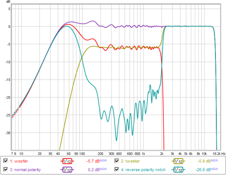

Here is a result from my latest DSP based speaker:
From thread that I posted:
http://www.diyaudio.com/forums/mult...sum-monopole-dipole-speakers.html#post4227362
