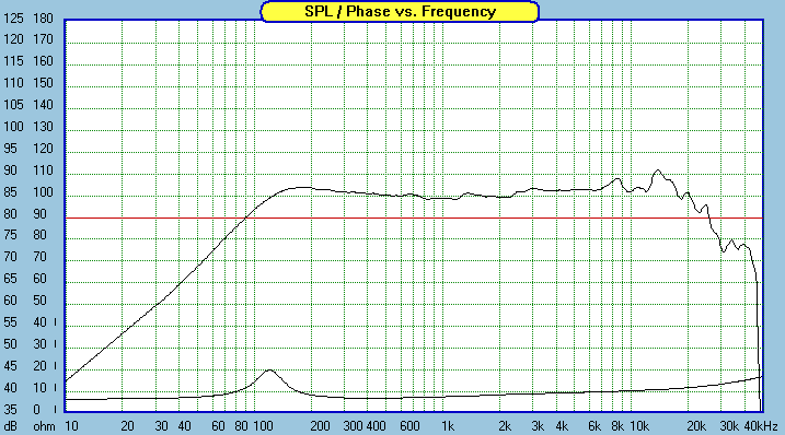

I don't read Japanese. What box was this tested in? Looks like both drivers are similar with Scanspeak having a bit more smoothness up on top. Both need serious BSC and both have some room cancellation dips going on or this is the output of a TL. Where is this link from?
That is kind of creepy to have a plot that is alive and flips back and forth.

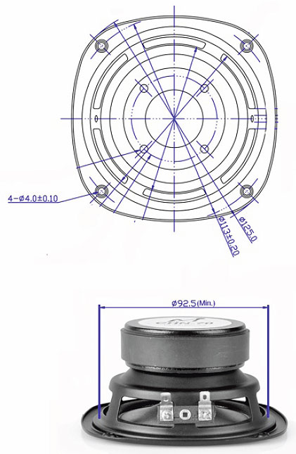

By looking at the speaker's dimensions, I notice that it has a combination of a very shallow metal basket combined with an extremely large magnet mounting plate and magnet. ALL the back wave goes sideways. My hypotheses is that in x's narrow and deep Nautiloss enclosure, the back wave was pretty much choked and not able to use the infinite baffle nature of the box. That may explain some of the plot's problems. I would like to see a plot with the speaker back mounted on a simple flat open baffle.

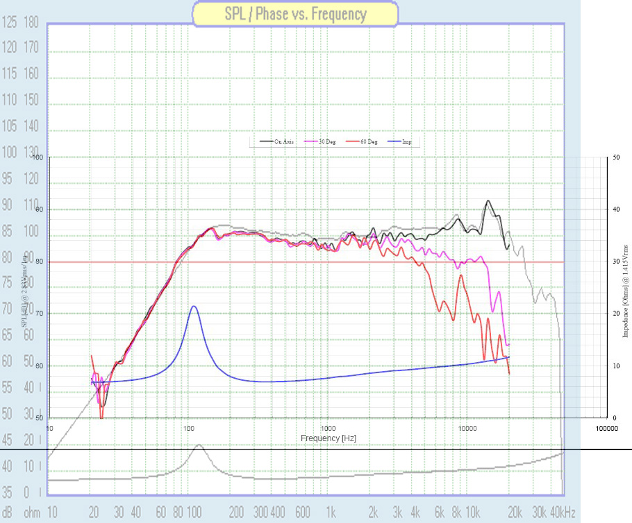

I don't get the why of posting this Vifa/Scanspeak graph as it does not seem to be a measurement valid for this thread. If you were looking for a validation of the official Vifa published measurements look at Zaph's website. He posted measurements of the Vifa showing a remarkable resemblance to the original published graphs.
If I remember correctly Owen (member name opc on here) supplied the 2 samples back in 2011. Here's one of the two graph's already uploaded here on the site.
Source of the graph: http://www.diyaudio.com/forums/multi-way/193015-stupid-cheap-line-array-10.html#post2798193
So that matches the rising high frequency response from the published specs from a driver in 2011.
Indeed 2 reasons, SS 10F was mentioned couple of times and no other measurements than those presented here have peakrespons for ~2.5khz with Vifa, they all have peakrespons at ~14khz.

There is something funky about those graphs. First off all, the scale is 120db, it is completely useless for evaluating the response. Secondly, one does not expect such a large slope in the response. Something is off.
Scale is funny and seems intended to show little difference between the 2 units. The slope in the respons is as close to Vifa's measurement as Zaph is, both are off, the Japanese shows a little bigger slope, Zaph a little less slope than Vifa themselves.
I wouldn't say Zaph's measurements are that far off from the original.
Once you adjust the scale to match they are actually quite close:
One might argue which graph is more accurate but you'd have to agree that they are similar.
This does show how important the scale is if comparing drivers. They have to be exactly the same to get a good first impression.
The Japanese graph shows many artefacts that are (too) similar between the Scanspeak and Vifa. So were looking more at a speaker/room graph than a driver in that case.
Yes lineout graphs either on 2.5k or 14k (highest output xrk or Vifa's graph) and Vifa's own is in between Japanese and Zaph. xrk's looks more like the Zaph/Vifa off axis respons btw ,is baffle material functioning as cone too, they did use the material with exciters with some succes in another thread, is microphone membrane mounted angled in xrk microphone??
