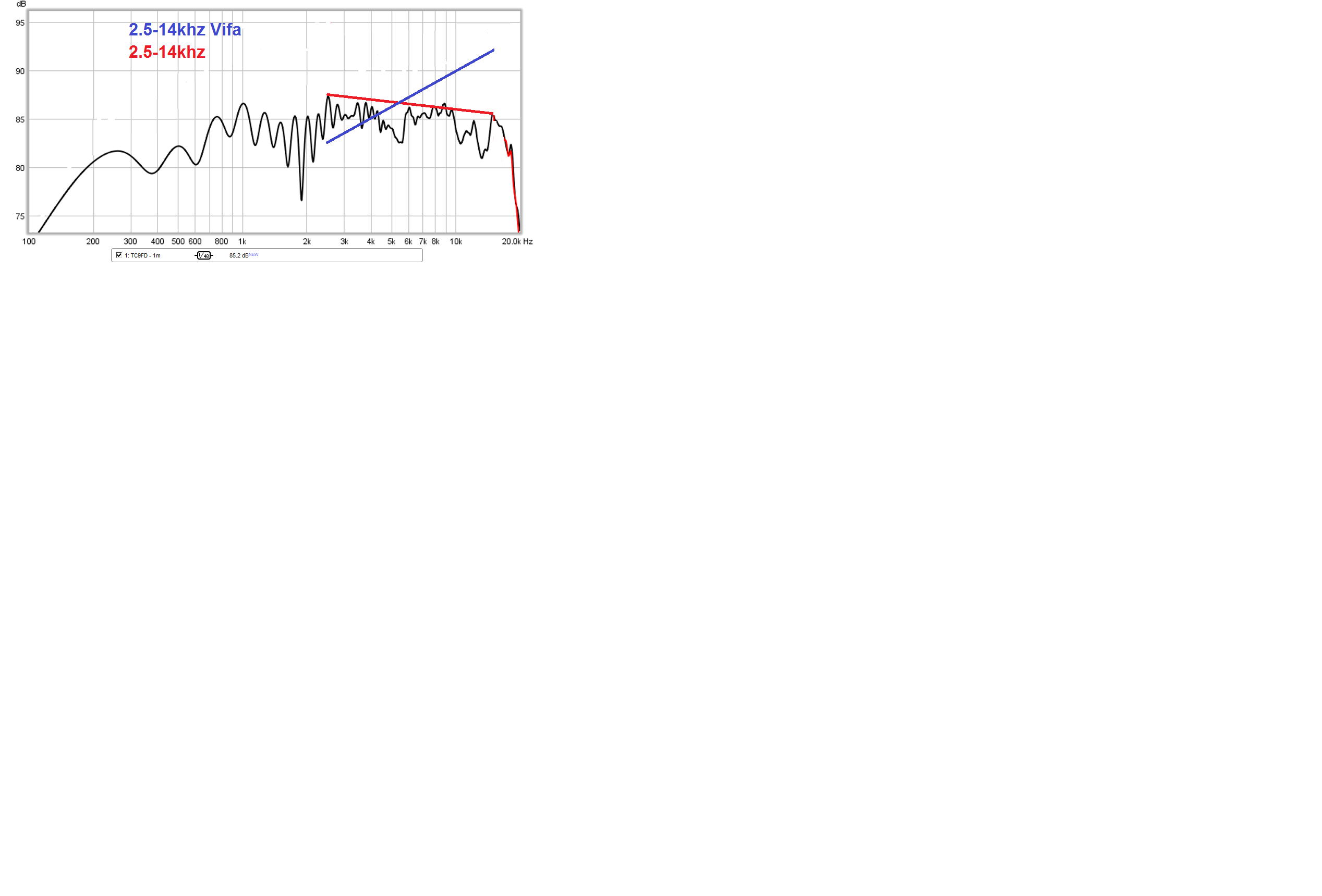

post #20 graphs I looked at, 2.83v 1 meter. Your highest point in graph vs value Vifa's measurement on PE and ~14khz where it kind of ends. Blue line is PE Vifa these 2 points connected and that actually resembles what Vifa graph shows, rising respons, and with red what your 1m 2.83v, similar?, shows.
This may have to do with what an earlier member said about the more recent TC9FD's having a hotter top end (the latest manufacturer's graph) and my unit from circa 2 years ago. Or it could be variability in particular unit. Let me test another unit and see if there are variations. Like I said though, this is a good variation as you don't want that sharp of a peak.

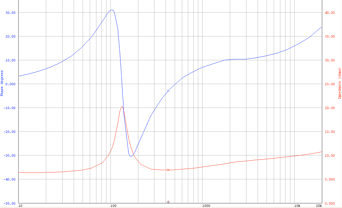

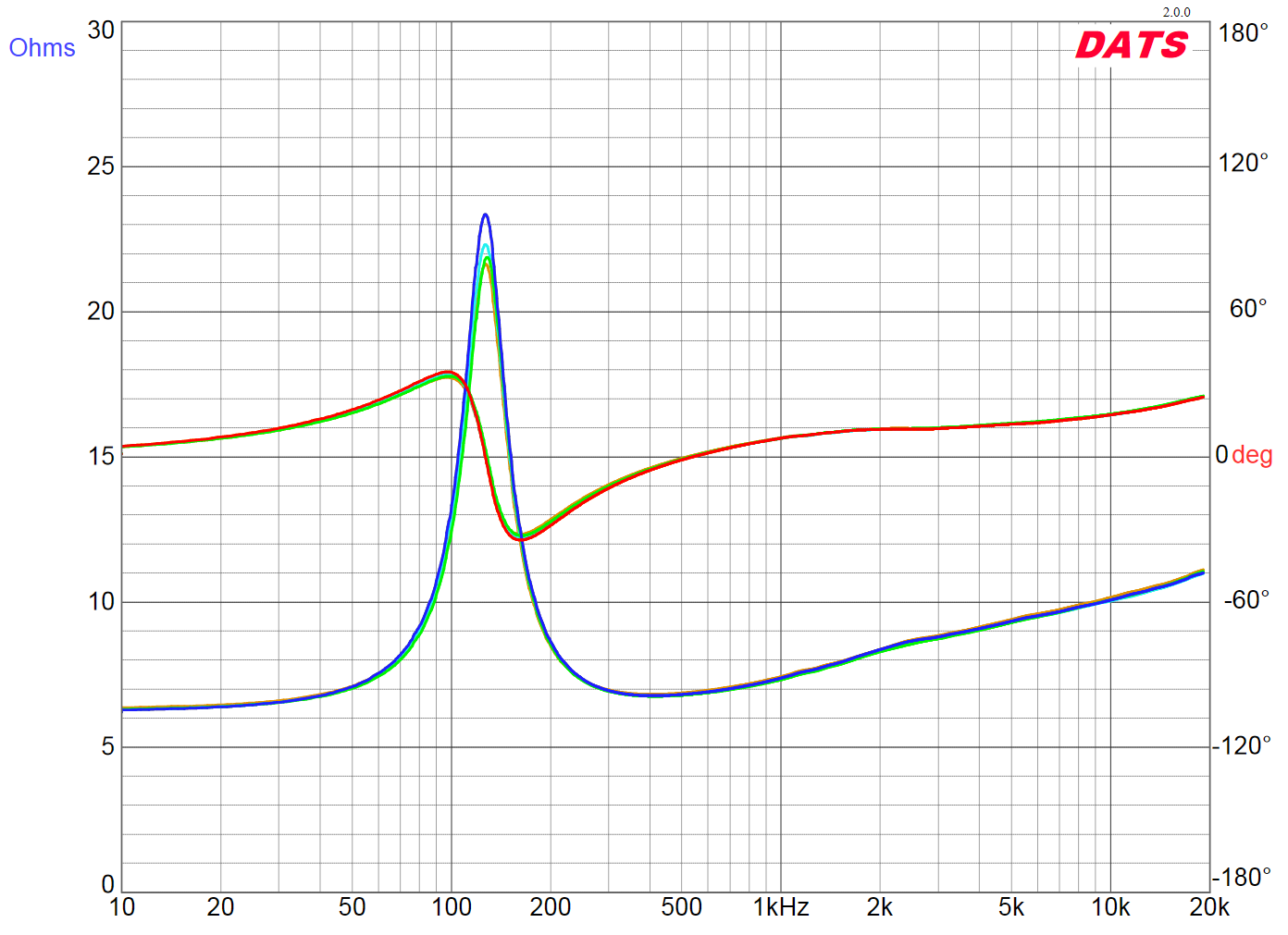

Accurate tools often used by professionals, good enough often used by a diy.
Is a diy device DATS v1 computer calibrated to a reference value good enough try compare the two plots, when calibrated i can actually take a reference R L or C and get expected value readings.
Below both a pro and diy measurements TC9FD, drivers not physical the same my plot show 4 drivers overlayed location is Denmark, planet10 measurement location probably Canada.
Post because can not see why this keep going on when we are at diy site.
Won't do it but could probably buy a CHN70 and planet10 Magnitude figures be amended to 6, 6, 1, 1.
TC9FD planet10 see #343.
![Planet10_TC9FD.gif Planet10_TC9FD.gif](https://www.diyaudio.com/community/data/attachments/419/419337-fd134dbe052f6d61ea94989d69d9ca43.jpg)
TC9FD x 4 see #349.
![TC9FD_Z_curve_4timesDriver.png TC9FD_Z_curve_4timesDriver.png](https://www.diyaudio.com/community/data/attachments/419/419354-85fca2e2bfb507e1a02fd5144ceb1bdb.jpg)

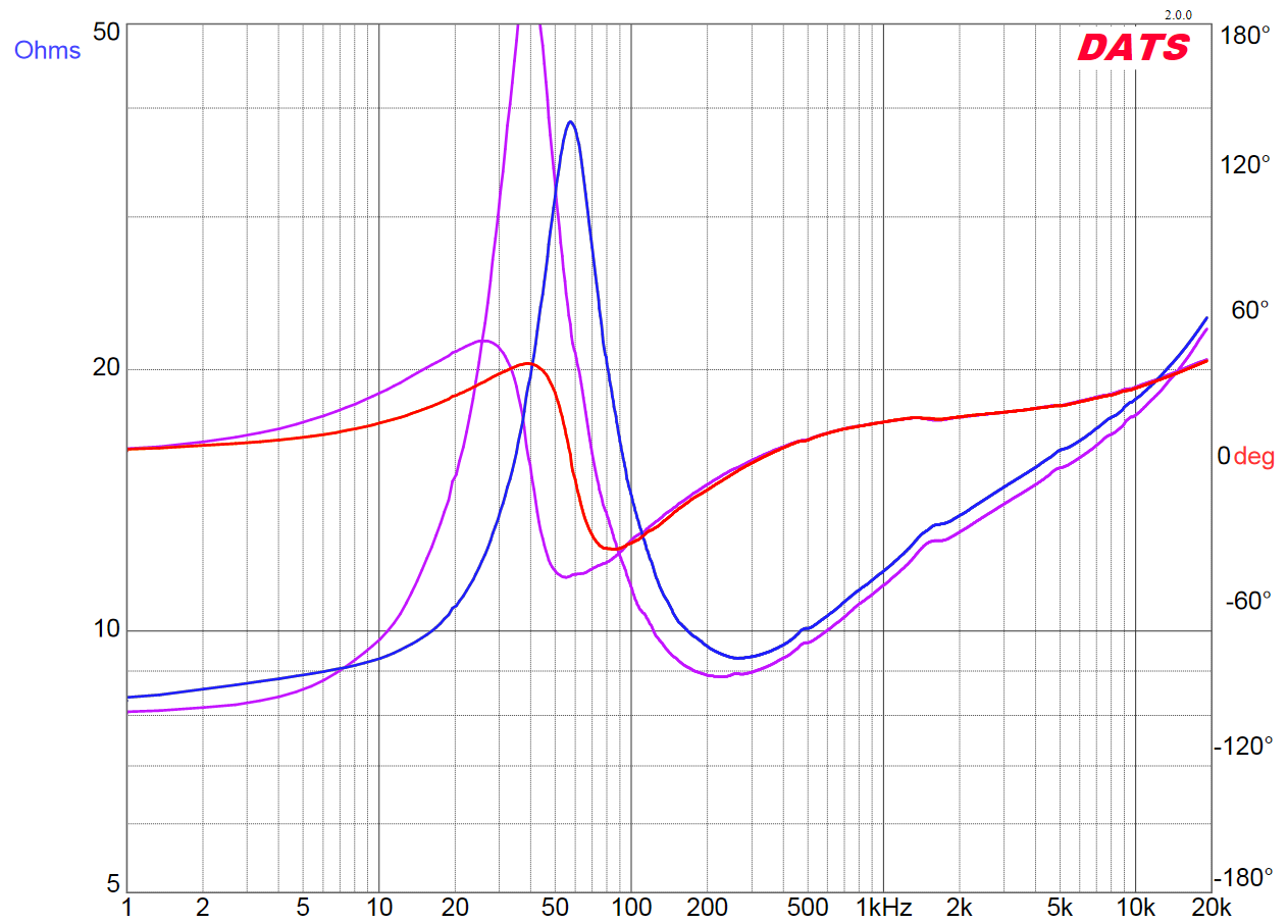

Do i misunderstand or what and which is best no bumps or a train, Vifa above have no bumps.
This one my MA A10.2 show a train, two overlays shown one in free air and other low Q sealed box taken thru 4 meter 0.5mm solid core speakercable for both measurements, this probably make 0,4ohm resistance for each core.
![A10.2_FreeAir_Box.PNG A10.2_FreeAir_Box.PNG](https://www.diyaudio.com/community/data/attachments/419/419179-b4b9b0974ad5f8db3970d70eaa63d58d.jpg)
At brinesacoustics web site A7.3 A12P shows bumps.
