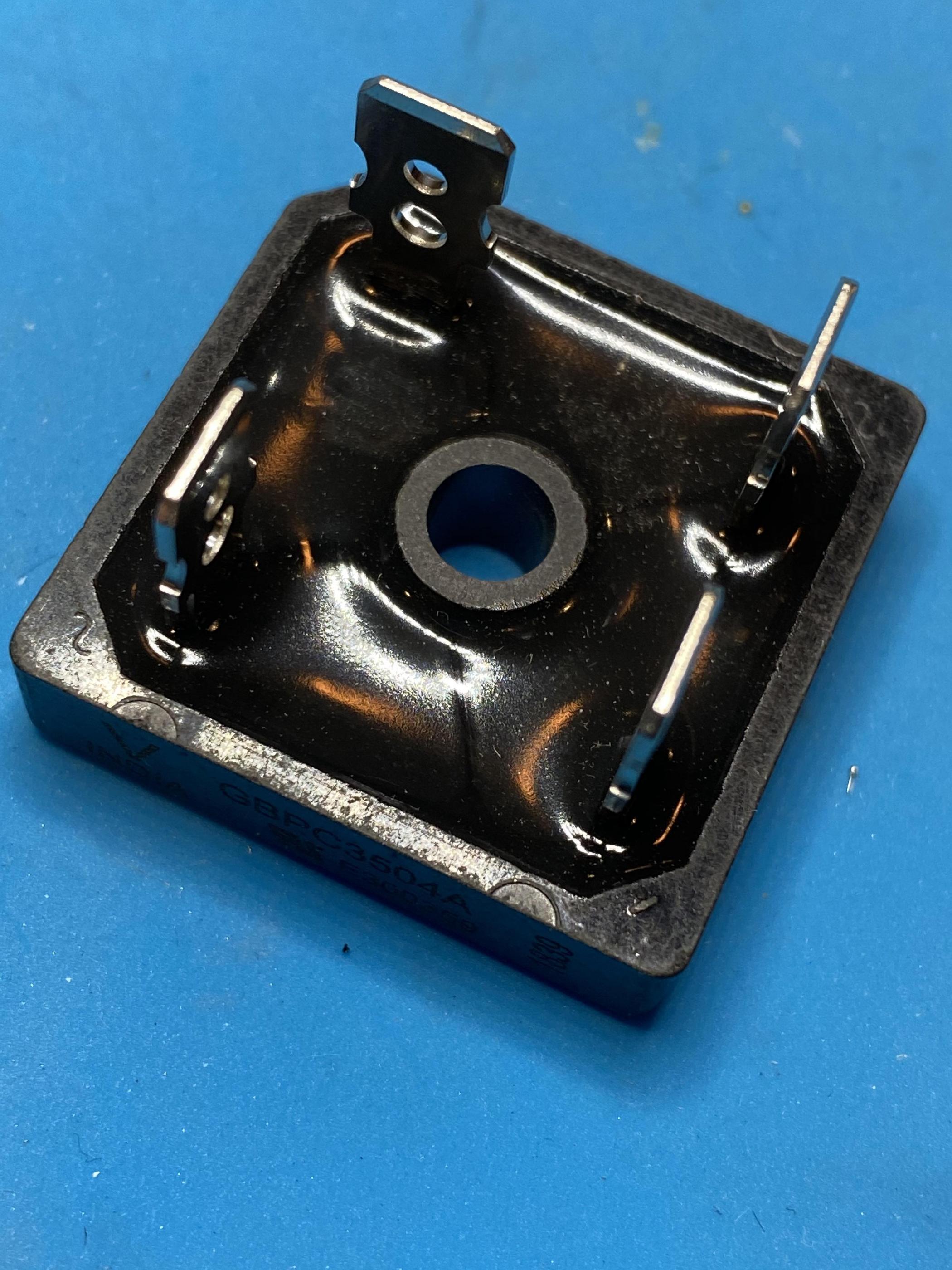

I just took a look at my supply board and it appears you have that connected correctly. However, it is hard to see in the figure but do you have the bridges connected properly? Make sure the AC side is connected to the 2 secondaries and to the bridge's AC side usually indicated with a printed or embossed ~ symbol on both sides. The ones I use have a chopped off corner to indicate the dc+ side and a - symbol on the negative DC side (see attachment). If you connect them correctly, you should see some DC voltage on the DC side of the bridge without any of the rest of the supply connected.
--Tom

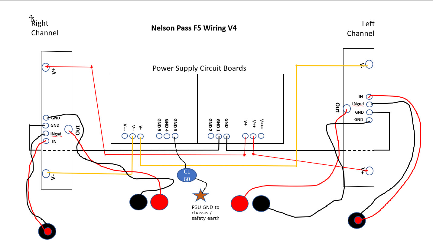

I put up this wiring plan a while ago. But I think I have something wrong.
Shouldn't V+ go to the left channel and V++ go to the right? I have it the other way around in this diagram.
Thanks for your review and comments.

Been an interesting day.
I hooked up the right channel and powered on. The dim bulb stayed on.
I unplugged the right channel and the light dimmed.
I've checked all the wires, things appear to be in the correct place.
What might I consider next to resolve this?
Thanks,
I haven't built a F5 so I can't help you with the amplifier board trouble shooting. However to get the process started, if you post clear, well lit, and high def pictures of the amp overall to show wiring and also individual pictures of the amplifier boards, I'm sure others will help you to get it running.
Also, is your light bulb 100W?
