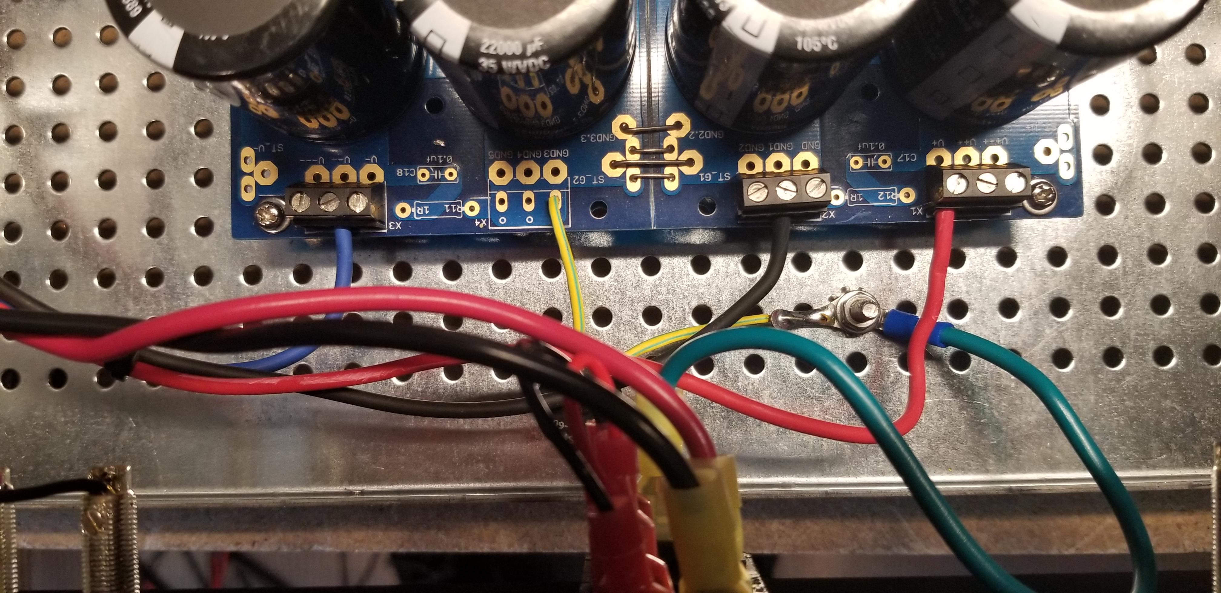

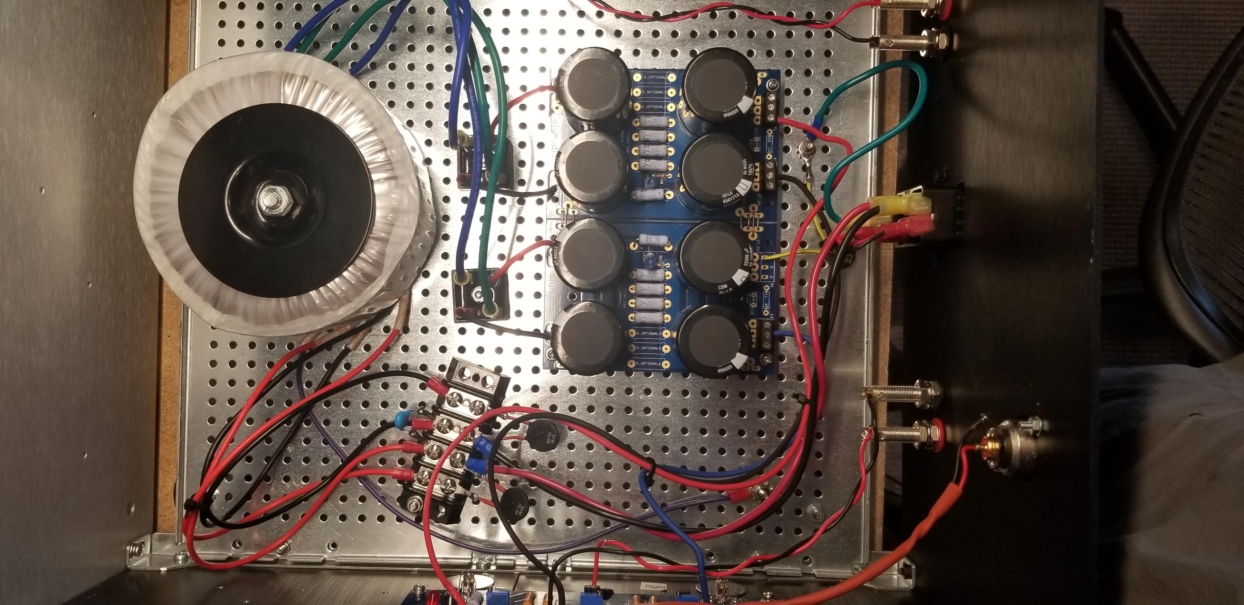

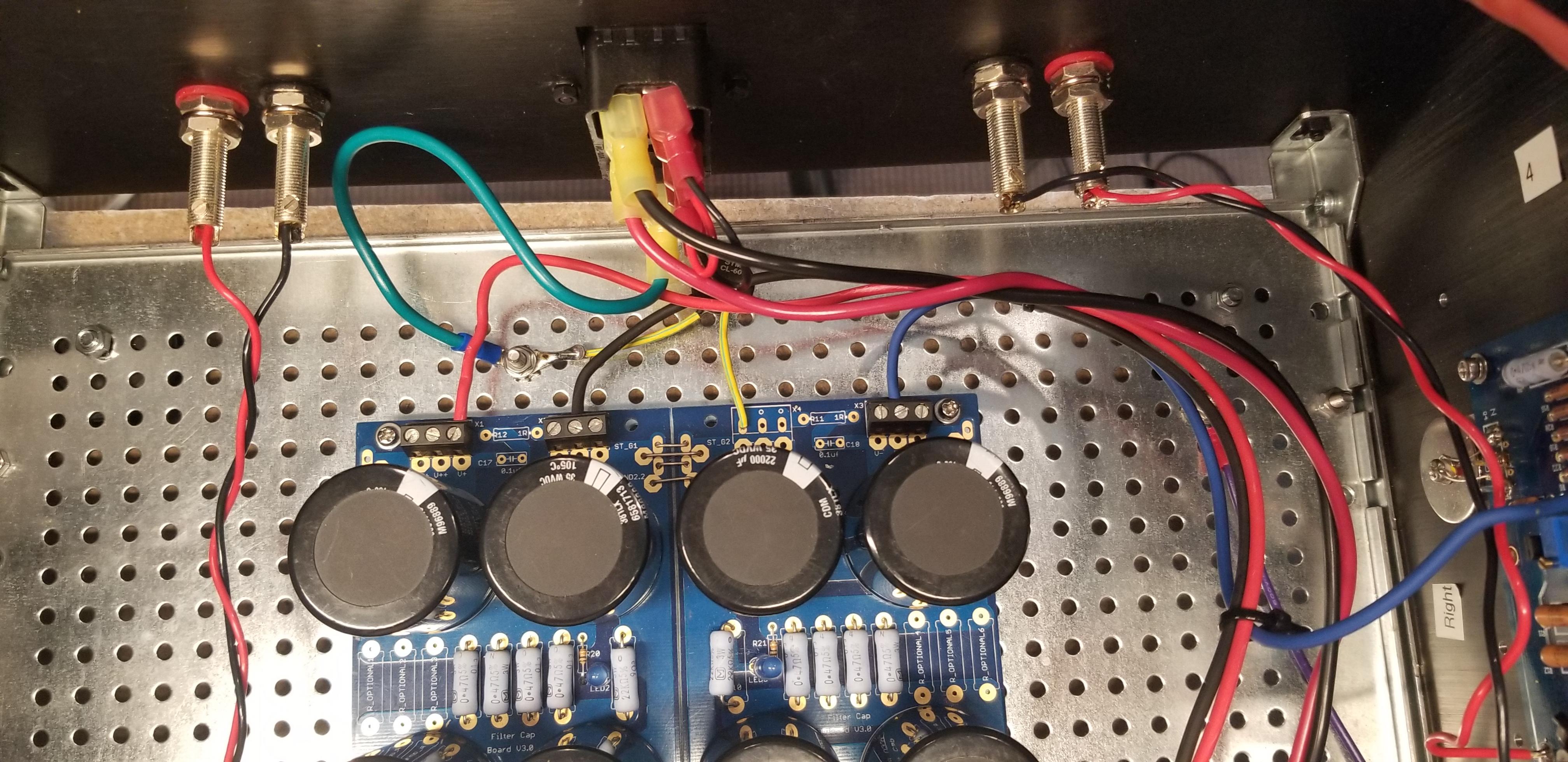

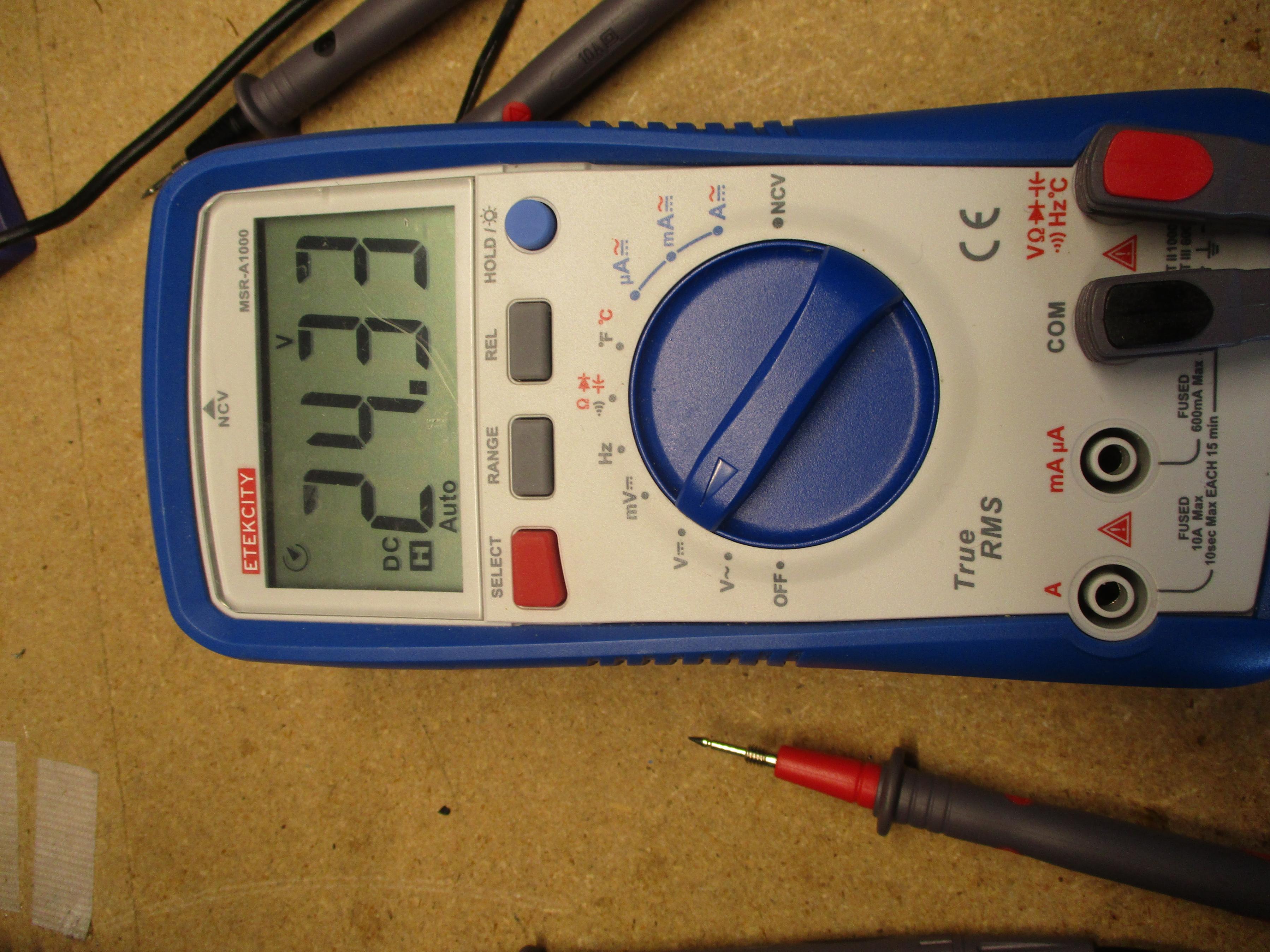

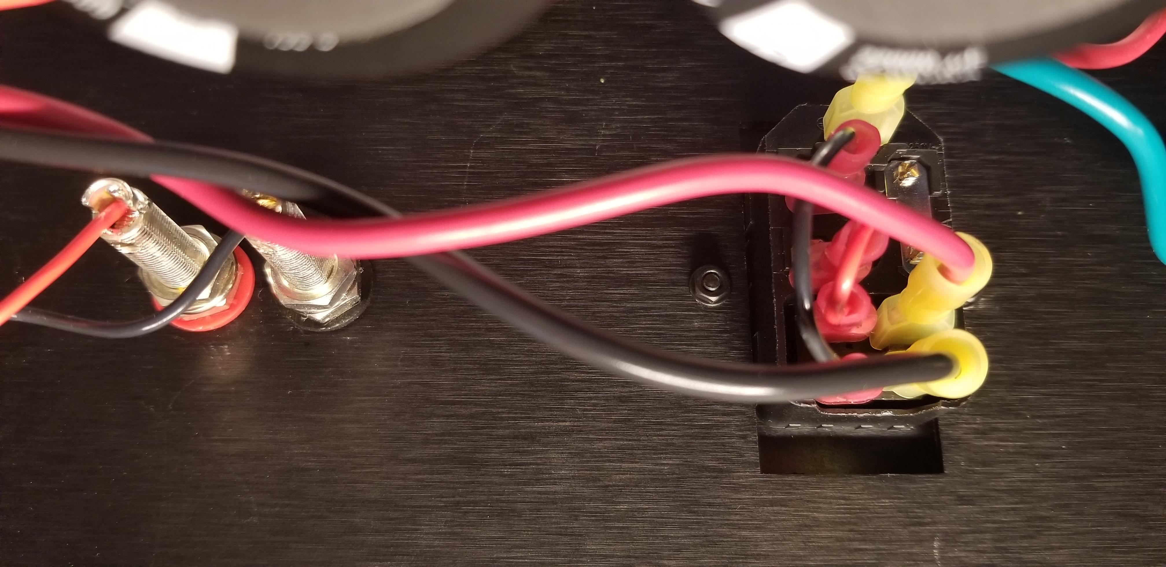

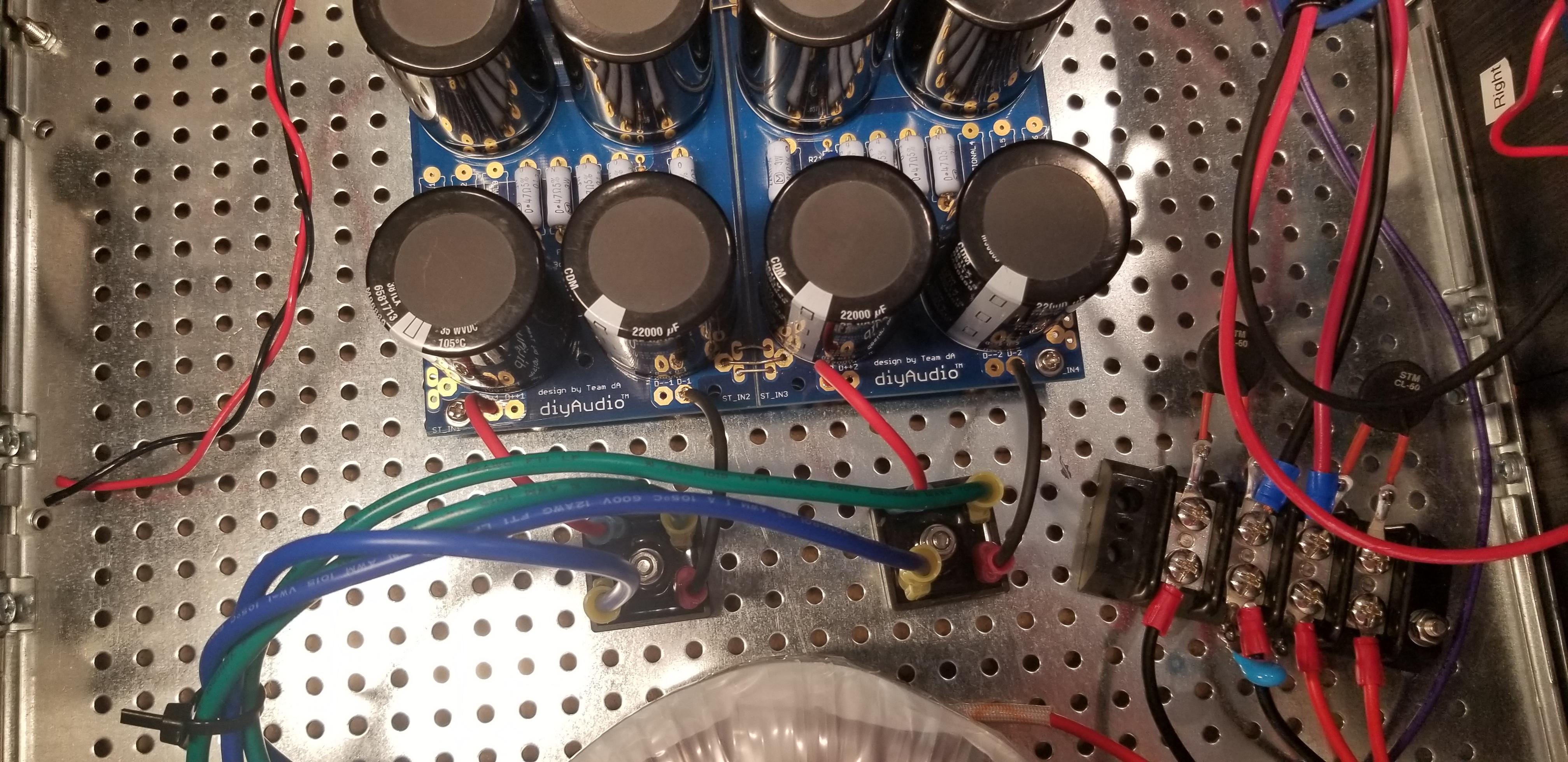

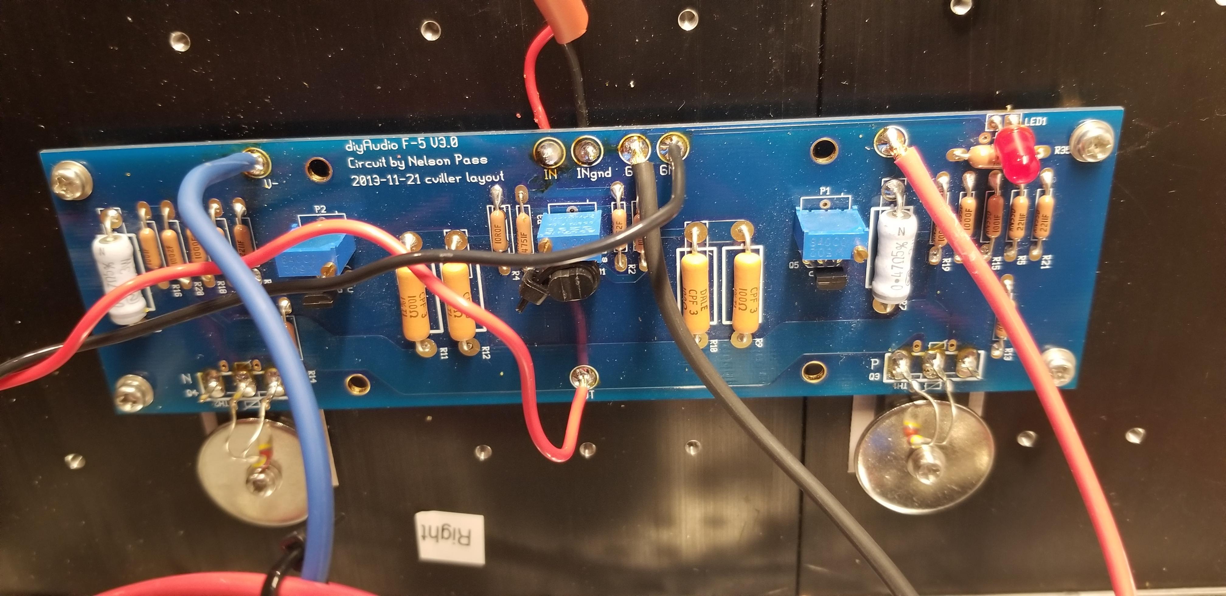

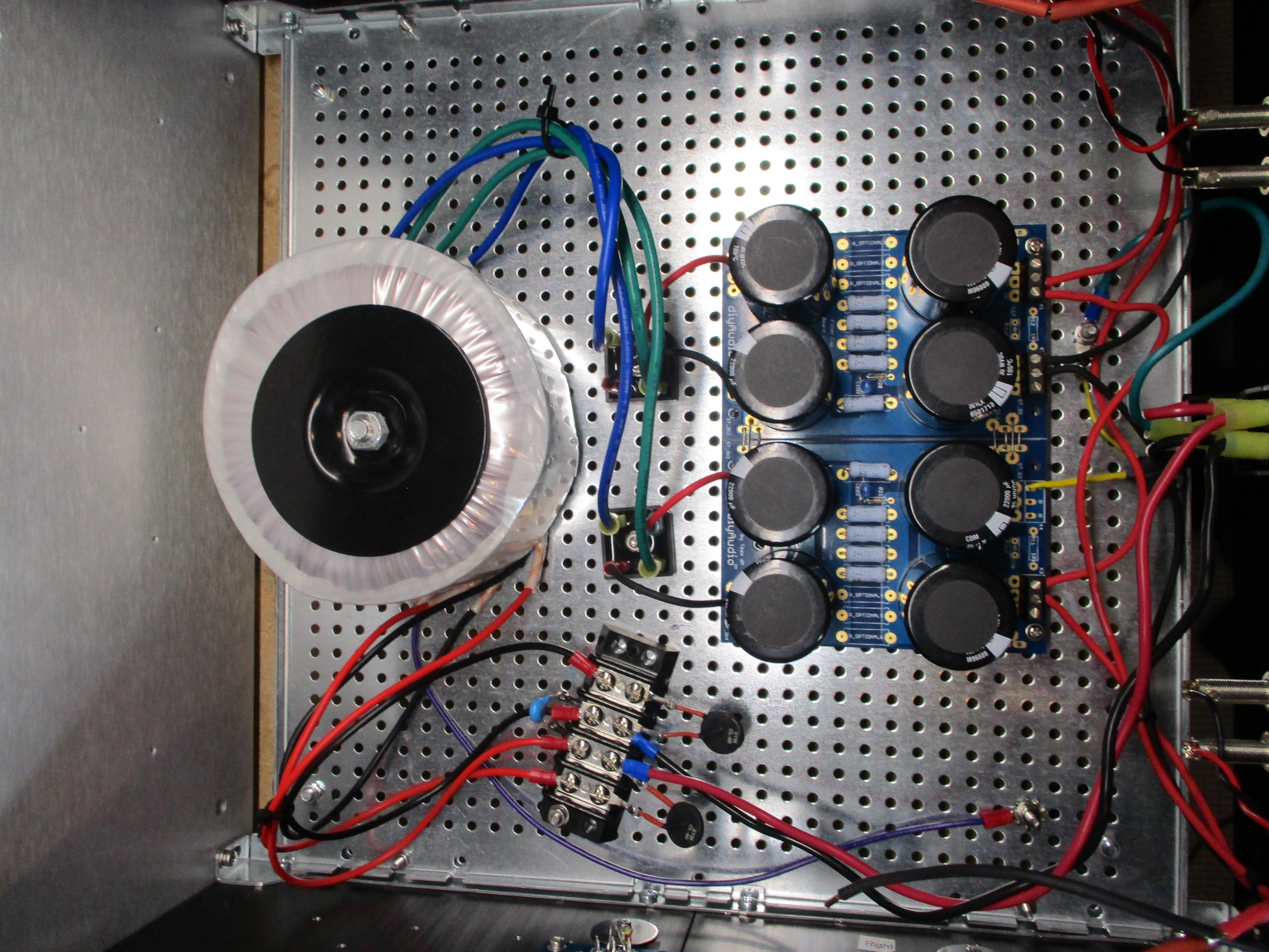

Chiptech,
A recap:
You had previously tested the power supply alone with the dim bulb tester and it passed.
You then connected one channel to the power supply and the bulb stayed bright - a problem.
Dennis asked you to check resistance at R5 and R6 which should be close to zero, and you measured 0.761R and 0.659R, which is good.
Looking at your pictures, you have red wires for both V+ and V-. Ideally you should have one colour for V+ and another for V- so that identification is easy and mixups are less likely.
To test the power supply without any boards connected, use your voltmeter and measure DC Volts between Ground and V+ and between Ground and V-. You should get somewhere around 25V or so.
If that is good, connect one board to the power supply and take pictures of the wiring and also take pictures of the amplifier board so that it can be examined for possible errors. Make sure you identify V+ and V- wires from the power supply. If both are red, wrap some coloured tape around the end of V- to differentiate it from V+.
Joined 2005

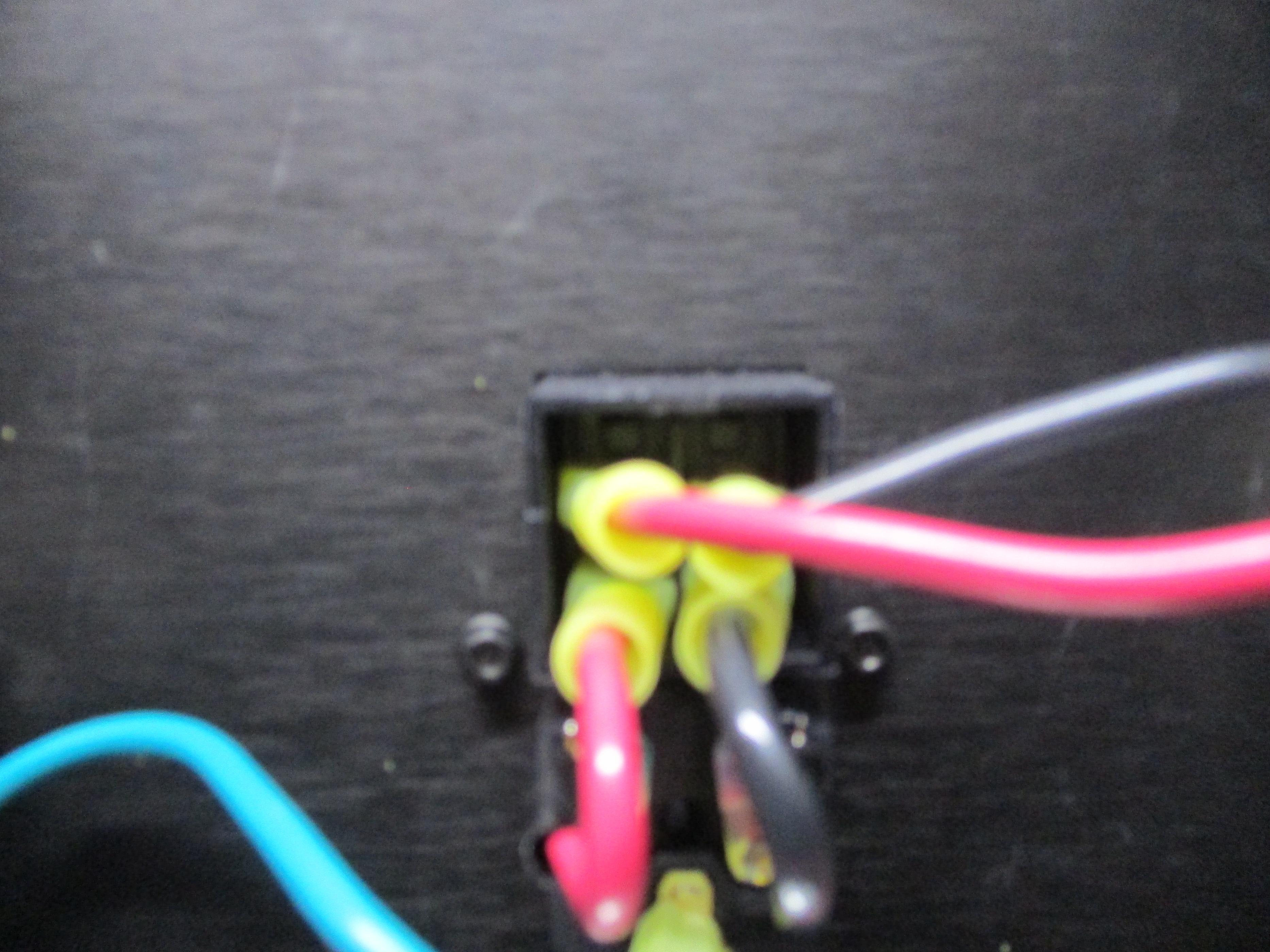

Ok. I get a reading of 24.33 from each PSU channel.
I have attached new photos. Blue cable is the V- connection.
I appreciate help in debugging this.

Joined 2012
Your power supply voltage is good. Your wiring to the amplifier board looks good.
Looking at the P channel Mosfet (right side of board), the thermistor wire may possibly be contacting the washer/screw. Make sure that only the body of the thermistor is in contact.
Once that is done you are ready for power up with the dim bulb tester. Having two meters for the biasing is best, with one meter set to DC Volts on the speaker out and the other meter across R7, also set to DV Volts.
If all is good, the dim bulb tester should dim after intially glowing bright.
The voltage across R7 should be very low (much less than 1V).
If good, then biasing is next.
Edit 2:
I can't tell from your picture but are the thermistors in the board thermistor holes? Looking at the picture it looked like they are on the Mosfet pins, but that is probably a illusion.
