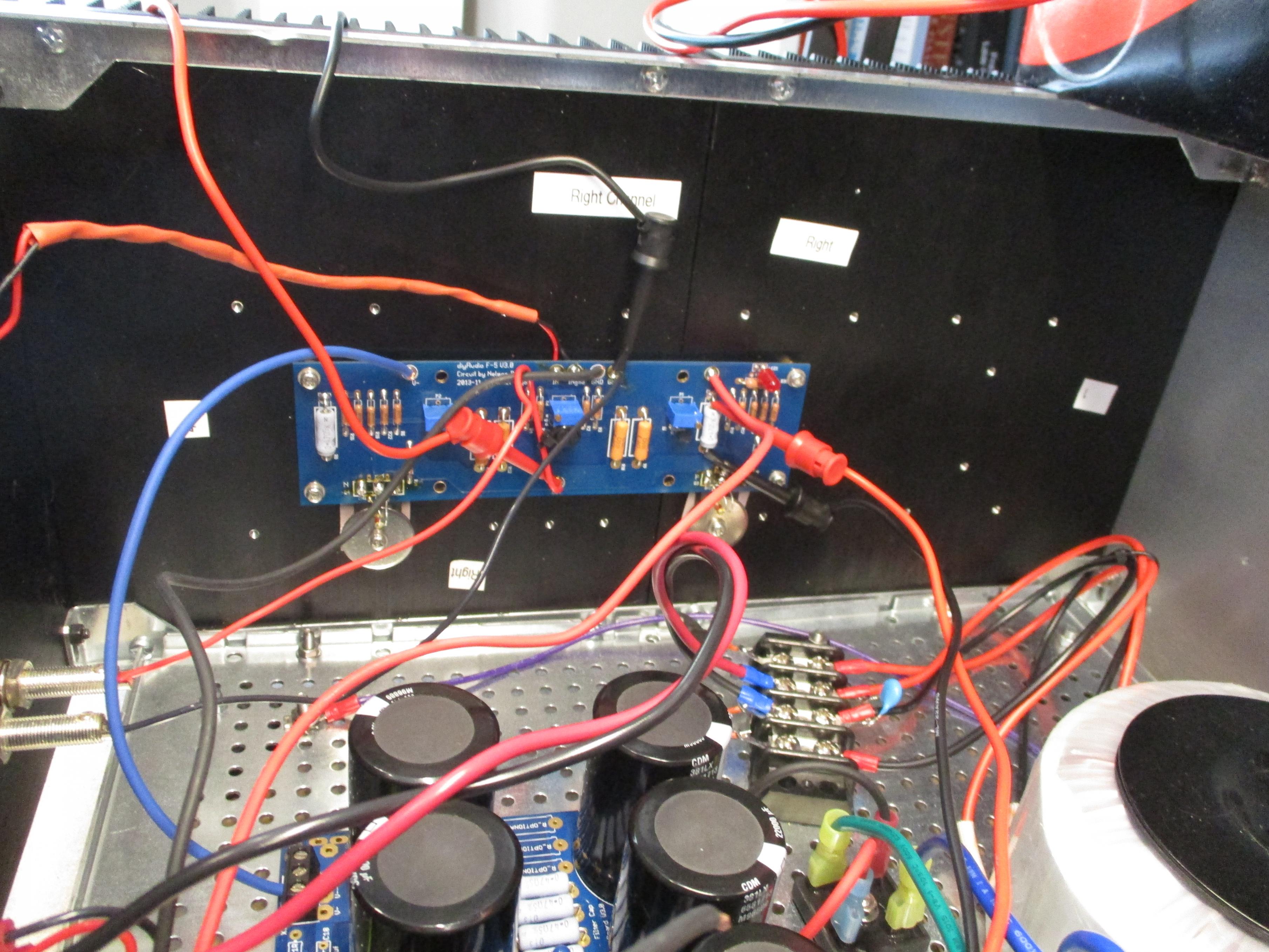

Could someone with better eyes check the values of R21 and R5? It may be worth checking their counterparts also, but I can't see them in the picture at all.
Edit - I got the picture to enlarge on my screen. 🙂 They look correct at 2.21k.

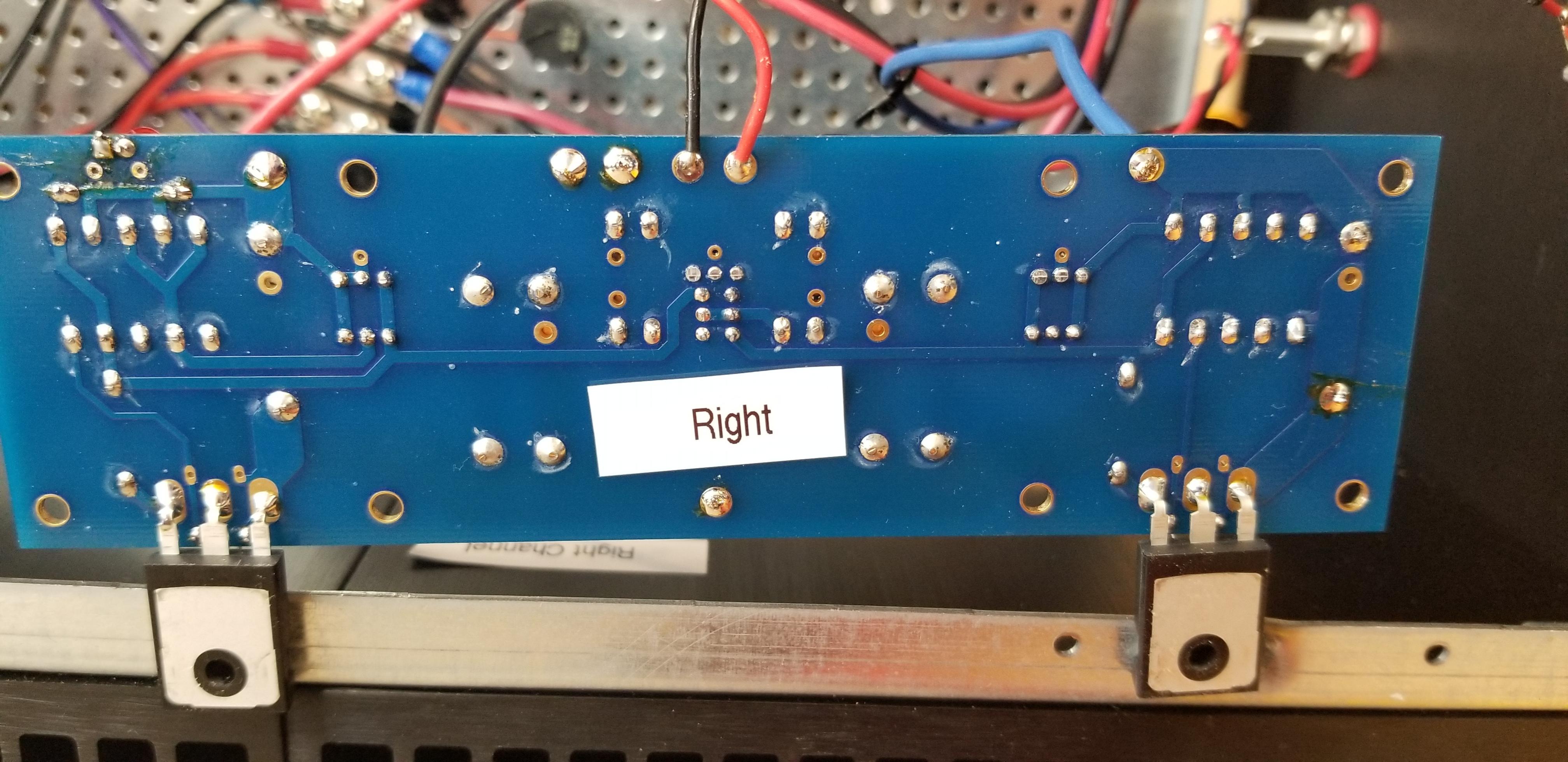

With the power off, set your meter to Ohms and one probe on the Mosfet washer/screw, measure resistance with the other probe on each of the Mosfet pins and the Mosfet thermistor pins. All should read infinite resistance. This is to check to make sure the isolator between the Mosfets and the heat sink and the coating on the thermistors are not damaged and therefore conducting electricity to the mounting screw and heat sink and ground.

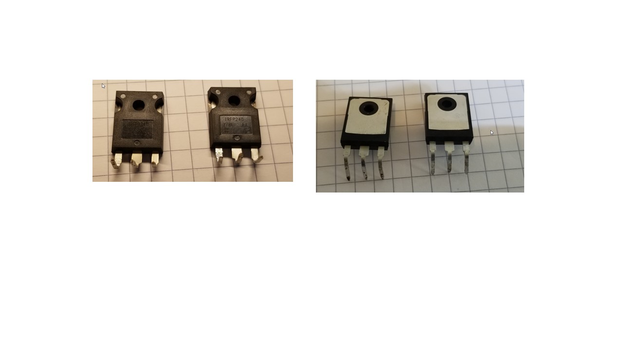

Take the fender washers off and double-triple check you have the IRF240 at Q4 and the IRF9240 at Q3
I have Right Q3 is wrong and Left Q4 is wrong. They need to be swapped.

Your power supply voltage is good. Your wiring to the amplifier board looks good.
Looking at the P channel Mosfet (right side of board), the thermistor wire may possibly be contacting the washer/screw. Make sure that only the body of the thermistor is in contact.
Once that is done you are ready for power up with the dim bulb tester. Having two meters for the biasing is best, with one meter set to DC Volts on the speaker out and the other meter across R7, also set to DV Volts.
If all is good, the dim bulb tester should dim after intially glowing bright.
The voltage across R7 should be very low (much less than 1V).
If good, then biasing is next.

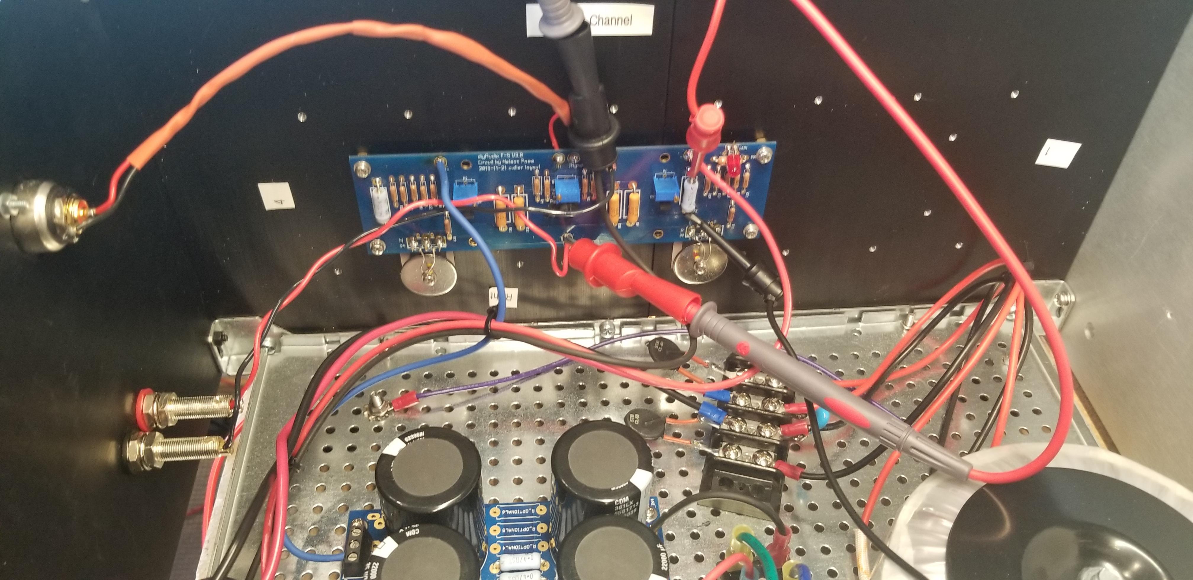

Well, I undid the errors with the Mosfets on Q3 and Q4. I double checked everything else on the boards.
But once again dim bulb rules and stays on. I did get a -434.2 reading off the speaker out. didn't get a reading on R7.
Appreciate any input.
1. Your Mosfet or Mosfets may be damaged. Did you test them as Zen Mod mentioned in his post #1497?
2. Your -434.2 at speaker out- what are the units?
3. "Didn't get a reading on R7" -do you mean VDC = 0 across R7 or you did not measure?
4. Did you check Resistance between Mosfet pins and screw clamping Mosfet to heat sink? Check if you did not after remounting Mosfets. Should read high or infinite resistance.
5. Check VDC across R8.

Today's measurements:
Regarding #4 above: testing resistance on the MOSFETS I get:
For the right amp P Channel:
Gate OL
Source .047
Drain OL
For the right amp N Channel:
Gate OL
Source .048
Drain OL
For the left amp N Channel:
Gate OL
Source OL
Drain OL
For the left amp P Channel:
Gate OL
Source OL
Drain OL
On R7 I get OL.
On speaker out I get -427.6 mV
On R8 I get OL.
If one or more of the MOSFETS are bad I can replace all of them.
