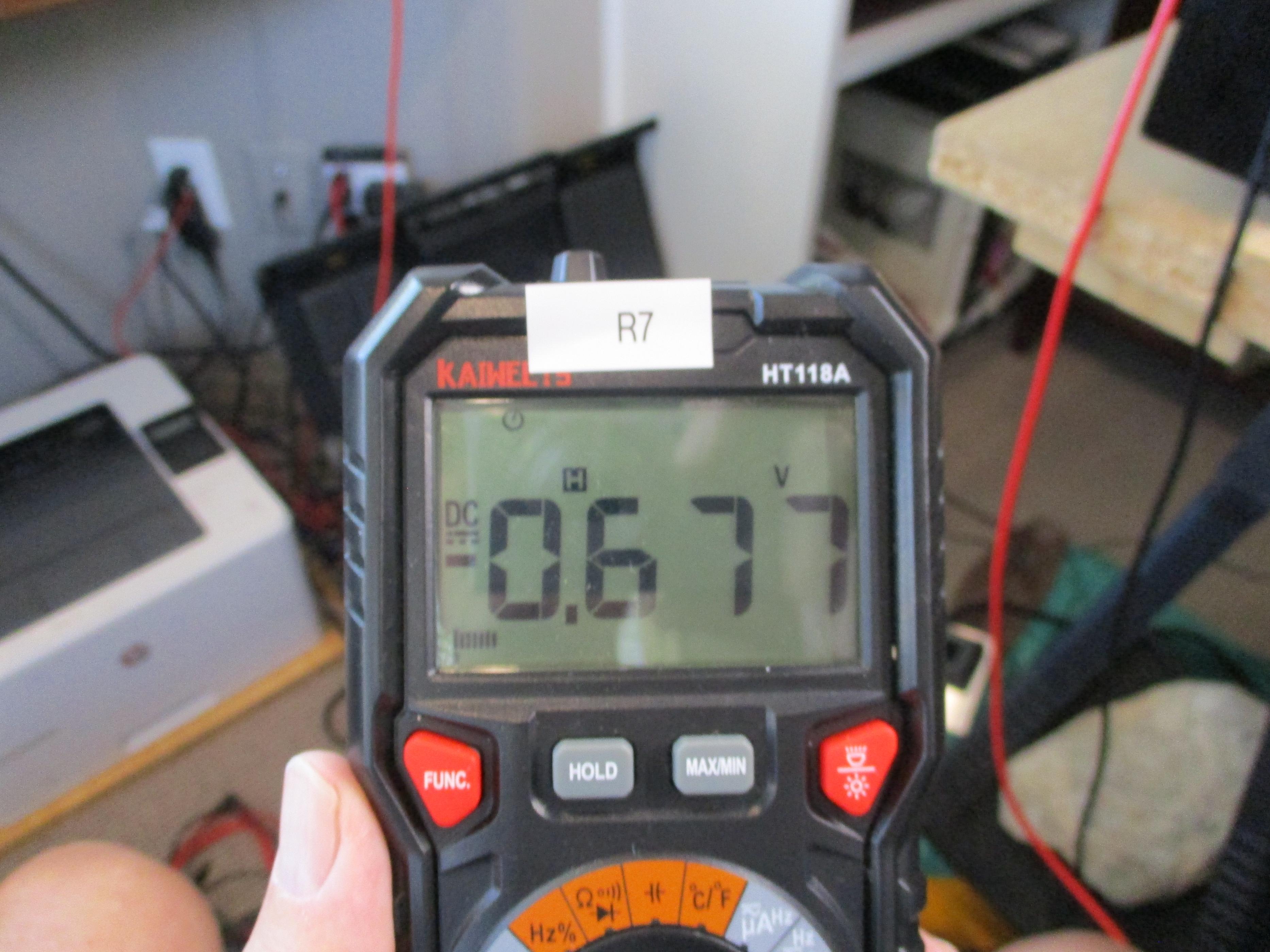

I am puzzled that with power to the board, you measured OL for VDC across R7. Is your meter auto-ranging? Was it set on VDC? Does your meter have "mV" and "V" positions? If yes, was it set on "mV" or "V"? I am puzzled because as far as I understand meters, OL means over range. In the case of VDC, that would mean the voltage exceeds the display or measuring range of the meter. That would take a large amount of current through a 0.47 Ohm resistor to do that, but with the light bulb in place, that should not happen.

When measuring Voltage, set to VDC first. If the voltage measures in the mV range, then change to mV.
First, I do not have auto ranging multimeters.

Anyway, here are my measurements:
[attached photo so you can see what I see]
R7 -0.677 V
R8 -0.691 V
Right sound out -0.459 V
The LED does not light up either.
Appreciate any observations.

No problem. Set them to 2 or 20VDC

Is this on initial power-up with no adjustment of the potentiometers?

Your measured voltages of -0.6x across R7 and R8 imply a current flow of near 1.5A.
This is inconsistent with the ~0.84 ohm resistances across R5 and R6 in post #1519. Since
your meter is not auto-ranging, is it possible those resistance values were
actually ~0.84K ohms?
I know we're all sounding like broken records for asking this, but we're
just trying to make sure you have proper adjustment for your initial
power up.
