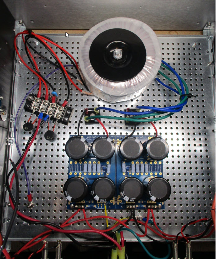

I turned on my F5 which has no connection to the channel amps. And it failed the dim bulb test. I'd appreciate any help on where I begin to identify my problem{s}.
How did it fail the test? Bulb on solid? Did it do that with just the PSU and no channels attached?
Dim Bulb Test failure
The bulb stayed on and bright [100 watt]. I have nothing connected to the PSU regarding the channels.

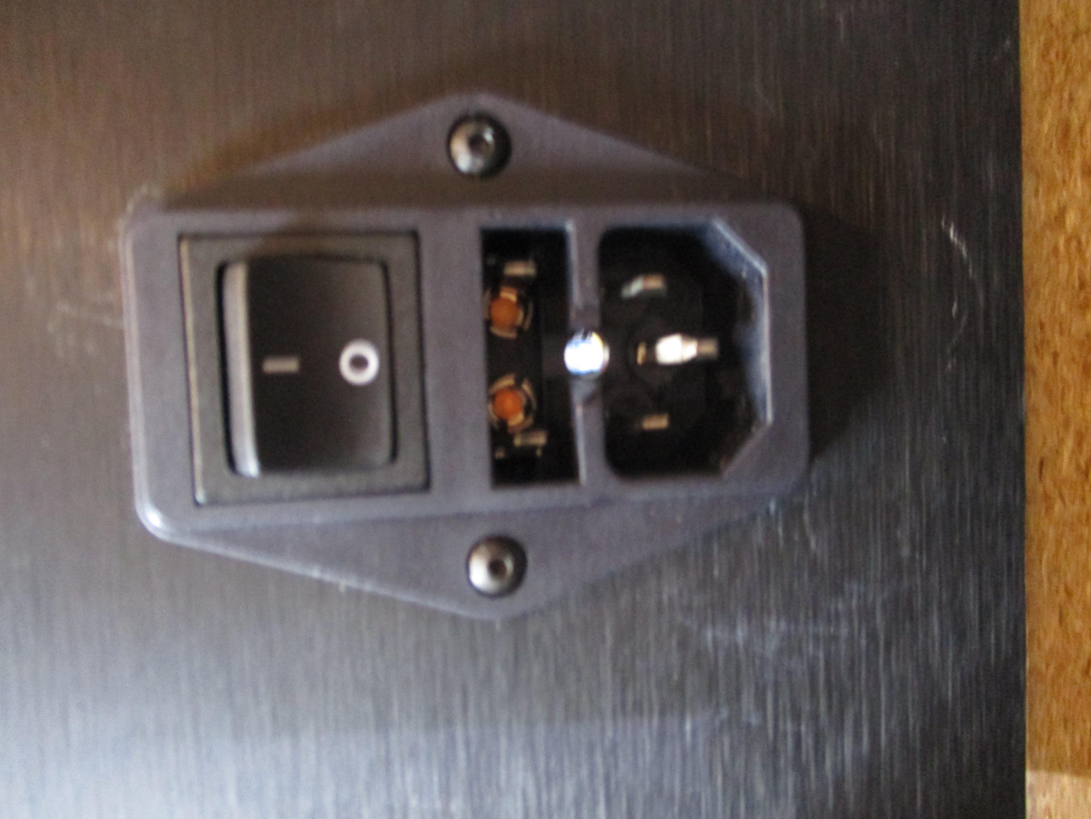

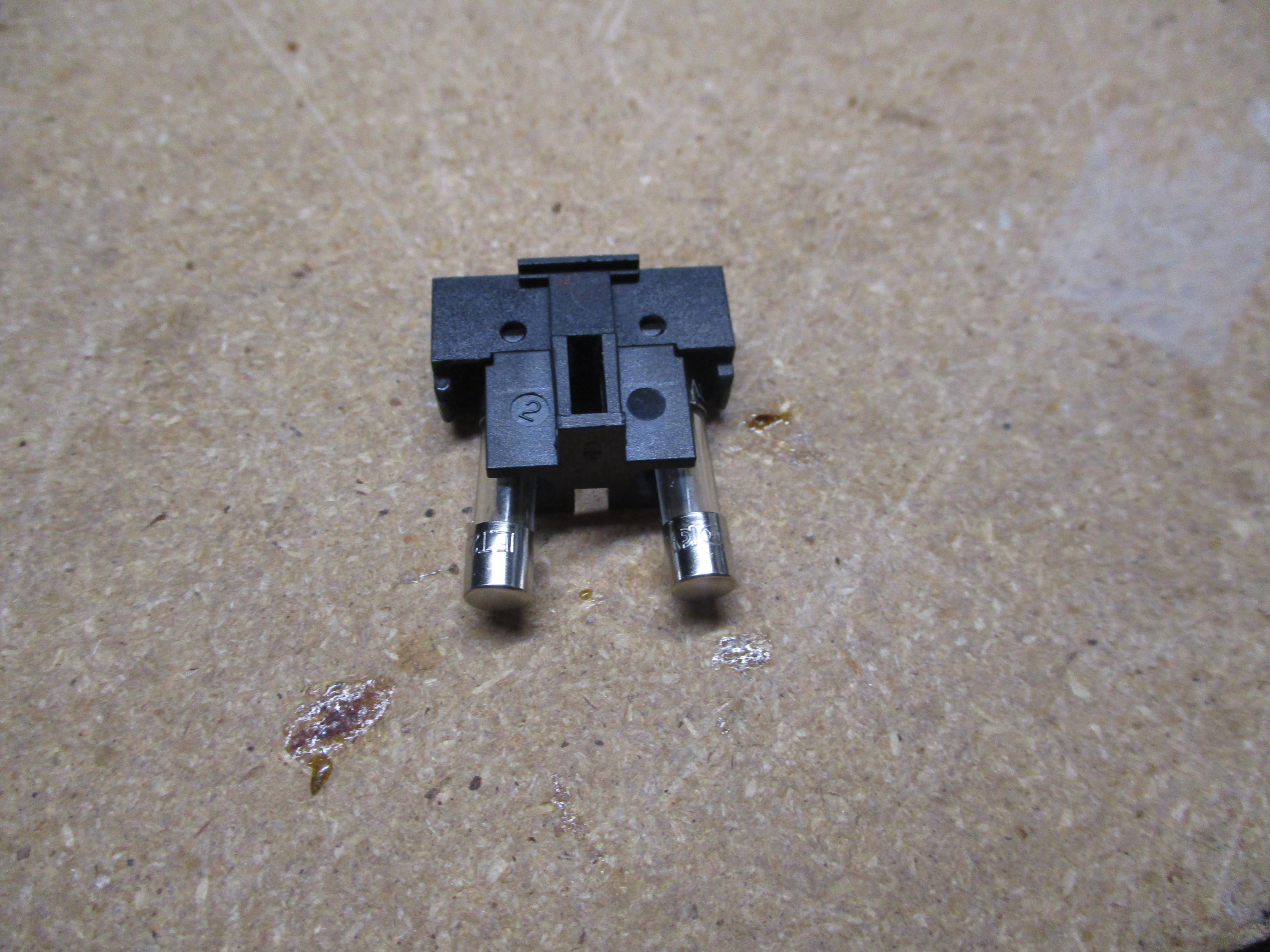

inner is working one, outer (in tube) is spare
Mine also has two fuses, and all this time I thought one for hot and one for neutral.😱
Disconnected the PSU boards from the bridges. No light from the bulbs.
So shouldn't the bulb light up and then dim if things are working? With the PSU board disconnected from the bridges, when i turn things on, nothing happens. No light in the bulb at all.
Would appreciate some guidance.
That’s actually good.
Reattach the PSU to the diodes but remove all the wires on the output side.
Ok. So pull out the wires I've got on the out board side? Just to be clear. Do I leave the SL-60 in place attached to the ground star which is also where the switch is grounded?
Yes this was mentioned/clarified on the Whammy thread the other day that you should only has a fuse on the hot side on the incoming AC; not on the neutral (or in addition to the hot side) because most if not all compliance codes now requires this configuration.
The other is a spare you hopefully will not have to use any time soon. 🙂
