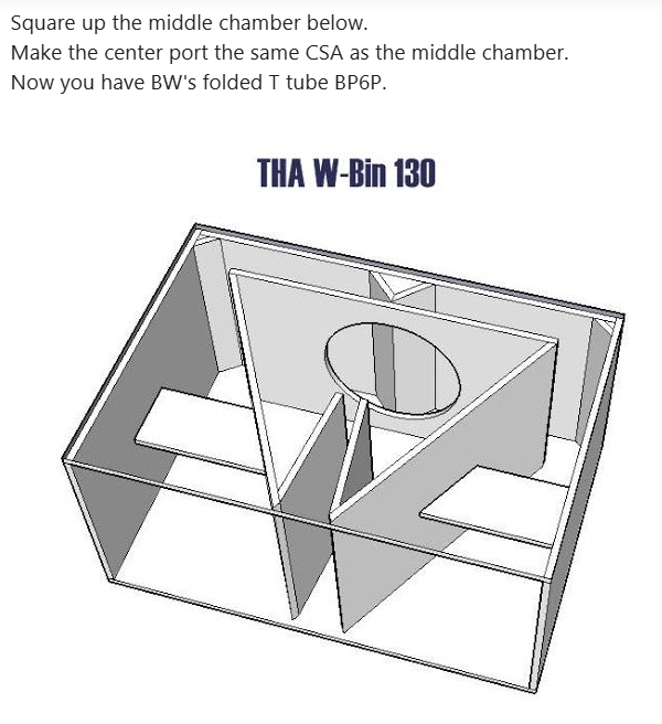

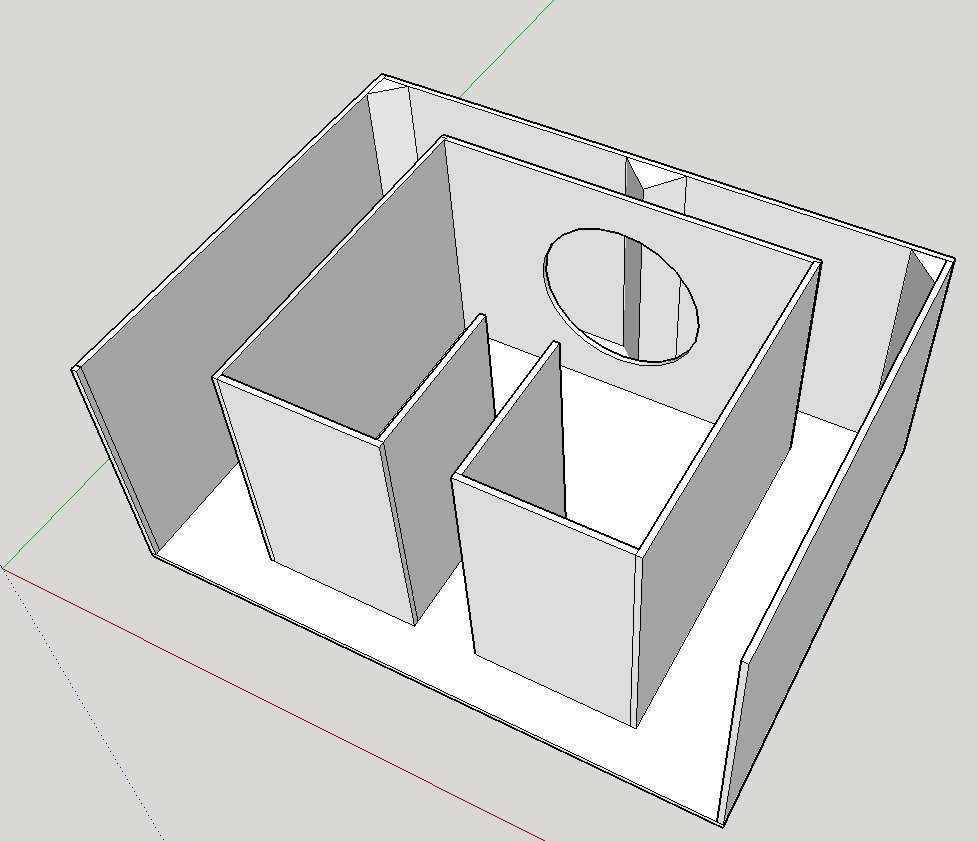

You basically built a w-bin BP6P without folded wings.
Square up the middle chamber below.
Make the center port the same CSA as the middle chamber.
Now you have BW's folded T tube BP6P.

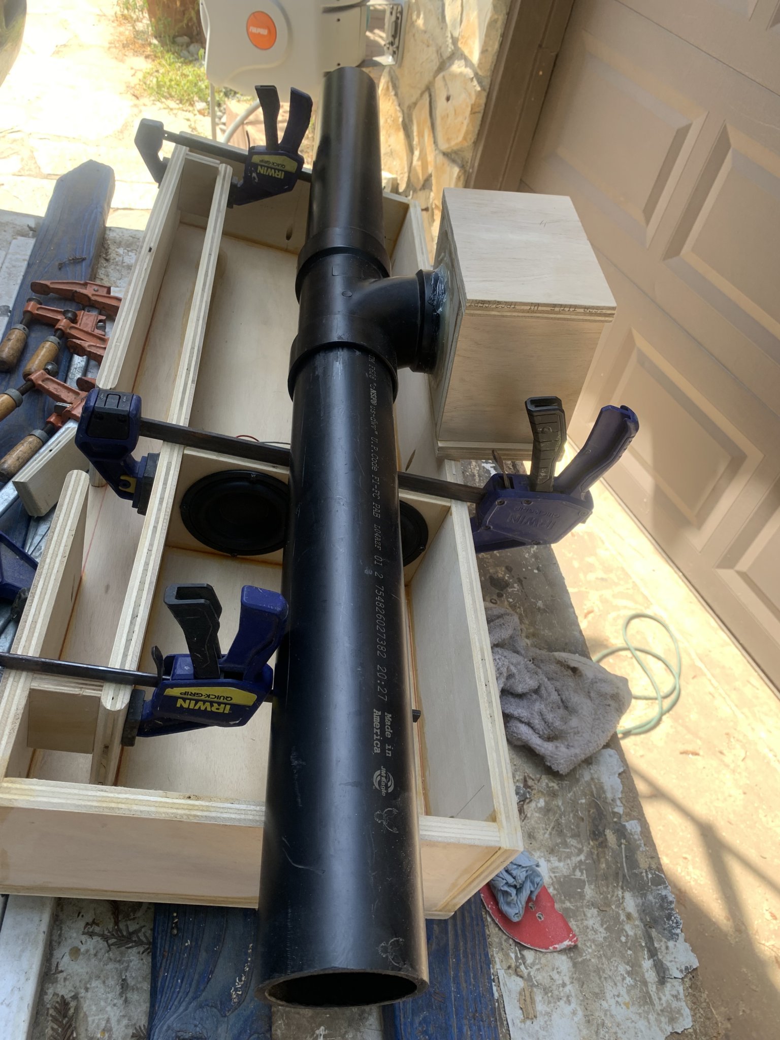

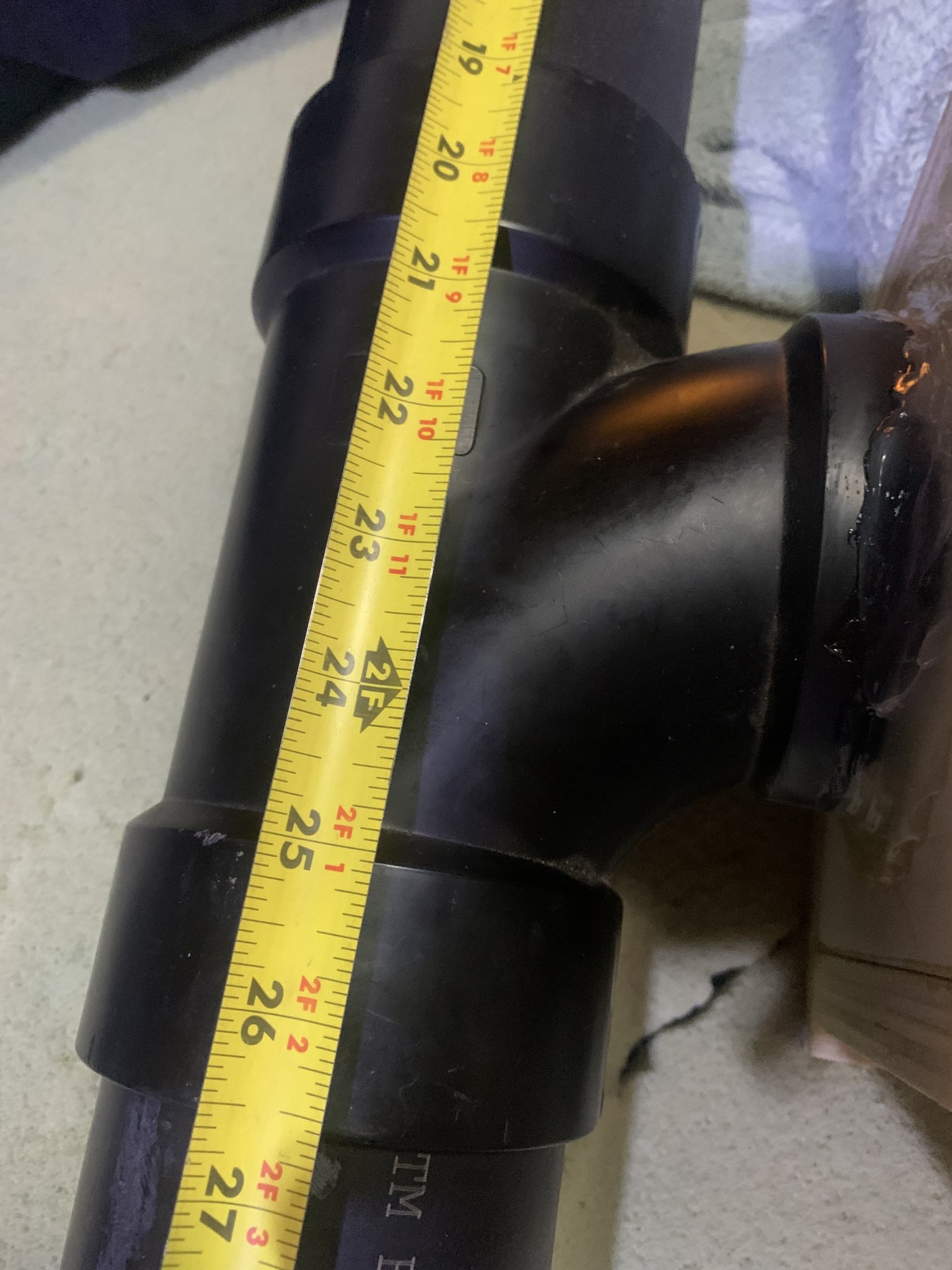

Driver is mounted dead center of a 46” (3”diameter/45cm2) pipe. Modeled as a 90cm2 58.42cm (23”) 1/4 wave pipe.
i didn’t add the short distance of the ‘T’

That pic is exactly what I'm talking about when I said we are trying to model a BR type enclosure. Remember, TL's are fancy or exotic BR enclosures.
You switched it up by trying to use Ap/Lpt with an offset driver.
Your Pic shows there is no tube or chamber on the other side of the driver.
A plain pipe isn’t a Bassxreflex enclosure. it is just a didgeridoo with resonances based EXCTLY on its 1/4 length /1,/3,/5,/7,/9…?
im using scraps and junk for an experimentAl skunk works resonator for area51 and you’re busting my nuts about a little frame around the driver so it can be siliconed into a pipe T? 👽

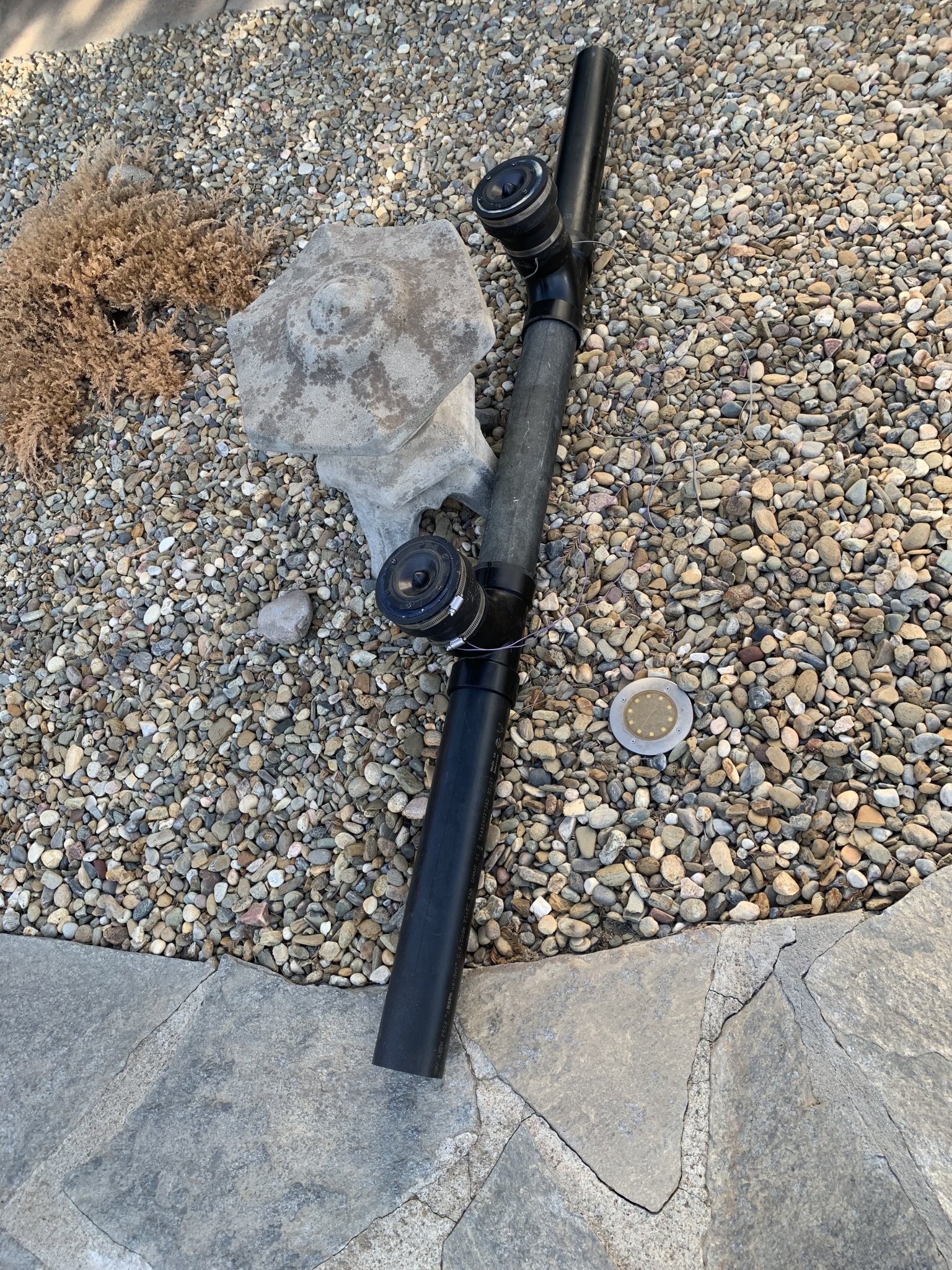

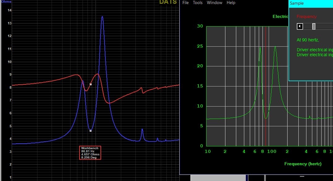

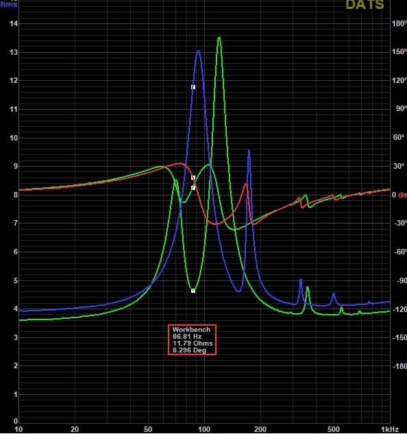

That pipe and then i (accidentally for science) flipped the polarity on one of the drivers and Fb nearly halved? Wish I could imagine what was going on inside for that to combine as such. Suck and blow at the locations for the second resonace ?

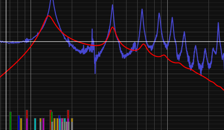

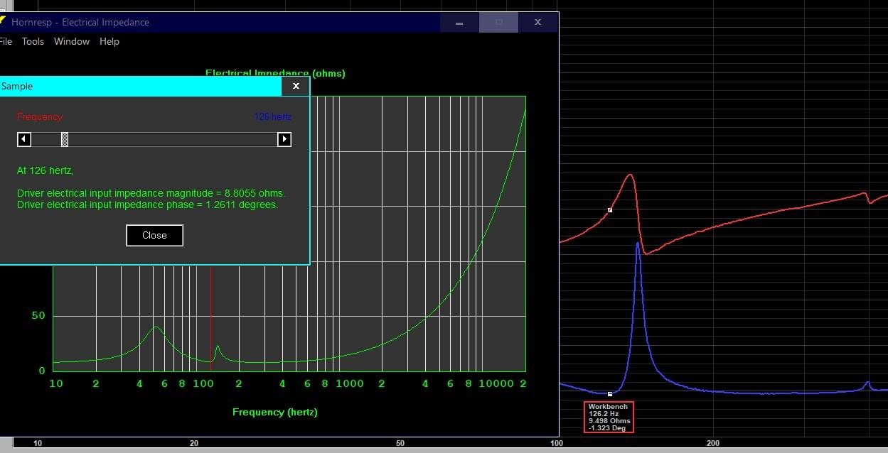

quick and dirty mic at one of the open ends and horn resposne(red)
acts exactly as it’s 1/4 cousin would?
