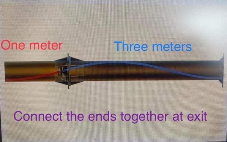

Depends exactly what you're doing. If you're creating something with an internally mounted drive unit, then in essence it's an extreme version of a BP6 or H-frame since the front & rear of the driver excites physically isolated 1/4 wave pipes, & if those are of different lengths, then it's akin to a DSL style [double] tapped horn. If it's a pipe open at both ends that's simply excited at a given location by either the front or rear of the drive unit, it's a 1/2 wave pipe. The Bose Wave Cannon falls in the former category.Hi, I have a new question: if both are open ends, then would it be possible to align two resonances, like: 50 Hz, 200 Hz, to extend the frequency range of the transmission line box?

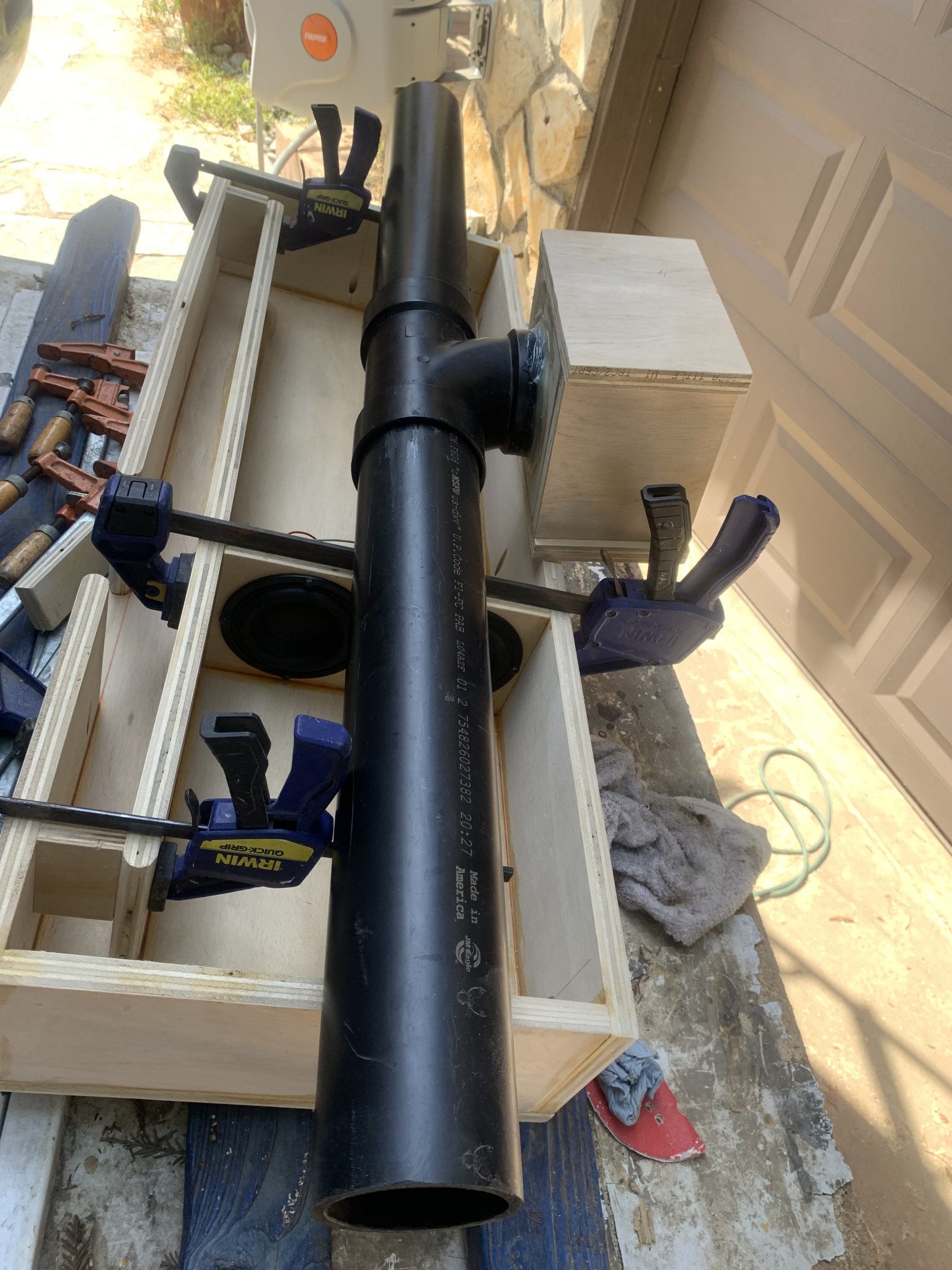

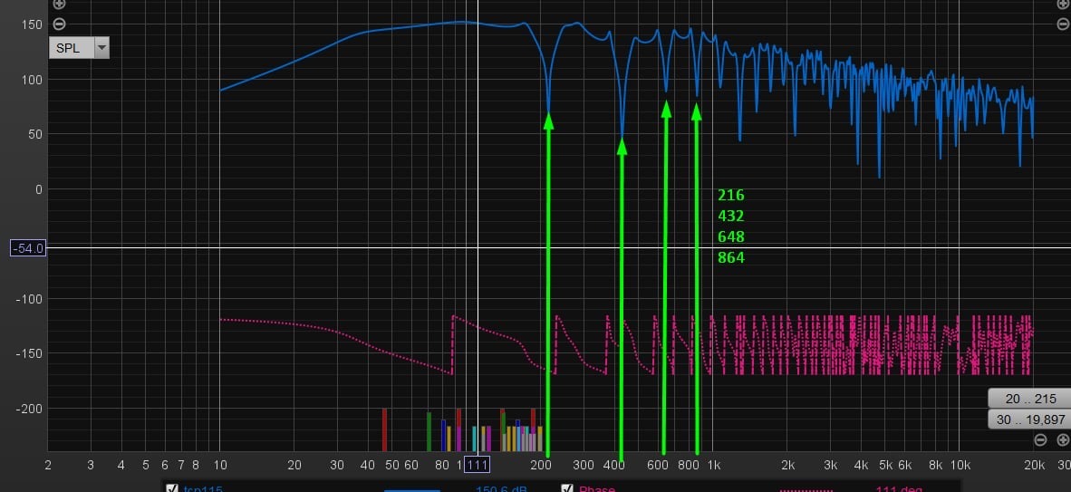

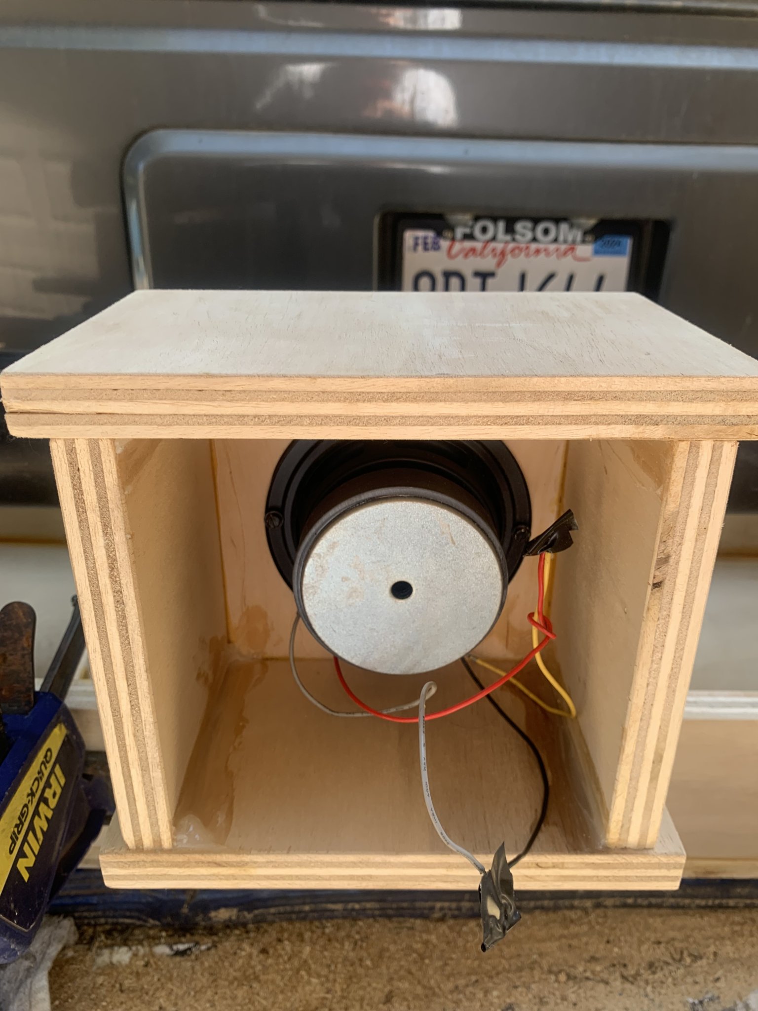

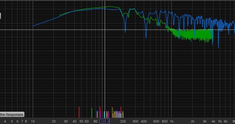

I built one for fun (folded up so they exit together) and it sounds nasty when left alone to resonate and ring. I need to adjust the rew scaling to really show this better

Below is a BP6P enclosure.This must have a pretty legit dsp/parametric EQ cleaning up the high frequency resonances and a steep crossover?

Do you mean without a low pass filter?it sounds nasty when left alone to resonate and ring.

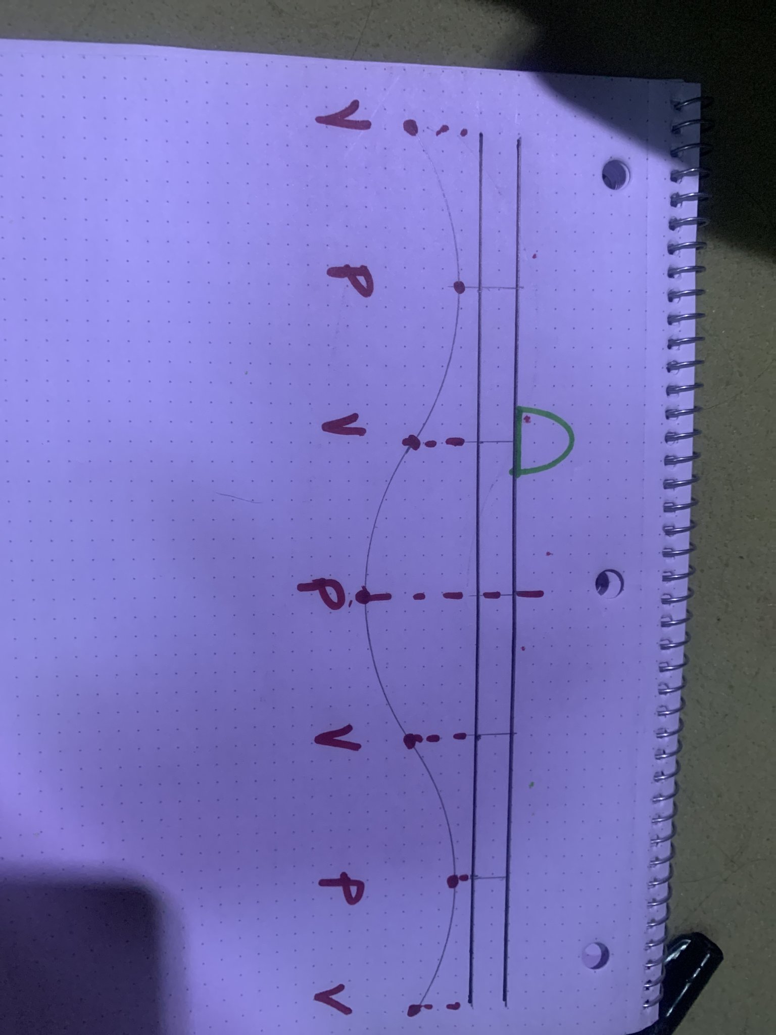

Yea sir, there’s nothing in horn response that allows us to describe an open/open ended pipe (or how intersting it would be to move the driver around to velocity max for particular resonances in one) . but can we just assume the same locations in the closed/open end pipe will be in the half wave pipe at similar distances from ‘center’? And moving the driver around doesn’t create ‘another pipe‘ affectively and more resonances ?Below is a BP6P enclosure.

No, it needs much more than just a simple filter . It’s a train wreck that only dsp can tame and the fundamental is far too overdamped to be an exciting ‘subwoofer’. I sent a really annoying sound clip off my phone to @maxolini of it playing without a crossover to torture him 😝
if ‘paraflex’ sounds as good as they claim, then the work done to clean that up (with offsets and vent position) must be respected /recognized imho. It’s like taming a raging bull with Tourette’s

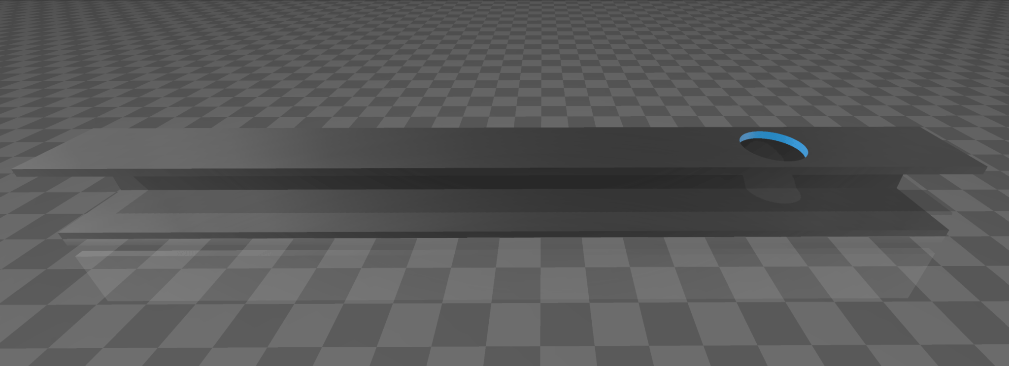

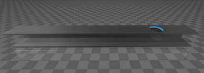

For a better understanding of the transmission line in my question.
These are images of a straight tube measuring 215 cm and divided.
If we divide according to the location of the speaker hole, this would be: 172 and 43 cm, which corresponds to: 50 and 200 Hz.
[Other] If my calculation is correct, the modes of the three-dimensional space are related to 1/2 of the wavelength in the width and height of the transmission line, so if the width and height are at most 21 cm, the transmission line can go up to 800 Hz.

50 and 200 cm will be the resonating length of 344 and 86 hz in the pipe with both ends open. But the driver position it’s in has me baffled(no pun intended 😃). Intersting thing to figure out!
