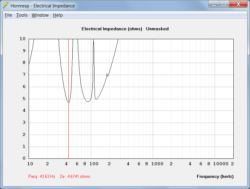

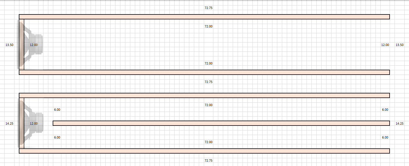

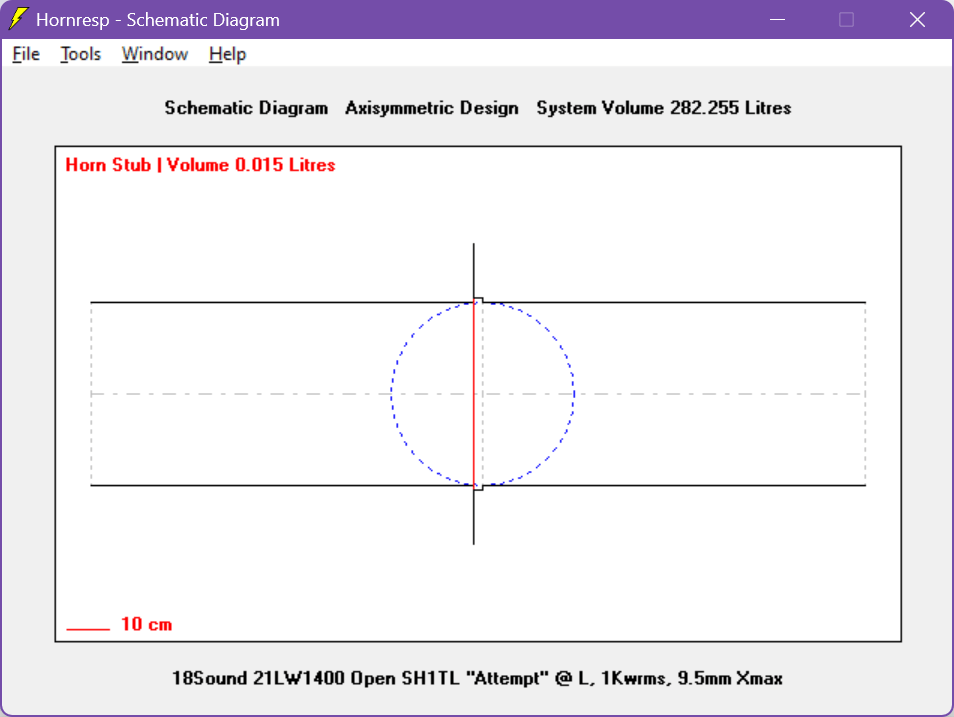

An idea: A T-line with both ends open
They need very precise dsp to pluck out the resonances and then a steep crossover…. But then it neutered so much of the punch/impact if not careful.
its like supercharging a TL, but it’s rather excessive up to the second Resonace and always seems to overdamp the Fb
I’m guessing tapped horn (single path resonators l) sound much ‘better’ ?
