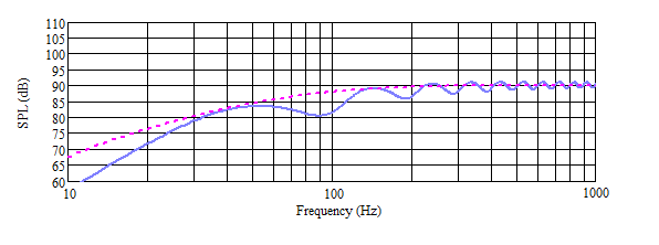

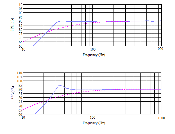

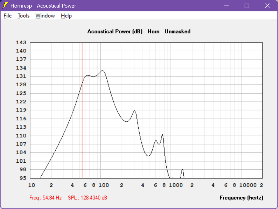

Quick example -apologies that it's not the best: it happens to be an MLTL variation, but it was to hand on the desktop.
The upper is as-designed, for the client who wanted a max-flat alignment (I'm not a fan, but that's what they wanted). The lower is the same drive unit, in a box with the same Vb, with the same vent dimensions and same damping. The difference is that the proportions have been changed to those of a conventional vented box rather than the tall MLTL form factor. If the operating physics were no different, we'd see no shift. But we do. QED -they ain't the same thing. Related, at a distance, since at some level we're dealing with boxes that have holes in, & even a chambered back-loaded bass horn can be called an extreme variation on a vented box / bass reflex if you go down far enough into the background / abstract fundamentals, but those are functionally speaking not very relevant.
Actually, tall MLTLs do have some interesting traits -you can get to the point where the longitudinal starts to provide some damping of the vent around Fb -this is one of those cases. A lot tend to be a bit shorter & more highly forced. I like the tall types as acoustically speaking it's quite an efficient way to go about things and keep the vent proportions reasonable -the price being the damn thing can get quite tall if you don't fold it up. Since I happen to quite like that aesthetic, it doesn't bother me, but that's a matter for personal preference! 😉

Why are you not a fan of a max-flat alignment? I agree with you when it comes to BP enclosures.
Depends on the specifics, but mostly because in the majority of practical in-room situations, you'll end up with an LF heavy balance. If you've plenty of space from the boundaries & a fairly dead acoustic, or have some other specific object in mind then it can work. Most people don't have that luxury though, so in general I find a better-damped LF alignment, preferably designed for the intended system & room, is more practical / neutral. Other reasons too, but that's the major one.
