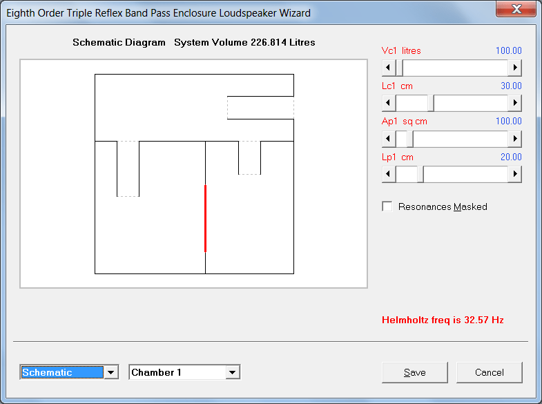

You vented the front and rear chambers into a vented common chamber. You added a 2nd order to the BP6P, hence BP8P.
You need to use the BP8P function and see if HR matches your built measurement.
You vented the front and rear chamber into a vented common chamber. You added a 2nd order to the BP6P, hence BP8P.

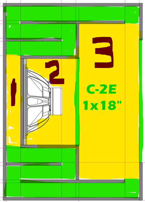

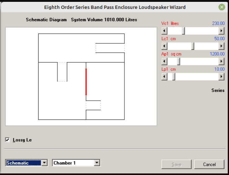

1 vented chamber + 1 sealed chamber = 4 orders.
2 vented chambers = 6 orders.
3 vented chambers = 8 orders.

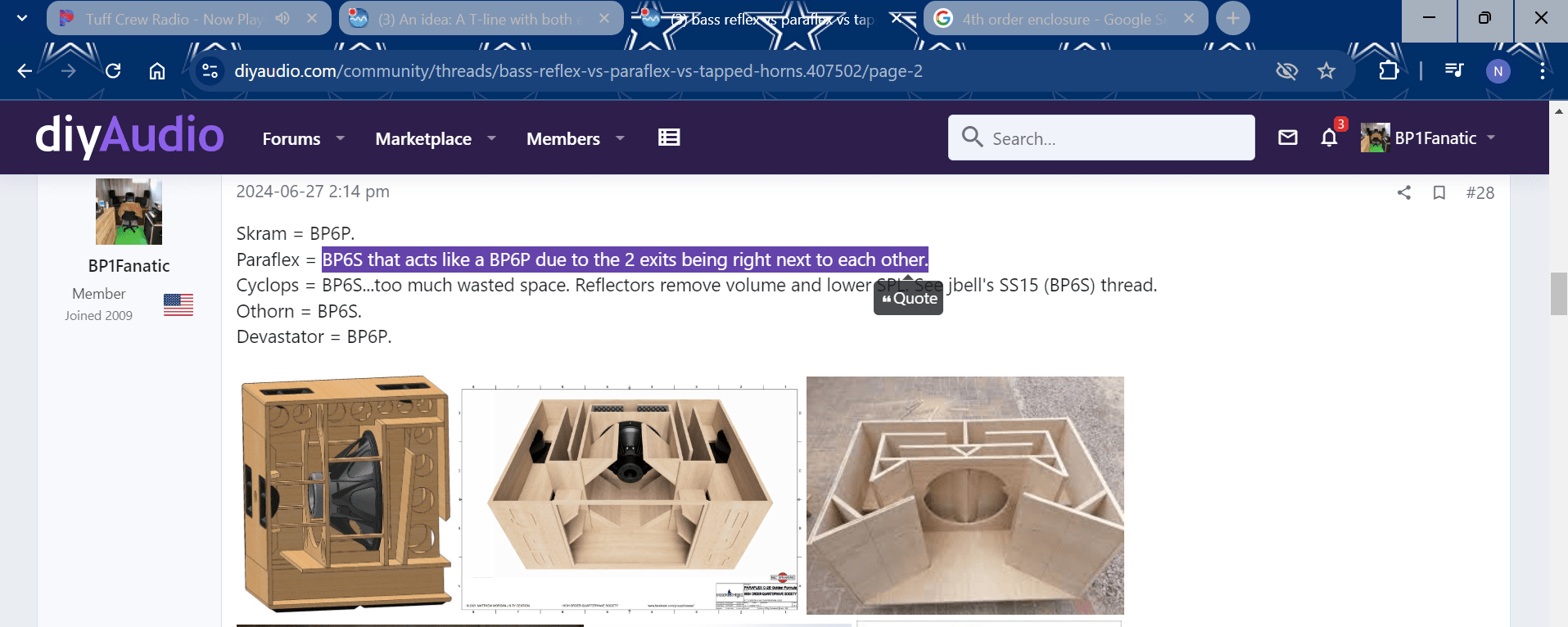

The PH function is for series tuned enclosures.
You built a parallel tuned enclosure.

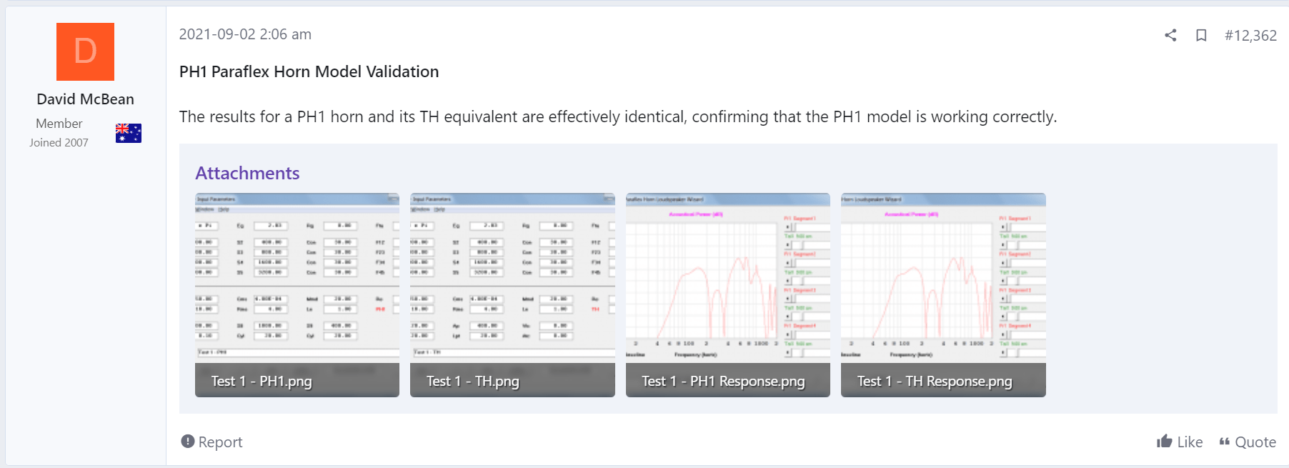

Before DMB added the PH function to HR, I always thought PH's behaved like a parallel tuned enclosure in folks' series tuned (TH) models due to the front chamber port was exiting so close to the enclosure's mouth.
Now, I can SEE that PH's are BP8P's. I think the original Paraflex thread might have mentioned the enclosure is an 8th order.

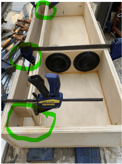

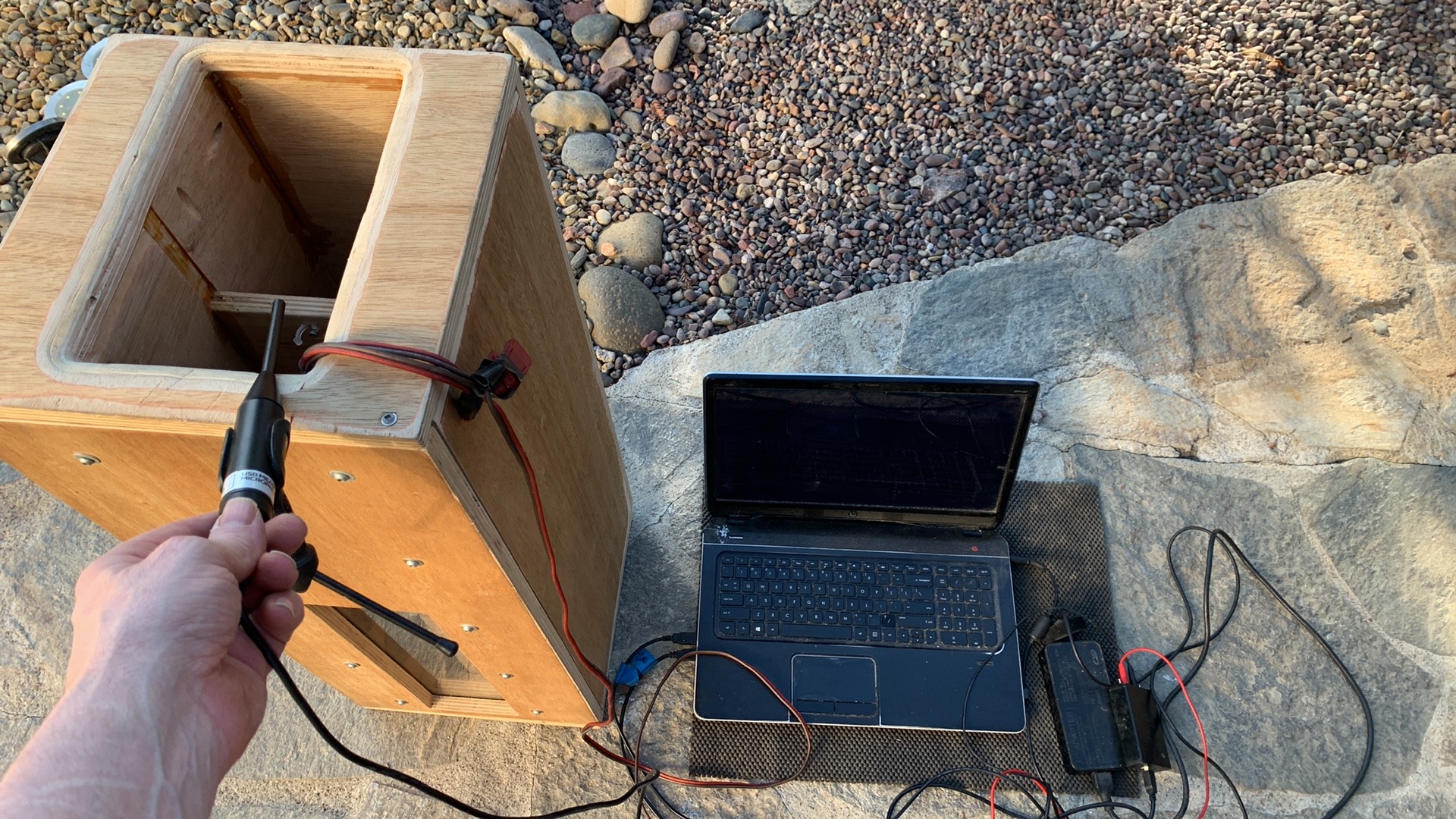

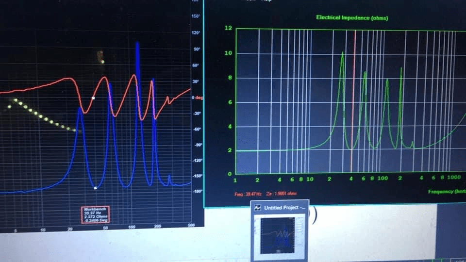

Is my ‘paraflex’ an 8th order? There isnt much of a ‘chamber’ there where the resonator exits converge, but their sharing the same location ?
