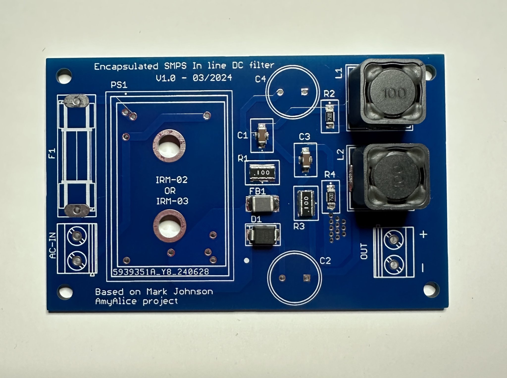

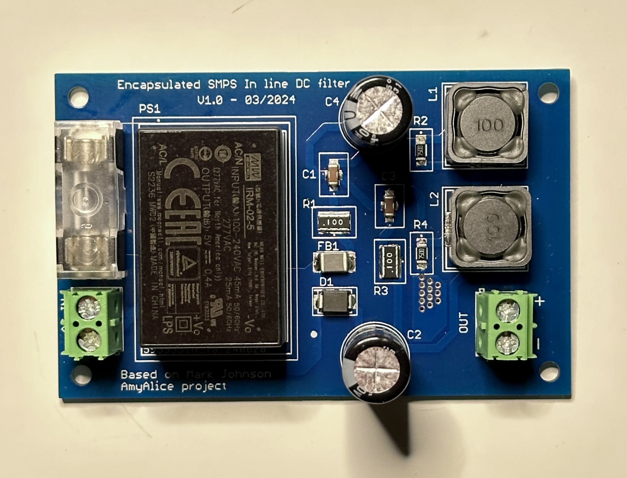

First of all thank to @Mark Johnson for this very useful project. I started using it from very beginning when Mark published it and I’m very satisfied.
I’ve also used it in some very low power demanding device where I normally use some small encapsulated SMPS. In the beginning I just hooked up the SMPS to Mark’s board, but then I decided to make a dedicated board to avoid having flying wires and to add a fuse.
I made this board that can accomodate a Meanwell IRM-02 (2Watt) or IRM-03 (3Watt) with various output voltages.
Schematic and components are exactly the same as Mark’s AmyAlice board.
I don’t want to hijack Mark’s thread and I don’t think that this board deserve a dedicated thread, so if one want to make this board just DM me and I’ll send the Gerber files. I still have some boards available that can give away for mail cost only.

Congratulations on your PCB design success, @mvaldes !! Please start a new discussion thread about your new board, and provide the Gerber files for downloads there. With its own thread dedicated to your board, diyAudio members will immediately know exactly who they should ask for technical support, debugging advice, component substitutions, and desired modifications. They should ask you, the thread starter and proud father of the board. Please feel welcome and free to either include or exclude "AmyAlice" from your thread title, whichever you prefer.

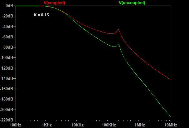

Here's a simulation of the effect of coupling between the inductors. The read trace estimates the coupling coefficient at 0.15, not exactly a transformer, but enough to impair the attenuation. The green trace assumes no coupling coefficient.

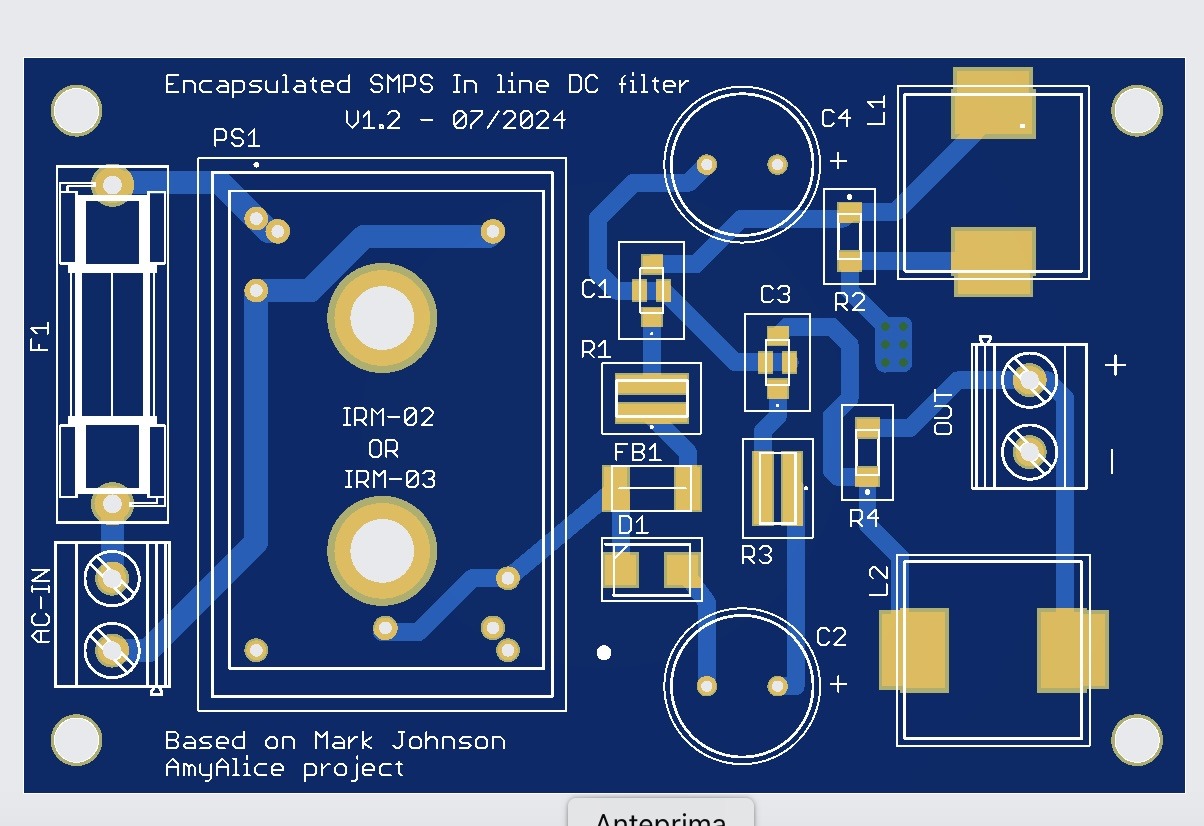

When I made the board as post #142 I didn't read about your consideration regarding coupling between two adjacent inductors.
I've just made a new board today where I separate the inductors.
I'll follow Mark suggestion and soon will open a new thread for this board

Beware of the trace width and cobber thickness - Marks Johnsons PCBs are rated for 3 A, that one looks a little light on the copper for that amperage (or specify the rated current of your board).
It might just be my eyes, if thats the case just ignore me
Oh yeah, did not think it throughSince these boards by @mvaldes are intended for IRM-02 (2W) and IRM-03 (3w), worst case scenario is 900mA for the IRM-03-3.3.

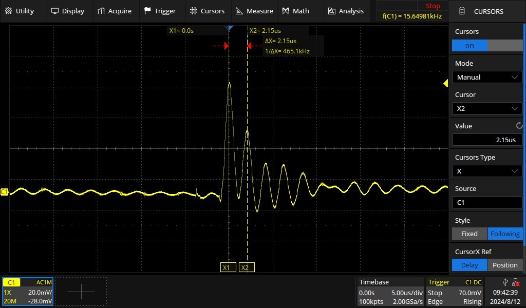

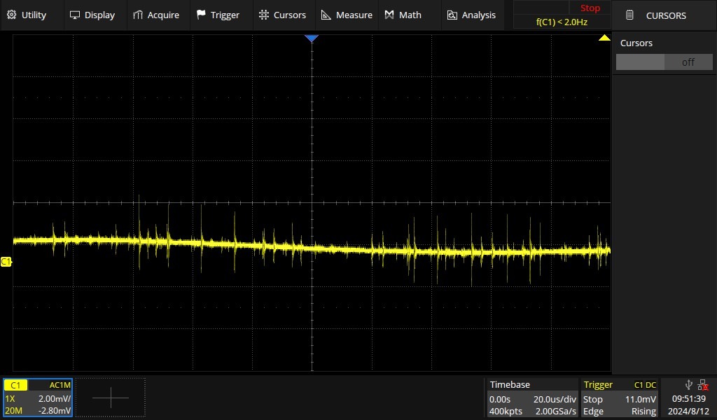

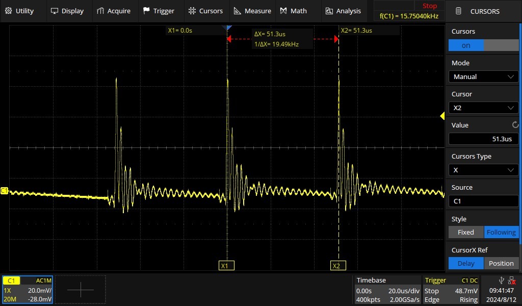

Here's some "before" and "after"Amy doing her thing on an HP Printer 32V 2.5A power supply. Note that the scale on the "after" is 2mV/div vs 20mV/div for the "before"
