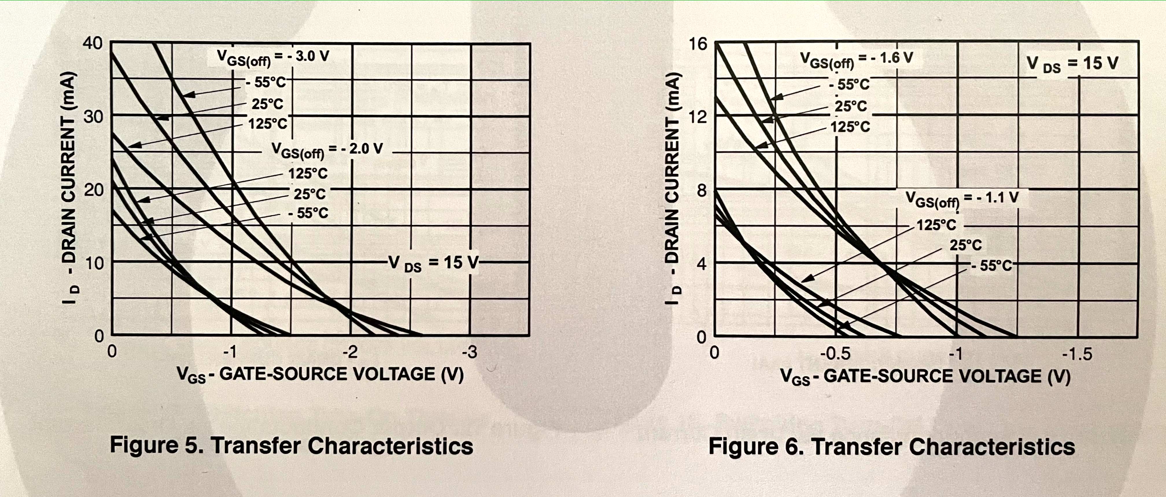

Would someone help me understand these Performance Characteristics charts for the J113 please?
When I measure Idss (Vgs at 0V, Vds at 16V), it is 11.2mA.
That must have something to do with one of these lines (for Vds at 15V) but what?
I suppose I am asking what is Vgs(off)? Why does it vary?

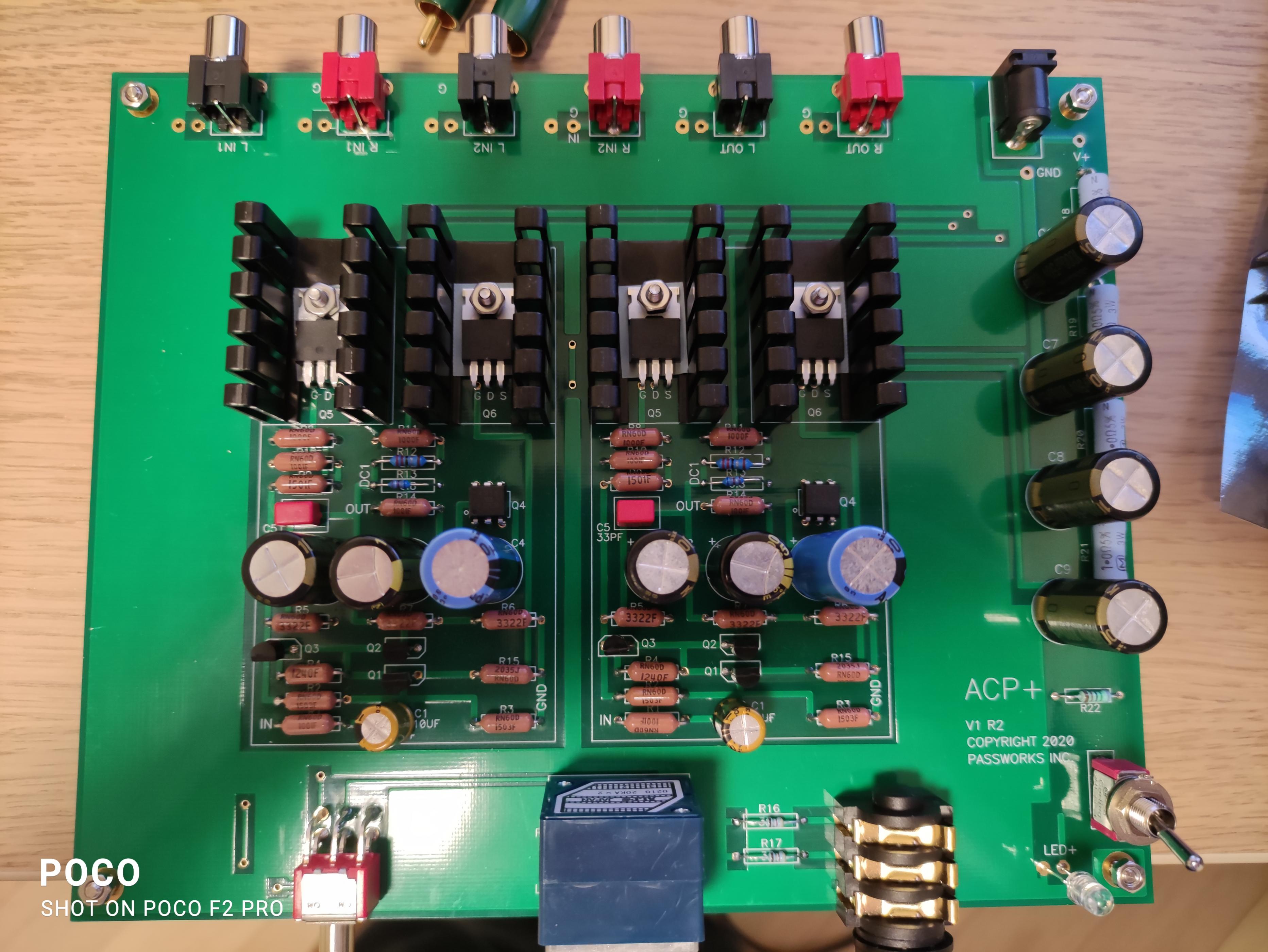

I finished putting everything tgt, and I chked the Voltages, and realised ont he Left channel its 11Vs the the DC1 side of R12 and R13 and on the Right channel it measured 18 ish V which obviously is not whats expected, So I went ahead and plugged in headphones and the right channel is just buzz noise and left works perfectly fine. is there anyway to trouble shoot it? I have checked the solder joints at the bottom , and on the front side i attached a picture , looks identical to the left so im not sure how to go about fixing it. Appreciate the help!
What is the voltage across R15? It should be about 4.5V.
And what is the voltage across R4, and what is the value of R4 (125 Ohm as specified)?
I ran into a similar problem with my build. Based on help I got here in this thread I ended up lowering the value of R4 significantly. The goal is to have 10mA of current across R4, so you may need to try a few values in that position to get as close to that as you can.
R15 on the left channel I got 4.65 V and on the right it's 4.3V
And R4 I'm using 124ohms resistors. Both channels measures around 11 to 11.9 depending on which side of the resistor... Also these measurements are taken by fixing the black pole on the GND at top right and red pole on the resistor either side... Hope that's the right way to do it...
