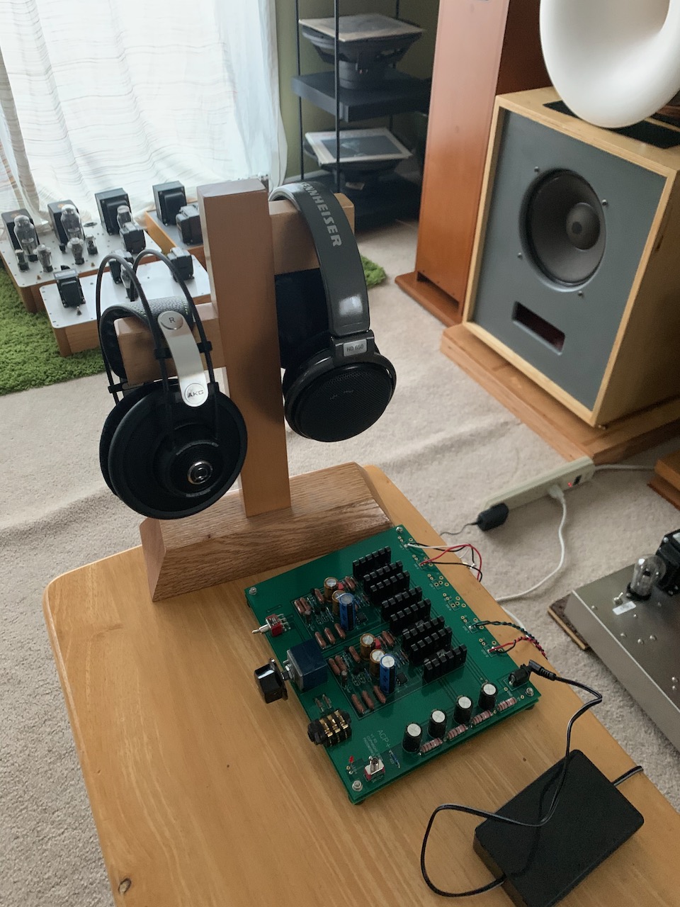

I use the ACP+ with my Beyer DT880Pro (250 Ohm - version).
Outputresistance can be adjusted to the demands of different headphones.
I don't remember the number of the post in this thread, where the formula /
resistance table is described. I think it was Ben Mah? not sure....
My Beyer likes the ACP+. Sounds really good. I also built the Whammy and Waynes Line Stage (to drive headphones). All three preamps are great - as preamp and as headphoneamps. Each has its special 'character'.

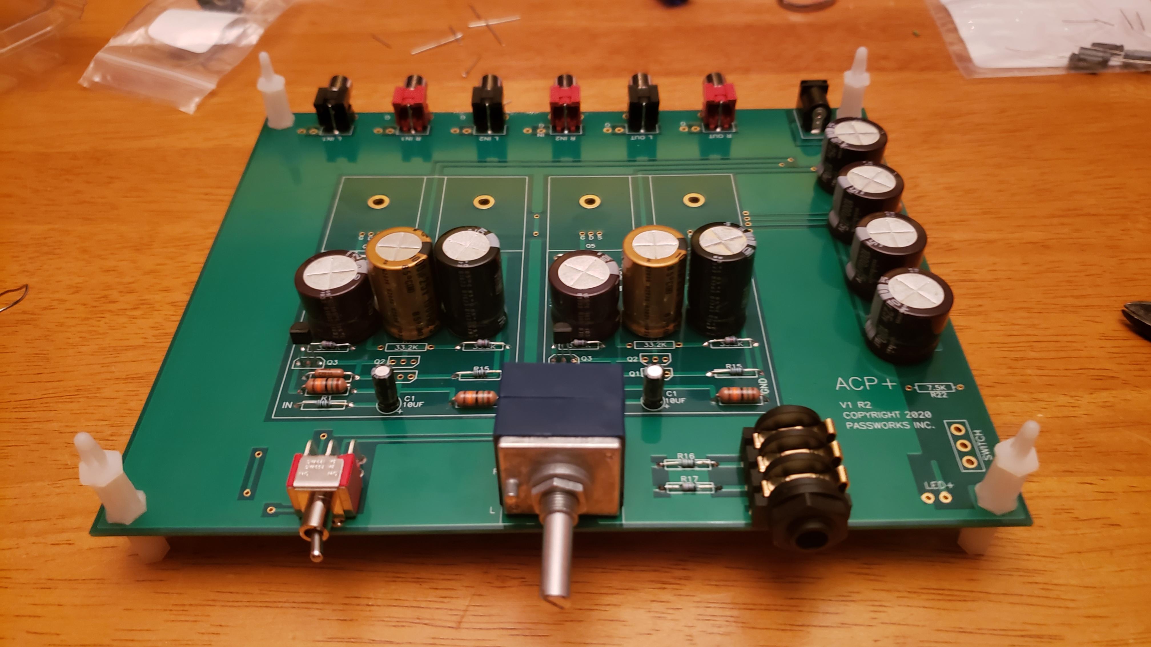

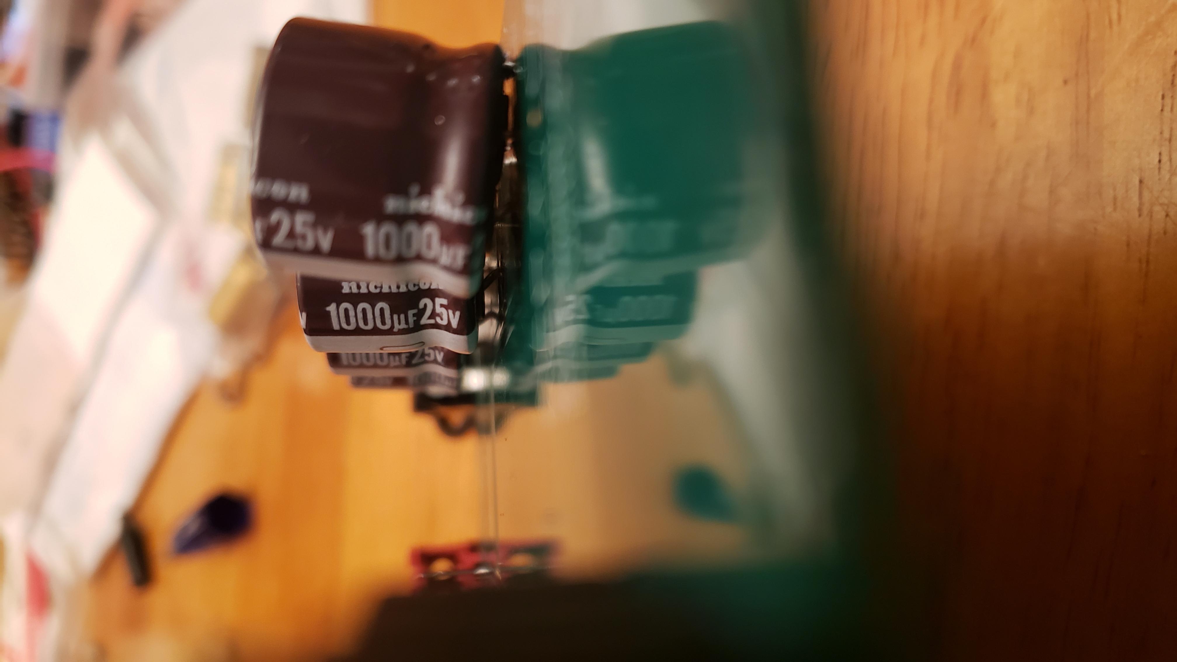

I managed to make the caps I had work. Not only did I accidentally order caps with 7.5mm lead spacing, the caps for C2,6-9 were 15mm wide. So that I didn't have to bend the leads so much to get them to fit, I stuck an o-ring under them to act as a spacer. The o-rings also helped the caps stand up straight as well.

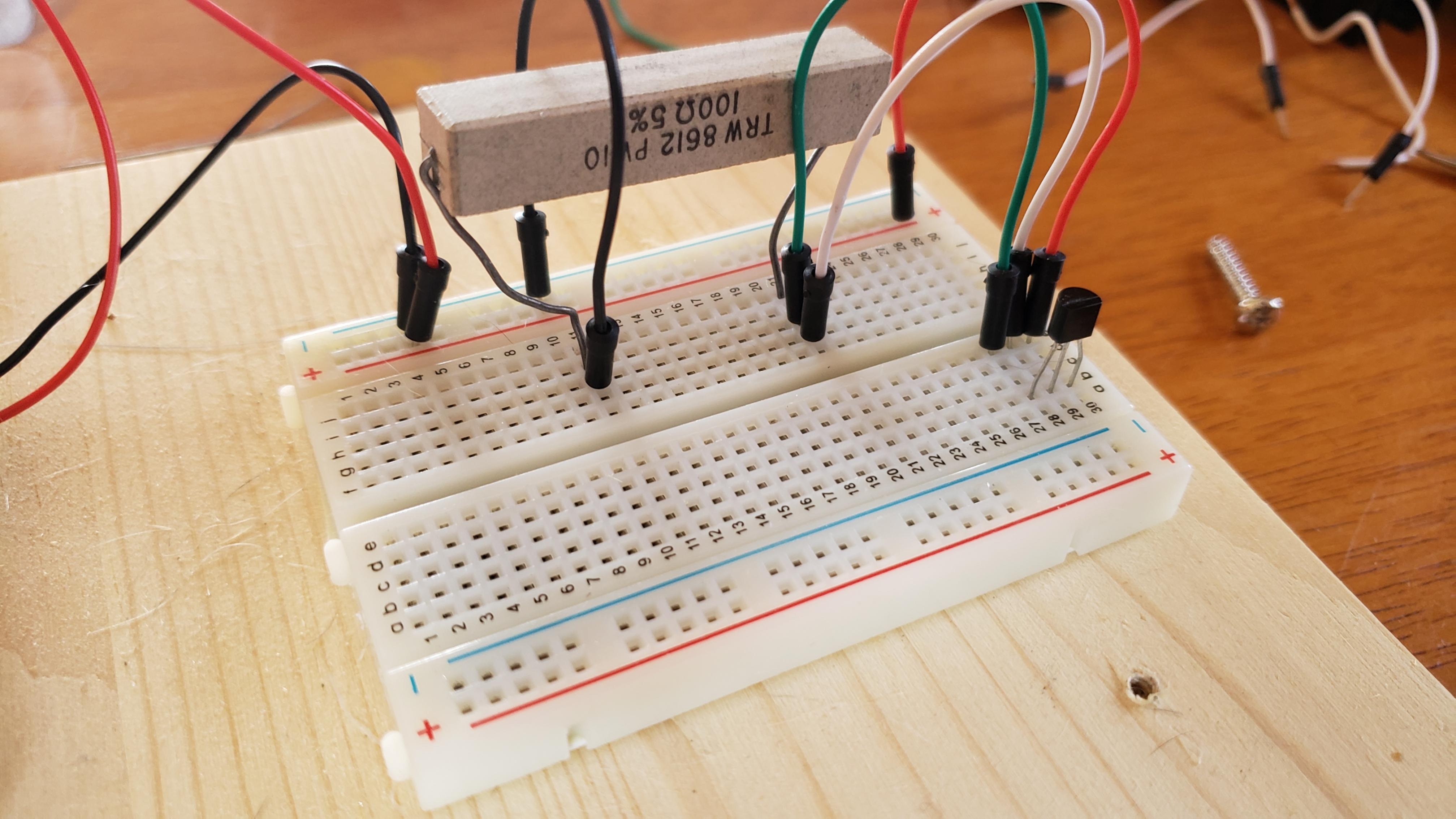

So I'm new to all of this, and I was reading that it wouldn't hurt to match the Q3 jfets. I figured that since I have a couple extra, I'd at least try to use the two with closest values.
I'm using the same process described on how the diyaudio store makes their matched sets, but I'm not sure how to interpret my results. I'm using a new 9v battery, but the voltage drop across the 100 ohm resistor steadily drops once I apply power. Is this normal, or is there something wrong with my testing process?

When I'm measuring across the resistor, I'm getting between 10.88v and 10.81v.
I'm probably just showing my ignorance, which I don't have a problem with because I'm trying to learn. But it seems to me I should have the resistor between the signal and ground instead, otherwise why not measure the voltage drop between the drain and signal+ground pins?
measure voltage across resistor, divide with 100R, that is Ids
you're getting at least 10 times of what is expected - either your JFets are Dodo, or you did not connected something by schmtc, which is good for N JFets
for P JFets just opposite polarity of battery
btw. it is irrelevant where you put resistor , bellow JFet or above
I use fig9 in this page, all explained there
