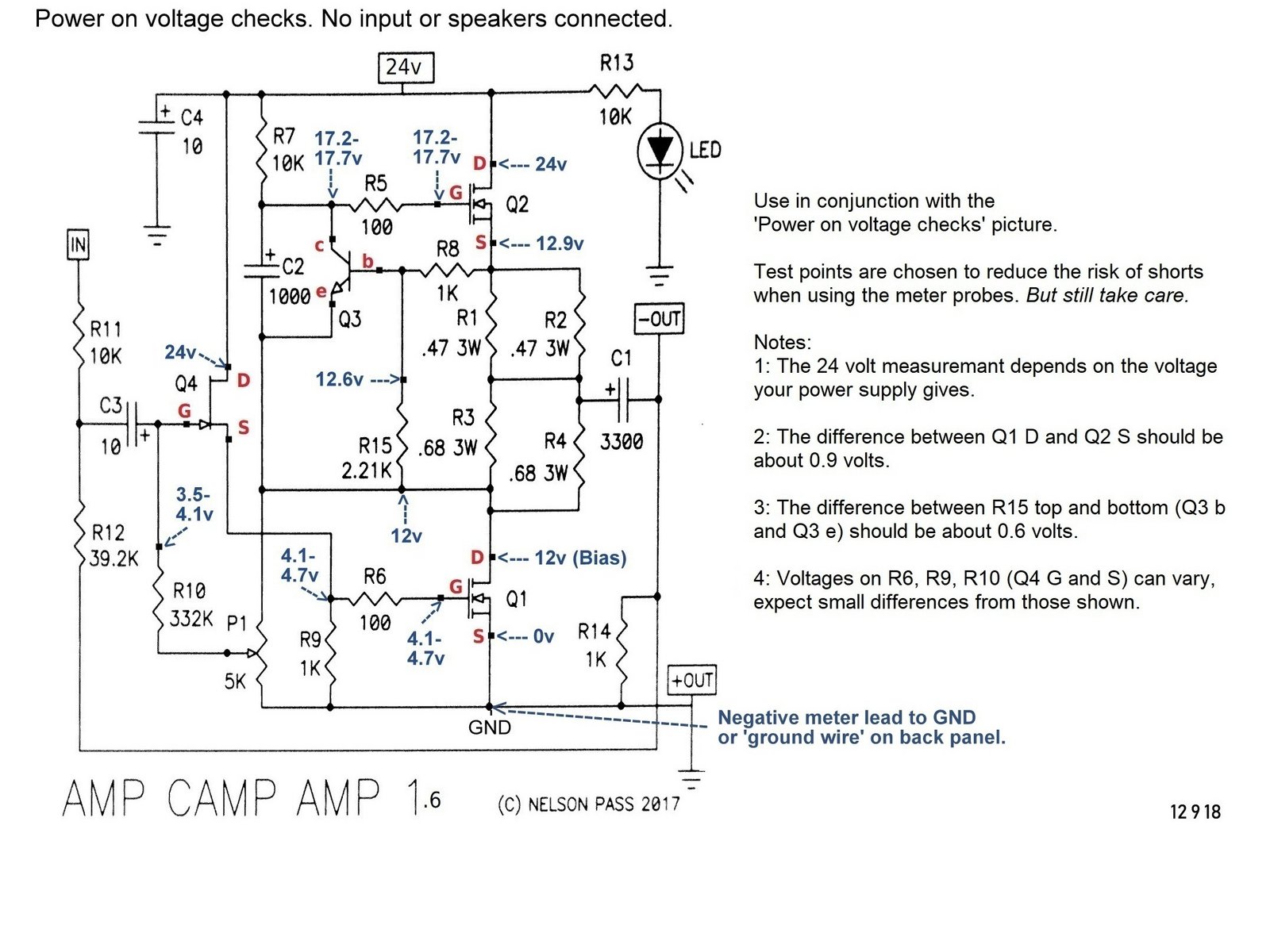

Have you done the voltage checks on image 2 and 3 of ACA 1.6 build guide step 56?

Still not getting any sound. Perhaps it is my the new Emotiva pre. The only other thing is the resistance check on r 10. Using the 2M setting on my multi meter I got 0.32 on both when it says I should be getting 335k. The image shows this reading taken at the bottom of R10 and not at Q4 D?

0.32 on a megaohms scale is 320K. Close enough.

Well gee whiz, not sure how I missed that? Will do. So the gate of Q4 is really measured at the bottom of r10? Can I run the ACA on a line out from my existing receiver?
