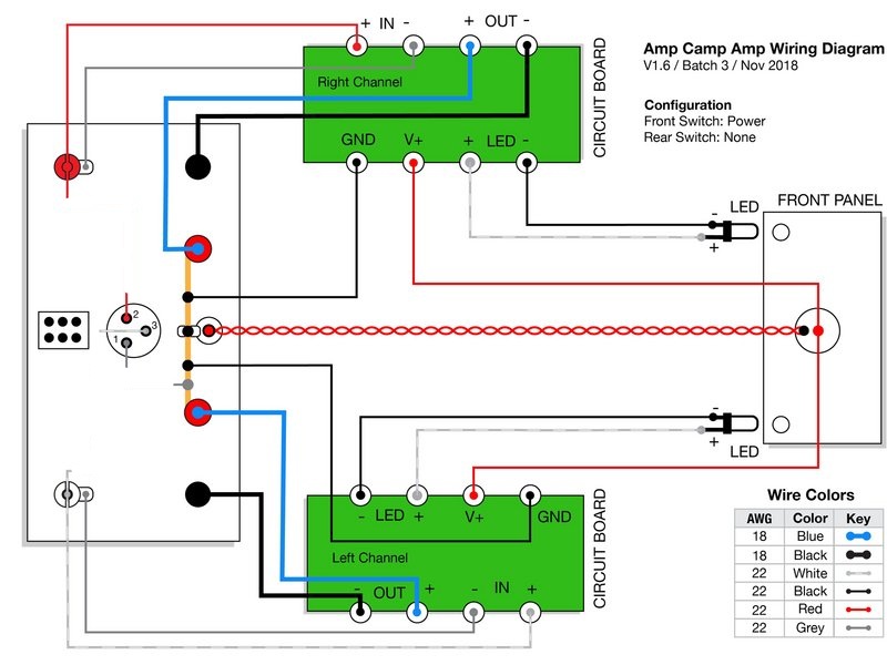

Hello everyone. I'm building from the v1.8 kit, and had a question I wanted to some input on. I will only use the RCA inputs, and run in stereo mode. Because of this, I want to leave out the XLR input and the 3 position selector switch. I assume I can just leave those out along with the associated wiring. Is that correct?
I drew up a version of what the wiring in my case would look like using the v1.6 (no rear switch) wiring diagram.
Yes, you can do that and yes, it's going to wire as you show. 🙂

That said, I'd suggest just building it as standard, if you ever get a 2nd ACA you can run them as mono blocks, and try both Bridged and Parallel configurations from RCA. And who knows, you may get a balanced DAC in the future and use the XLRs. You've already got the parts.

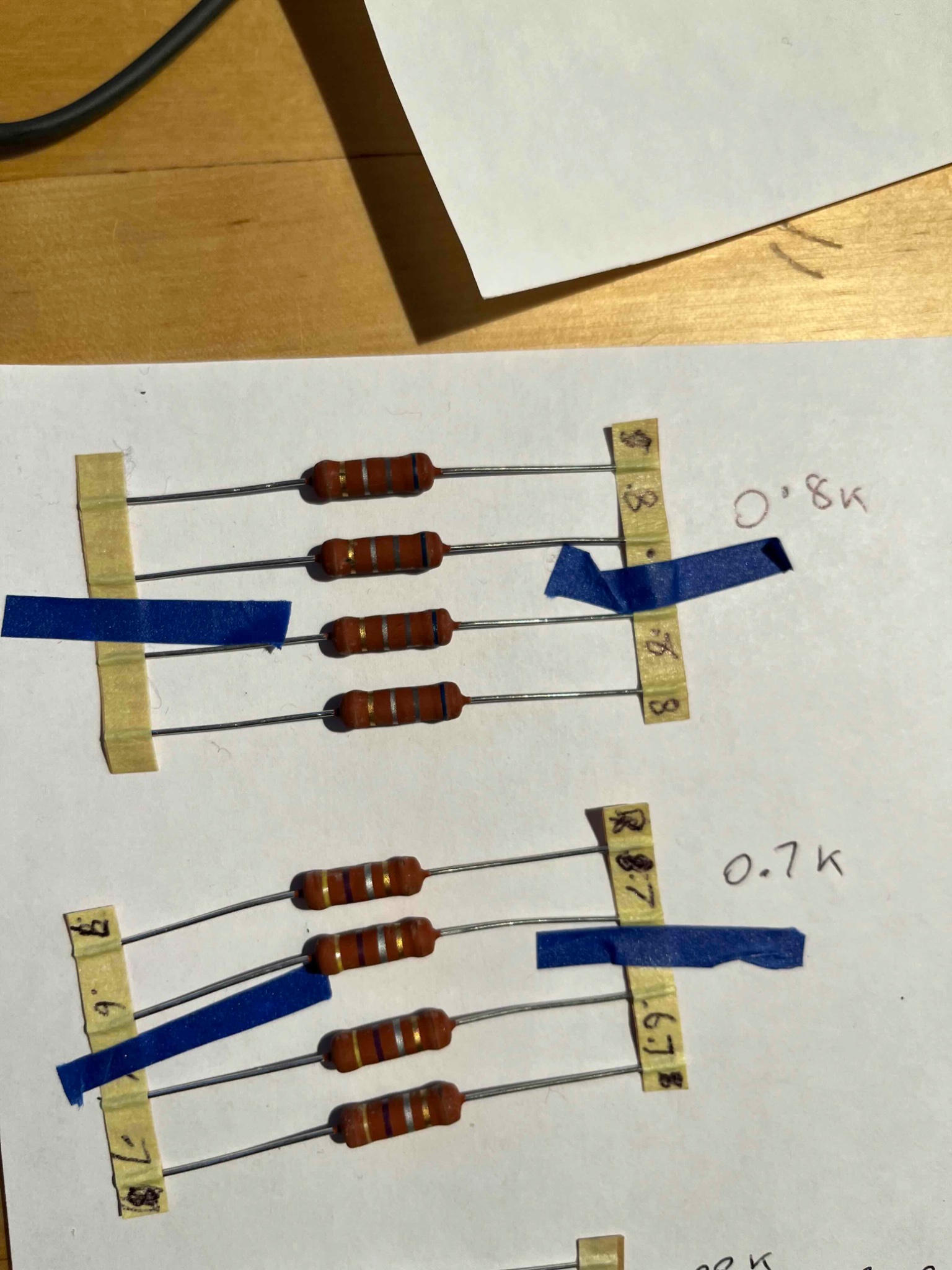

I posted this in the ACA thread in the Pass Labs forum before I saw this thread: I just received a second ACA 1.8 kit having already built one several months back. The resistors R1-R4 supplied this time (see 1st pic) are different than those from the first kit (2nd pic) and also don't seem to match the specs on the board. Since I intend to use the amps as a pair, I am worried that there may be sonic differences. Any thoughts would be greatly appreciated before I start building.
