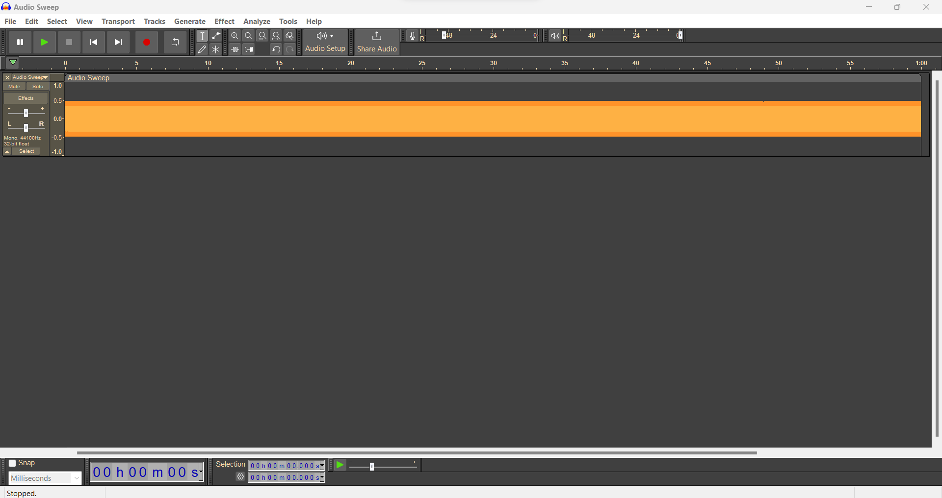

So massive differences round about 30 seconds in on your recording assuming that the sound at 30 seconds and at 32 seconds is meant to be the same.
I've no immediate answer to that I'm afraid... it really needs looking at with a scope to see what is happening.
Have you got a frequency sweep test tone? If not I can create one in a couple of minutes and attach it. It would be an MP3 file.
What I'm thinking is you could record the sweep at say around 0.5 to 1 watt output. That will be very loud to you but safe for the speakers. We could then analyse that and compare channels. You could use the mic initially and I would say use only one speaker and one input feed and swap those between channels so we get a true 'amp only test'.
So you would have two recordings, one of left channel and one of right. We can then look at that and see if there is any deviation.

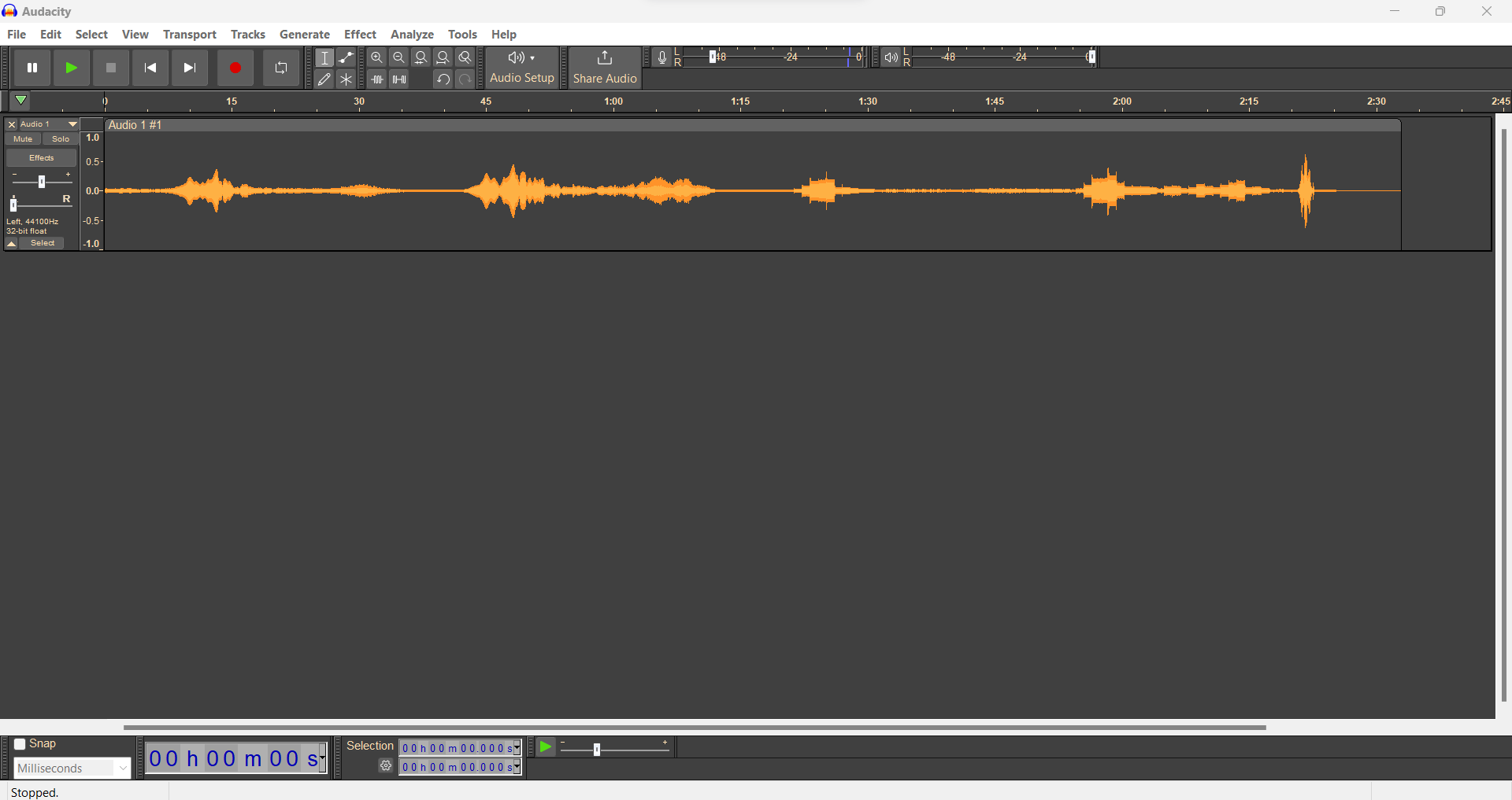

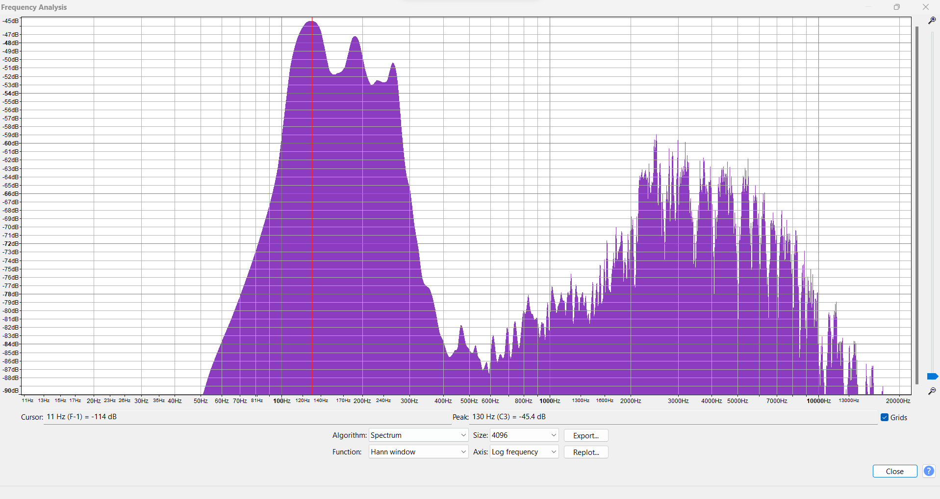

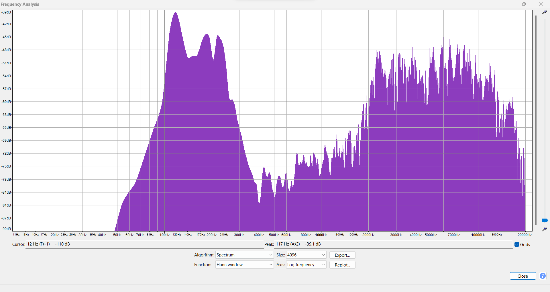

This shows what I think are the two treble parts. One is much higher than the other in amplitude and I've also quickly plotted the spectrum of both. Its very strange for that to be an amp kind of problem... interesting.

Here's continuous & stepped sine sweeps from that Outlier Audio youtube test clip. Really highlights the issue in upper-midrange and beyond. Left channel is first and there's some background noise from the road unfortunately.

It looks very strange and unfortunately isn't giving enough clues at this point. This is your track, so if we say that the midpoint is where it switches channels... well it all just looks really really strange.
Can you confirm you have used one single RCA feed and just one speaker so that we can 100% rule out anything other than the amp? Signal handling faults (uneven and weird response) are almost unknown tbh. I can't begin to imagine what is happening here although I know for sure a scope would show things much more clearly.
So you really are getting into oscilloscope territory here.
If you could feed a known good sweep into the amp (not one from YouTube 😉) and connect the output of the amp to your PC line in and record that then we might have more of a chance. You would need to leave the speaker connected as a load and you would need an attenuator on the line in.

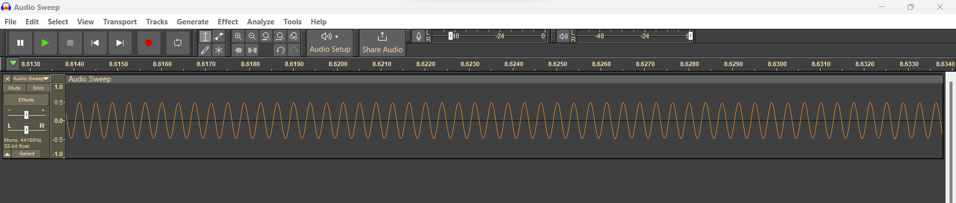

I've attached a 192kbps MP3 100Hz to 18kHz sweep in case it is any use.
The frequency sweep would (should) look like this, a constant amplitude across the frequency range. If we zoom in we see the sine.

Thanks Mooly, should have a moment to try this in the next few days. Just want to check the setup so you get what you need.
I'll run a single RCA (from my DAC at a fixed source volume) into the right channel first, record the test tone, then switch the same RCA into the left channel and connect the same speaker to the left speaker outputs, correct?

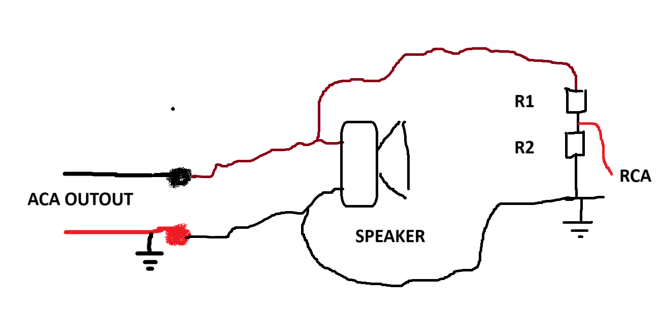

That all sounds OK.Just want to check the setup so you get what you need.
Remember that the speaker sockets (red and black) on an ACA are reversed by design. Make sure that the ground of the lead to the PC really does go to the speaker terminal that is grounded in the amp which should be the red on.
So like this. R1 and R2 may not be needed if you keep the level low. If it overloads the PC input you need it. R1 and R2 can be any reasonable combination such as 10k for R1 and 1k for R2.

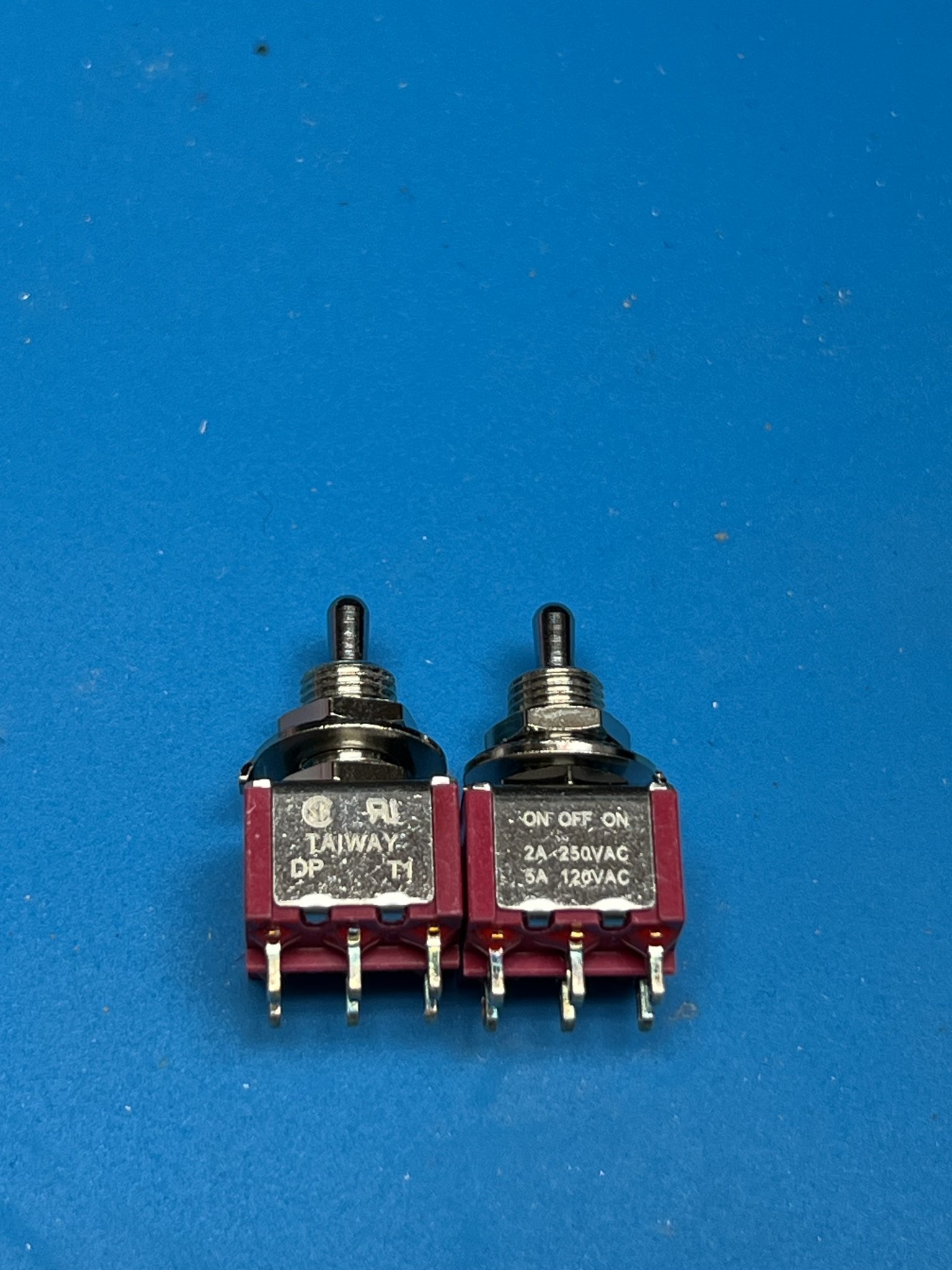

The switch I’m still looking for. I do have a couple of DPDT Taiway on-off-on short bat switches rated at 2A/250v, 5A/125v.
