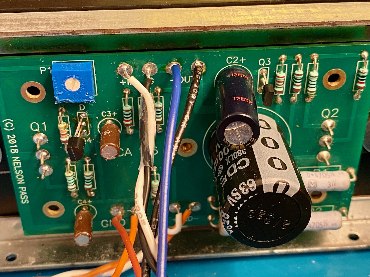

Those results are fine in practice. The voltages are not absolutes (the ACA is not a precision DC amplifier) and they also drift with temperature. The midpoint at approx half supply voltage allows the output to swing equally above and below that value meaning you get symmetrical clipping should you drive it to high levels.
The voltages across the low value resistors allow the quiescent current to be calculated. 0.312 volts across 0.47 ohm is 0.66 amp. You will find the same value calculates out for the 0.68 ohm. 0.452 volts is also 0.66 amp.
The actual vbe (base emitter volts of Q3 (how much voltage it needs to turn on) and the gate/source voltage of the power FET's also affect the result.
So all good there. I still think you need to swap out Q4, to at least prove it one way or the other.

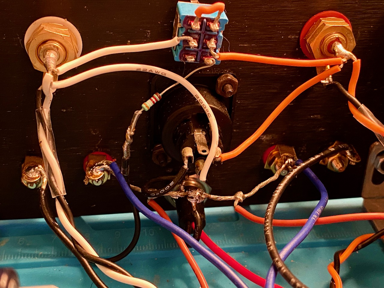

I have a pair of "identical" v1.8 amp camp amp's with few mods mentioned on this forum.
With XLR connection (switch at the middle) speakers (88dB sensitivity) are totally quiet to my hearing. All ok from XLR.
When I connect RCA connector to amp, I get hum/buzz to a speaker (other end of RCA cable free).
Hum/buzz goes away if I short circuit open end of RCA cable. Connecting it to other electronics is not removing hum/buzz.
Both amps act the same. And so does Input A and Input B (when connected alone).
I usually use only XLR so this has not been a problem, but now I have B1 Buffer Preamp and it comes with RCA connections.
Hum/buzz is quite quiet, but it can be heard in quiet parts of music or when playing at very quiet levels.
Bridging resistors have been changed from original 39k to 68.1k ohms. Other mods are on boards / same for XLR and RCA, as I understand.
If I measure those resistors, those give only about 42k ohm (power off).
I have tested "switch up" and "switch down" possibilities. Same results. Even stereo (switch at middle; RCA) gives hum/buzz when RCAs' are connected to amp.
But if I connect both RCAs' (switch up), there seems not to be any hum/buzz (even from straight of my DACs RCA SE OUT).
B1 is not totally quiet same way, there will come small hiss (when both RCA's are connected in the one amp, switch up). Yes, instructions say connect 1 RCA only to Input A, but I tested this also. May help you or not. Anyway, another RCA connected seems to make this more quiet.
This is hard to explain, hope you have simple answer 😉
It would be great if I could measure what is wrong some how. Where I should start looking for?

Kind of hard to untangle it all... so first question, are you using the Meanwell PSU recommended for the ACA?
It is relatively common to be able to measure very high AC voltages from a floating SMPS to ground and this is usually caused by inductive leakage in the switching transformer and also from any deliberately 'designed in' coupling between the live and non isolated side and the secondary side. This can typically be a small very high voltage cap.
Although no mains hum should come down the DC output it is still possible to get a ground loop if the negative of the PSU output is connected to mains ground in the SMPS. I don't know if the Meanwell is a two or three core mains lead (so double insulated or mains grounded). A true ground loop would produce 50 (or 60) Hz.
The ACA should be silent on RCA inputs if just the PSU is attached and shorting plugs are fitted to the RCA inputs.

I swapped the left and right Q4 and precisely nothing changed. I’m baffled.
Would it help if I make a recording of that YouTube test video and the audio? I have a decent mic that should be able to pick up the imbalance. It’s totally hollow from the higher midrange on up. I’m just not sure how to approach this.
As always, truly appreciate any help offered here.
You could try a recording I suppose. Looking back and I think we said all the voltages seemed OK (post #1260)
Are you sure it is nothing like the speaker output leads from board to socket being reversed on one channel (so speakers out of phase) although that wouldn't cause crackles and static noise.
