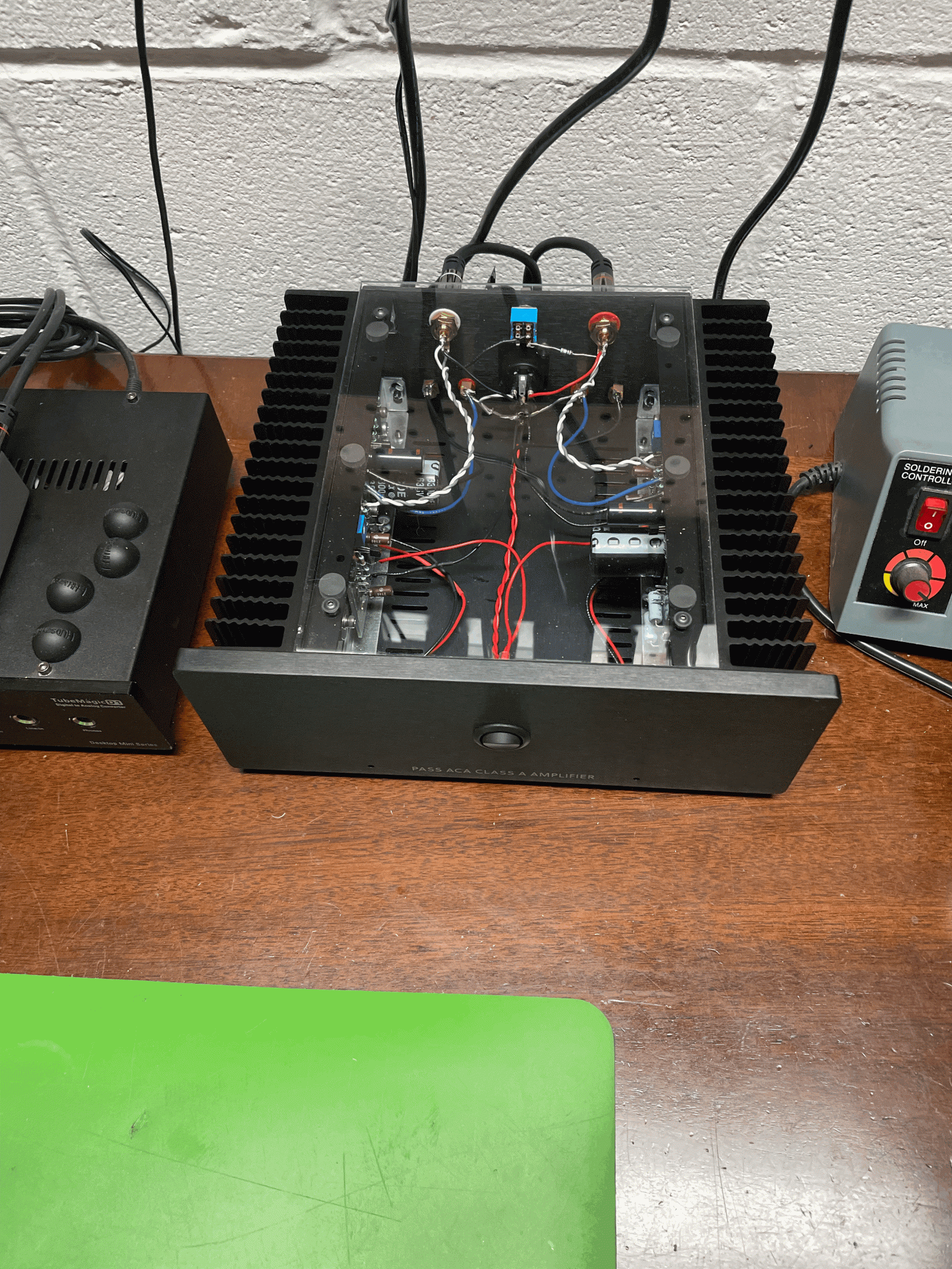

Small update. I'm making progress, but still facing an issue, it seems.
The pigtailed powerjacks worked like a charm and required no drilling, so that was a win. I rechecked all my resistors, wiring and solder points, and I think everything looks right. I powered up and got both lights on, proper grounds, and no voltage across the speaker outputs, but most importantly, no more smoke!
Testing with the selector in Stereo, I'm getting 23.81V on each side's V+, ~23.8 on Q2 Pin 2, and successfully adjusted the pot to get 12V on the right channel Q1 middle pin, but for some reason the Left channel doesn't really respond to adjustments on the pot and is reading overvoltage at ~20V. Any ideas?
I did start to try troubleshooting based on the resistor values across both channels, and found some differences, but I realized the build guide Step 56 doesn't seem to match the v1.8 kit's resistors, so I'm a bit lost. I also checked the V In from RCA on each side and found ~0 on the right channel but ~2.4 on the not-working L side with no source connected, so this seems like a problem, but not one I'm sure how to correct. The LEDs also fade out pretty slowly (~10 sec) when I flip the power switch off, which seemed possibly odd.
Please let me know if any updated photos would help.

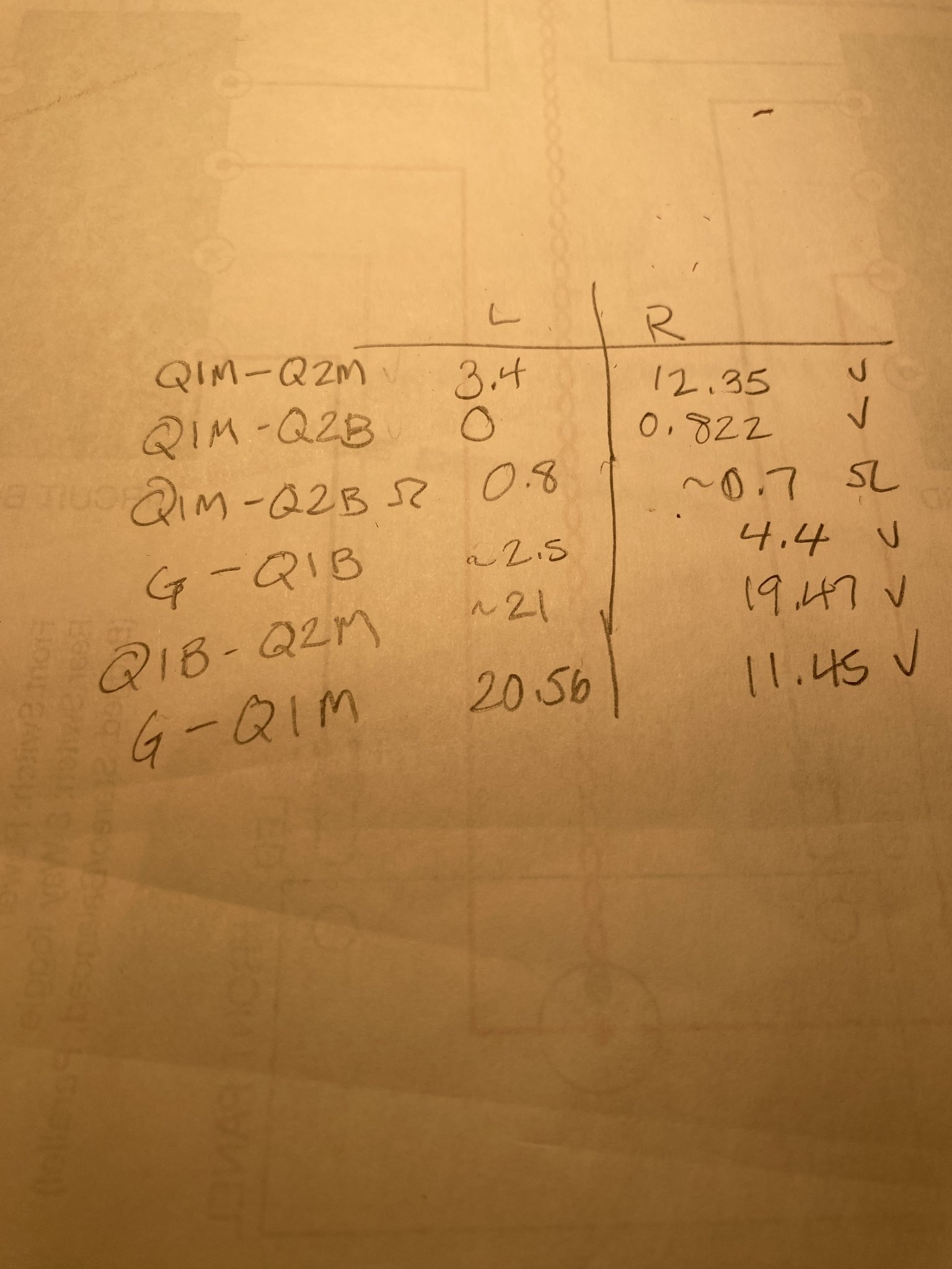

Thanks, Mooly! All those values roughly check out on the right channel. 12.4V when measuring ground to Q1’s bottom pin and 0.83V between that pin and Q2 middle pin. Does that sound about right? This is at 11.9V between ground and Q1 middle pin.
I made a quick table to compare:
I was also getting similar temps on both channels ~99* F for left and 102 for right after 10 minutes of power on, but after 20 min on, the left channel dropped to just 86* while right was up to 108* F.
Resistance in circuit looks OK. 0.7 ohms for R and 0.8 for L.

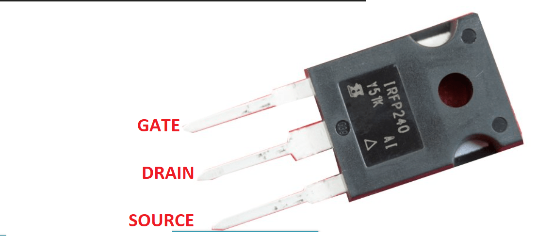

The voltages sound about right, maybe written ID of the pins might be amiss although your picture looks correct :)
The Drain (middle) of Q1 should be at 12 volts and the Source should be ground. Q2 middle pin (Drain) should be at supply voltage (24 volt)

The channel with 20 volts rather than 12 volts at the midpoint has a problem.
You seem to show no volt drop between Q1 Drain and Q2 Source for this channel meaning no voltage across the low value resistors. That suggests Q1 is not being turned on.
Check that the small FET (Q4) is correctly fitted and check the continuity (with the amp OFF) from all leads on Q4 to their destinations. The Drain should go to the supply and the Source should go to R6 and the Gate of Q1. So you should see 100 ohms measuring between Q1 Gate and Q4 Source. Measure to and from the leads themselves and not on the print as likely trouble points are cracks in the print around the solder pads of the parts.

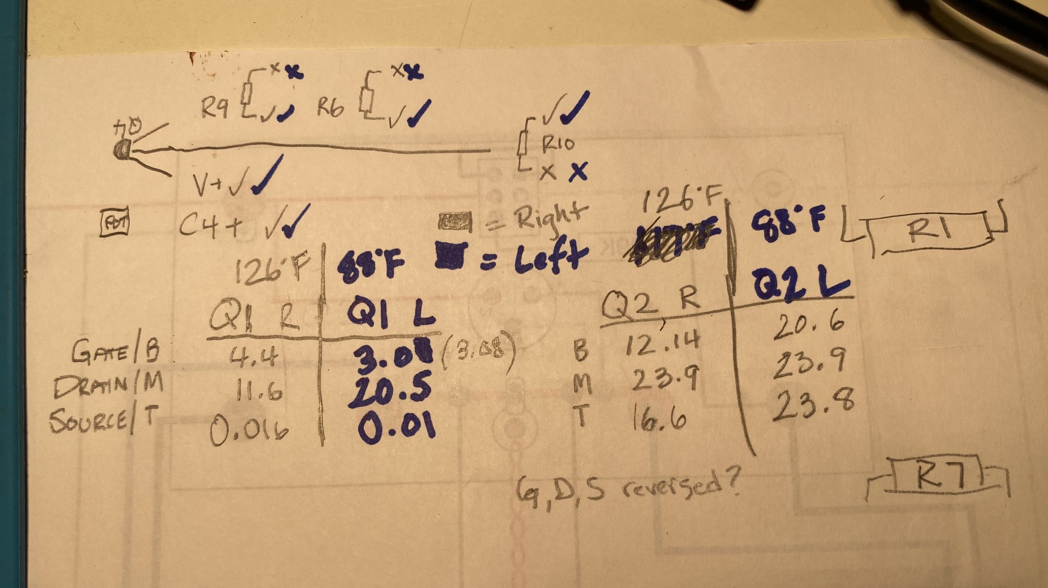

Thanks again, Mooly! Here's what I can report back. I did get 100 Ohms between Q1G and Q4S on both channels, so that's good. Voltages... less so.
I tried another table/drawing. Hope it helps. Pencil here is the Right Channel, blue Sharpie = Left Channel. Check mark indicates continuity... X = no beep. Still not getting head from the Right Channel, so I think you're right that Q1 is not turning on.

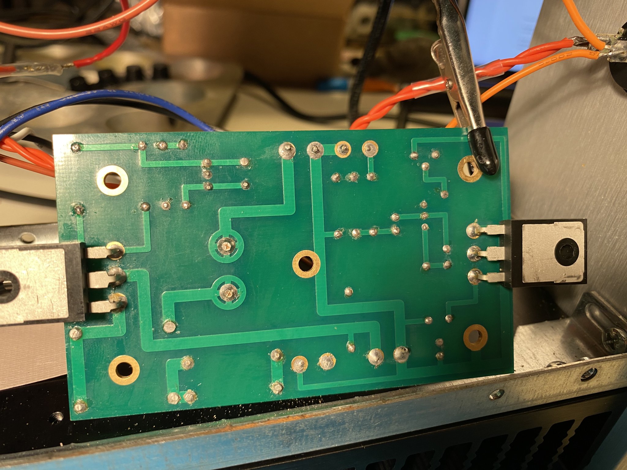

I did check the back of the PCB on the troublesome Left Channel, but it looked okay to me.

Q1 isn't turning on, the 3 volts on the gate isn't enough. That voltage is derived from the input FET Q4 and of course depends on the setting of the preset.
What are the voltages on Q4 as measured from ground? Measure on the pins directly. You should have supply on the Drain (24v) but what are the other two pins at?

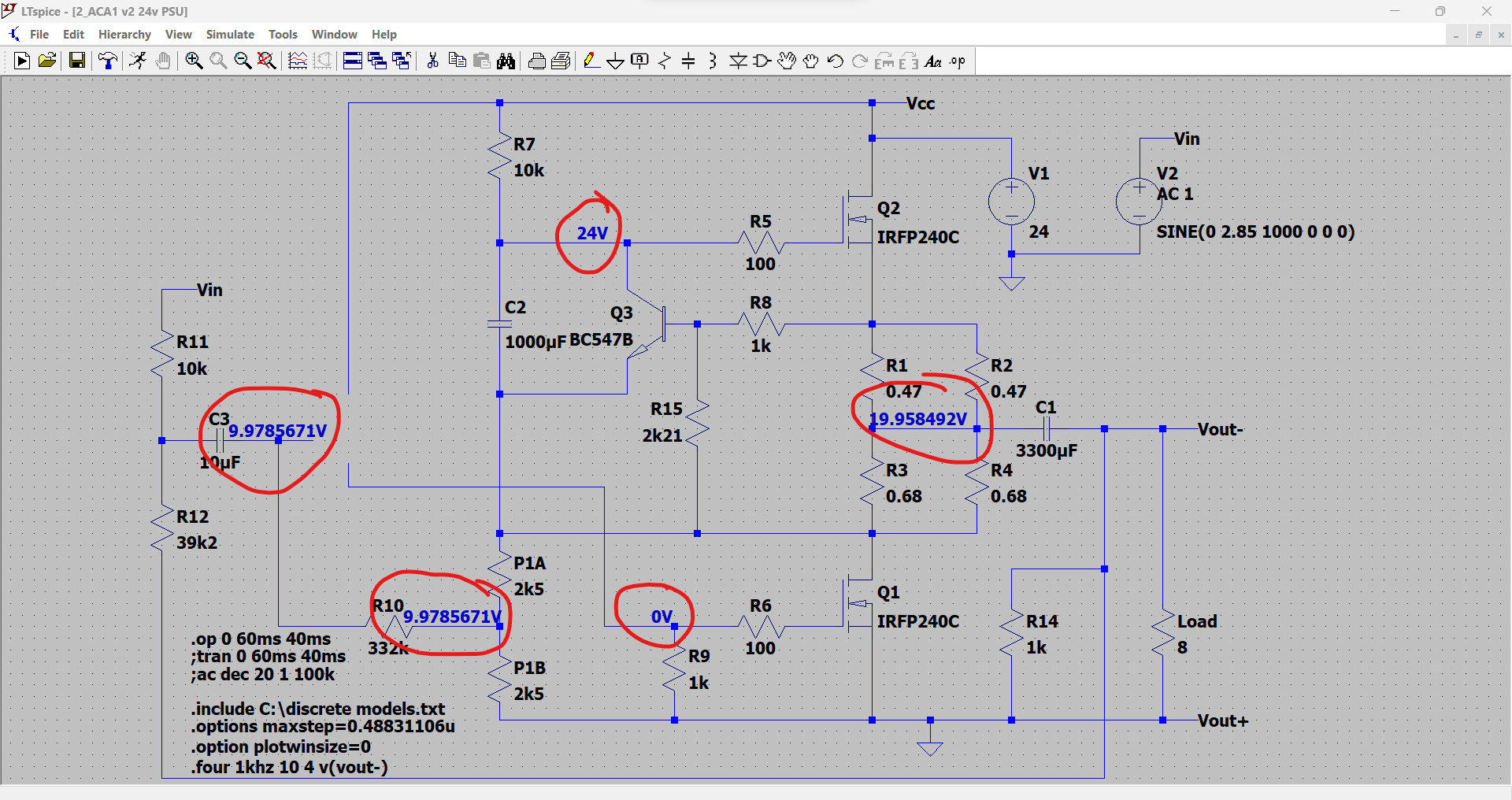

I wanted to make sure I understood correctly before removing Q4. I should remove Q4, then measure ground to each end of R10, and I should see 10V on each end, then 0V when measuring across both legs of R10 at the same time? If so, Q4 is shot?
Yes, with Q4 removed and the preset centred you should see approx 10 volts on R10. There must be 0.00 volts across R10 in that condition.

This is what you should see with no Q4 fitted:
