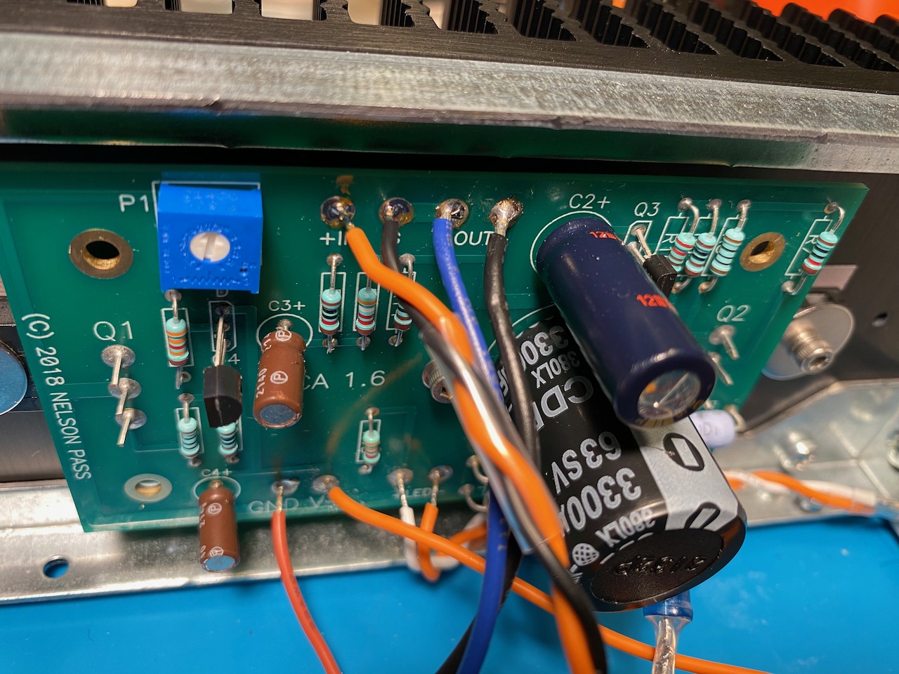

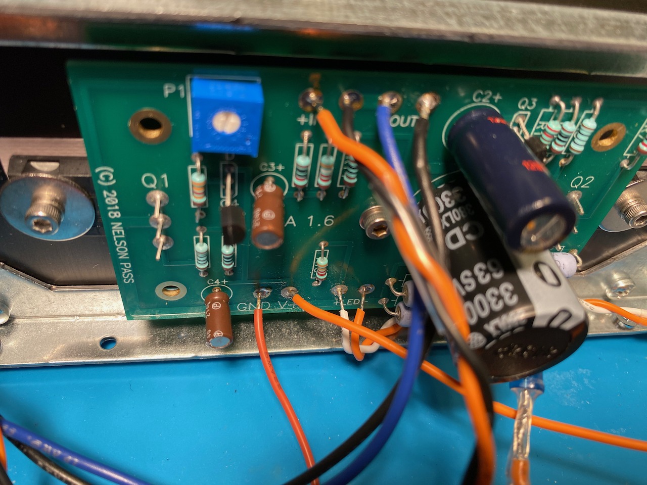

In addition to what @6L6 suggested, please post close up, high-res images of your board so we can help.Hey all,
I got the 1.6 version of the amp that I first assembled in a wooden case in 2020. So far it got super nice but since I didn't have time to finish properly the enclosure I decided to get the aluminium one a few days ago.
So I decided to transfer the whole set up into the aluminium case, and realizing that the DC power input jack wires were too short compared to my wooden setup to reach the rear panel, I just soldered it the wires witout attaching the barrel connector to the panel, you know, just for the test. And then it got wrong... While the amp being turned on, I observed a little crack on the little tab of the barrel connector. What I suppose is that the red twisted pair of wires touched the ground bus.
And now, only one PCB delivers the sound. I guess the other one burnt somewhere but I dunno where to start checking ? Could you guys please orientate me in the diagnosis ?

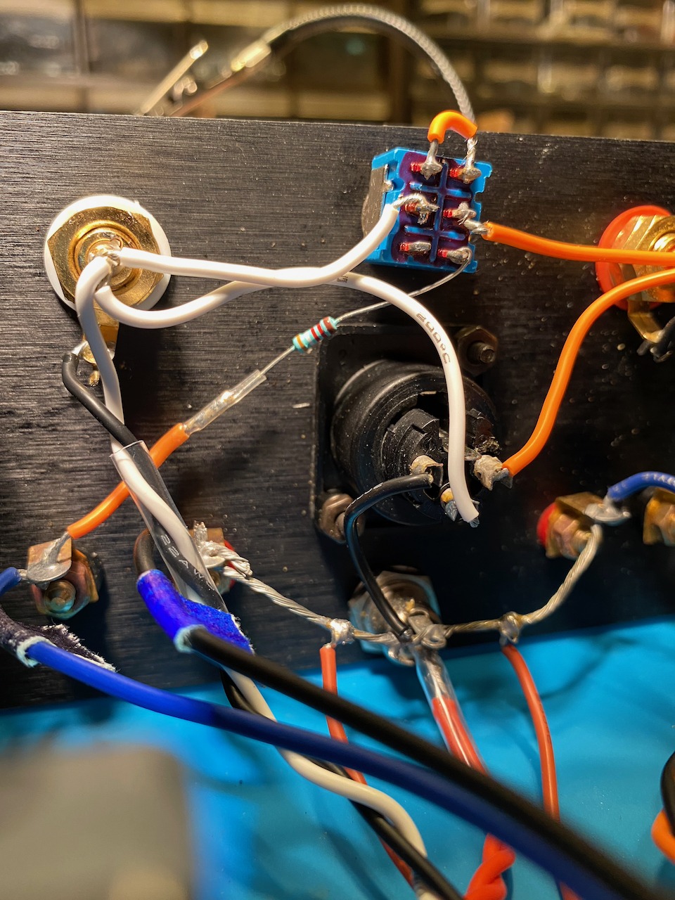

The switch always seems to confuse. All it does is route the input signal to one channel according to what mode you want the amp to run in. Replacing it will achieve nothing. If you have any doubt then just measure the continuity from the amp inputs (R11) and make sure it connects to where it is supposed to.

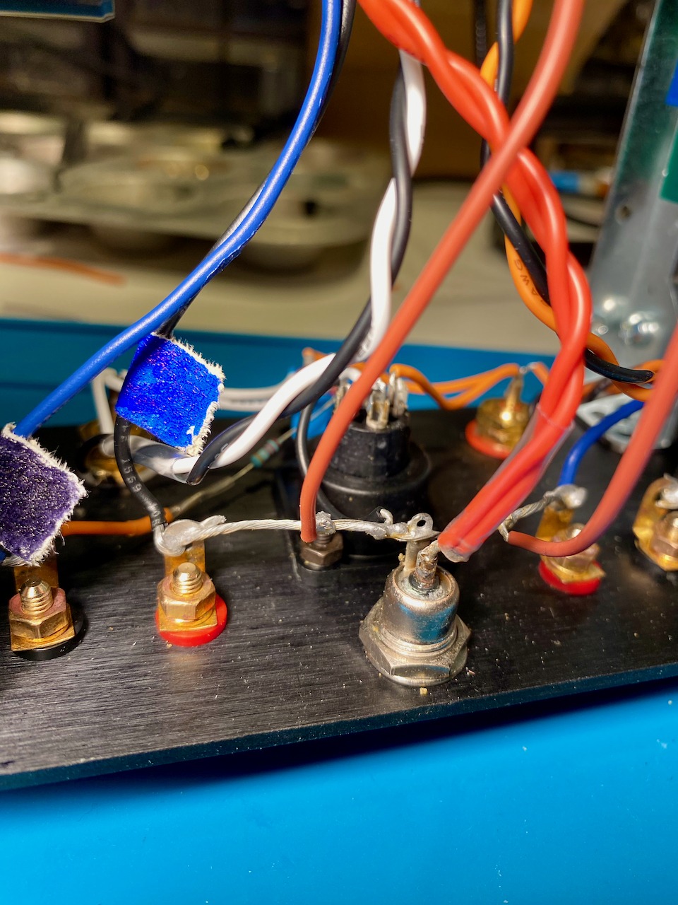

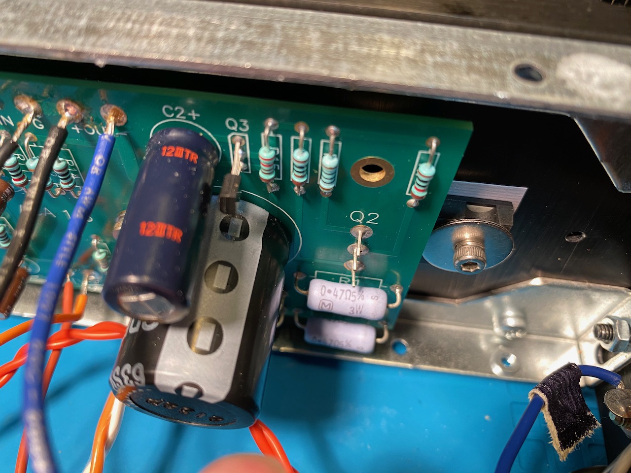

Well... I finished assembly of my ACA 1.8 kit just a few moments ago, which was my first real attempt at any electronics build. I thought I had checked all my wiring, but upon connecting power I only found one LED lit.
After the power had been connected for just a minute or two as I was preparing to adjust the DC balance, I noticed a tiny puff of smoke from the inside of the power connector and immediately disconnected the 24V DC in. I rechecked all my wiring and indeed I had reversed the left channel LED +/- to the circuit board. 🙁
I'm a total novice here and honestly a bit unsure how to proceed without causing damage to myself or the amp. Can anyone offer some advice on how I might proceed? I've already fixed the LED connection, but I'm unsure whether I should reconnect power before any other steps.
I've been really amazed by all the help offered here, and so just want to say a big thanks to the community in advance if anyone's able to help.

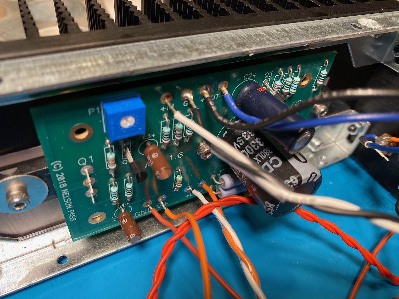

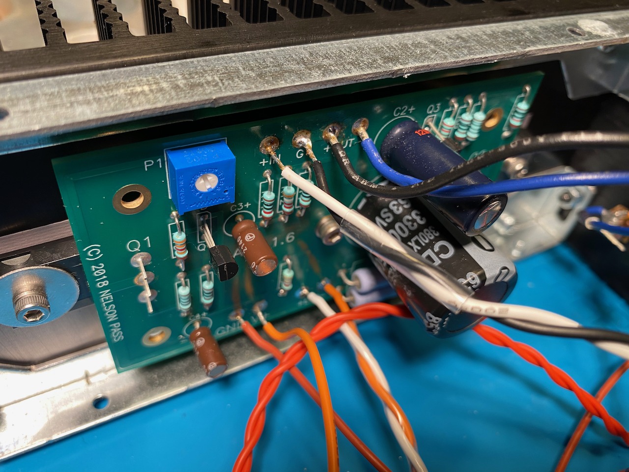

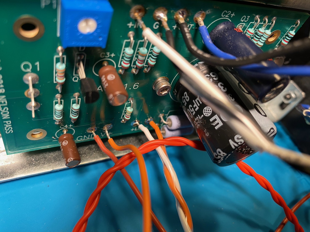

I've taken the best photos I could with my phone, so I hope they're helpful. I'd be very happy to take additional pictures if it might assist in diagnosis.
Please note that after noticing some complaints about the supplied wire, I swapped in some other wire (https://www.amazon.com/dp/B01M0O1NXM?psc=1&ref=ppx_yo2ov_dt_b_product_details) in my favorite color, orange, in place of the red 22ga and used brown for the power grounds, as well as replacing the black LED . I also mistakenly swapped the blue & black 18ga colors (blue/black) on the left channel speaker posts, but they were correctly wired to the PCB and tagged with some colored tape as a reminder. Hope it doesn't cause too much confusion.

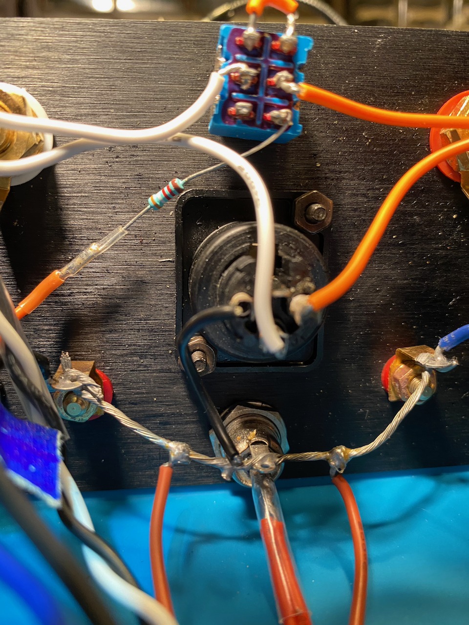

measure if the PS still works.
measure if you have continuity between the hot and ground of the PS jack on the chassis. If you do, time to replace.
edit:
the jack looks ugly, like it has corrosion on it. Suggested to take a close look at it and test connections.
Some of your solder joints could use revisiting. Want a good shiny finish to them.
If the PS is working correctly and getting correct voltage into the chassis, try one board at a time to reduce pull on the PS until you know both channels are working correctly.
edit:

Not sure if it's relevant, but I was using the Fire Metall Eutectic solder and some old flux that I found in my dad's workshop. Does flux have a shelf life or anything like that?

For the SMPS, set the DMM to VDC, put the red probe inside the output ferrule and the black on shiny bit of the outer barrel of the output ferrule. This should read 24VDC.
For the power jack on the chassis, a couple ways to do it:
1. Set the DMM for Ohms (Omega symbol) and measure the resistance between the jack center pin and the outer barrel. Place one probe on the center pin and the other probe on the ground bus/wire. This should be very large, 1M or higher.
2. If the DMM has a continuity checker (marked by the radiatiing sounds waves symbol that is a bit like "(((", set it to that. Touch the two probes together and there should be a steady beep for as long as the probes are touching. Now do like number 1 (touch a probe to the center pin and the other probe to the ground bus/wire) and listen for a beep.
If resistance is 1M ohm or higher OR the beep doesn't sound, the jack should be good. If the resistance is low (anything under 1M) or there is a beep, need to replace the jack or figure out what is causing the short.

23.98V DC on the power supply! That's a relief, at least!
Thanks for helping me realize I needed to set the function to the o))) symbol! They were all marked on the dial but I needed to also press a "function" button to get into continuity mode.
1. I get a reading of ~370 Ohms which slowly climbs towards 390ish the longer I keep the black lead on the busbar or outer barrel and the red probe on the power center pin.
2. Check beeps, but I get about the same reading as above with red on center pin and black to the bus.
FWIW, I also get a solid ground check from the busbar to the chassis and the GND pins on both PCBs.
Seems like I'll need a new power jack? I looked on the DIYAudio site but didn't see that single part anywhere.
Are there any obvious things I should start looking for to identify a short? I don't see any touching wires/leads that aren't connected in the 1.8 wiring diagram. Again, really can't thank you enough for the detailed troubleshooting! It's giving me hope 🙂

If you have the correct 24 volts getting to the PCB then you can carry on fault finding. Measure on the PCB itself and confirm you have 24 volts between ground and the centre pin of Q2.
The reversed LED will not cause any damage to the ACA itself although it will have caused the reverse voltage rating of the LED to be exceeded. That may or may not have impaired the LED. If it lights its fine.
If you're measuring with the signal boards still in the circuit, the 380 seems reasonable.
the 1M ohm would be applicable with the signal boards out of the circuit, which was the original intent in the described measurements.

Well, as soon as I reconnected the power to the amp I got more popping/smoke on the inner (amp interior) side of the power connector. I assume this means I'll need a new one and to rewire that part. Is this the right replacement? Anything else I should try while I wait for a new jack?
Well it does appear like you need a new one 🙁 Very strange. When you solder to the centre pin (in particular) make sure you use a hot iron and be as quick as you reasonably can so as not to overheat/melt anything in the jack.
It looks about right but I've never seen one for real and so perhaps others can weigh in on that.
