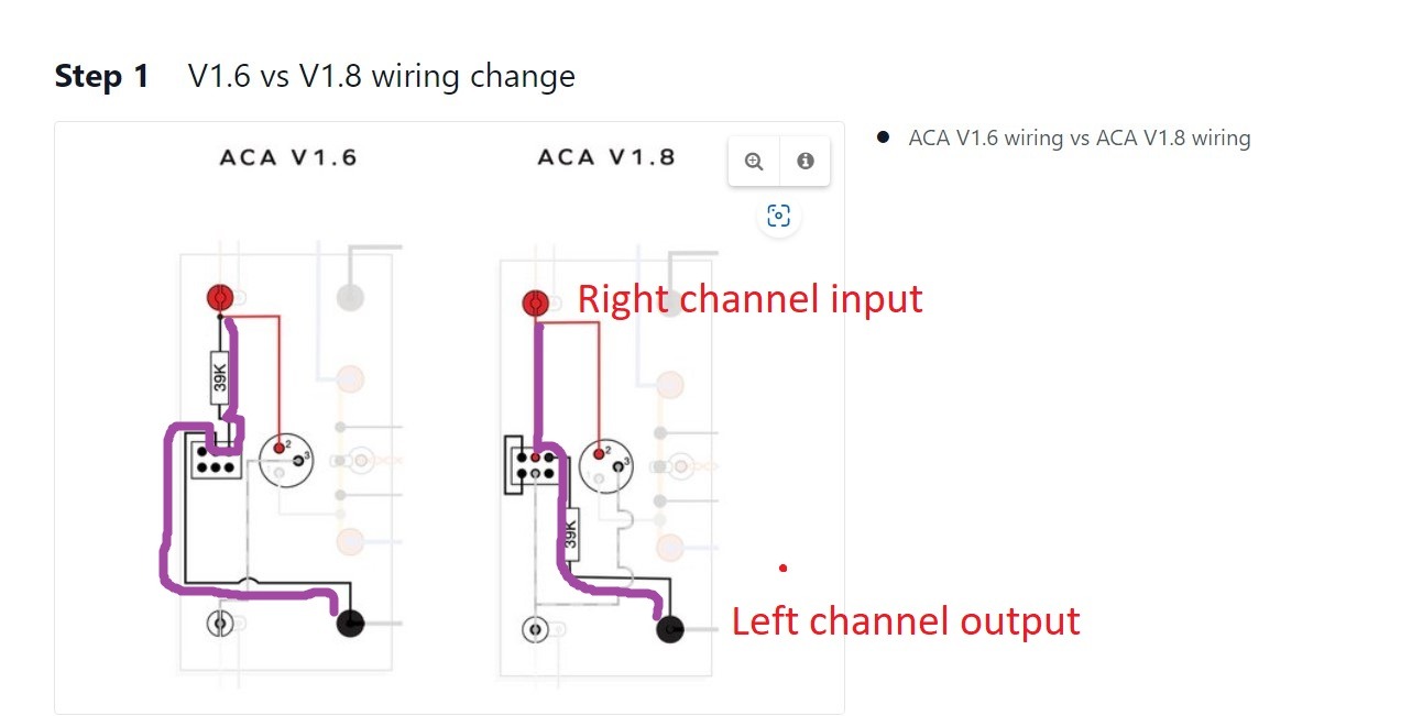

The switch needs to be in the position that connects the 39k from the left channel output to the right channel input as shown here. In the diagram here that means the centre top pin and top right pin of the switch are connected when the switch is in the bridged position. The right input red RCA socket is left unused.

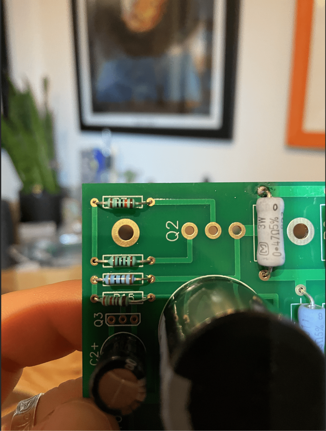

Hey all, I appear to be missing two 10kohm resistors for the R13 spot. I may have never recieved them, or may have misplaced them. Either way, I need two 10k ohm resistors, will any 10k ohm resistor do?

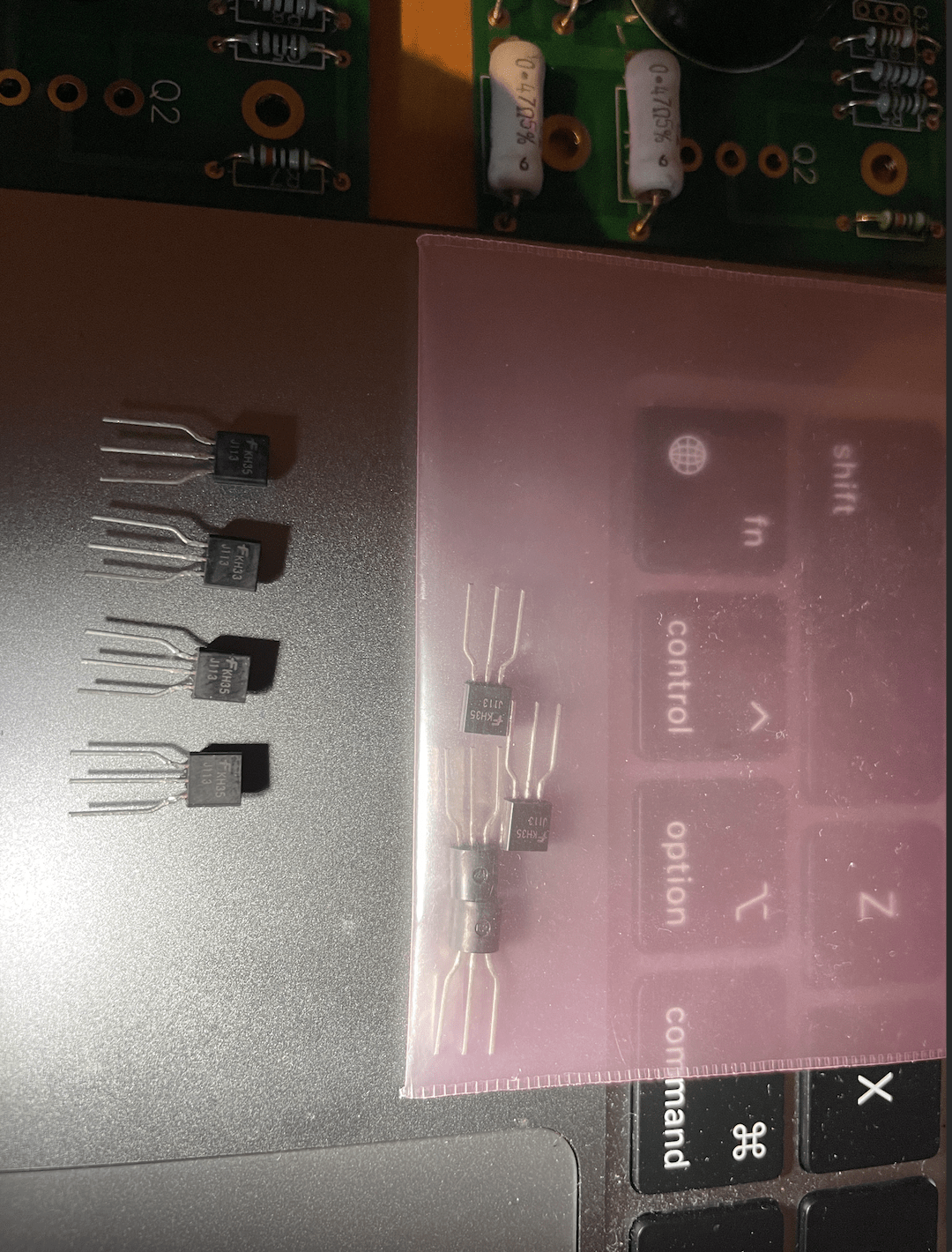

On another note, I can't tell how to identify which transistors are meant to go in the Q3 and Q4 spots on the circuit board. From what I can tell they are all the same, but the schematics have different ID#'s listed.

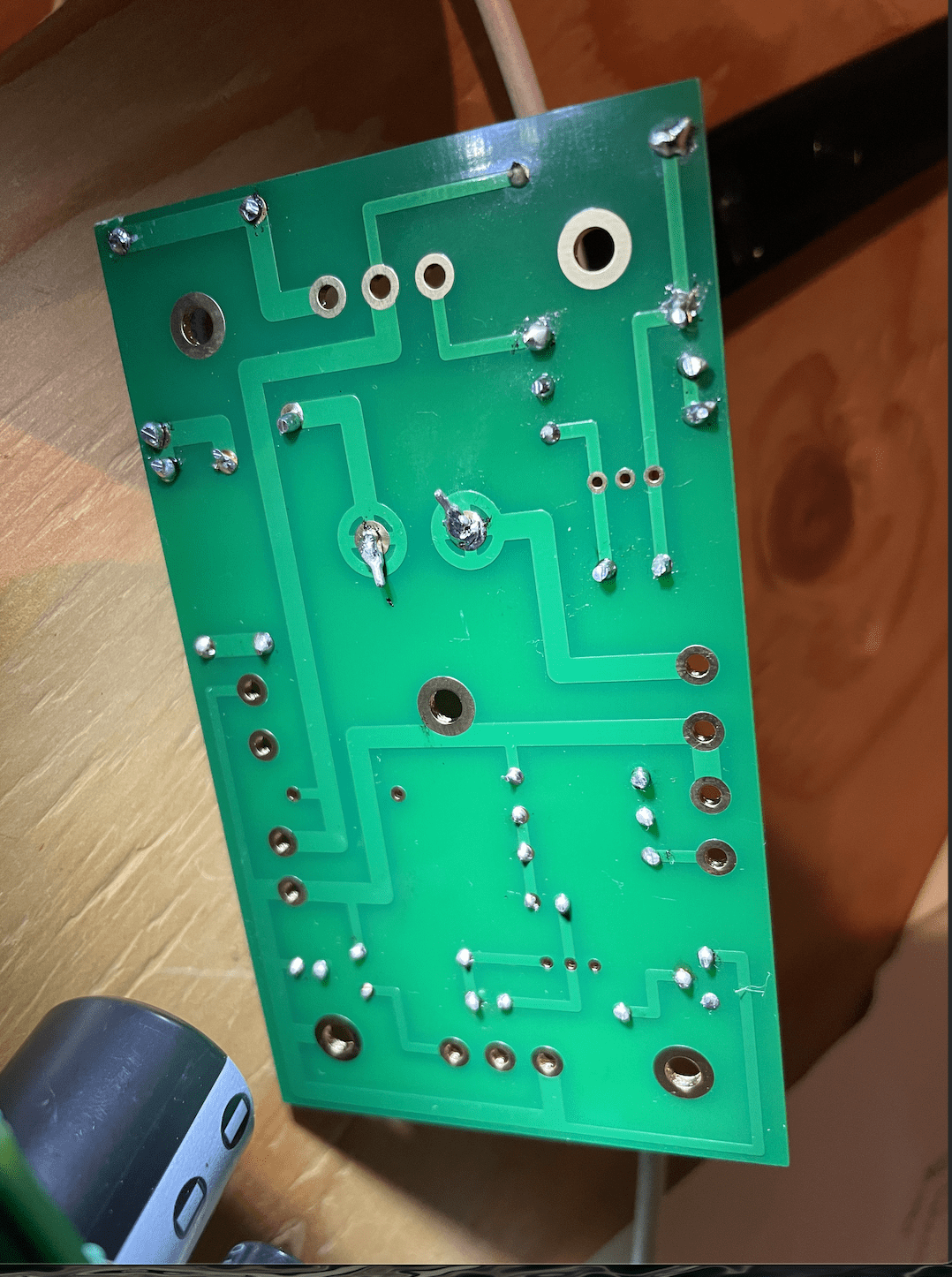

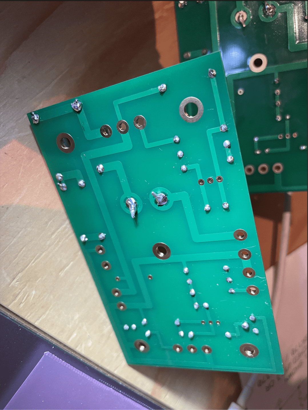

Also, while you're at it. Any input or thoughts on my soldering? It's my first attempt and I'm a little wary of it.

Tell us about your soldering equipment, material, and technique. What Iron/tip? What solder? What temperature? What's your technique? What teaching resources have you used (videos, books, practice board)?
I'm using a Hakko fx-888D Iron, Sparkfun Lead free solder (water soluble flux core) and in terms of technique I pretty much hold the iron to the joint for a moment and then apply the solder underneath the iron above the joint and hope for the best haha. I run the iron at 700 Farenheit.Tell us about your soldering equipment, material, and technique. What Iron/tip? What solder? What temperature? What's your technique? What teaching resources have you used (videos, books, practice board)?
That’s the wrong small transistor pack. PM me your post address and I’ll send proper ones.
Lead free solder is, well, awful. I’ll send you some real solder as well.
