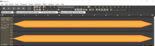

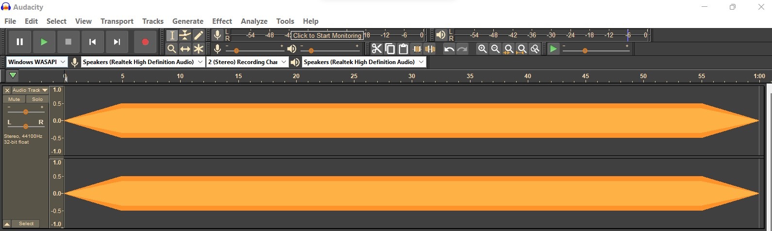

I'll do a tone now... give me a couple of minutes.

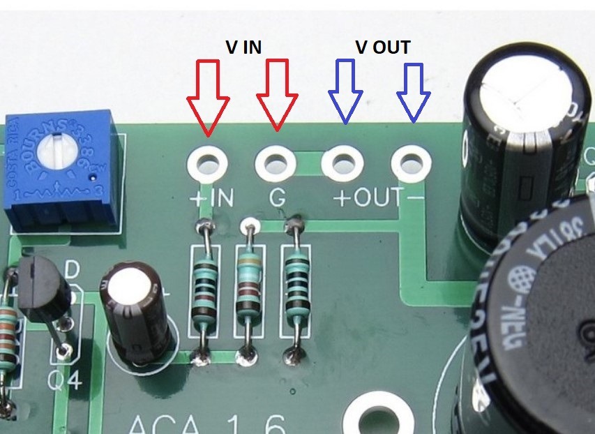

It is worth you visually checking that the same value parts for R11 and R12 are fitted to both amplifiers. Don't assume anything 🙂

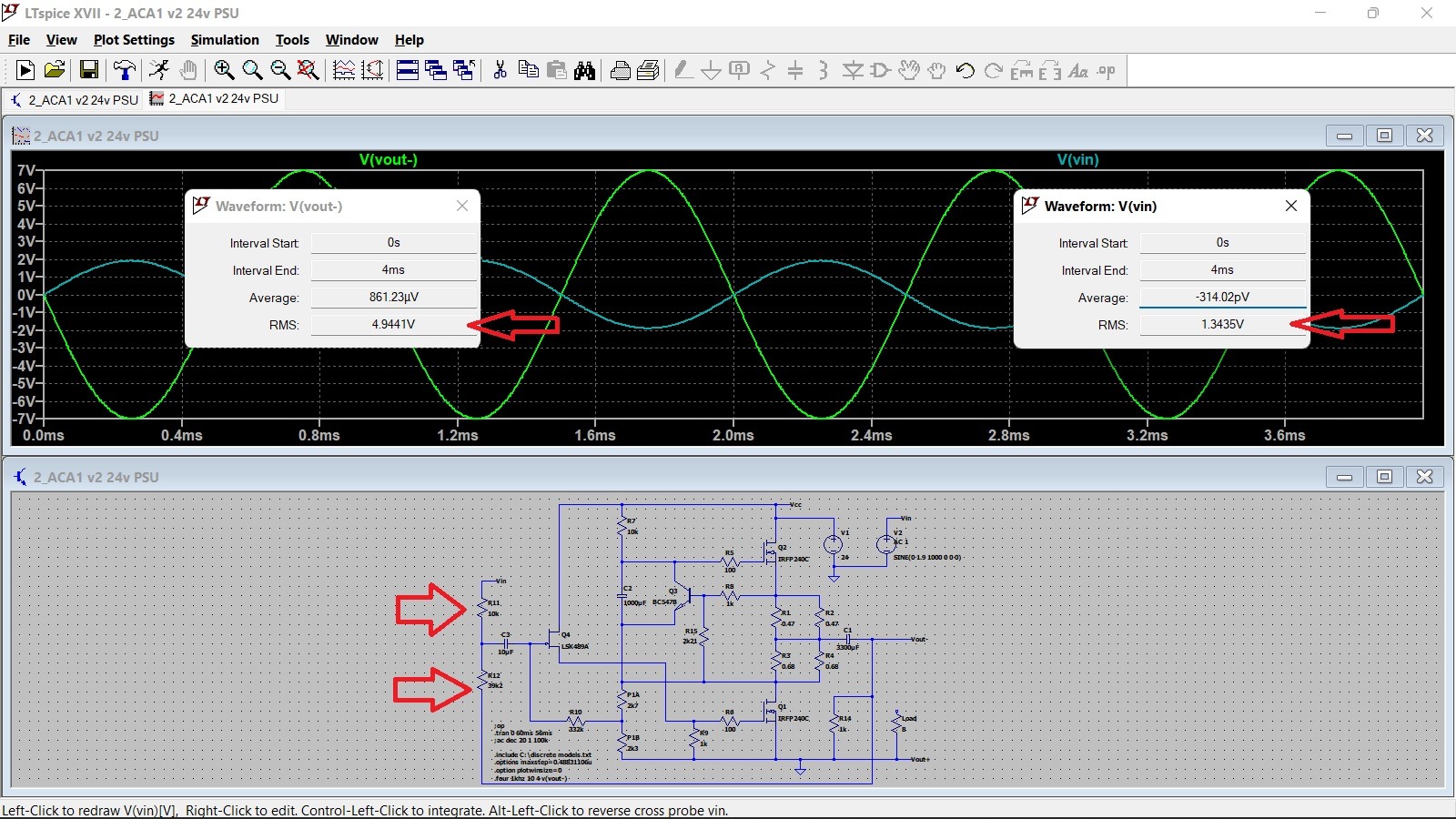

This is what you are checking. This shows voltage in and voltage out as a scope would show it and (in the boxes arrowed) what a meter will show.
The gain works out as the 39.2k divided by the 10k (so numerically 3.92) and you can see this simulation comes pretty close at around 3.7. Why is not exact... because of the complication of R10 and the setting of the preset which is an unknown as each amp is different.
Give me a minute for the tone...

Now compare output voltage and input voltage as measured on R11 (the end that goes to the input sockets). Try and use the same range on the meter for both readings.

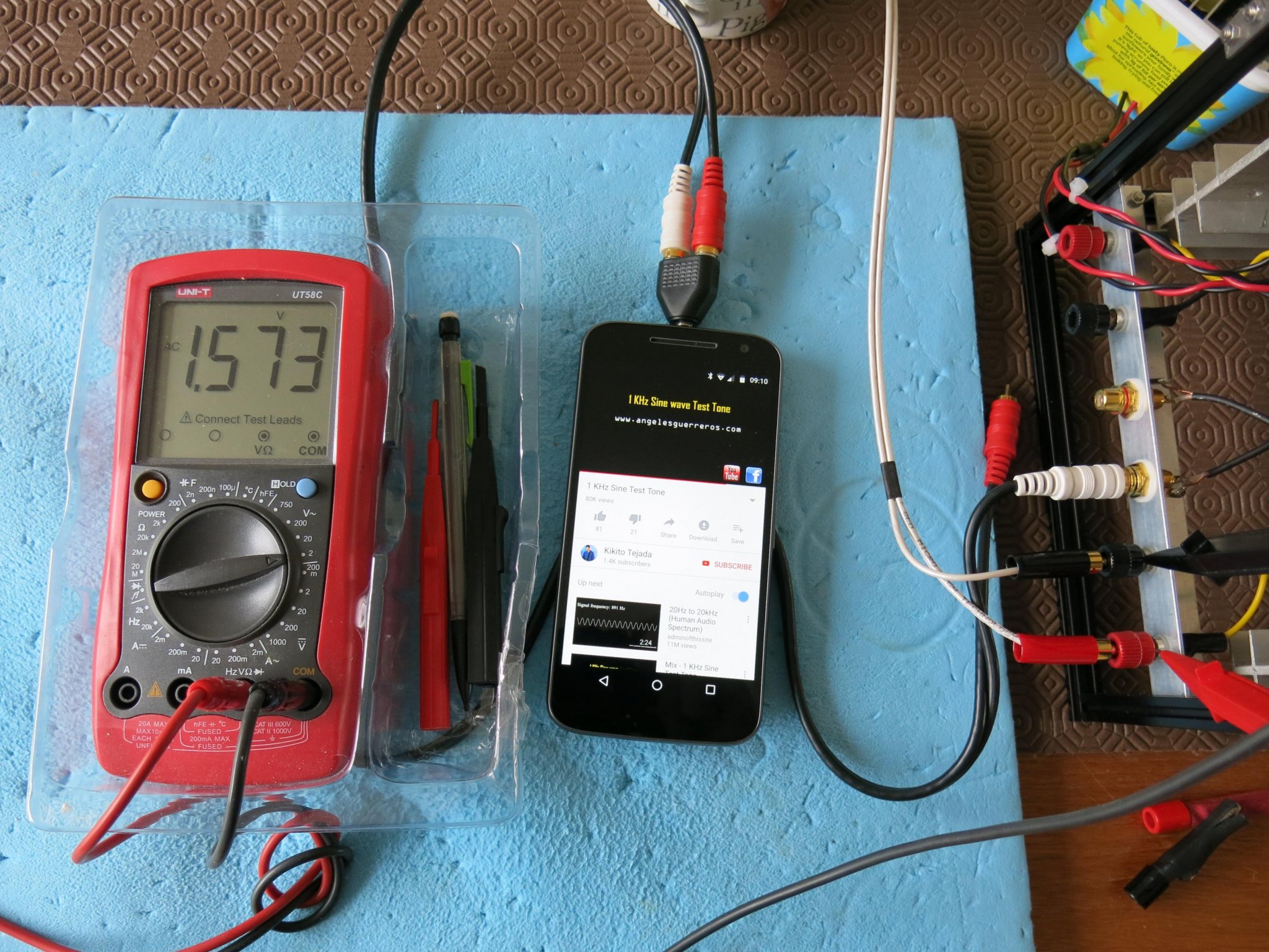

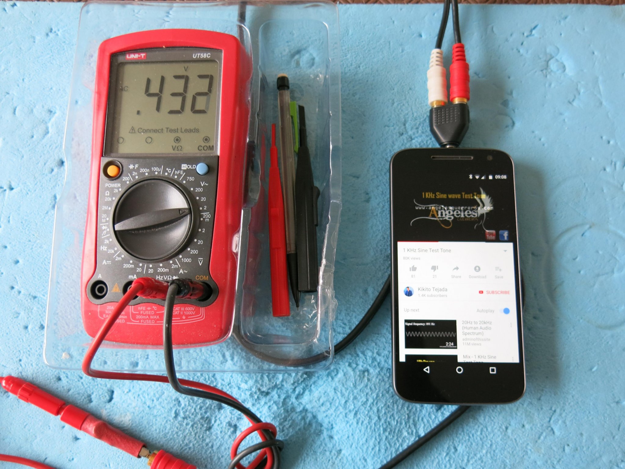

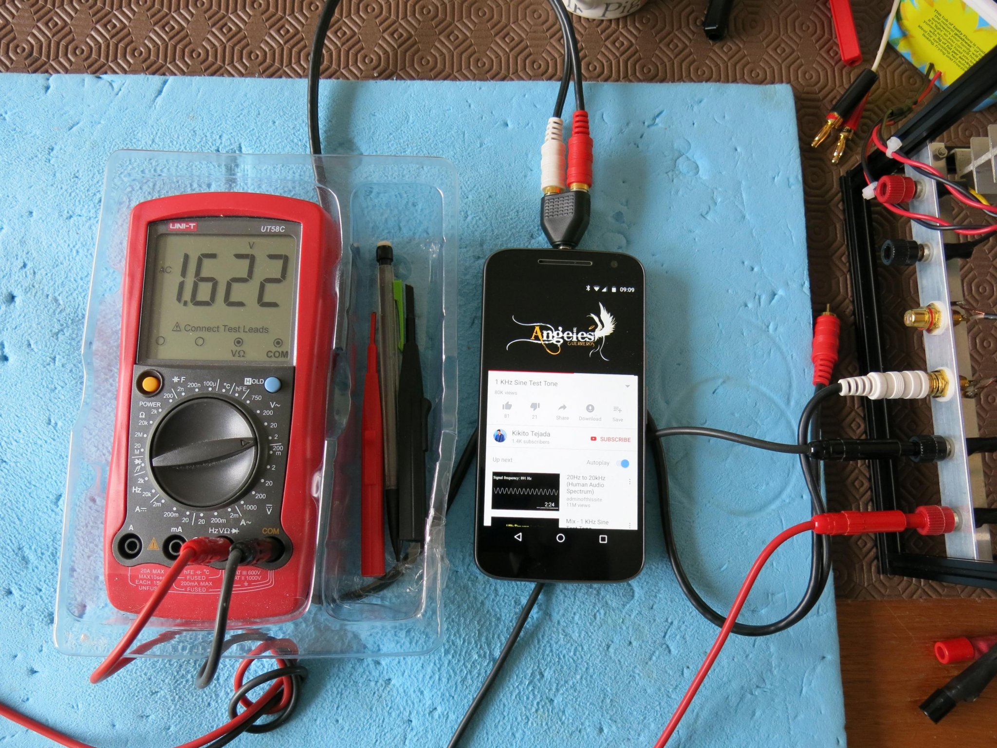

There is another way to use a test tone if you have a mobile phone. From here https://www.diyaudio.com/community/threads/amp-camp-amp-aca.215392/page-298#post-5547999
Quote, ''Here is a way to test your ACA is amplifying correctly. I just tried it on mine and this is what I did.
Used my mobile phone and went to this site for the 1 kilo Hertz test tone, it is a bit louder than some.
I turned my phone's volume to maximum and measured the AC voltage at the head phone socket playing the tone. Mine is 0.43 volts AC. Yours might be more or less, just note what it is.
Then I plugged the phone into my ACA and measured the output at the speaker terminals. (No speakers connected.) I get 1.622 volts AC.
If I connect my speaker (8 ohms) and measure I get 1.57 volts AC.
Again yours might be different just note it.
So on my amplifier for an input of 0.43v ac I get 1.57v ac out.
3.6 times amplification and you should get something similar if all is well.
Hope that helps.''

What is the best way to check voltage to R11?
With a meter if you have no scope. The meter must be on AC volts. Measure between these two points in red for the input voltage and then between the two points in blue for the output voltage.
