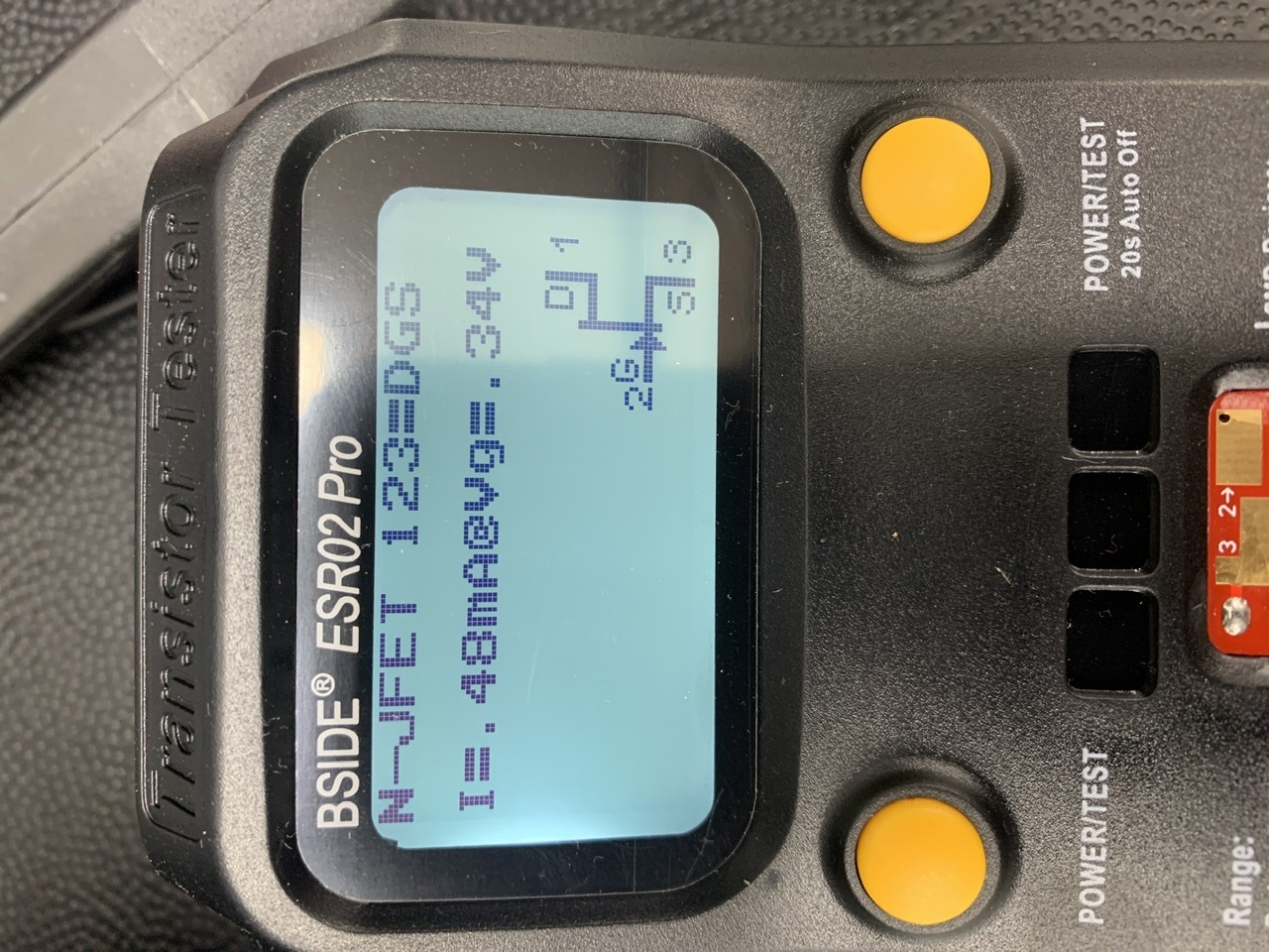

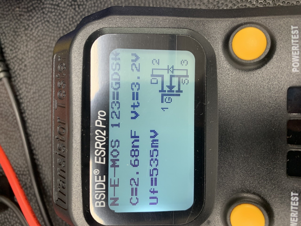

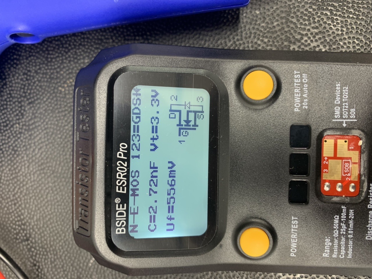

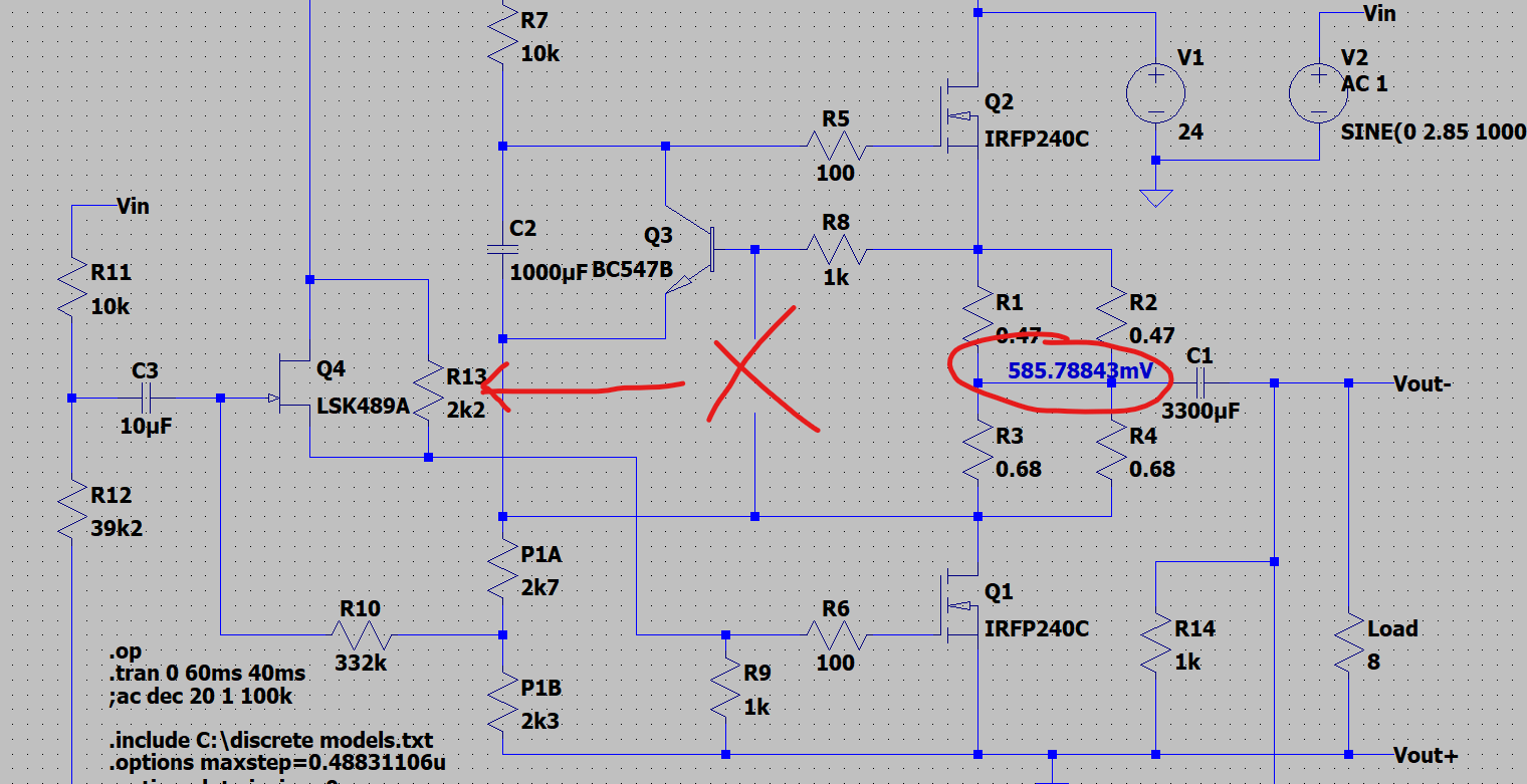

This is a puzzling one. I suspect something around the input FET (or the FET).
3.6 volts on R6 isn't quite enough to get the power FET into conduction.
Look at R10 (330k) that connect the gate of the input FET to the preset wiper.
You should see approx the same voltage on either end of the 330k. Check that is so first. The actual voltage depends on the preset position and should be able to be taken down to zero volts at one end of the range and as high as whatever the midpoint voltage is at the other end.
A totally random thought. If the input cap C3 is fitted incorrectly (wrong way round) then the leakage current would be enough to pull the gate voltage down. That scenario will show by you measuring very different voltages on each end of the 330k

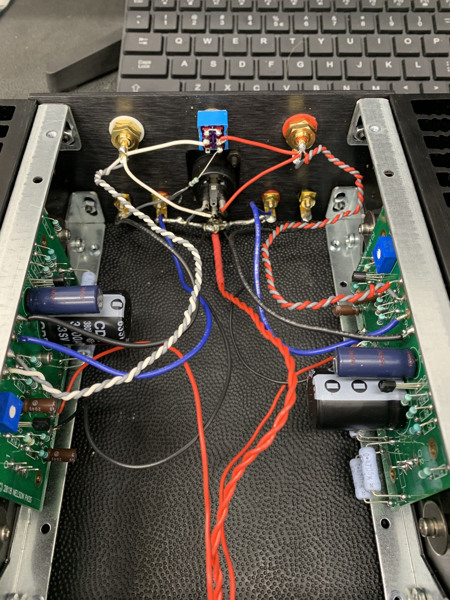

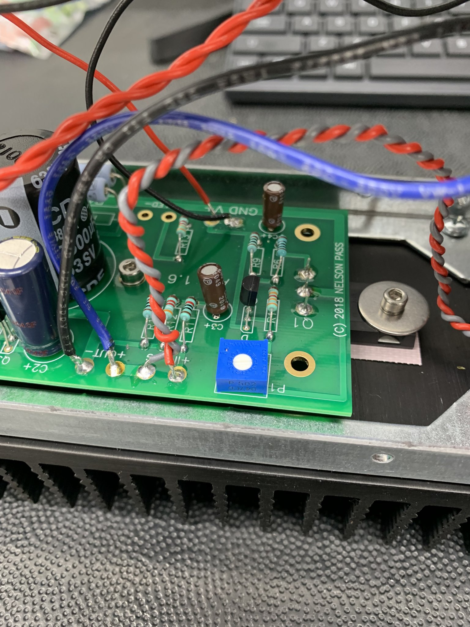

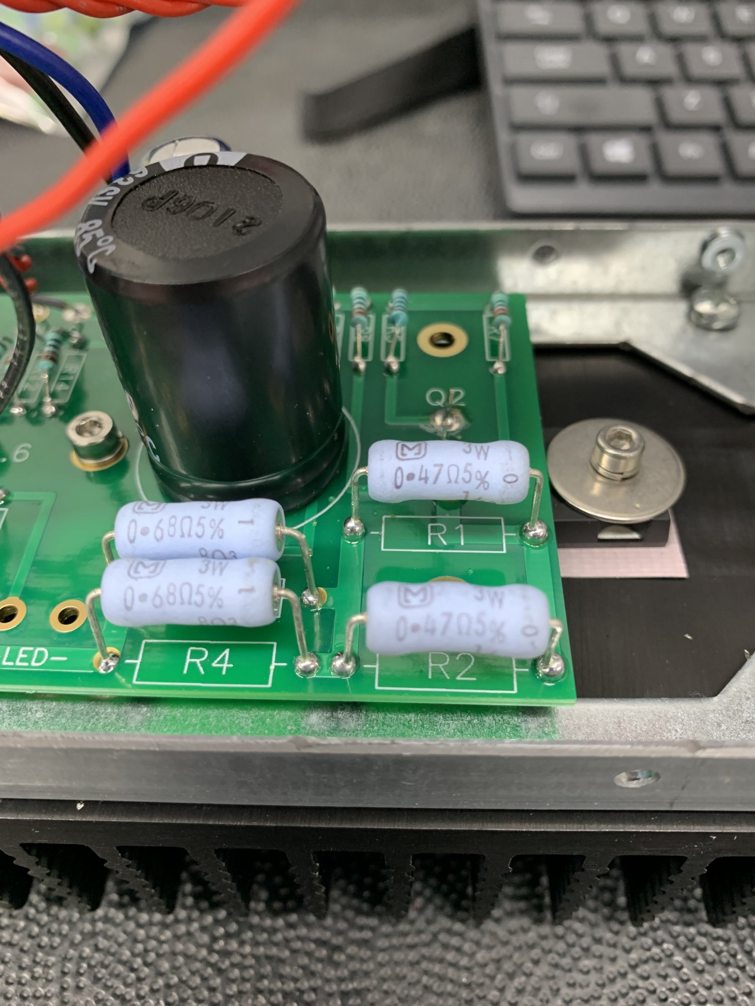

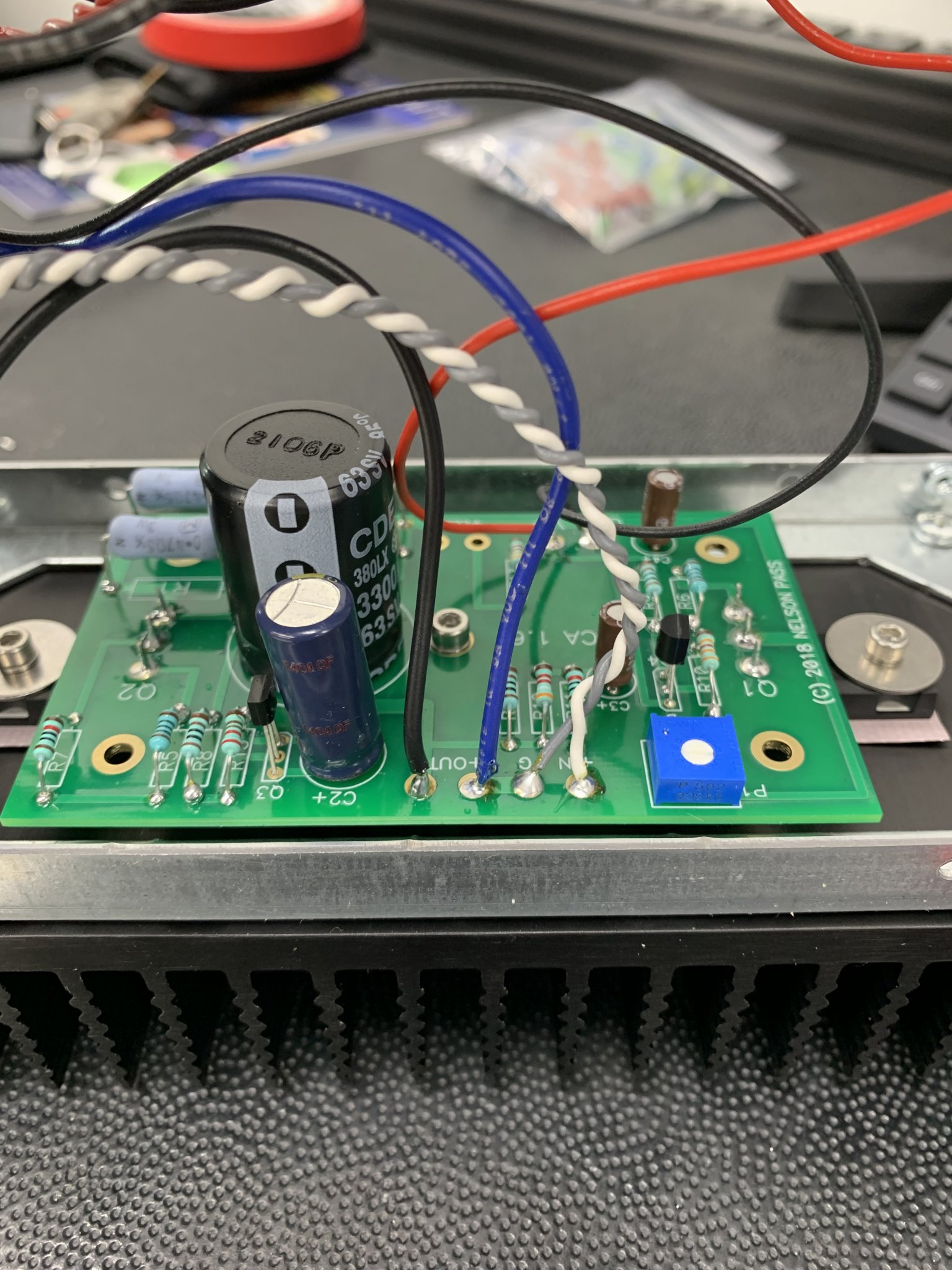

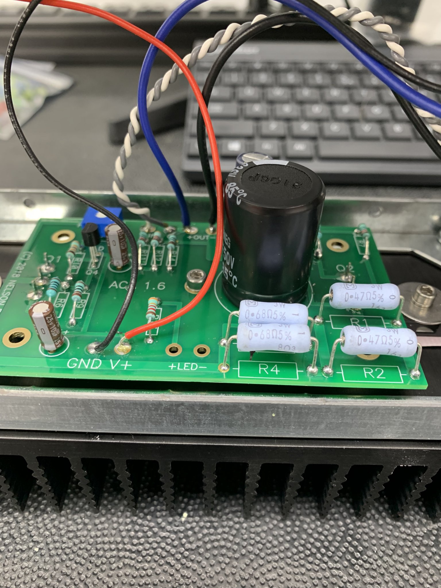

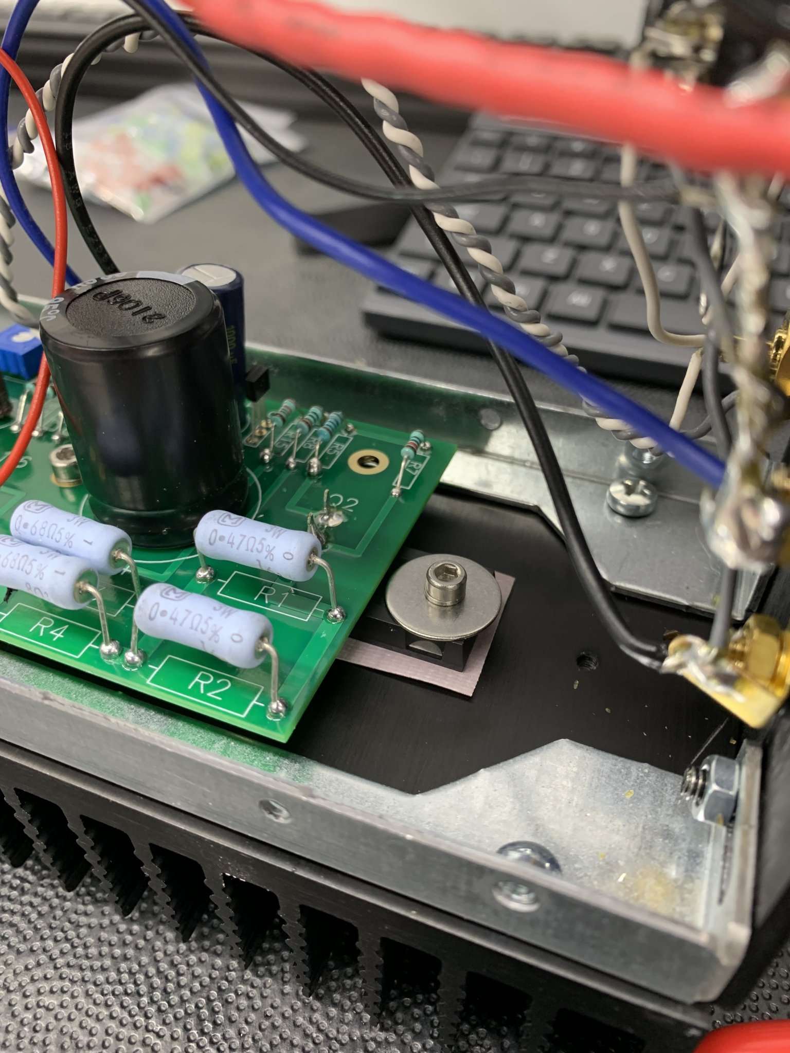

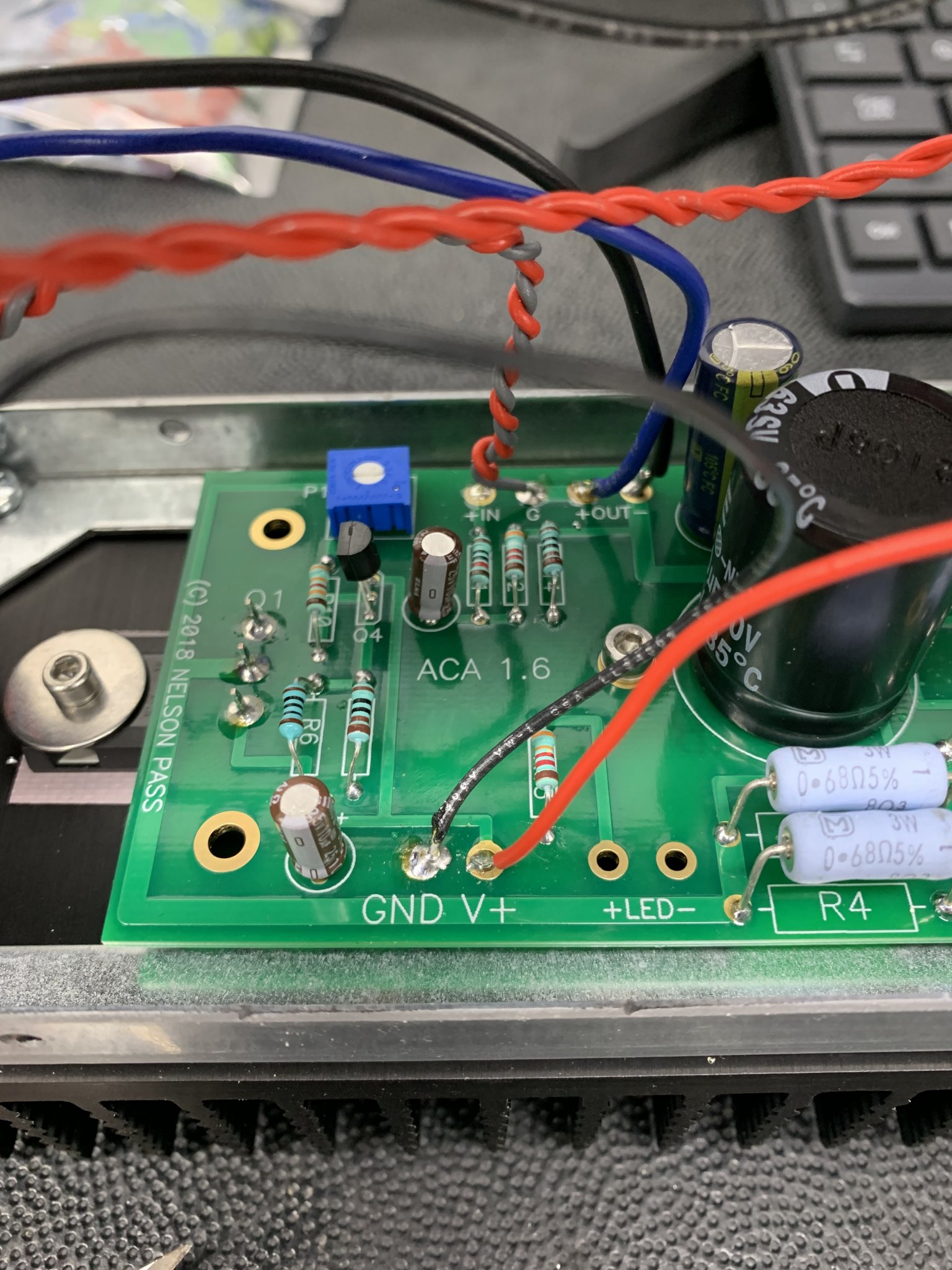

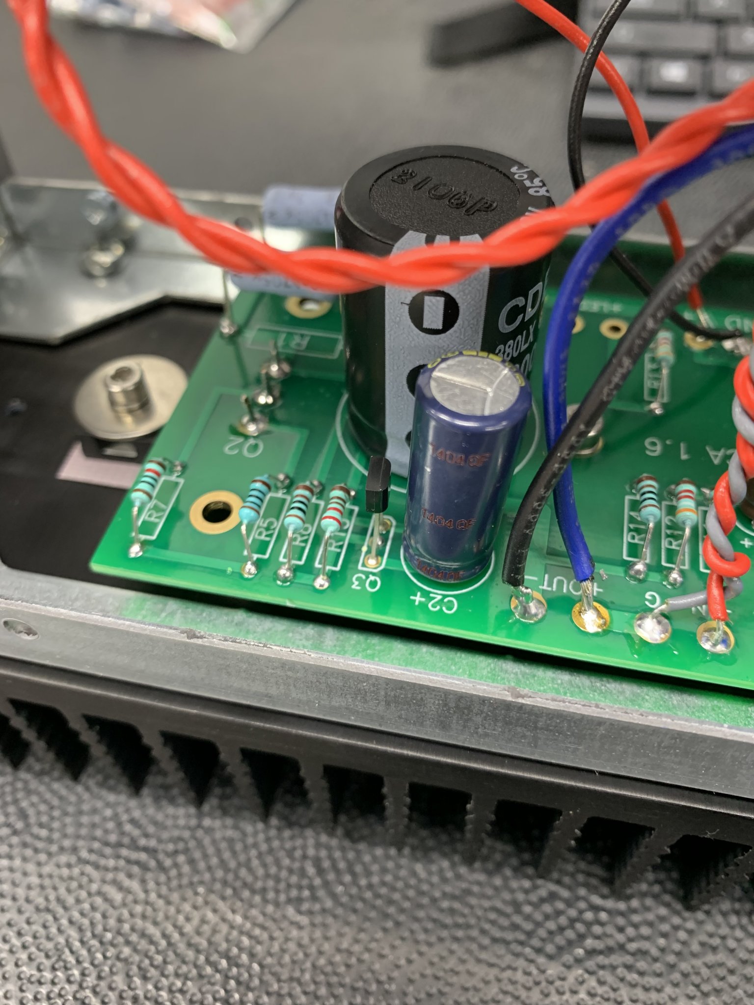

I’ll share the results of the test, wanted to share some pictures first, I tested all the resistors before I populated the board, individually. They were the correct values. Capacitors are all facing the correct way for polarity. I pulled the boards to make sure nothing was touching the chassis and that’s good also. Testing now.
“You should see approx the same voltage on either end of the 330k. Check that is so first.”
I get 3.4Volts on either end of R10.
“The actual voltage depends on the preset position and should be able to be taken down to zero volts at one end of the range and as high as whatever the midpoint voltage is at the other end.”
Do I do that by adjusting the potentiometer?
I'm not sure (well I am sure actually
) that that is a good idea. Ideally any fault should be found by doing as minimally invasive work and testing as possible.

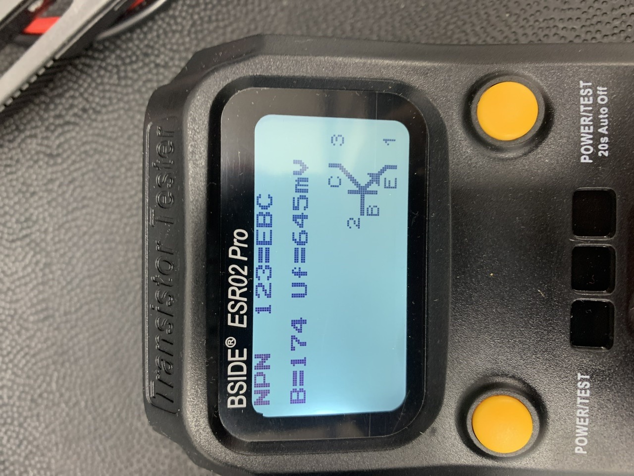

As for the input FET, well I think the circuit should bias up OK if that were even swapped to a small signal NPN transistor like a BC546 or similar.

Mooly, I wanted to say thank you for all your assistance. I ordered in a new parts kit, and kept the chassis. I soldered everything up, I did use silver tinned wire this time though and 12Ga wire for power. I was talking with Gareth Roberts and he corrected something I did wrong on the first build, which was most likely the issue, I thought I was supposed to set the dc offset to 20V. This time I set it to 12V (actually 12.04 and 12.06, I couldn’t get them any closer.) It works fantastic!

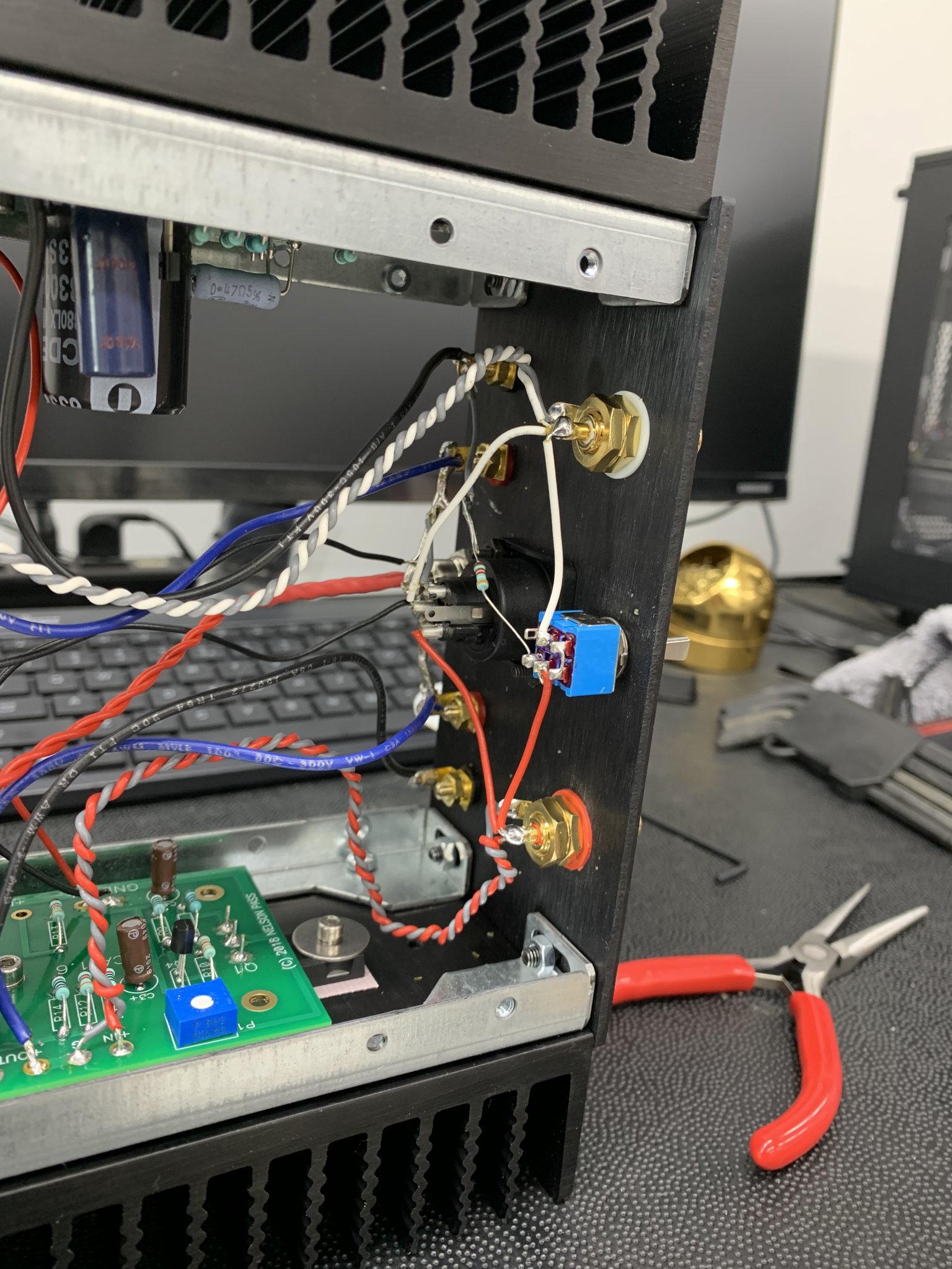

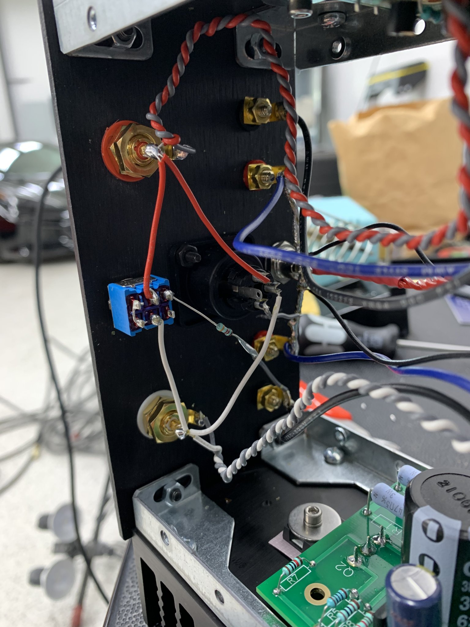

Hey all, I've come to step 39 ( Back Panel Wiring 3 ) and realized I'm missing the green wire that is mentioned. I'm sure I can find some at the local hardware store or amazon however I don't know what gauge of wire it's supposed to be. I have lots of 12, 14 and some 18 and I figured it probably wouldn't hurt to upsize the wire but I wasn't sure how sensitive the components are to voltage differences caused by the resistance of the wire.
LED- is 22awg black in the V1.8 kit.
In- is 22awg grey in the V1.8 kit.
https://cdn.shopify.com/s/files/1/1006/5046/files/ACA_wiring_-_All_Together_-_V18.pdf?v=1593415056
I hope that assists.
Yup the thinner wires are 22. Colors are what whoever linked to. His link shows the “correct colors”, which I believe are white and black. Who’s on first? Whatever…
You could also use the “wrong color” and no one would know. Fatter wire will have no effect.
