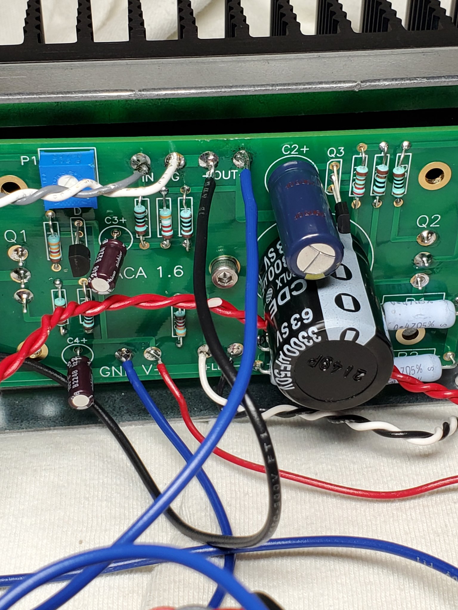

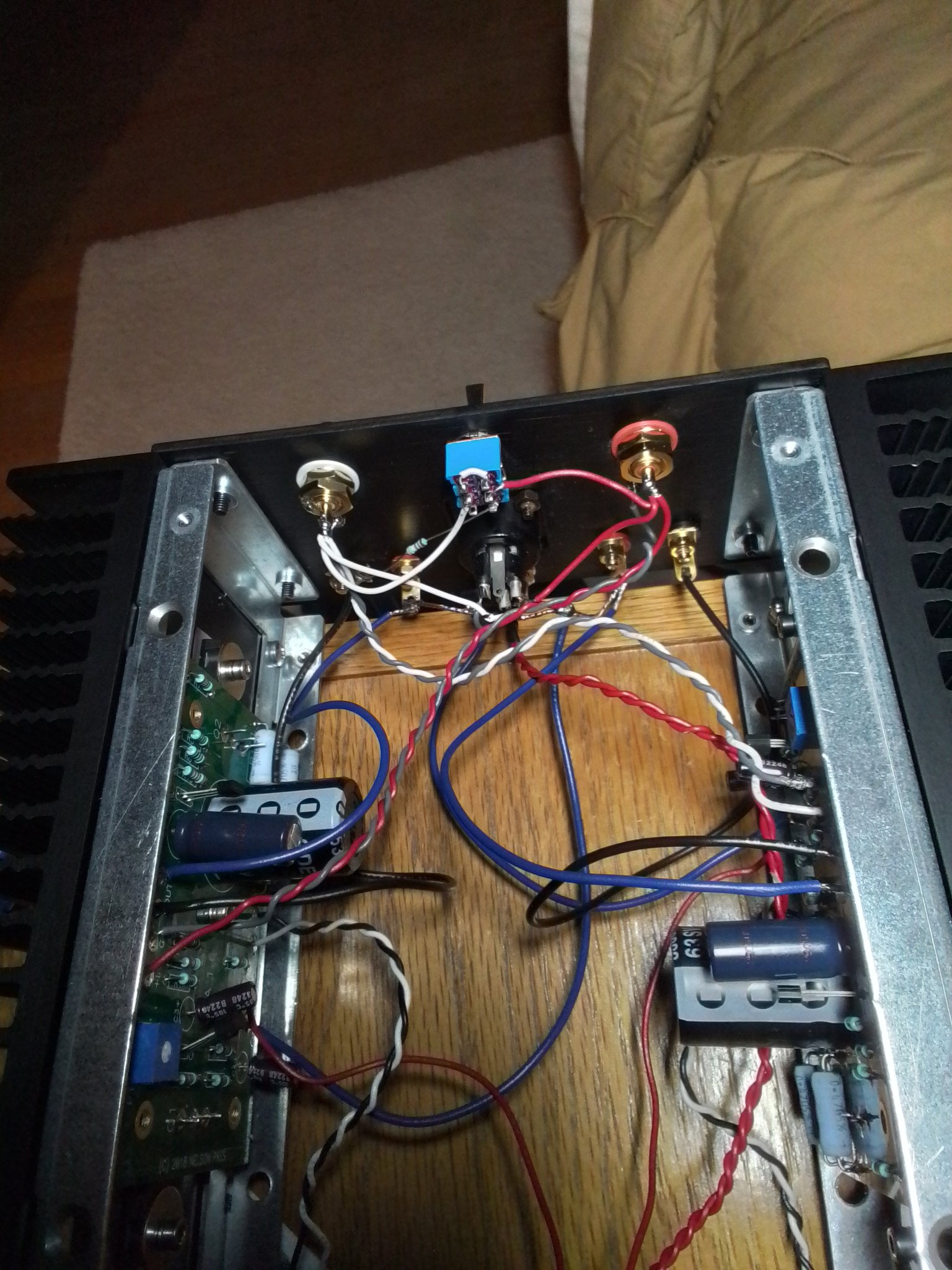

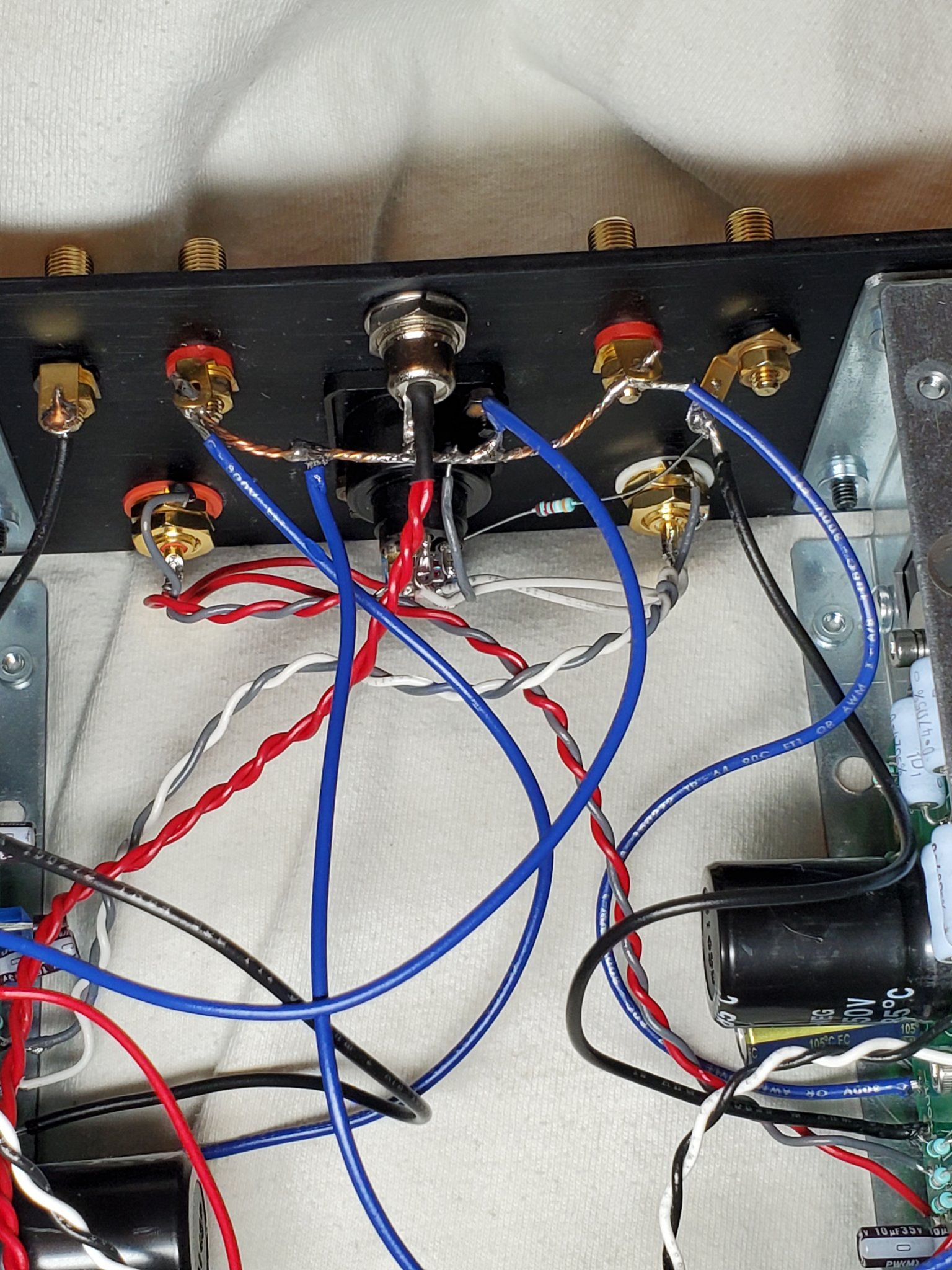

Turned the amp on and let it warm up. Set the bias just above 12V. Diodes are on but I get no sound. My kit did not come with the ground bus wire so I made one with three 22 awg bare copper wire strands twisted well.. Amp does get nicely warm, all four Q's seem to be putting out even heat. I could have put one of the diodes in reversed. I soldered the mosfets on the under side of the board just to be certain. Pictures will have to wait until tomorrow. Except this one of the V 1.8 rear panel wiring.
O.K. then, the diagram in post #1290 is for running in bridge mode, sorry about the mistake.Somewhat surprised that there has been no activity here for almost two months. Did nopajoe ever get his issues resolved? Seems a common problem is bad solder joints and wiring mistakes. I am surprised by the graphic in post #1,290. How is someone unfamiliar with the amp going to get the speaker connections right? Doing as much reading as I can before starting. Will be using eutectic solder and a digital soldering station. Is there a multi meter out there that comes with good instructions and is relatively intuitive in use? My HF one is rather crappy. It is unfortunate that Radio Shack went under as they were a local source for electronic parts. I surely hope I can avoid any serious hard to solve problems with my build which should start in earnest in a couple days.

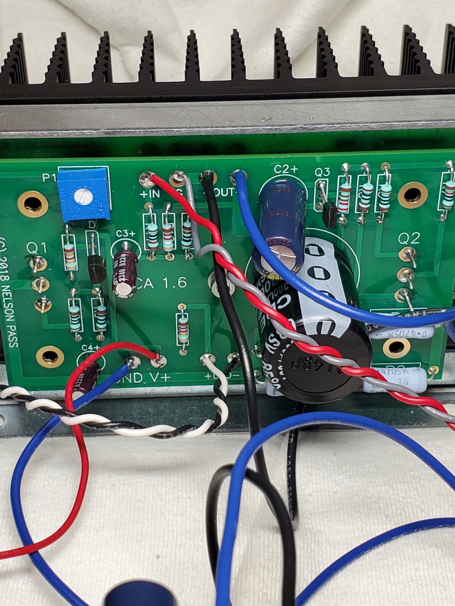

Center legs to ground. Hope the above pics show the resistors well enough. The out and in wiring on the boards shows up well enough.
Right Q1 = 12.6V, Q2 = 24V
Left Q1 = 12.2V, Q2 = 24V
Any more tests I could do? More pics needed?
Casting about here; Cold joint on rca inputs to board? Resistor out of place on board?

R13 looks wrong on my left board...have to check R10 ( maybe I should have gone for the auto ranging meter). Apologies for not mounting them brown end down. I think I must have installed some R's wrong.
R13 is not wrong, It was changed from a 10k on V1.6 to a 33.2k on the V1.8 to dim the led. Dim witted I may have shorted the inputs ( remember hearing a sharp snap as I was moving it ) Capacitors were charged and the input cables dangling off the back. Is there a way to check the transistors ( D3, D4 ) for damage?

That is good advice Tom. I did not get onto the V1.6/ 1.8 build guide quick enough. I'm certain I will get this sorted as I do not give up easily. My boards look good and the wiring is right. I just ordered replacement Q4 fets from Digi Key along with some desoldering wick.

I'm not planning on removing Q1 & Q2 unless replacing the Q4's does not fix things. Q3 looks to be hard to obtain now. I think when I shorted the input leads the capacitors dumped through Q4 and fried it. Just a wild guess though.
