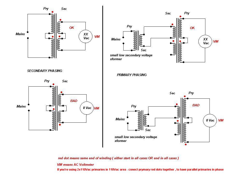

The 2 secondary 18 volt windings need to be added together, and guess the sequence of wires should be yellow - red to yellow - red. The red to yellow will be the centre tap, one yellow to either ~ connection, the free red to the other ~.

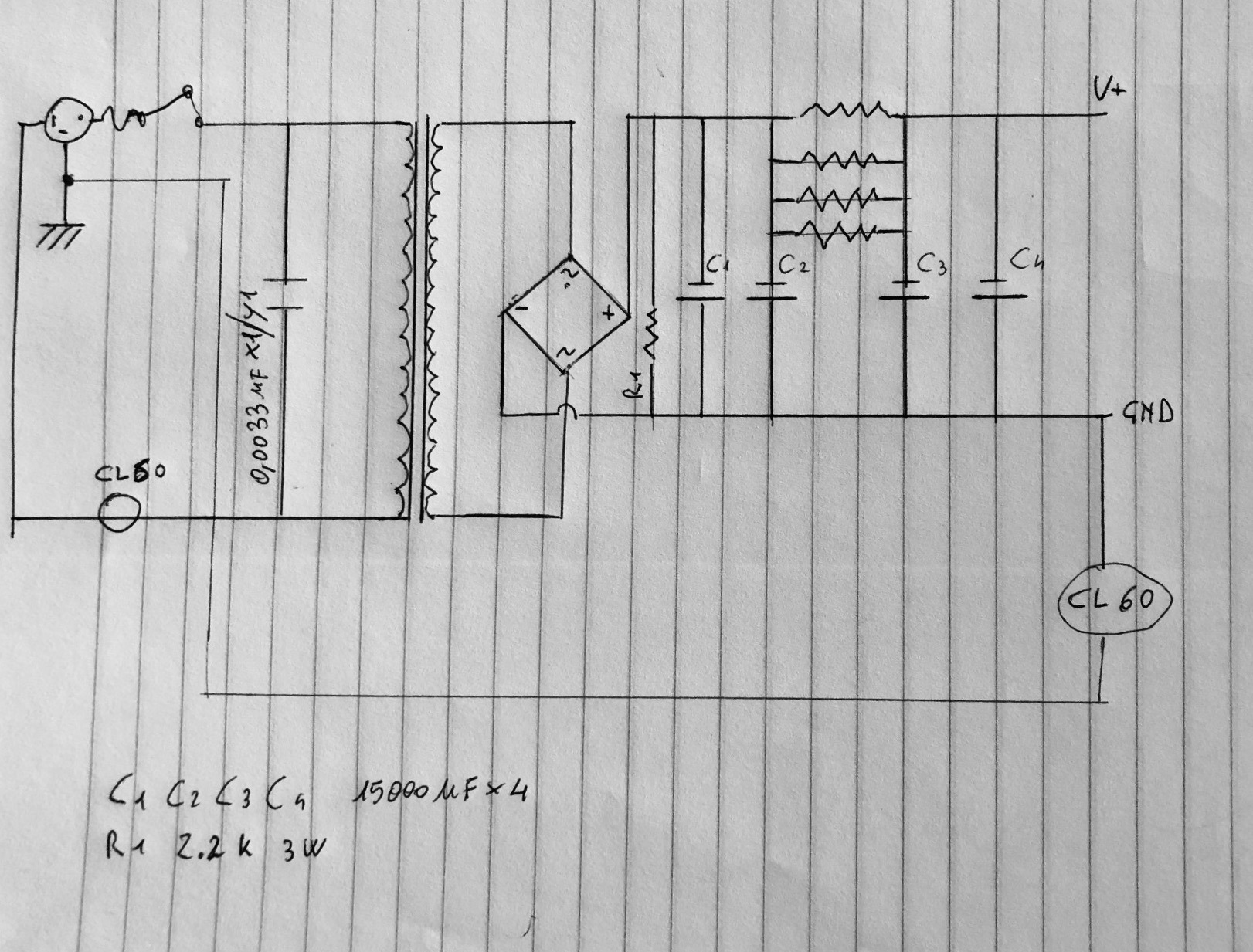

Hi, I found a toroidal transformer with only one secondary 20v 200va without center tap. Could I use it for ACA Amp?
This is the power supply I would like to make with the 200va 20v transformer I found for little money. I have to buy the capacitors, are 4 x 15000 uf capacitors enough for 2 channels? I have attached the schematic so you can tell me if it is correct or if there are better solutions.
