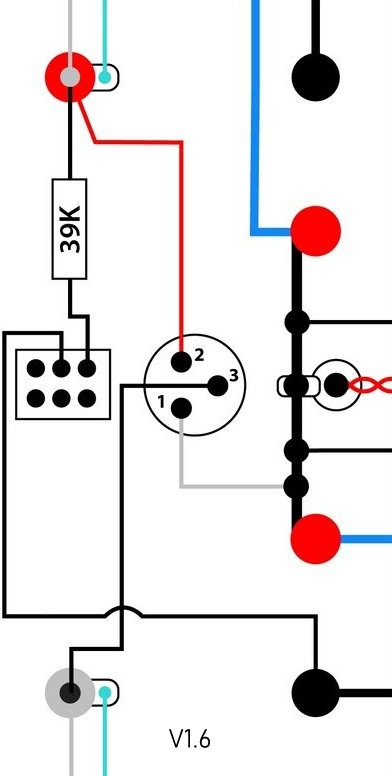

If I use a single-ended to balanced cable to use the ACA's as monoblocks from a pre-amp with only single-ended outputs, will I get the same distortion cancelling benefit, just not the double voltage from having a signal in each lead of the balanced cable?
You have to tell us what sort of 'single ended to balanced cable' you want to use. And or how it will be wired.
If it is the sort that uses XLR pin 2 as input (hot) and combines pins 1 and 3 as the shield, it will simply short the input of the pin 3 side of the ACA. (XLR pin 1 is ground.)

Would the ACA just amplify the signal on pin 1 then? Would it not still cancel out the inherent distortion of the amplifier, just with a lower signal?
Remember, in simple terms, in the XLR world pins 2 and 3 are both used for input. They are not referenced to pin 1 which is the shield / ground.
If you short out pin 3 you will short the 'white' input RCA to ground via pin 1. You wont do any harm, but the ACA will only amplify on the 'red' channel, so cannot cancel any distortion... (Effectively it will be the same as switching off the 'white' channel.)
To use XLR balanced mode you need a balanced output pre-amp or use a 'module' that converts RCA to XLR balanced. You cannot do it with a cable alone.

got it, thanks! That's the answer I was looking for.

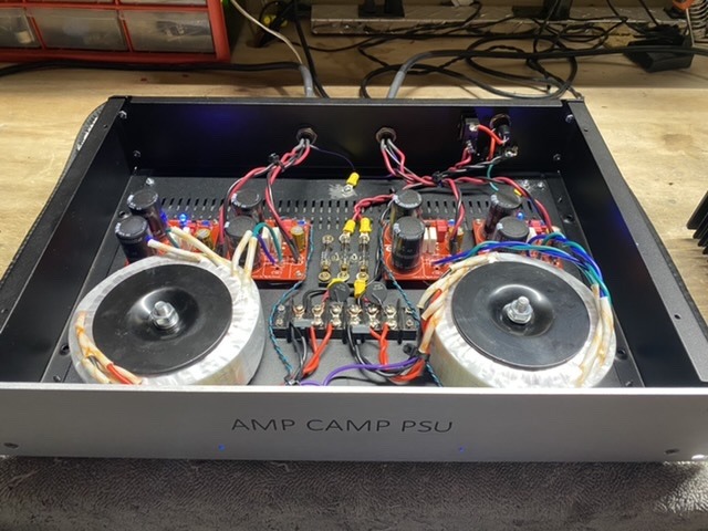

It might might be helpful to add that it will be a single Rel subwoofer connected to a pair of bridged amps, but with an external PSU I built using Rudi’s revision of the CapMX PSU from Jason Keutemann. Each amp board has its own CapMX PSU board with each channel having the grounds tied together. I swapped the power 2.5 x 5.5 mm input with a 4 pin input to separate the power and not using the power switches on the front.

In that case, use an ohm meter to test for direct connection between input terminals. If none then it's likely ok.
